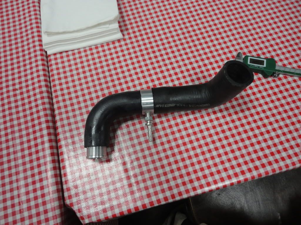

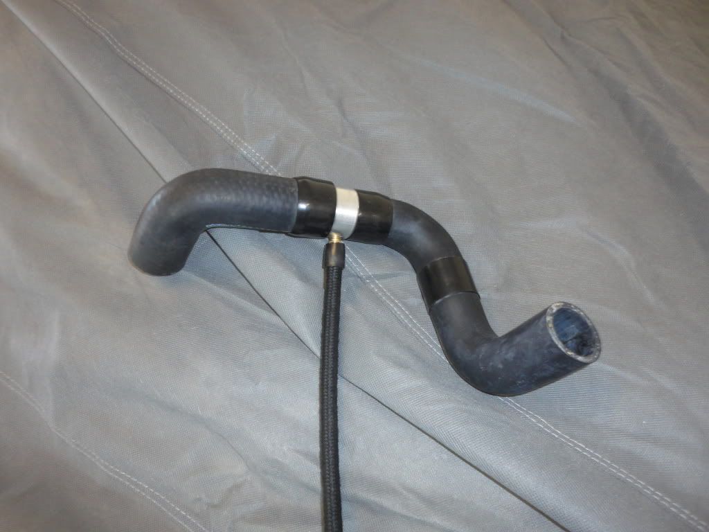

If you want to use your old radiator.......Heres what I did.....you are going to have two different sizes for the hoses.....I made an adaptor to fit the two sizes.....and...I put a fitting for the steam line in the adaptor......Killed two birds with one stone.....a lot easier to find a common size hose with the bends you need.....here are some pic's showing what I did.....works perfect.....
Ken

camcojb 01-19-2013 06:31 PM
That's a great idea Ken, because at some point you have to deal with the hose diameter change. LS is 1.25" id and standard small block Chevy is 1.5" id on the upper hose. Lower hose is even bigger at 1.75" so you'll need to deal with that also if you're going to use a standard non-LS radiator.

Could you explain in a little more detail on how you made that adapter/fitting. Im at that same point in my build. Also what kind of black connecters are those on the ends of the adapter piece? Thanks
kwhizz 02-05-2013 02:21 PM
The aluminum fittings have a Rib on either side that bite into the hose.....the black pieces you see are Heat Shrink fittings that take the place of standard hose clamps......they are made by Gates........These LS engines don't get hot enough to seal them up so I had to use a Heat gun.........LS engines "Rock"......
