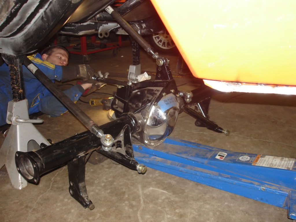

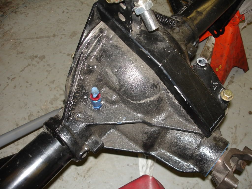

I needed a 12 bolt and asked Lateral Dynamics to build one of their suspensions using a 12 bolt instead of a Ford 9 inch. They ended up using a Strange center section for a 82 to 92 Camaro. Last time I checked they still had a couple in stock. It has a pad for the torque arm that can be adapted to provide a mounting point for the center link of a three link system.
http://i974.photobucket.com/albums/a...aCamaro069.jpg
http://i974.photobucket.com/albums/a...aCamaro001.jpg
