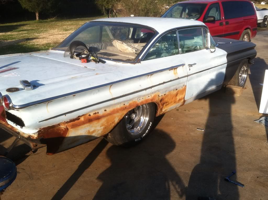

I'm very interested in this build! I also own a 60 Ventura mine isn't pro touring style but still a ton of work has been done. Here's a pic
http://i306.photobucket.com/albums/n...n/c6a2fccd.jpg
Lots and lots of room in those wheel tubs for big tires!!
