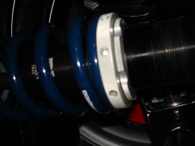

67ragtp 03-01-2013 09:43 AM
As Matt said its a locking ring under the coil adjuster ring, nothing more than a jam nut. Just instaled four of them, you wont have problems great quality.
Rich
