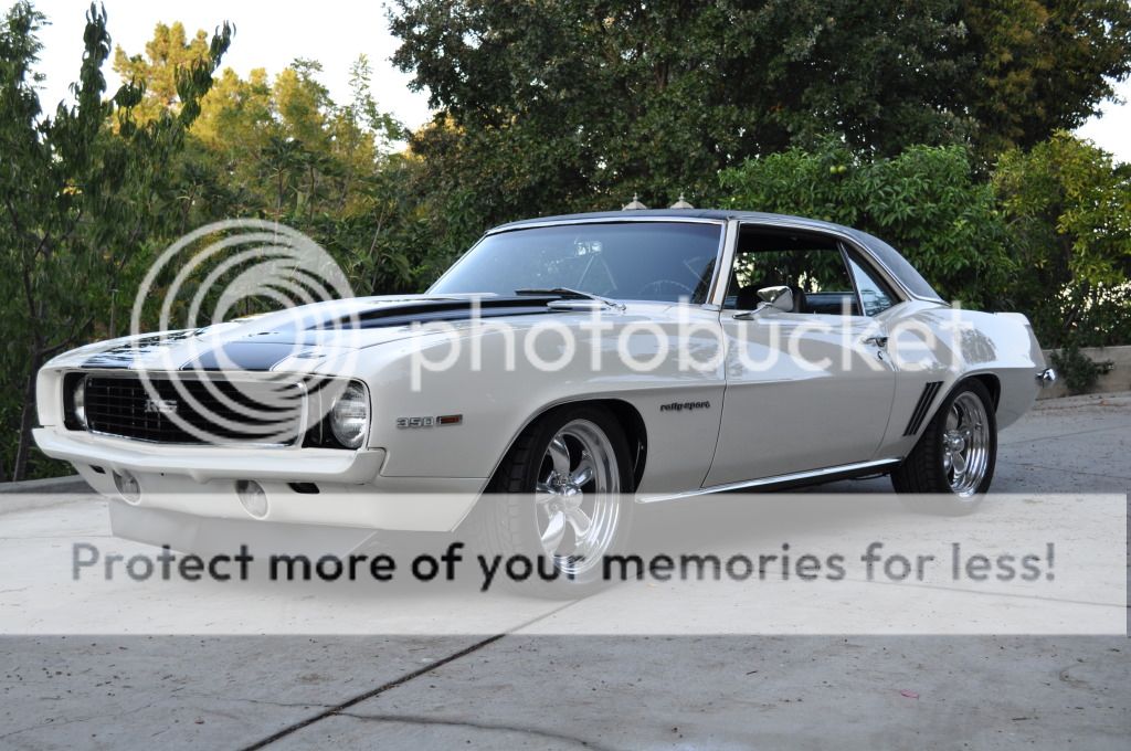

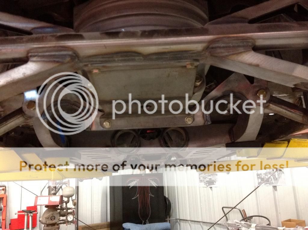

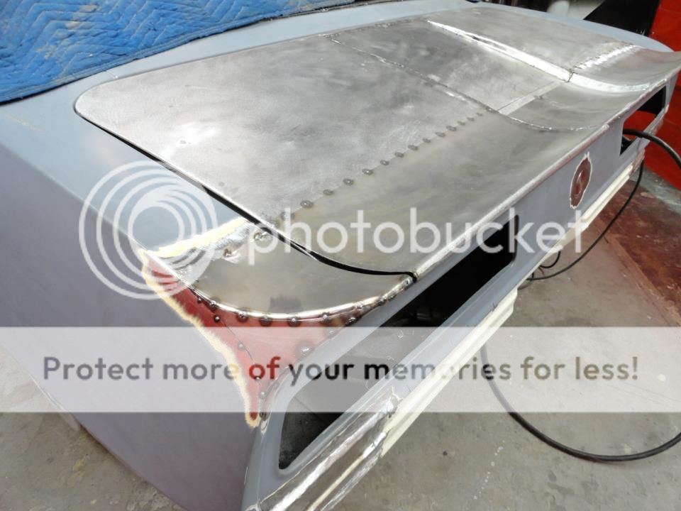

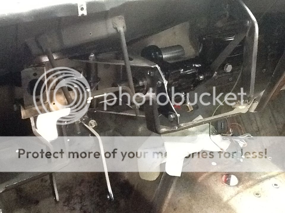

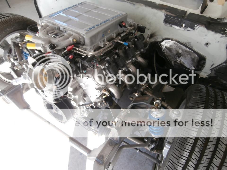

Car was pretty much completely restored when I bought it and decided to get a few things done and call it complete. A few things turned into completely re-doing everything. I'm sure a lot of you guys can relate.

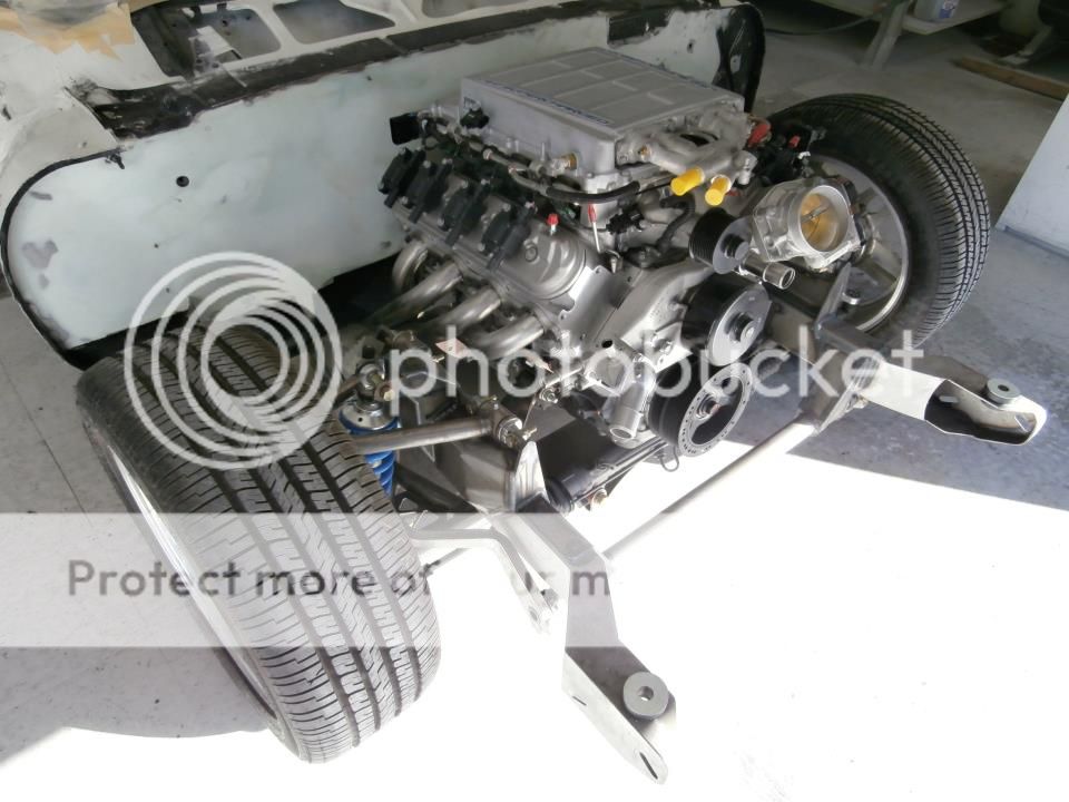

New LS9 crate motor, Roadster shop IRS chassis, custom wheels, mini tubs, 14 inch willwoods, under dash hydro boost and the list goes on and on.

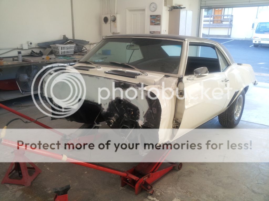

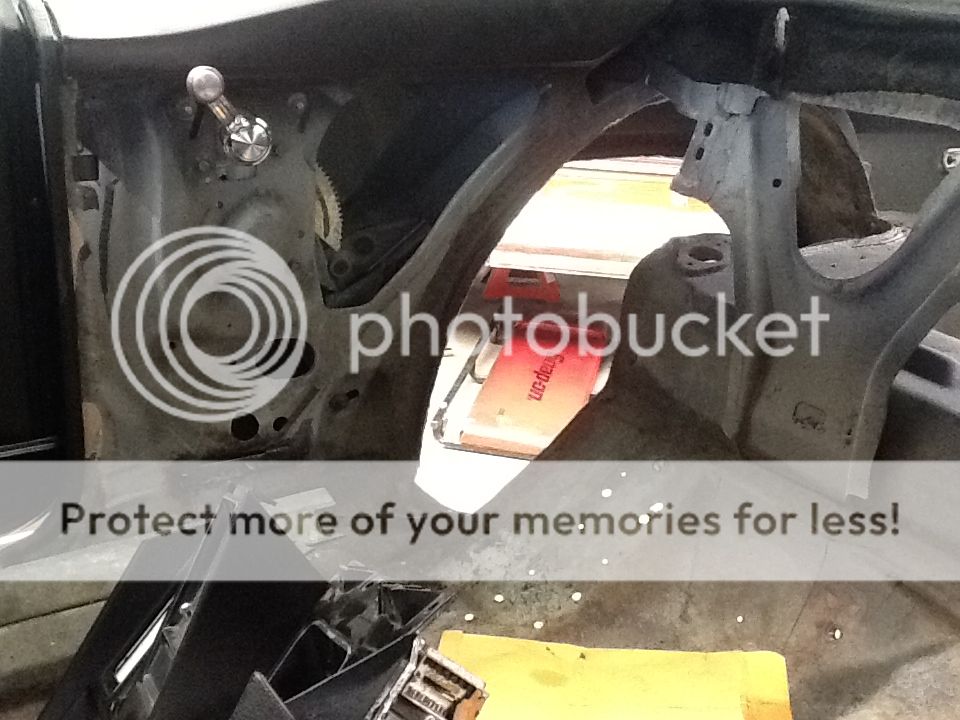

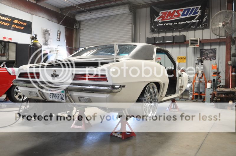

Here is a few pictures before the build and during. Let me know what you think and any ideas.

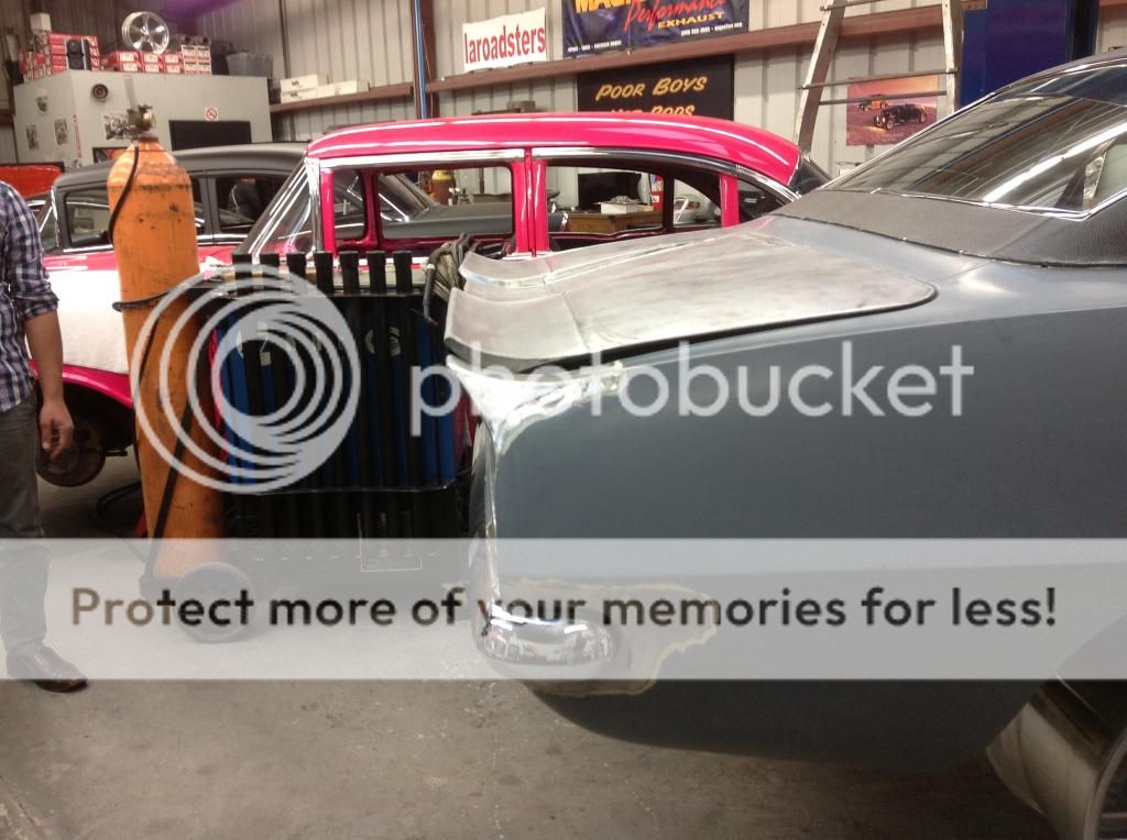

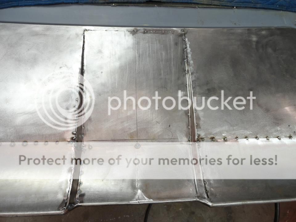

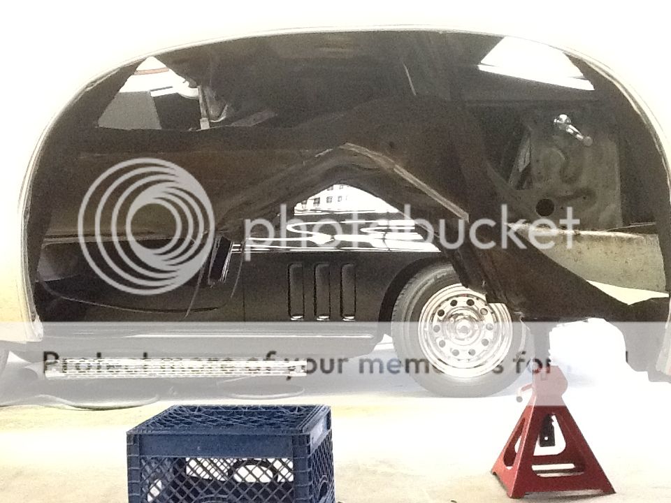

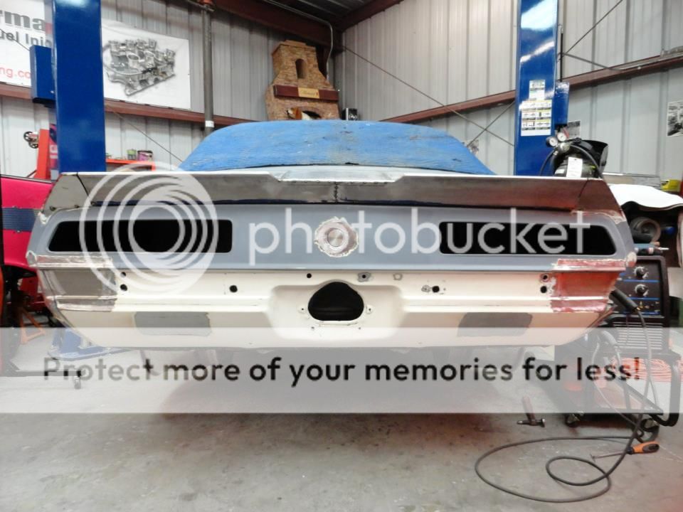

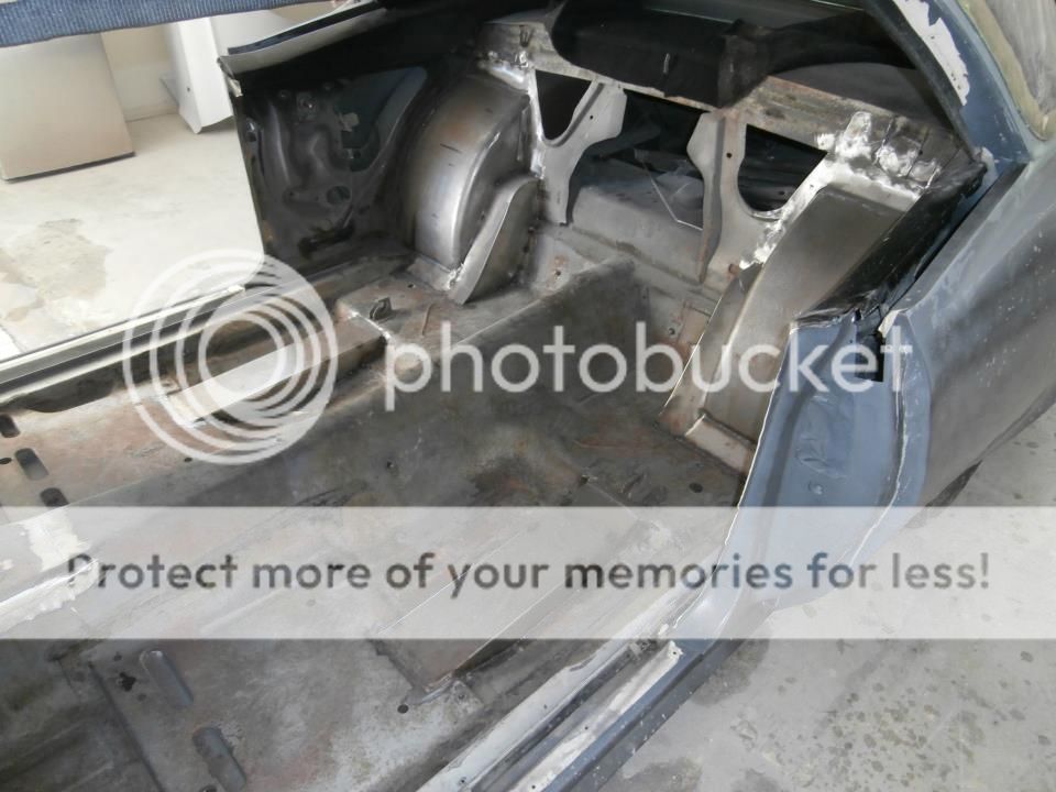

The Roadster shop chassis was modified in the rear for the exhaust. They recommended running 2 1/2 inch over the top of the rear end above the 1/2 shafts for my set up but the clearance is not all that great and I needed duel 3 inch and was not going to fit. You can see in the corners were removed and modified for structure.

Holy smokes, this is gonna be sweet. Like the trunk fab work. Keep the pics coming...we love pics around here.
Cole 02-26-2013 09:05 AM
WOW!!! Love the fab work.

killer build. looks like you had a nice starting point as well. love the fab work on the rear looks extremely wide and very well balanced, excellent choice in color. keep them pictures coming....
