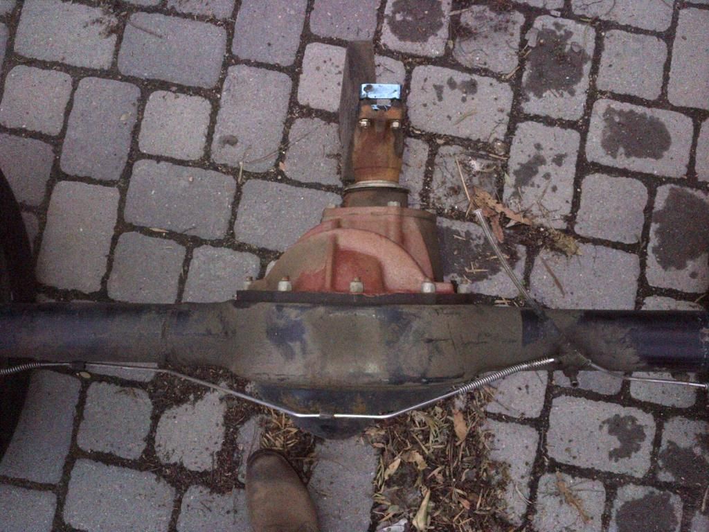

etp2563 03-08-2013 06:20 PM
1 Attachment(s)
I dont have any clear ones of exactly what I am trying to explain, Im in afghanistan right now, so when i get home ill definitely get more detailed photos. I found one that probably shows ore of what I am talking about. It isnt the finish project, I am probably going to change a few things and reinforce it a lot because the 390 I built has a little over 500 ft. lbs of torque so, its going to need it. I am perfectionist with these things and I change them when I am satisfied and felt that it is where it needs to be
