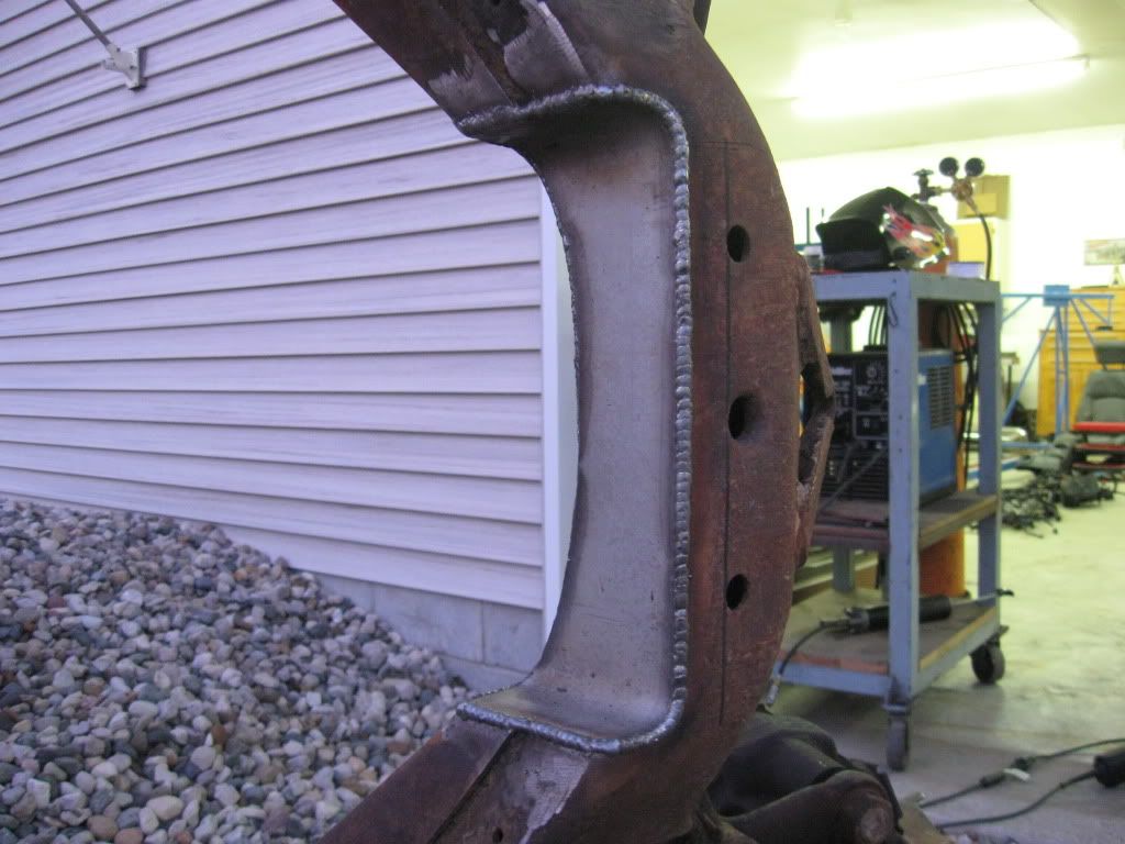

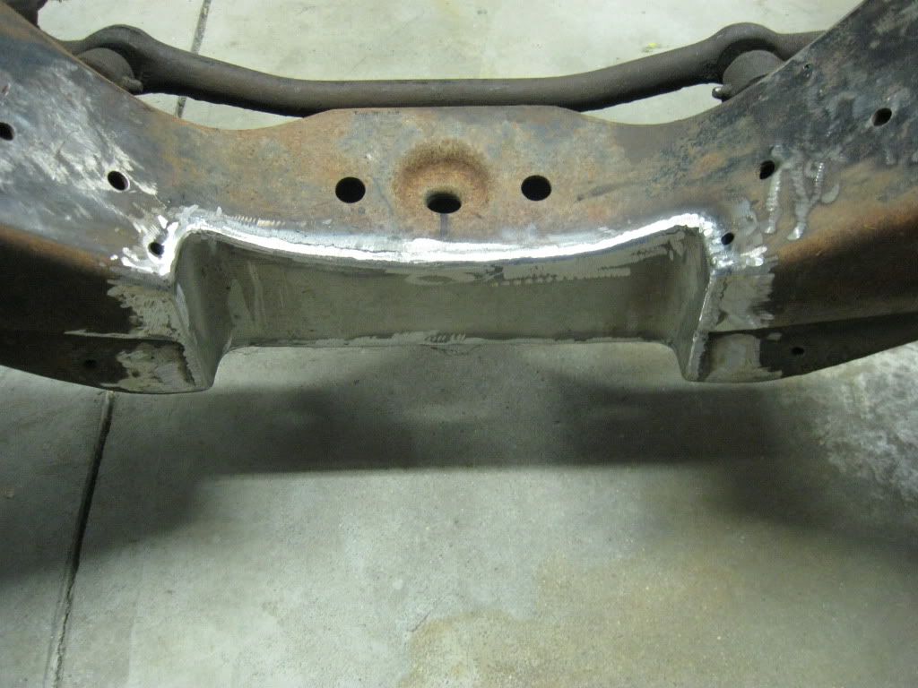

I'd be interested in how JB did his too. I can say that the earlier A-bodies (64-67) are a bit tighter around the front crossmember. The later frames had more of a flat area on the back and top side for pan clearance, the early ones are more of a "v" if that makes sense. I went with the F car pan, well for one I had one, and second it's shallow on the pickup side for ground clearance, and has pretty decent inner tie rod clearance. The biggest reason I notched mine was to get some clearance between the back of the passenger side cylinder head and the firewall. Some guys notch the oil pan instead for the same result.
Here's a couple pics of my notch:
http://i1207.photobucket.com/albums/...g/IMG_1418.jpg
http://i1207.photobucket.com/albums/...g/IMG_1421.jpg

JB64CHEVELLE 03-16-2013 06:23 PM
Hi Vince and Aaron, I will post up some pics for you on this. I had to notch the frame for oil pan clearance with the Mast pan. You will also need to check tie rod to oil pan clearance. I Left just enough room from cylinder to firewall for my coil packs. If your not putting the coil packs on the back of the head and making your own mounts you probably can move the motor back far enough to clear the crossmember. You will also need to modify the firewall to have access to the bellhousing bolts. I have a T56 and ended up cutting the complete trans tunnel out and made a raised one front to back . This was so I could have a low stance, driveshaft clearance with the T56. Hope this makes sense.
