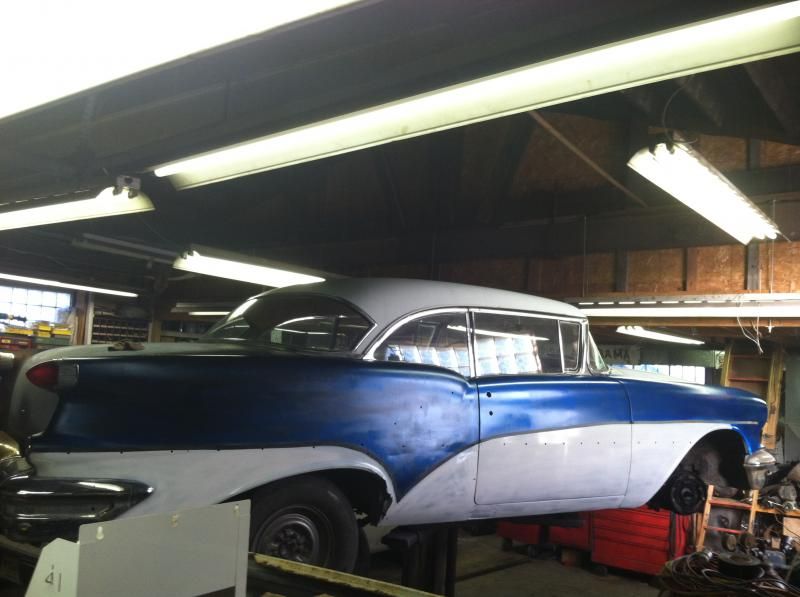

Sorry for the not so great pics. This was a 56 Buick, not the same but similar. We used a Heidts Pro-g clip on this one along with a TCI torque arme in the rear. The x frame accepts the torque arm quite well and the front end went in just like any other "subframe" swap. It's a bunch of work but it allows your to put ride height exactly where you want it. You will spend 8 to 12k in parts going this way, maybe more, so that new chassis isn't terribly expensive when you factor in your time.

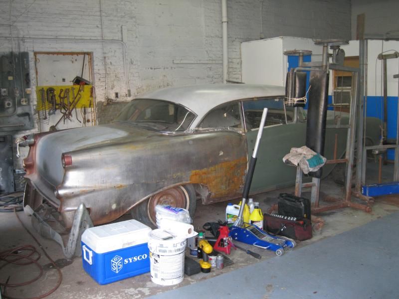

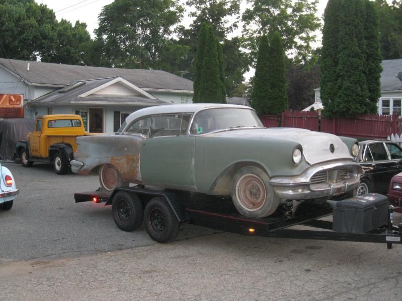

Not to hijack, but since we are on the 54-56 bodies, here's a few shots of the '56.
Shindig garage where found
http://img.photobucket.com/albums/v2...ps59671ee0.jpg
Arriving at the shop. Note '56 F250 Shop trunk on background
http://img.photobucket.com/albums/v2...ps04f18224.jpg
Ghetto paint job infusing '57 buick side trim
http://img.photobucket.com/albums/v2...ps4997371e.jpg
Origin of idea
http://img.photobucket.com/albums/v2...psae16aee6.jpg
Back to topic now.
