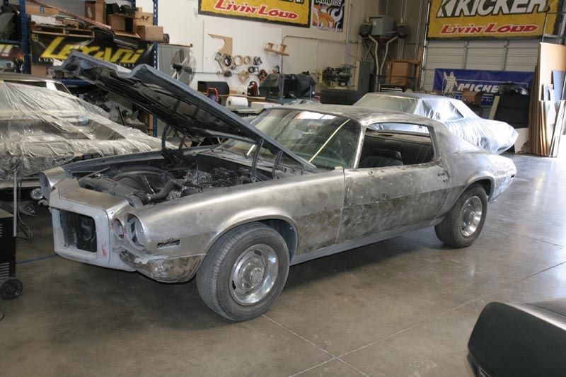

I found this 70 1/2 RS Camaro that a guy had installed a HO 350 chevy engine and a new 400 tranny but it was not painted just in primmer and I decided this would be a good start to a 2nd Gen build that I always wanted to do.

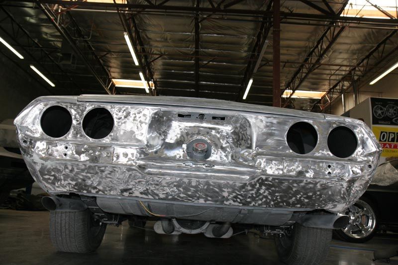

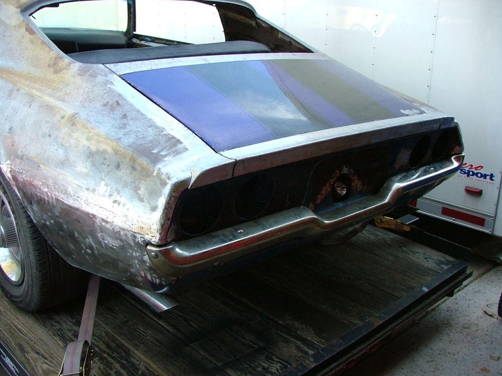

Took it down to bare metal and found all kinds of hidden problems. Someone had rearended the car at some time not real bad just pushed the rear roll pan area in about 3" and they just filled it with BONDO!! So the first thing was to find the parts to repair this problem. Here is a picture of the car in bare metal.
http://i1072.photobucket.com/albums/...1970Camaro.jpg

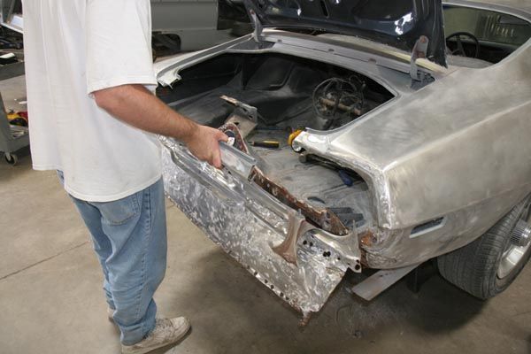

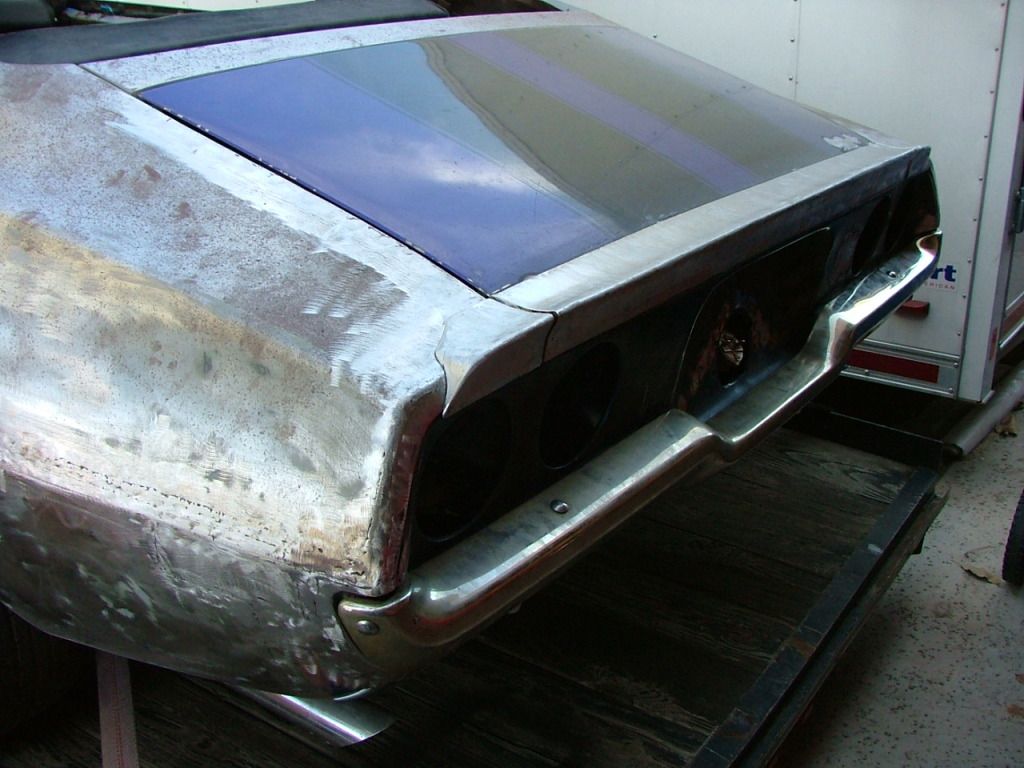

Found a stock rear section of a wrecked Camaro at a junk yard for $200 and got it back to the shop to install the used section on the car.
http://i1072.photobucket.com/albums/...S/Img00331.jpg
Here is the rear section where all the bondo was after it was ground out.
http://i1072.photobucket.com/albums/...S/Img00161.jpg
As you can see it was pretty bad and needed to be replaced.
http://i1072.photobucket.com/albums/...S/Img00521.jpg

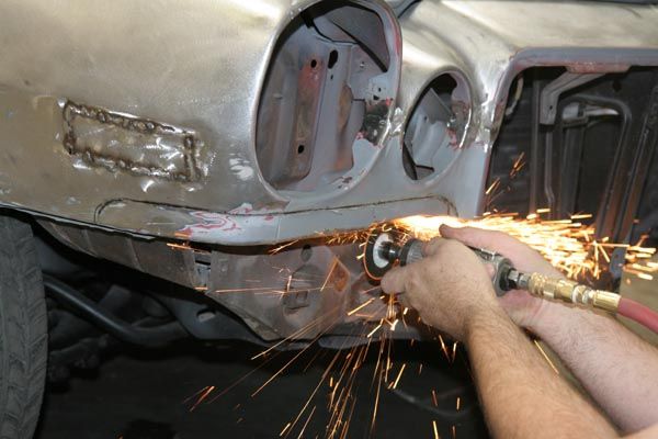

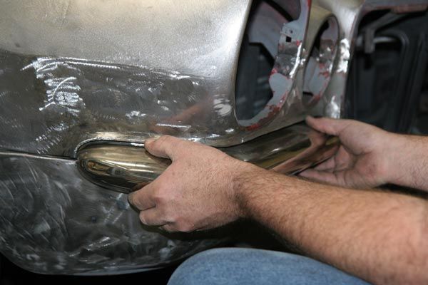

The back was drilled to remove the damaged metal and the new one would be installed.
http://i1072.photobucket.com/albums/...S/Img00531.jpg

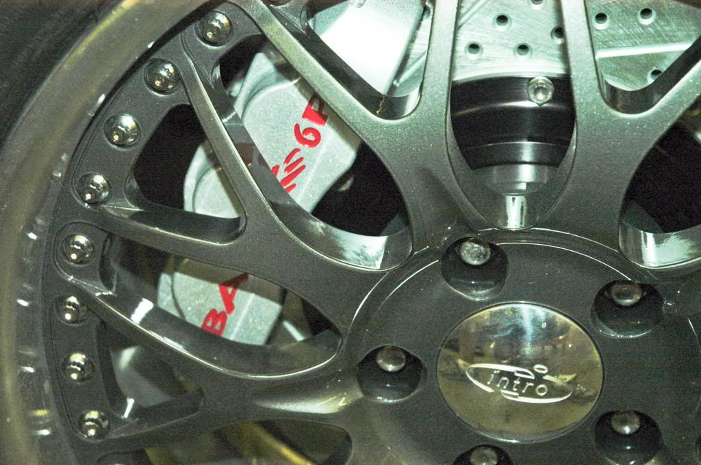

This Camaro will get all kinds of cool little treatments. I will be installing DSE suspension with Baer six piston brakes and Intro Custom wheels wraped by BFG 18" KDW tires. The body mods will be Corvette C6 door handles, a shorter that stock rear spoiler, a half way across the front lower front spoiler, filled side marker lights and tucking in the front and rear bumpers. It will be painted Mercedes silver with a single charcoal stripe and black interior. It will have a Greening Auto custom fiberglass dash with custom mods to the gauge area and the AC ducts. We will use a set of Classic Instrument Gauges and a Kicker stereo system with a RideTech Tiger Cage to keep me safe and be able to use a five point harness for AutoCross.

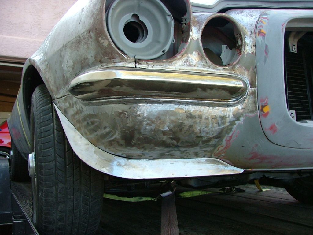

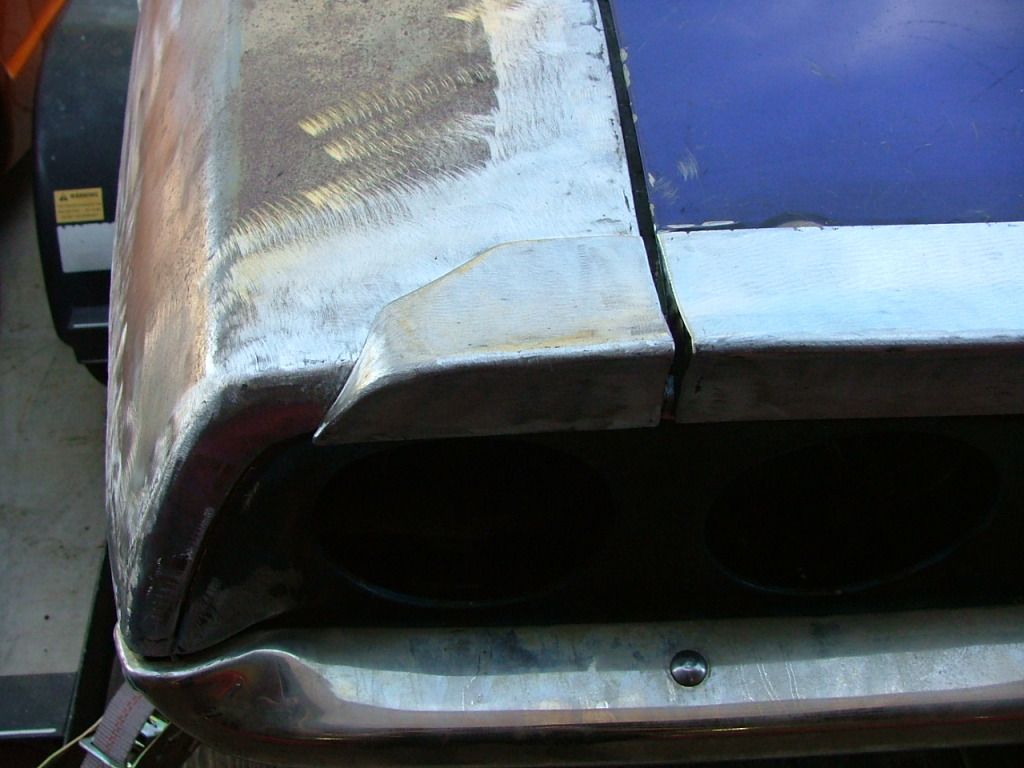

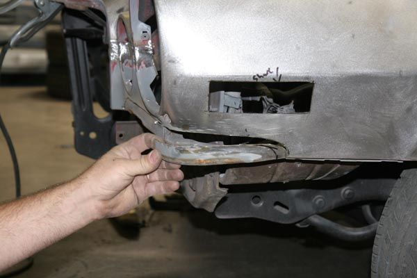

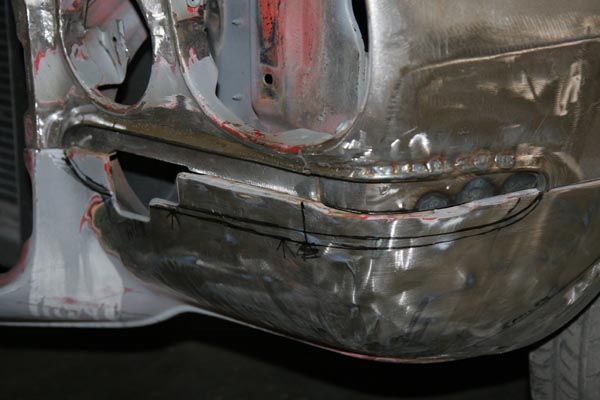

Here is the cuts to the front fenders and lower valance.
http://i1072.photobucket.com/albums/...S/Img00841.jpg
http://i1072.photobucket.com/albums/...S/Img01011.jpg

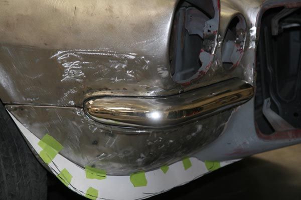

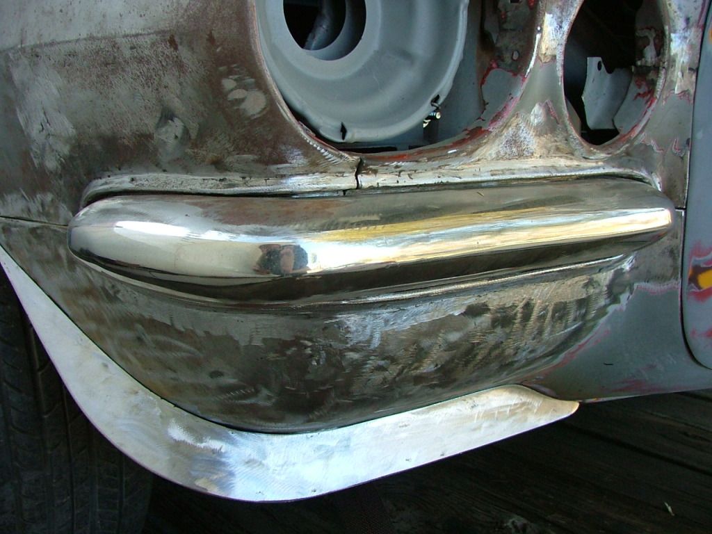

Here is where we are adding the metal to make the bumper flush and almost gives it a sticking out effect.
http://i1072.photobucket.com/albums/...S/Img01101.jpg
http://i1072.photobucket.com/albums/...S/Img01191.jpg
Now you can see how the lower spoiler is going to only go over to the center section and not all the way across.
http://i1072.photobucket.com/albums/...S/Img01231.jpg
The bumper turned out pretty cool and the marker is filled along with the seam from the headlight to the front marker light to the grille.
http://i1072.photobucket.com/albums/...S/Img01261.jpg

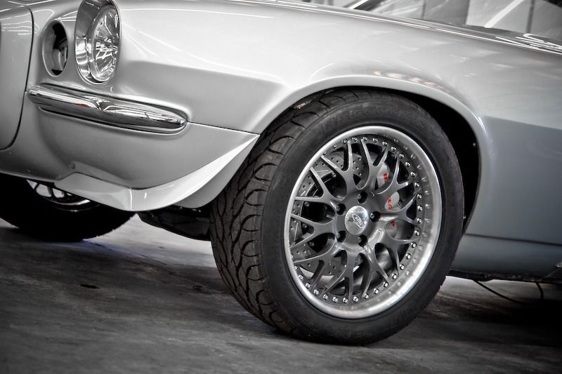

HRBS 04-10-2013 01:37 PM
ed i've seen these pics before......any reason your arent mentioning the builder ? :headscratch:
i am a HUGE fan of giving credit where credit is do regardless if you like the person or not.

waynieZ 04-11-2013 12:03 PM
It looks nice , first time I've seen recessed bumper on the front of a second gen. Cool.
