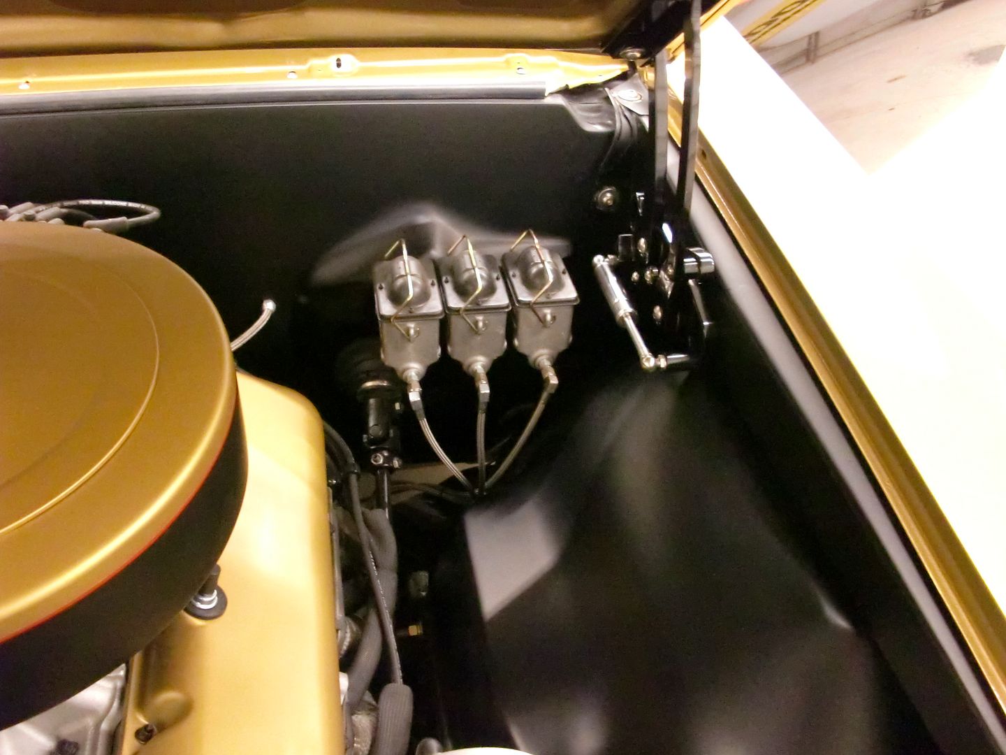

MarkM66 04-23-2013 09:41 AM
I prefer a Wilwood triple mount m/c pedal assembly. Make my own plate where needed.
And some sort of an aluminum column support. I like the Billet Specialties piece, as it has no visible hardware.
http://i17.photobucket.com/albums/b7...2/cimg1144.jpg
