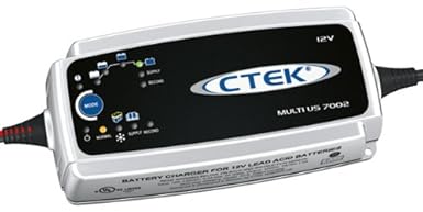

Have you tried reconditioning it with the chargers made for that purpose? I have saved several that way that I thought were dead. Regular chargers don't bring them back. I have a Ctek like this one, but they make less expensive models.

It may be that the battery is shot, but this is how the Ctek does it. A regular charger can cook these batteries. I've had Optima batteries that would not hold a charge that worked fine after being on the Ctek charger; of course your results may be different.

I think I'm going to give the Ctek a try. The way I figure it is that I'll need a tender anyway and this unit will also do that as well as charge and maybe recondition the battery. If it turns out the battery is indeed bad, oh well. I will need a tender anyway. The Battery Tender Jr I was using is an extra one so maybe I can sell it and recover some of my money. I'm getting the Ctek off Amazon for $90 shipped. Got my fingers crossed that it'll work.
