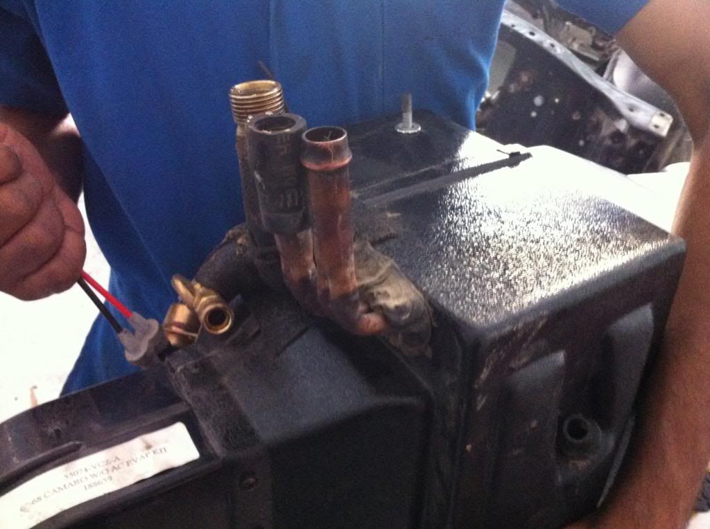

http://i218.photobucket.com/albums/c...psaf925315.jpg
I decided to post a photo of the Vintage Air evaporator to give a better idea of what I am talking about. As shown above, all the the heater lines fittings and #10 line fitting have to go through the firewall in order to connect all the lines. I am not concerned about the heater as the lines were not hooked anyways.
I am going to run the AC lines like I mentioned through the blower hole and the kick panel fresh air opening. Therefore, can I reroute or somehow bend the #10 tube in order to point it towards the kick panel vent?

I'm sure it can be done. I've seen a/c hardlines cut and re-welded to add mandrel bends or specific fittings on them. Just make sure whomever does the welding is good so it doesn't leak or fail. Should be able to cut it on the straight section, add a 90 degree bend and then re-weld the hose fitting back on to aim it at the passenger kick panel and out the firewall.

Jody I really appreciate your input on this matter. I was thinking about having someone to cut and reweld it to aim it to the passenger side kick panel. will give it a try an hopefully it does not leak:D

I thought most units you can disconnect the hard lines and just run hose/AN fitting to them directly.....On my Gen IV, I just left off the hard lines supplied and plumbed everyhting under the fender through the heater fan blower opening and down through the kick panel straight over to the unit..
Are you lines welded directly to the unit ?

The lines were not welded to the unit as shown in the photo. I ordered an extra length hose kit from summit in order to run the hoses through the heater blower hole and everything to be plumbed under the fender.
The only problem is that the #10 from the unit is pointing towards the firewall, which now needs to be cut and rewelded in order to aim towards the passenger side kick panel
