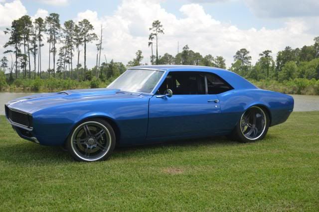

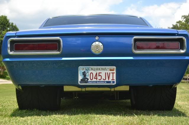

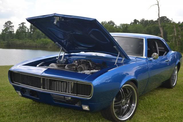

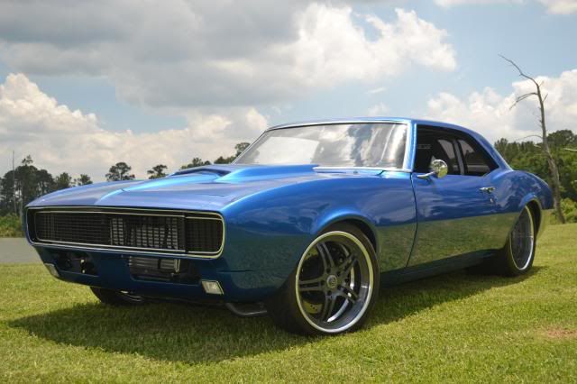

True Forged customer 67 camaro
Here is a customers almost complete build. Still have a few little things to do with the interior and still have to wet sand and buff the car. Here is a little parts break down.
Chris Alston uppers and lower control arms
Varishock coilovers front and rear
CA sway bars
CA 2in drop spindles
CA 600 steering box
CA billet body mounts
Willwood 14" 6piston fronts
Willwood 12.2" 4piston rears
Fab9 Rear
35spline axles
Detroit locker
4.30 gear
2x3 backhalf fully welded to frame
True Forged Victory gunmetal centers w/ matching custom center caps
19x8 fronts
20x15s rear
Motor Setup
stock 5.3
arp bolts thru out
custom spec'd pat g turbo cam
custom turbo kit w/ billet 76mm
built t56
rxt twin disk

To This

What's the backspacing on those steamrollers?

Wow that is MEAN from the rear... 15" wide?! LOL

very nice ride,like the wheels

the BS is 5in:thumbsup:

Those wheels and that car both look amazing. A rear bumper powder coated the same color as the centers would be the bee's knees though IMO

That and a front spoiler would make it perfect.
