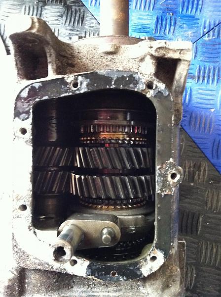

Got A Buddy Who Bought A Chevelle And The Owner Had A Couple Things It Came With. Side Cover #3952648, Tail Housing 3978764, And The Main Case # 3925661 The Trans Is For Sale, We Ran Numbers And Looks Like It Can A Rock Crusher. Can Anyone Help Determine This And Or Is The Only Way To Tell Is To Look At The Gears ?????? You Can Call Or Text 317 385 8484

Try this. The gears look to be the angle of the m22. Does the imput shaft have groves? Aso check the serial number. It should begain with a P and end with a A=m20, B=m21 or C=m22

BODYSHOPMARO 05-29-2013 08:08 PM
Its a rock chrusher
Vortech404 05-29-2013 08:14 PM
well that didn't take long. :thumbsup: That's the one to have
John
TheJDMan 05-30-2013 05:59 PM
Looks like the top mounting tab is broken off.
