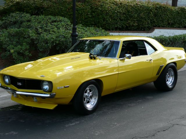

I bought the car from the US about 4 years ago. Long story short bad buy.'
It looked good in the pictures, but we all know how they can lie.
As it was when I bought it.
Attachment 39632

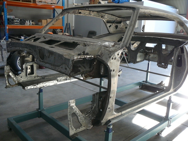

The start of the strip down
Attachment 39633

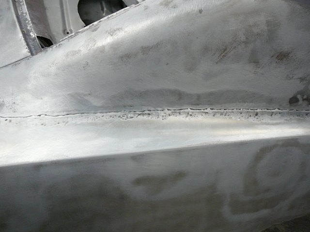

I own blasting company, so we stripped it and look what we found.
Attachment 39634
Attachment 39635
Attachment 39636

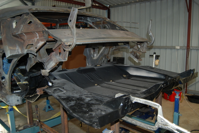

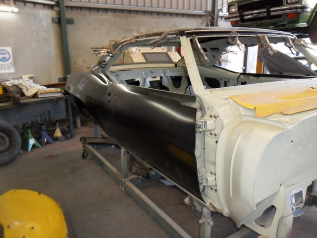

We replaced both quarters, full floor,trunk floor, firewall,roof and both outer wheel wells. I sold of most of the car as I decided to go with a Pro touring setup.
Attachment 39637
Attachment 39638
Attachment 39639
Attachment 39640

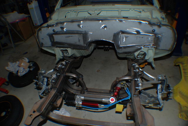

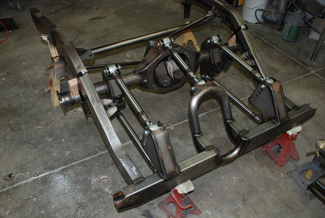

I purchased Art Morrision front and rear clips.
Attachment 39643
Attachment 39641
Attachment 39642

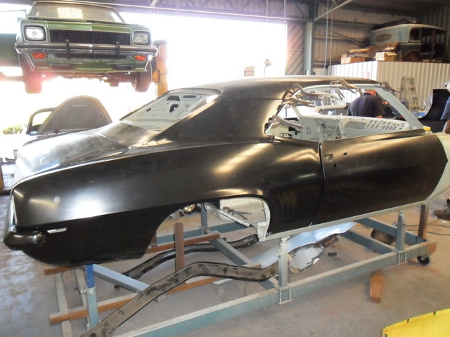

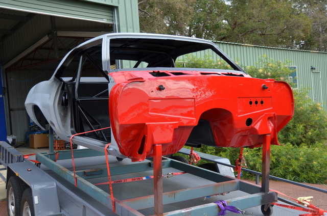

Greg from Aus 06-02-2013 11:28 PM
3 Attachment(s)

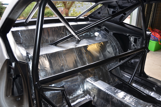

It's been moving along pretty well the last year.
Bringing it home after the firewall, interior and underside where painted.
Attachment 39644
The red is Sting Red, the interior is Matt Black and the underside is Gregorio Silverstone.
Attachment 39645
Attachment 39646
Greg from Aus 06-02-2013 11:36 PM

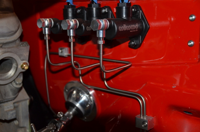

4 Attachment(s)

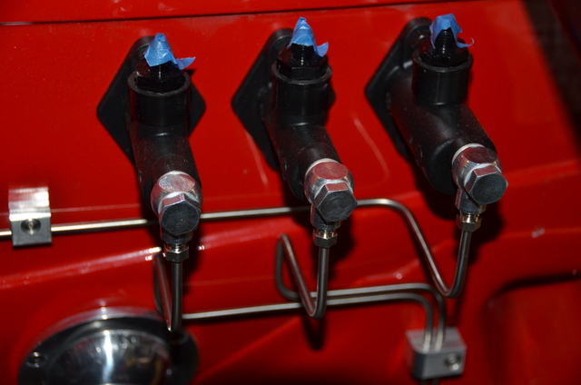

brake lines made.
Attachment 39647
Attachment 39648

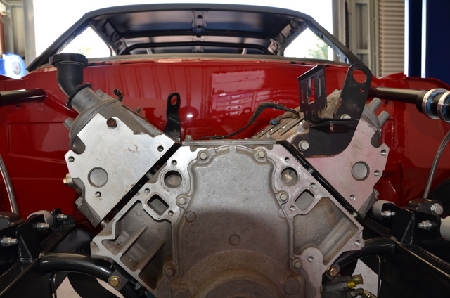

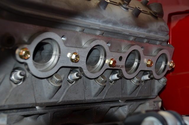

I have set a mock up engine in place, I am running a tall deck RHS block, but I don't have it here yet, so I needed to simulate it by raising the heads of the one I have.
Attachment 39649
Attachment 39650

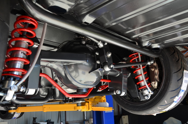

Greg from Aus 06-02-2013 11:45 PM

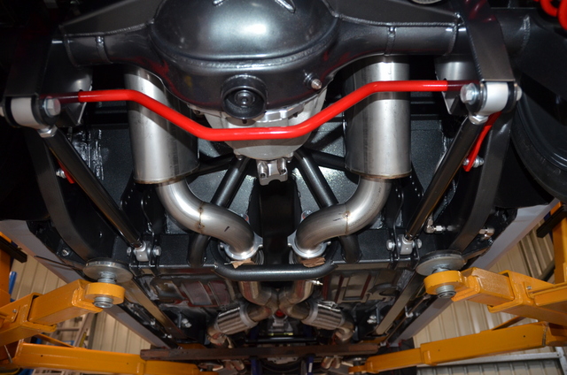

5 Attachment(s)
I have set up the breathers for the diff and fuel tank.
Attachment 39656

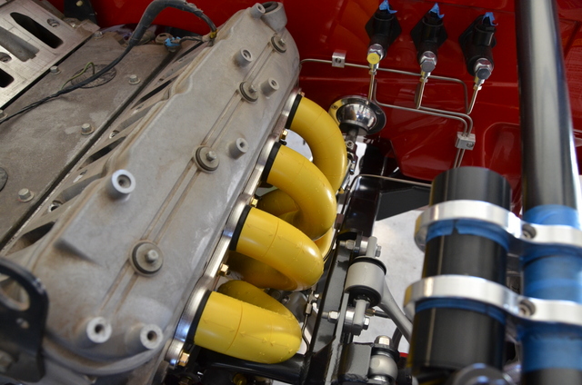

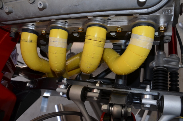

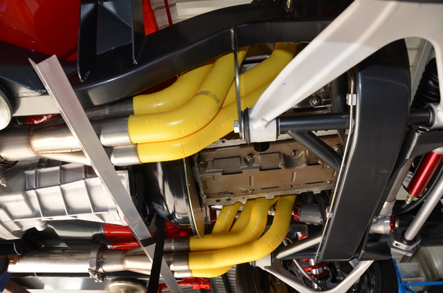

I have been working on the headers and exhaust the last couple of weeks. I have used a header design set by icengineworks, that works great.
Attachment 39652
Attachment 39653
Attachment 39654
Attachment 39655
Greg from Aus 06-02-2013 11:50 PM
4 Attachment(s)

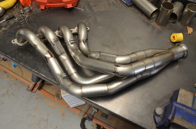

one of the headers all fabbed up.
Attachment 39657

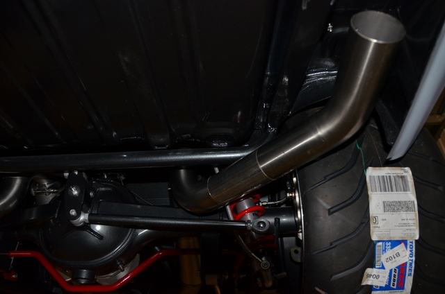

And the exhaust well underway.
Attachment 39658
Attachment 39659
Attachment 39660

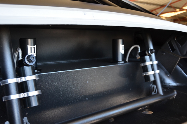

Radiator, coolers, support panel and dry sump tank in place.
Attachment 39661
Attachment 39662
