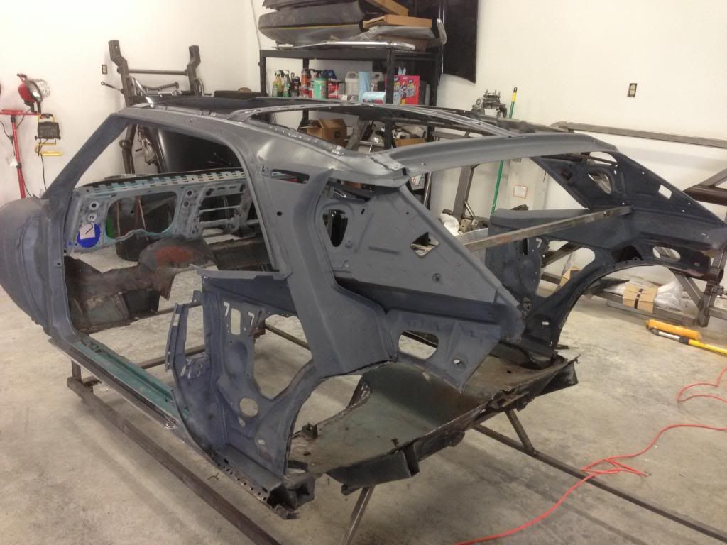

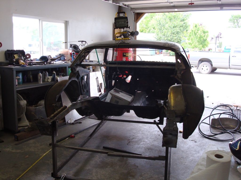

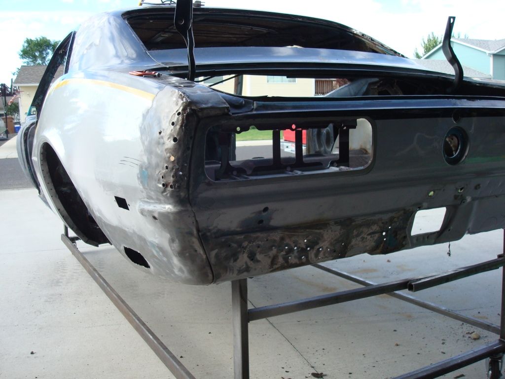

Bringing it home and tearing down. I installed mini tubs and had the hole back of the car bolted together waiting on Jakes rod shop suspension. That didn’t work out, so out came the plasma again to start over!
http://i1122.photobucket.com/albums/...aro/Newcar.jpg
http://i1122.photobucket.com/albums/...aro/drvqtr.jpg
http://i1122.photobucket.com/albums/...o/DSC01553.jpg
http://i1122.photobucket.com/albums/...o/IMG_0139.jpg

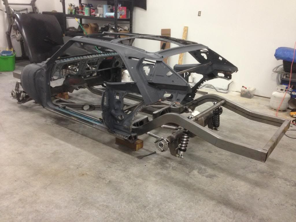

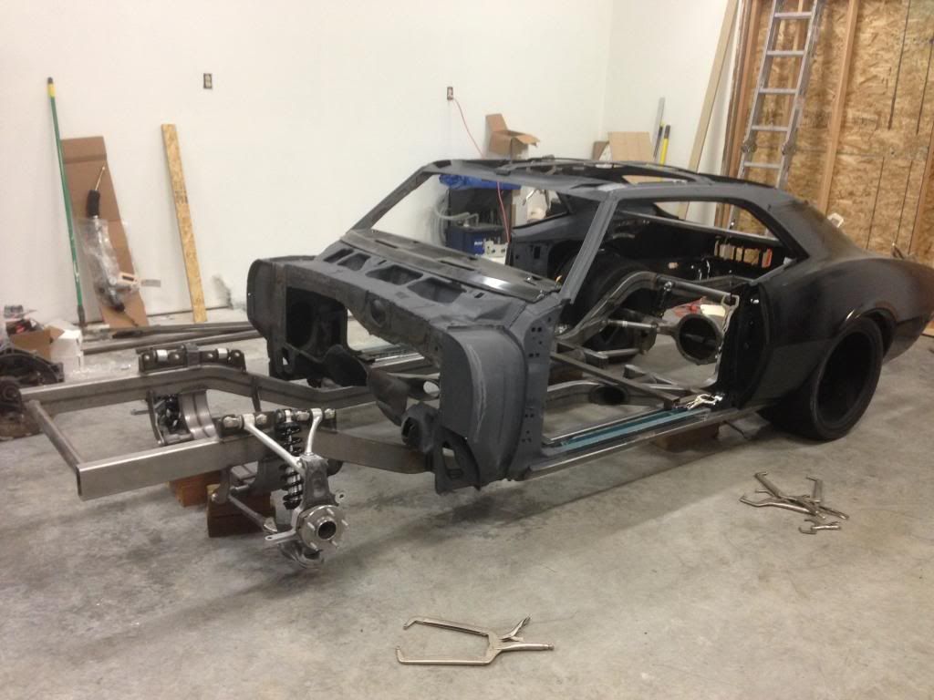

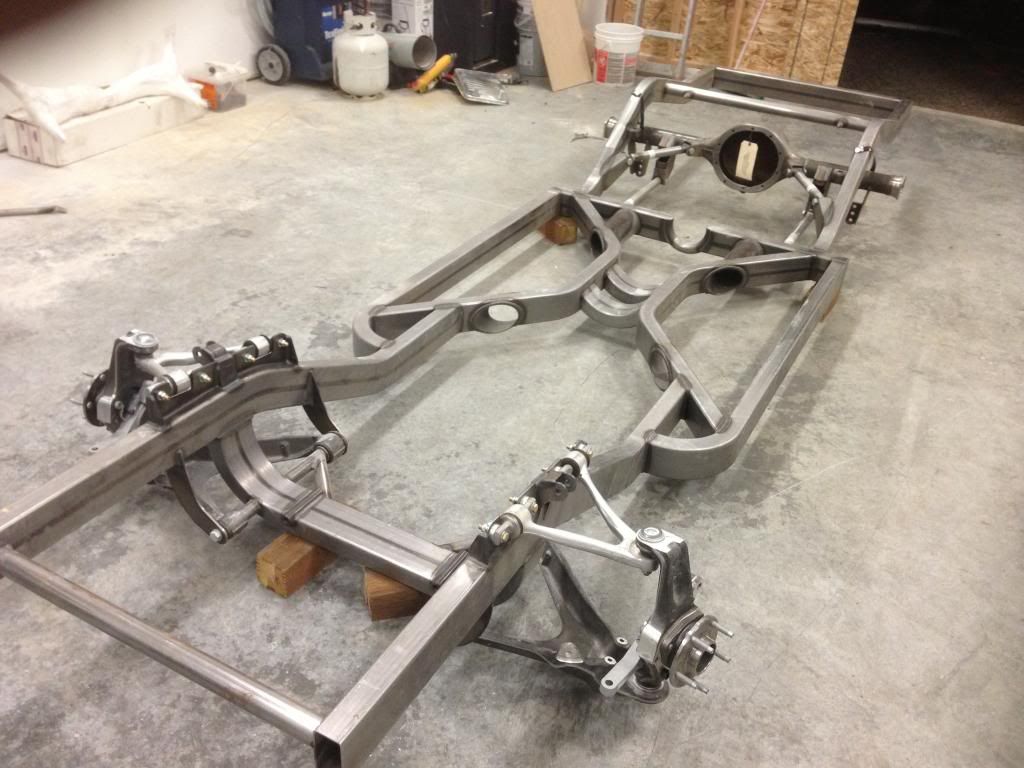

Here it is on the Max-G frame. These things are works of art!
http://i1122.photobucket.com/albums/...o/IMG_0141.jpg
http://i1122.photobucket.com/albums/...o/IMG_0156.jpg
http://i1122.photobucket.com/albums/...o/IMG_0161.jpg
http://i1122.photobucket.com/albums/...o/IMG_0162.jpg

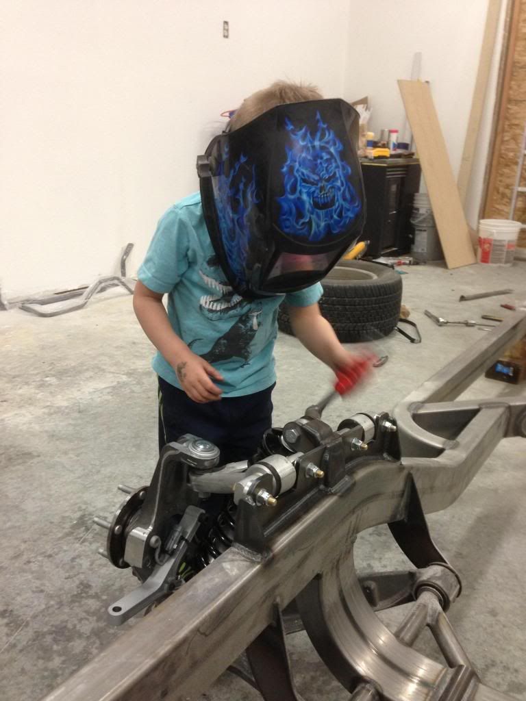

Lil helper getting the front suspension dialed in
http://i1122.photobucket.com/albums/...1694d2a002.jpg

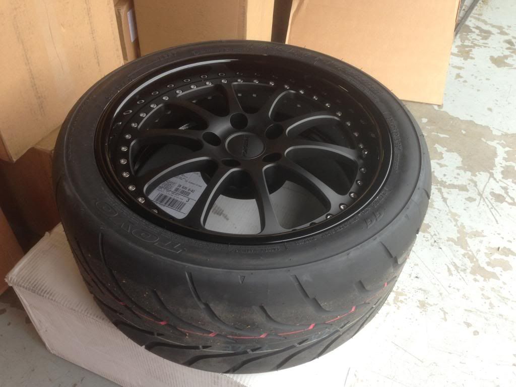

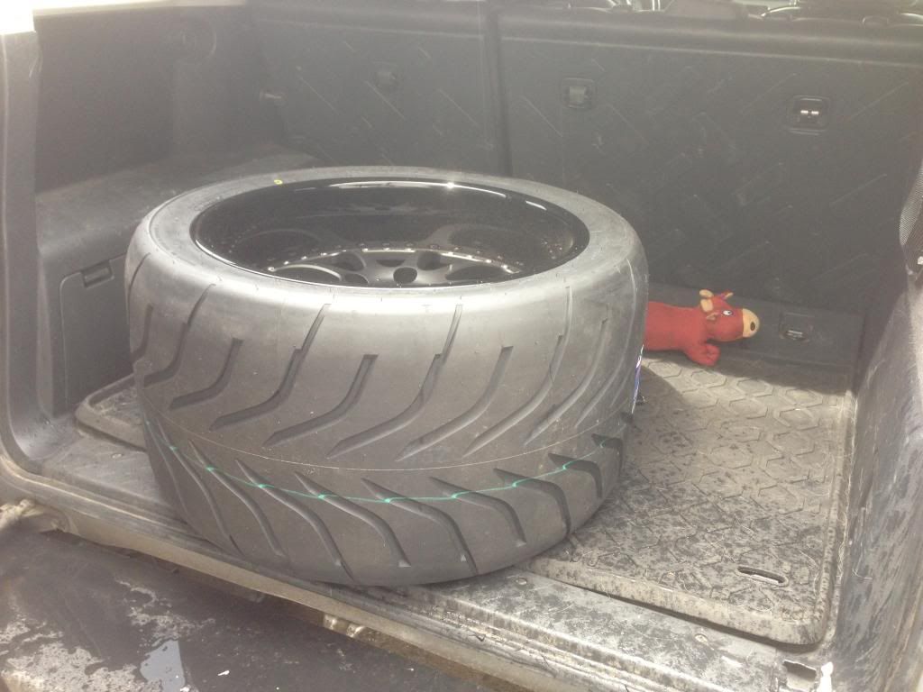

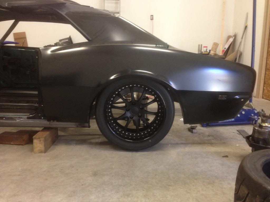

I got as far as I could then ordered these rims and tires so I could finish fitting everything. They turned out way better than I had hoped!
http://i1122.photobucket.com/albums/...o/IMG_0292.jpg
http://i1122.photobucket.com/albums/...o/IMG_0295.jpg
http://i1122.photobucket.com/albums/...o/IMG_0298.jpg
http://i1122.photobucket.com/albums/...o/IMG_0300.jpg

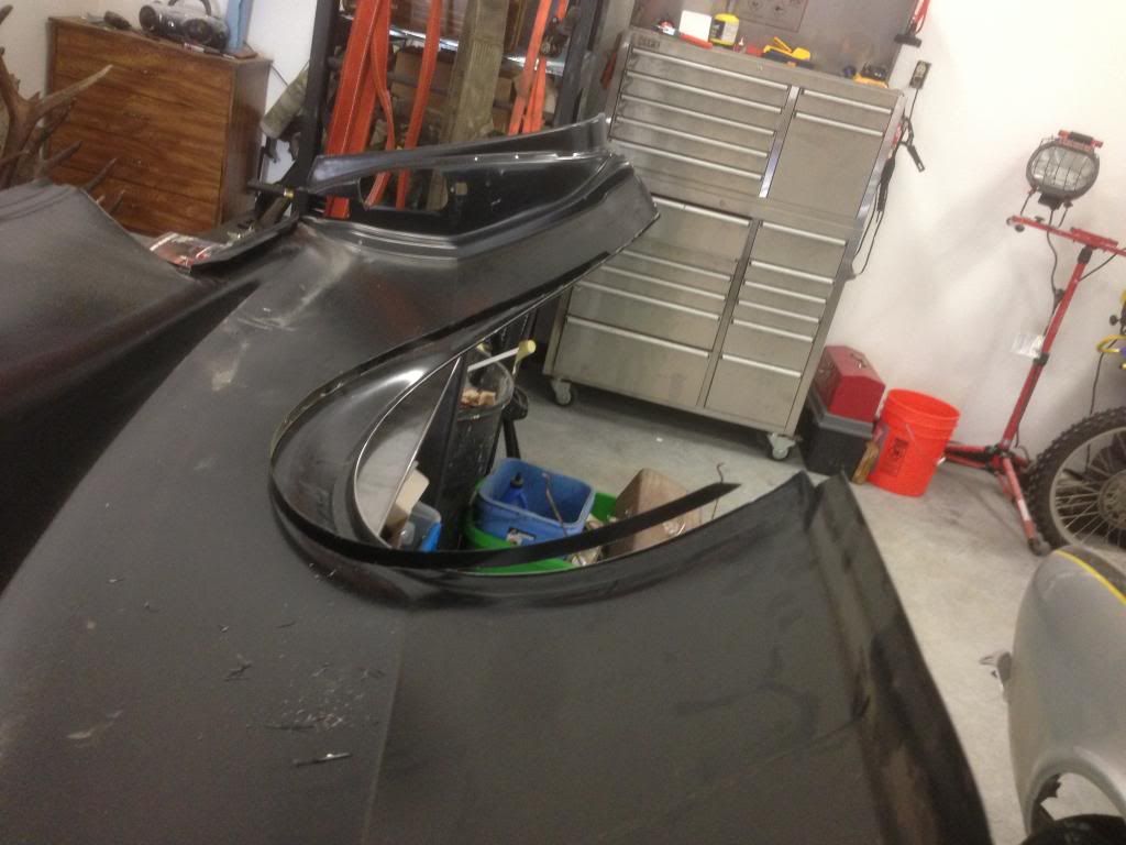

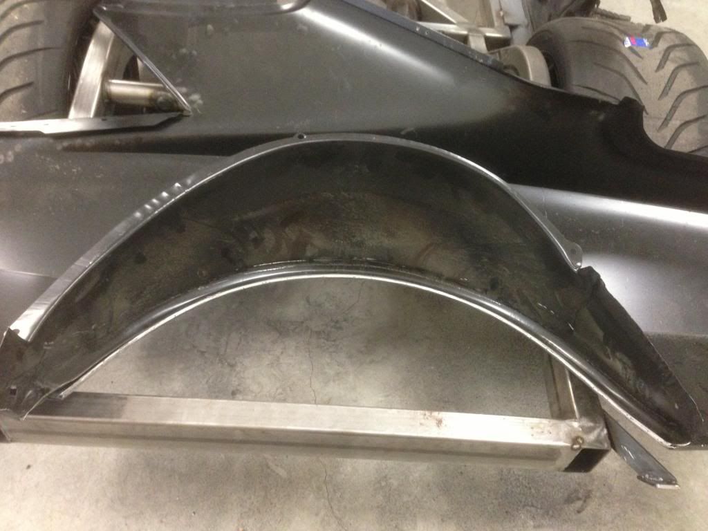

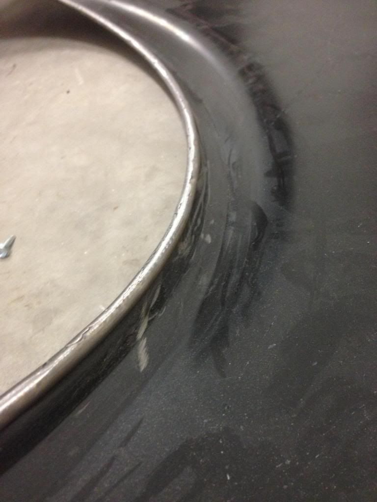

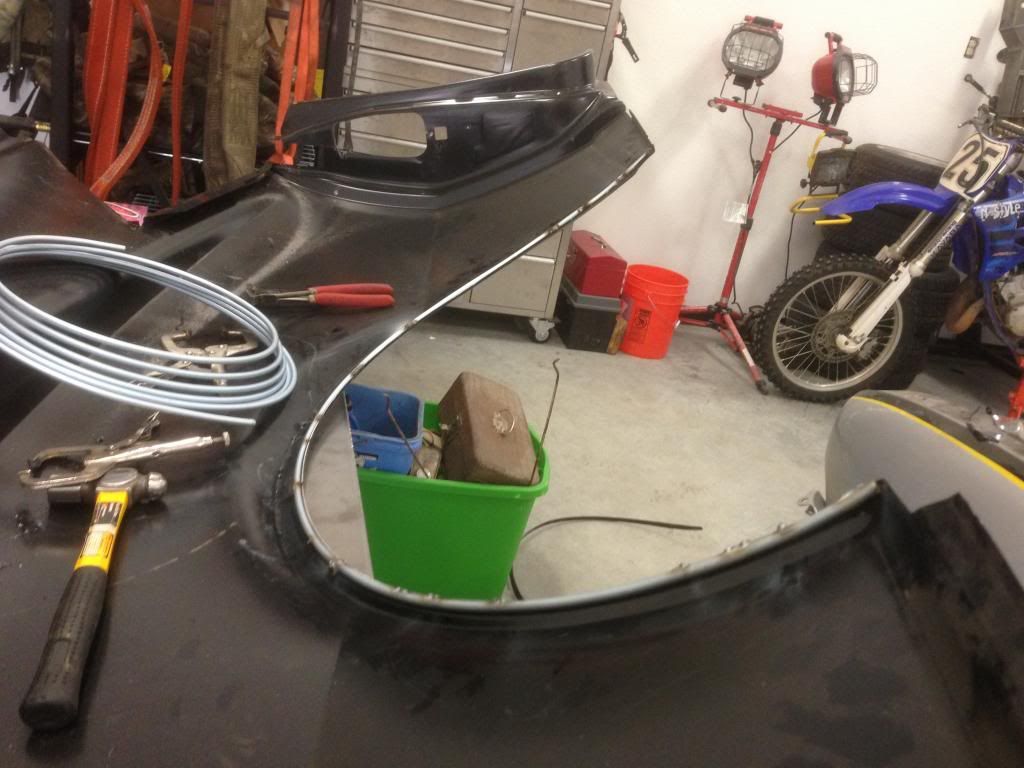

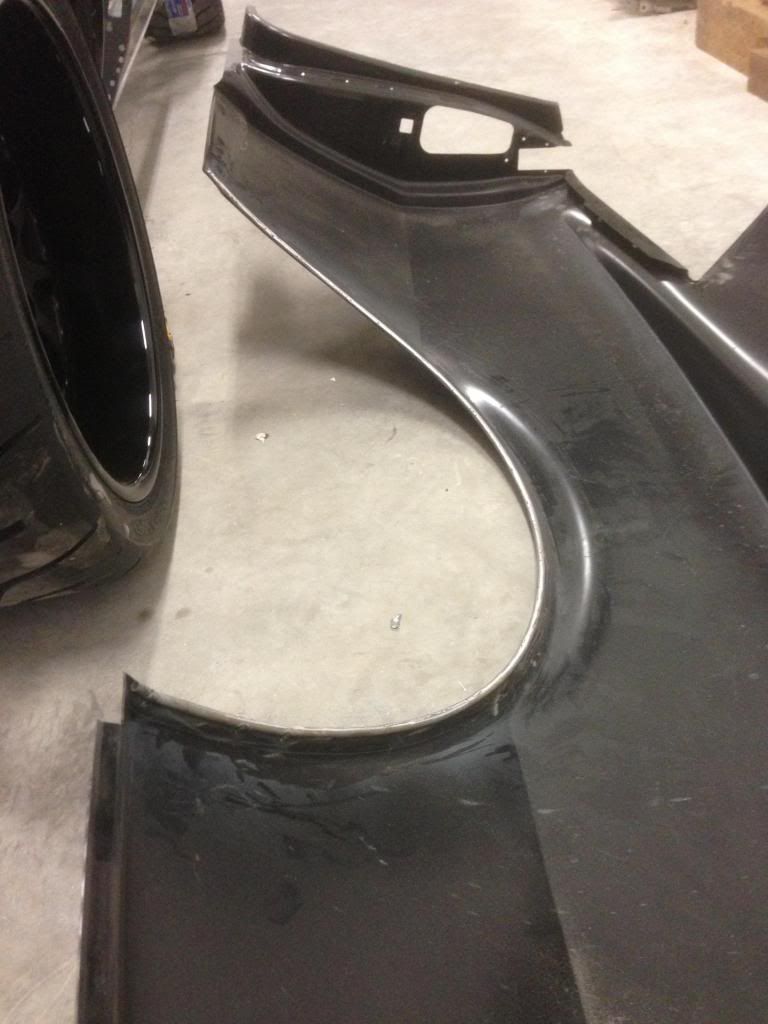

I cut the lip off the wheel well to make extra room for the tires. A friend suggested welding a piece of brake line tubing to the lip to give it that rounded look. It turned out perfect, but took a bit of time. Welding sheet metal is one thing. Welding a tube to it is something else! Cut the outer wheel wells to match.
http://i1122.photobucket.com/albums/...o/IMG_0309.jpg
http://i1122.photobucket.com/albums/...o/IMG_0311.jpg
http://i1122.photobucket.com/albums/...o/IMG_0313.jpg
http://i1122.photobucket.com/albums/...o/IMG_0314.jpg
http://i1122.photobucket.com/albums/...o/IMG_0318.jpg

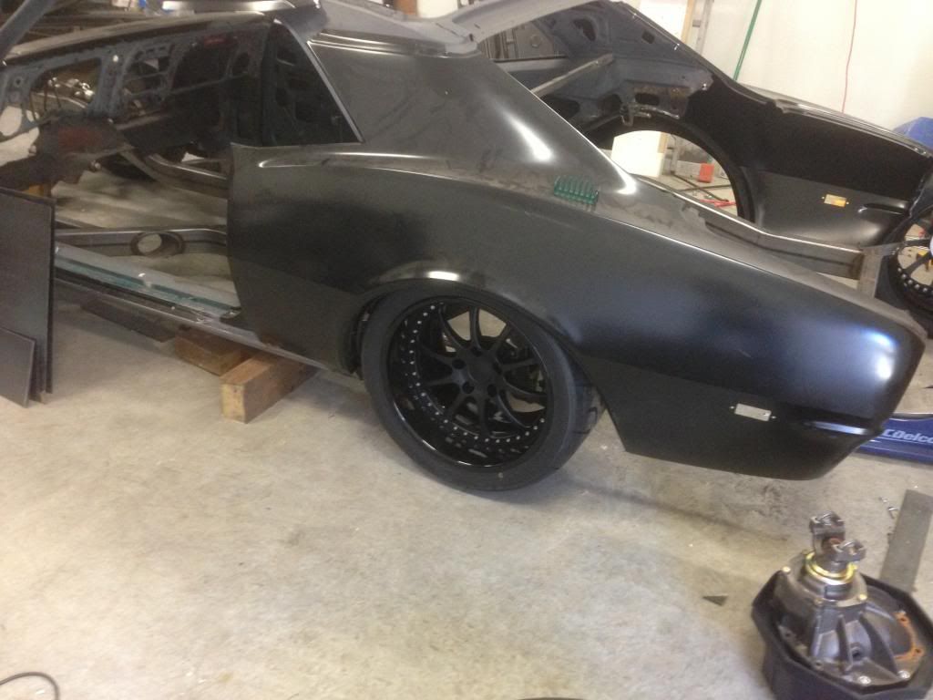

I was able to get the rear bumper brackets made and attach the rear tail pan. I will be fabing all of the internal sheet metal
http://i1122.photobucket.com/albums/...o/IMG_0321.jpg
This week I should have both quarters, tail pan and outer wheel wells on permanently. Seems like I’ve had those quarters off and on a hundred times. I’m excited to weld the suckers on. Then I will start working on the trunk floor and close internal body sheet metal this weekend.

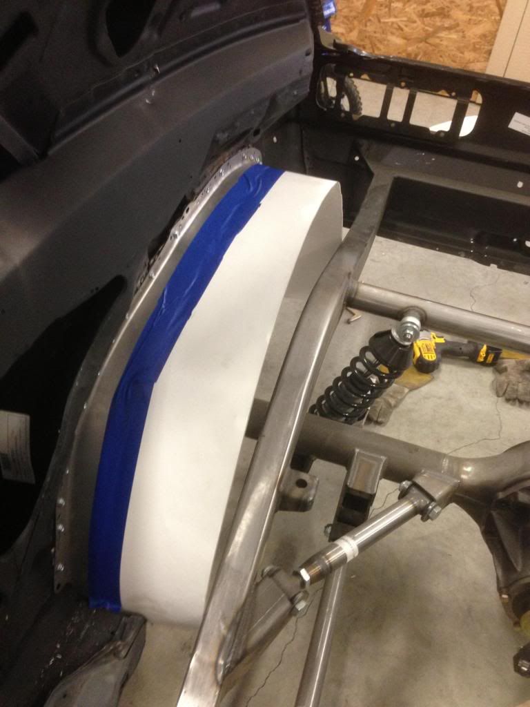

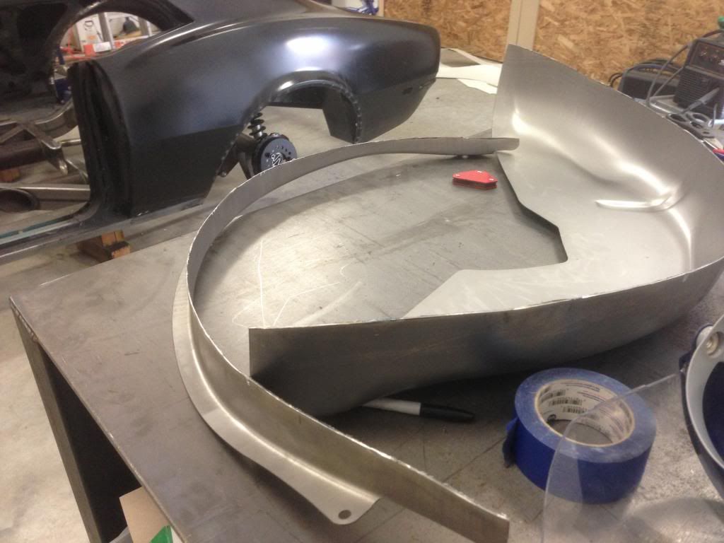

Here are some pics of the inner wheel well.

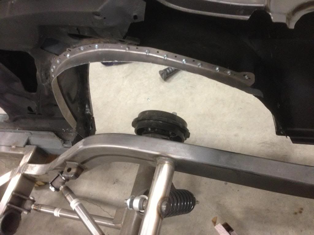

Cut the lip off of a new inner to use it as the base for the custom ones
http://i1122.photobucket.com/albums/...o/IMG_0360.jpg
Punched some holes in it for spot welds and attached where i wanted it to go using sheet metal screws. The screws hold things very tight and are fast to install. I prefer them over anything else.
http://i1122.photobucket.com/albums/...0c53a2325f.jpg
Made a pattern and then the real deal!
http://i1122.photobucket.com/albums/...c362e4211e.jpg
Finished inner wells.
http://i1122.photobucket.com/albums/...962db99f05.jpg
http://i1122.photobucket.com/albums/...o/IMG_0393.jpg

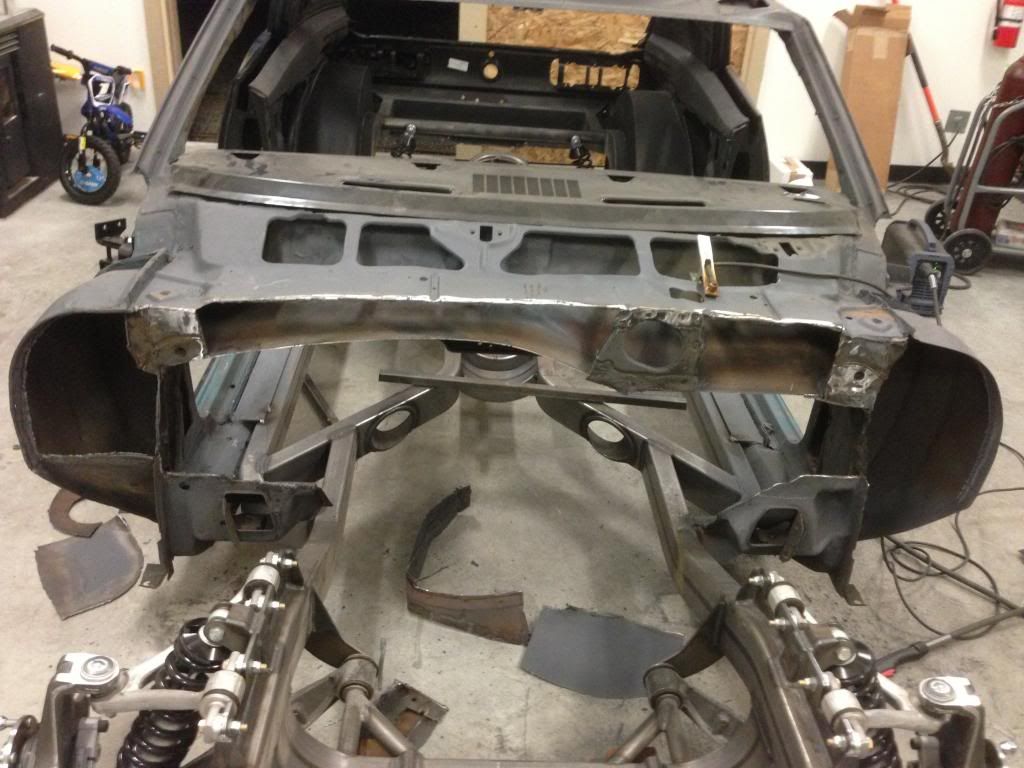

Next week the Whipple charger and some other goodies from texas speed will be here. seats, pedals and almost everything else has arrived so i can make some progress! Still trying to decide if i want to move the wiper motor under the fender or not. The LS3 is here so i cut out the remainder of the firewall to set the motor in and start making a new one.
