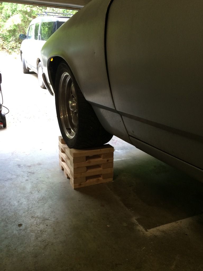

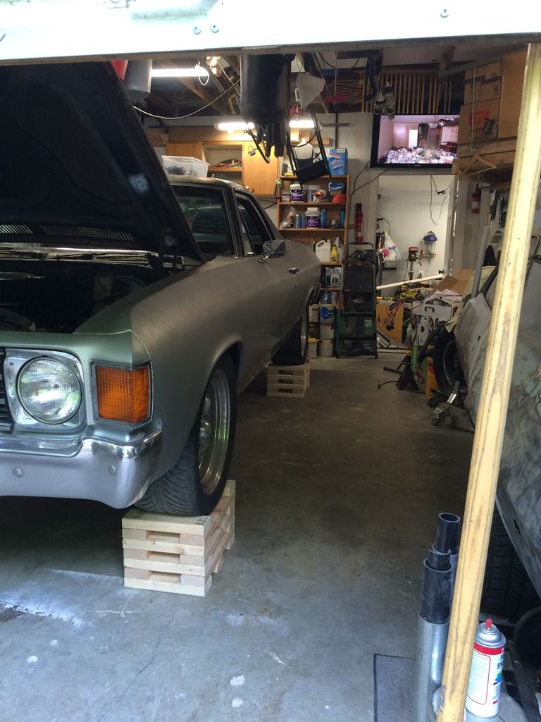

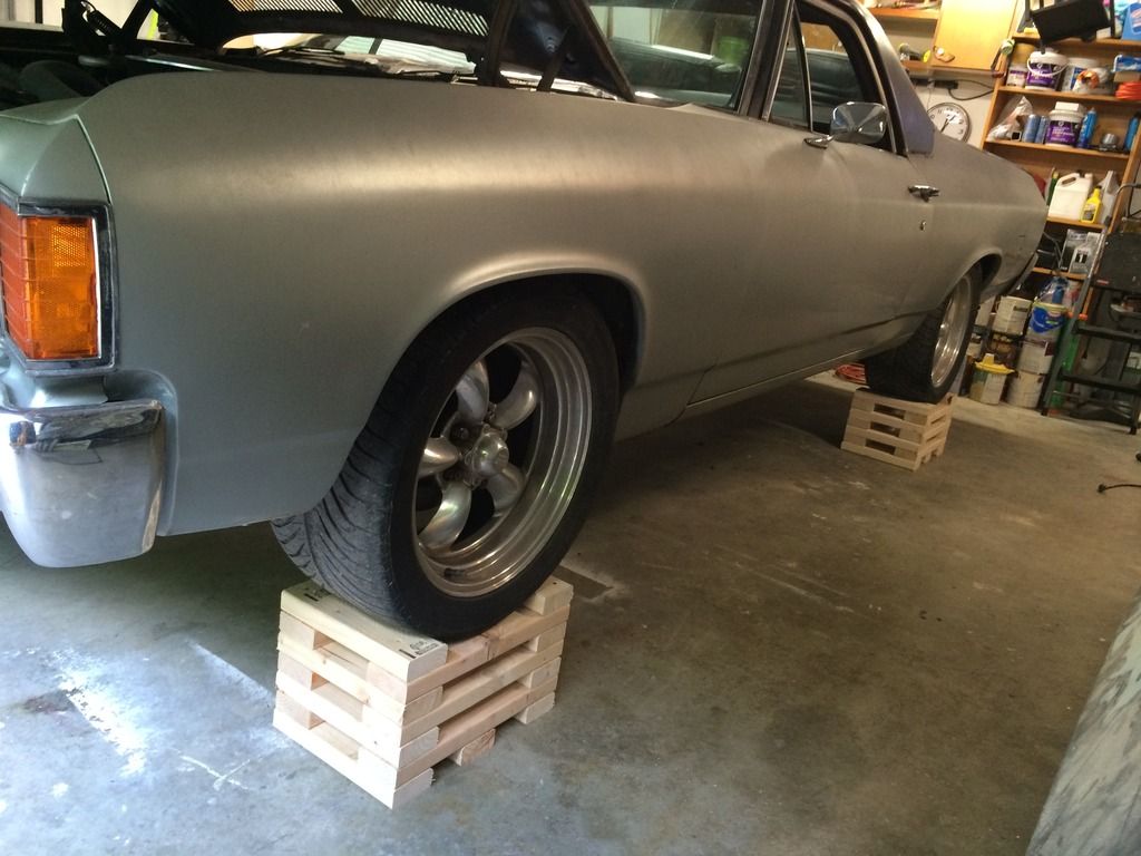

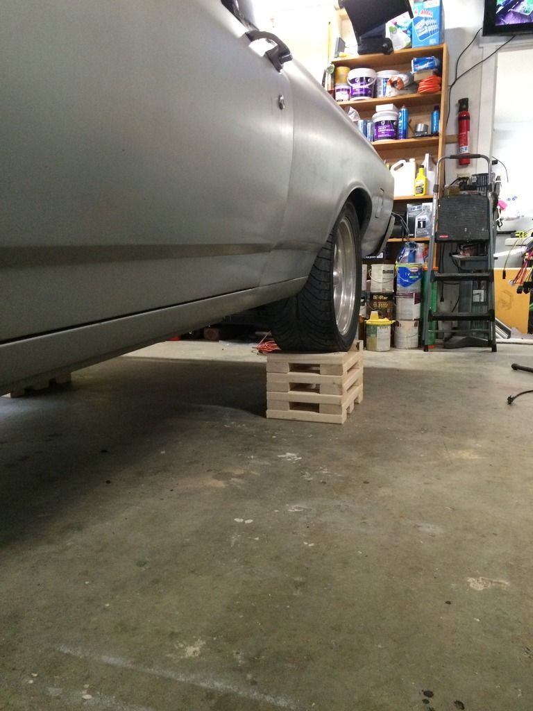

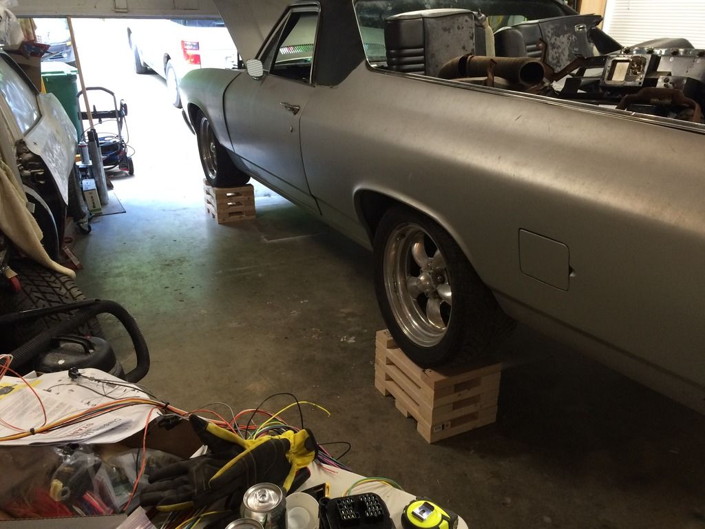

alvin3a 05-23-2016 09:39 AM
Built these this weekend 17"x12" screwed together cost me about $45 and took about a 1/2 hr for each one. Which seemed like a long time but it was a lot of screws
Alan
http://i1376.photobucket.com/albums/...psaewmqhcd.jpg
http://i1376.photobucket.com/albums/...pspqgwwpmv.jpg
http://i1376.photobucket.com/albums/...pspdjtnyib.jpg
http://i1376.photobucket.com/albums/...psf9ep51qi.jpg
http://i1376.photobucket.com/albums/...pslhoceekt.jpg

NorCal72 05-23-2016 09:02 PM
2x4 stands
2 Attachment(s)
I went 16x12 i believe. I went just high enough where my big floor jack could get to the bottom of the housing. Stable as can be. No clue why the pics are upside down.....Buy a Mac they said.....
