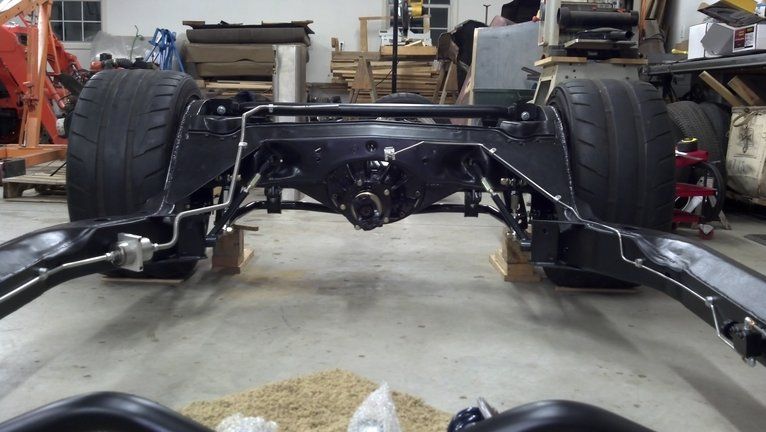

Pics, took this the other night:
http://i1207.photobucket.com/albums/...ps16923291.jpg
Here is what it looked like before I blew it back apart to nut and bolt everything:
http://i1207.photobucket.com/albums/...7414571653.jpg
Some of the motor/trans (basic LS1 rebuild, small cam, intake, Holley HP)
http://i1207.photobucket.com/albums/...1216940217.jpg

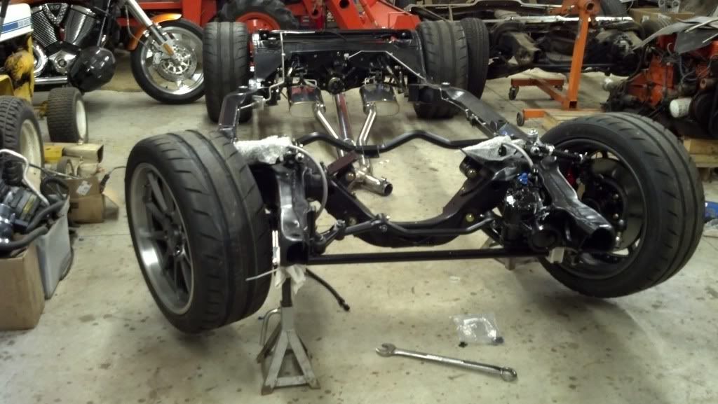

Some more of it on the chassis:
http://i1207.photobucket.com/albums/...7355031647.jpg
Sitting a bit high, but I'll take care of that :whenitsdone:
http://i1207.photobucket.com/albums/...7355024048.jpg
I'll post up some pics of parts that I made next.
Let me know what you guys think!

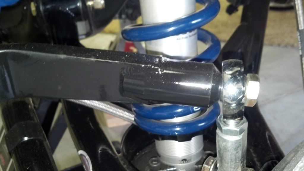

Splined sway bar arms:
http://i1207.photobucket.com/albums/...ps74d34d68.jpg

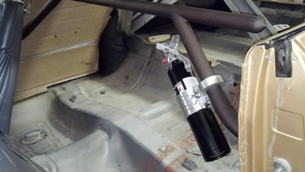

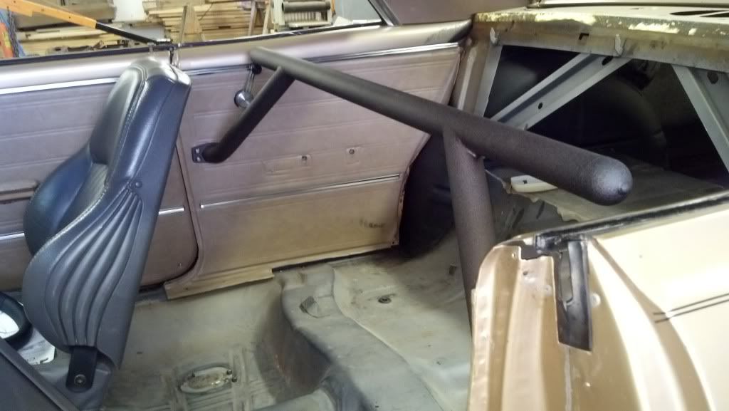

Bar ends for the harness bar (:whistling:)
http://i1207.photobucket.com/albums/...ps5486269b.jpg
http://i1207.photobucket.com/albums/...ps87c5e20d.jpg
http://i1207.photobucket.com/albums/...ps13f22226.jpg

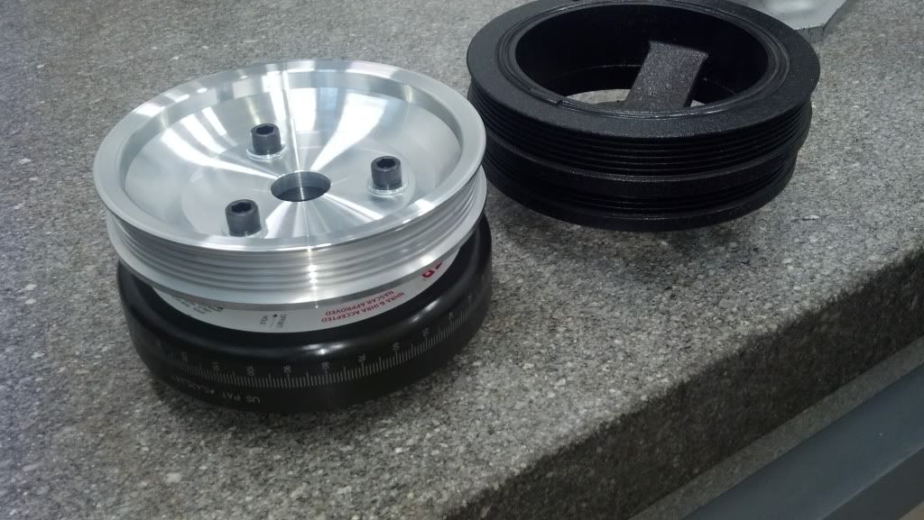

Custom front accessory drive brackets, more on this later
http://i1207.photobucket.com/albums/...2054962846.jpg
http://i1207.photobucket.com/albums/...psfaa92d62.jpg
