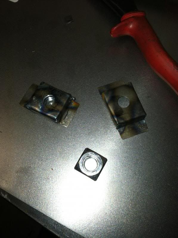

Guys, thanks for the replies. I've been working on the honey doo list and only getting time in the garage while it rains. Here is what I made and where is goes. I finally got the mig in far enough to get some sort of weld on it. It is holding. I've got to do the other side tomorrow.

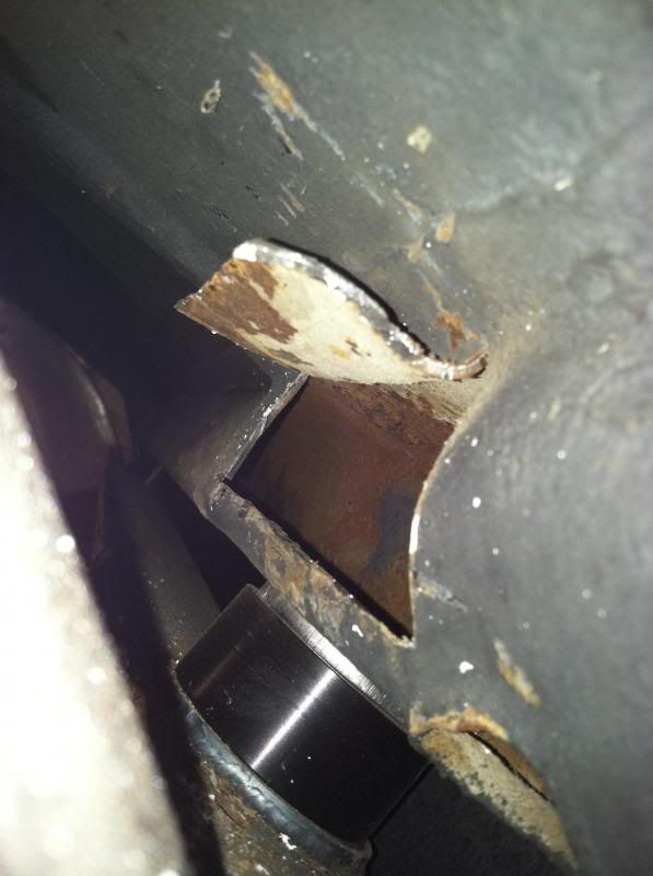

It's going in here. This is the channel under the body where the crossmember for the upper control arms mount.
http://i115.photobucket.com/albums/n...psf79e5829.jpg
HEEP
