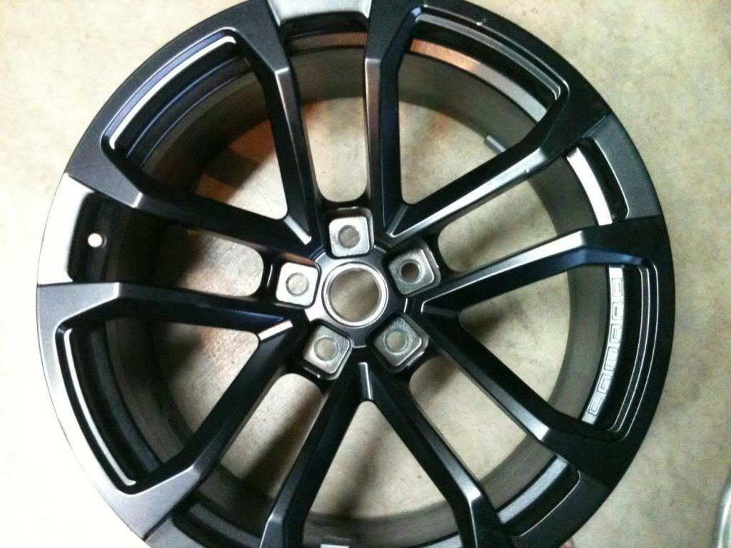

Bryan O 07-06-2013 05:57 AM
I don't think those are ZL1 wheels. Here's a pic of the ZL1 wheels:
http://i29.photobucket.com/albums/c2...1349182109.jpg
