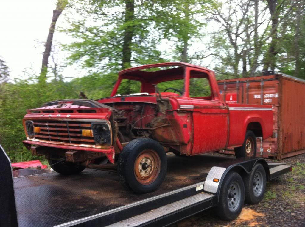

This is how the truck looked after sitting since the early 80's...it was loaded up and ready for delivery.

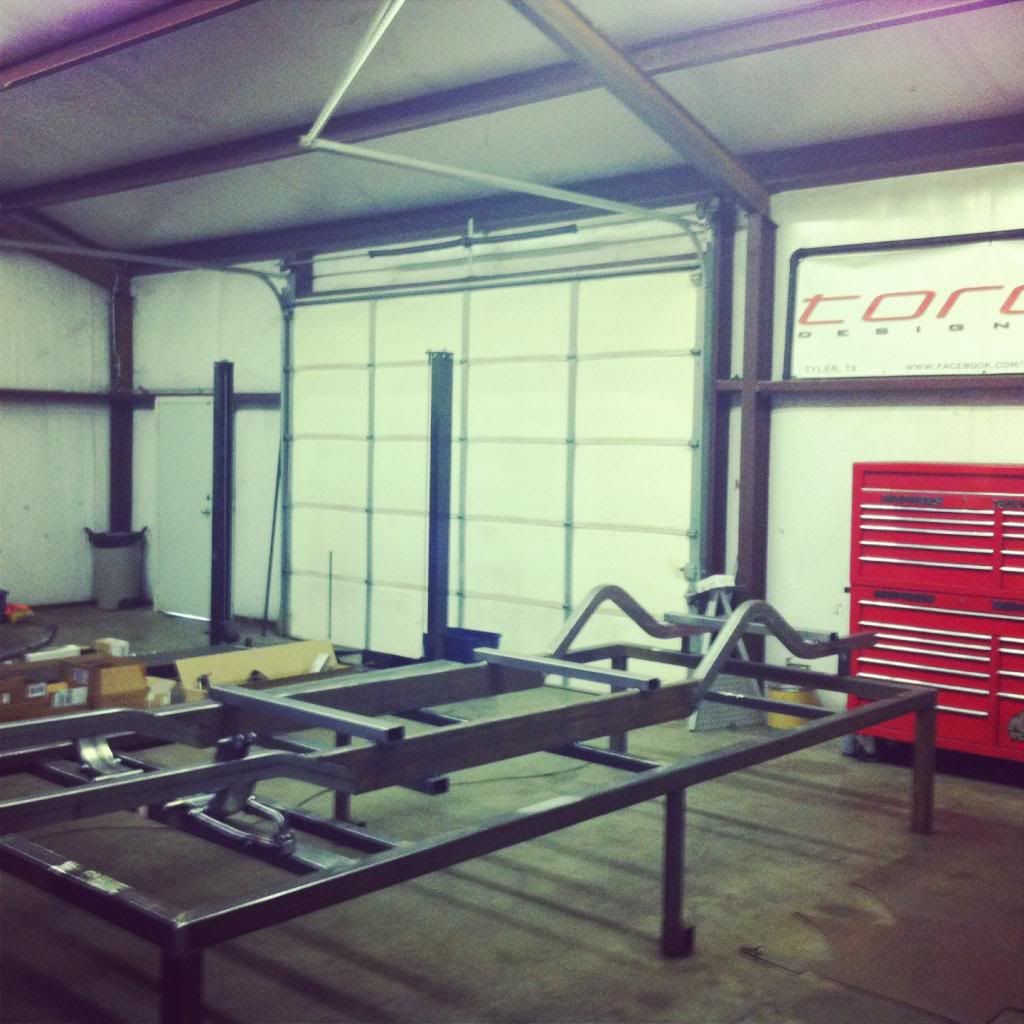

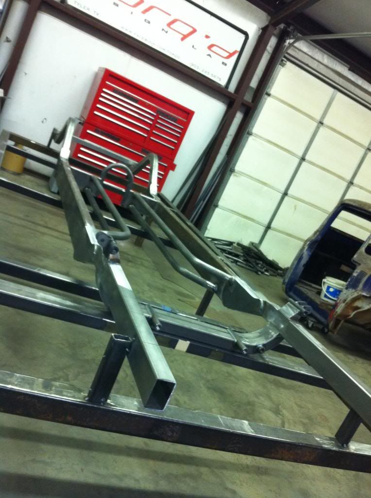

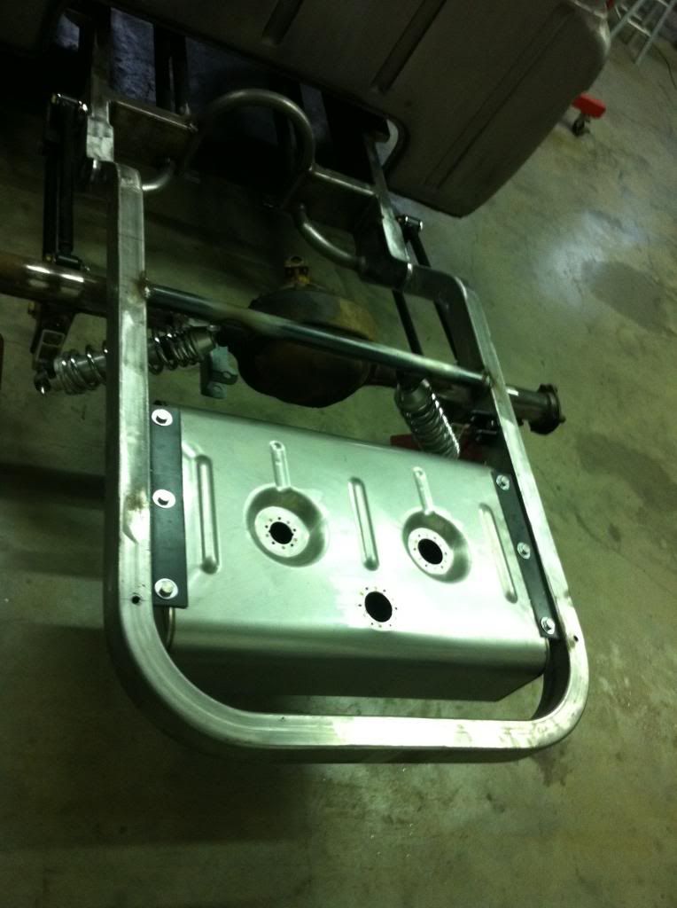

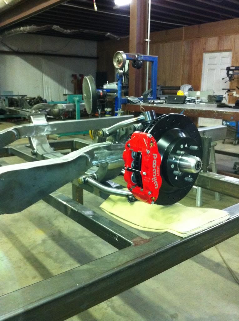

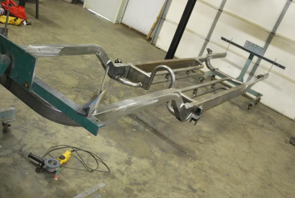

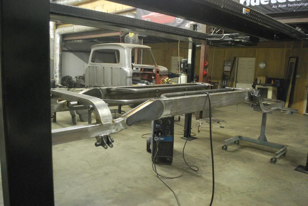

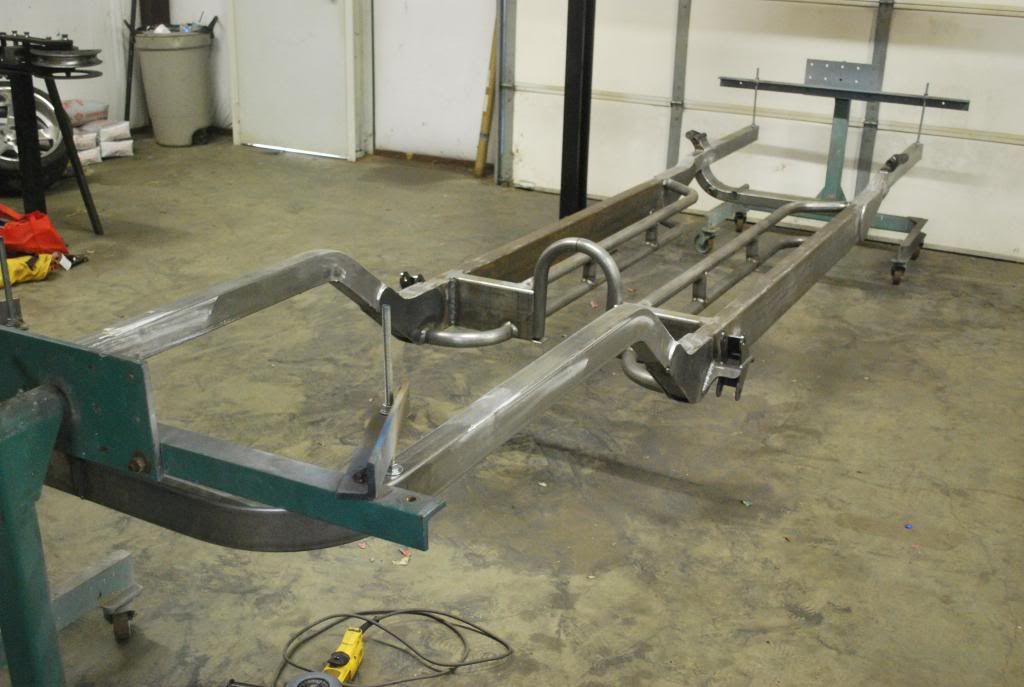

We are going to change a lot more modern but still keep it pro-touring/resto-mod. A lot of the sheetmetal changes will be with the bed.

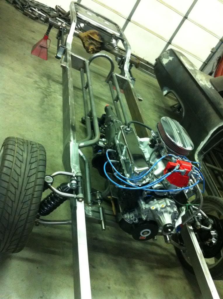

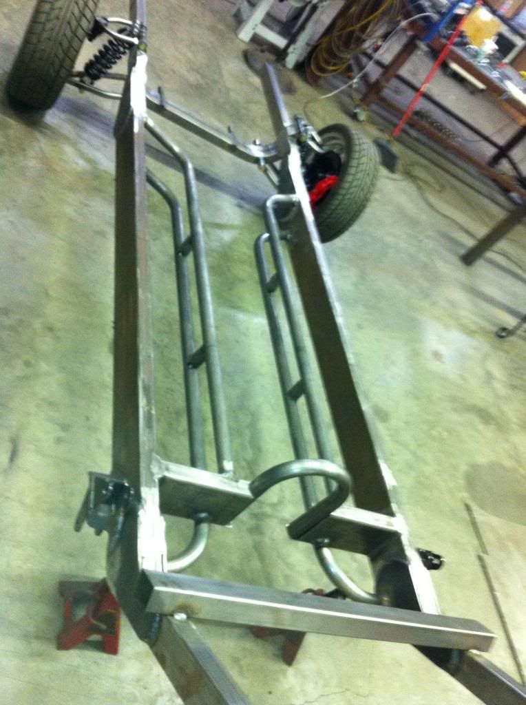

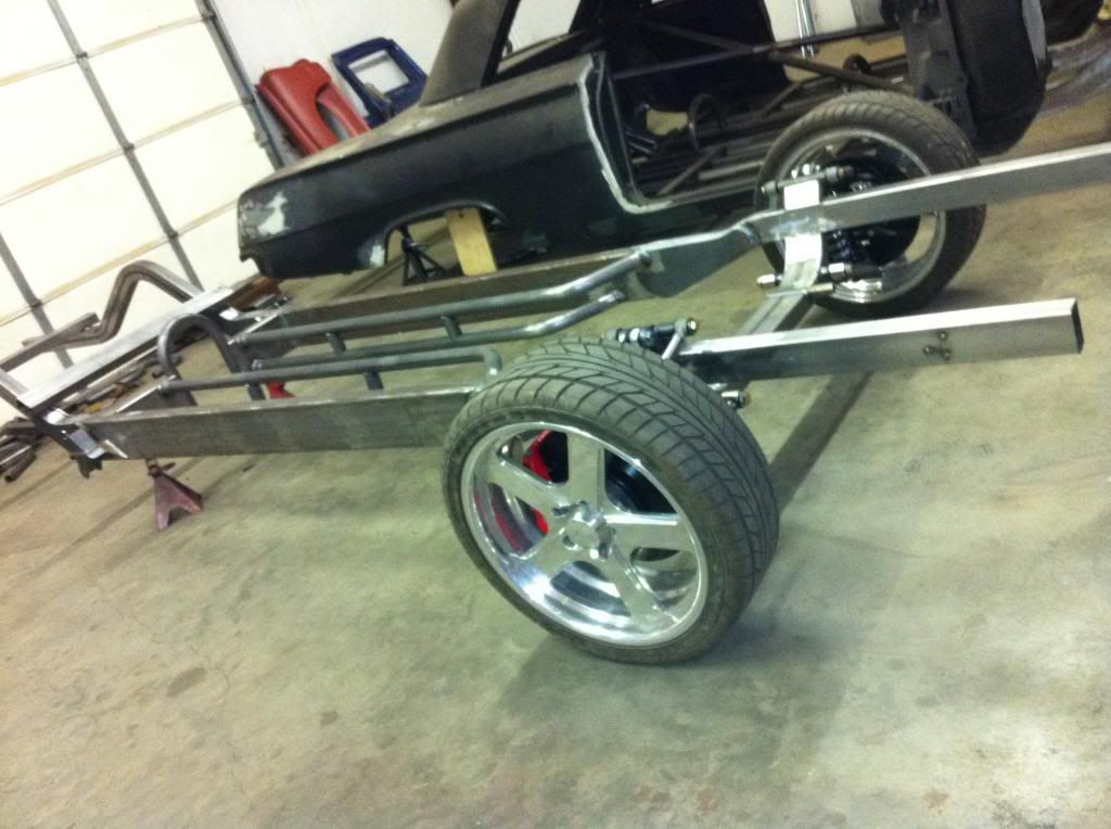

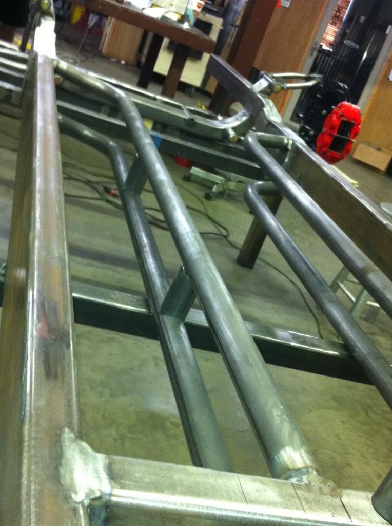

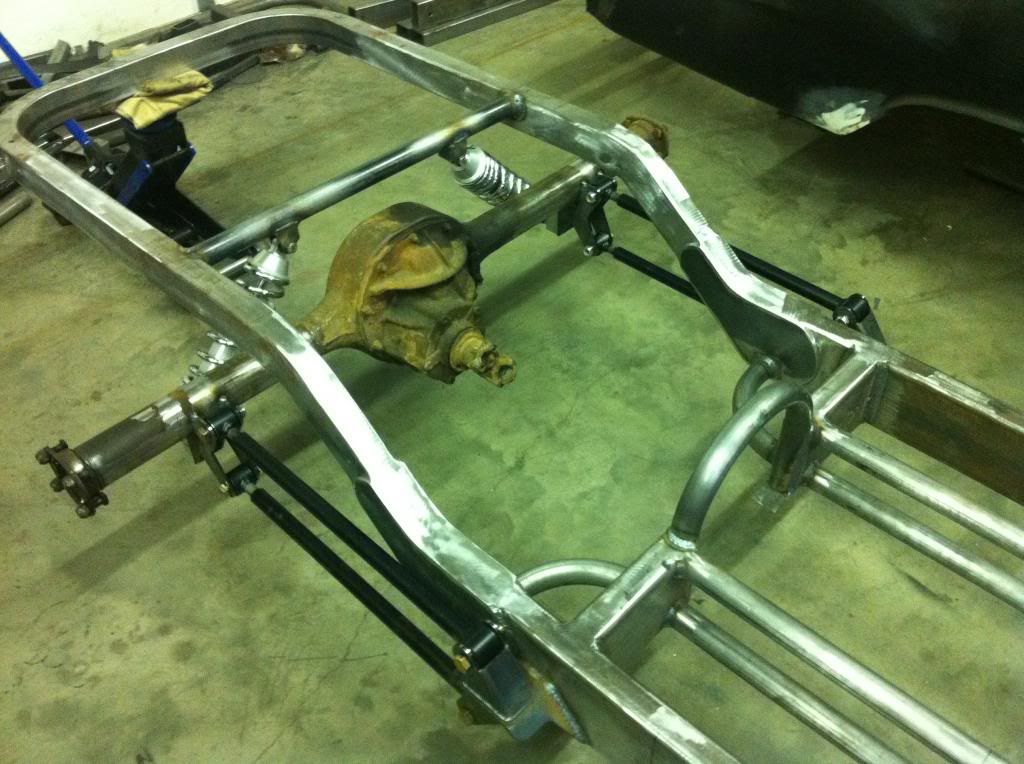

We have almost completed building and metal finishing a custom chassis for the truck, and it will have a Ford 347ci engine with a C6 trans.

Any details on the 347? AFR or TW heads? EFI or Carbed?
How about an AOD with a Lentech valvebody instead of the C6:D

The owner had the 347 ( I think its around a 400 hp dyno'd engine)built so I will have to check the specs on it. It is a carbed engine right now but we will probably be changing it over to EFI in the end. The owner had a new C6 so he chose to use this as well.

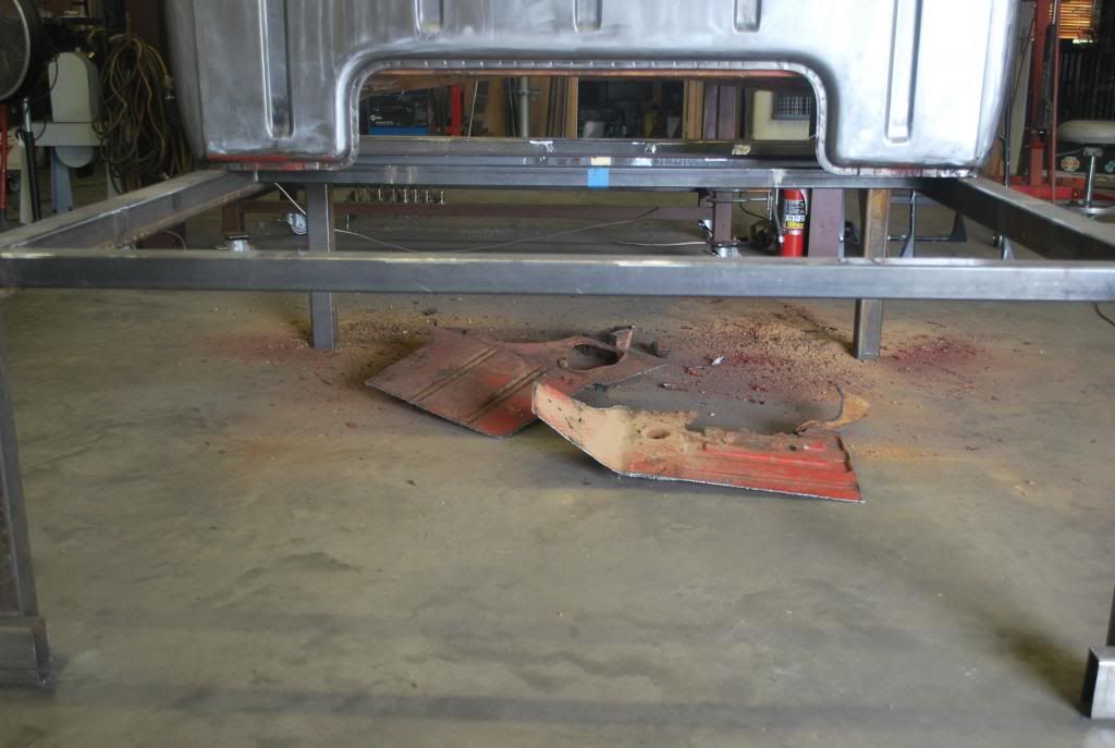

Torq'd Design Lab 07-11-2013 06:51 AM

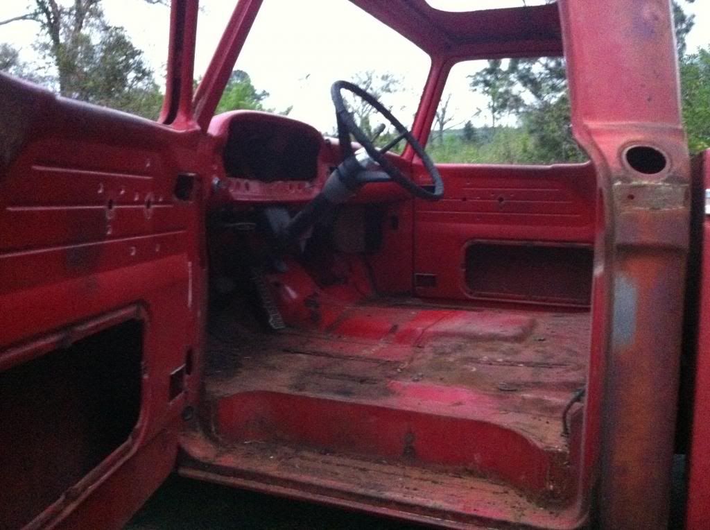

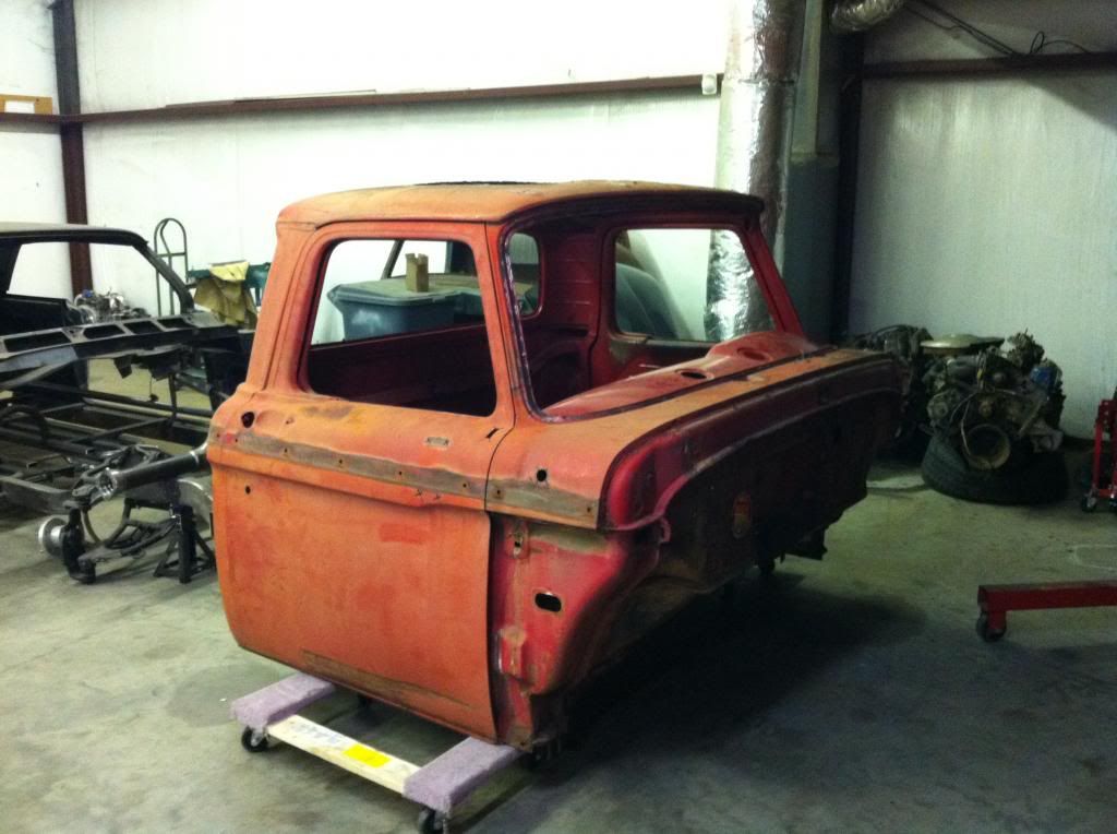

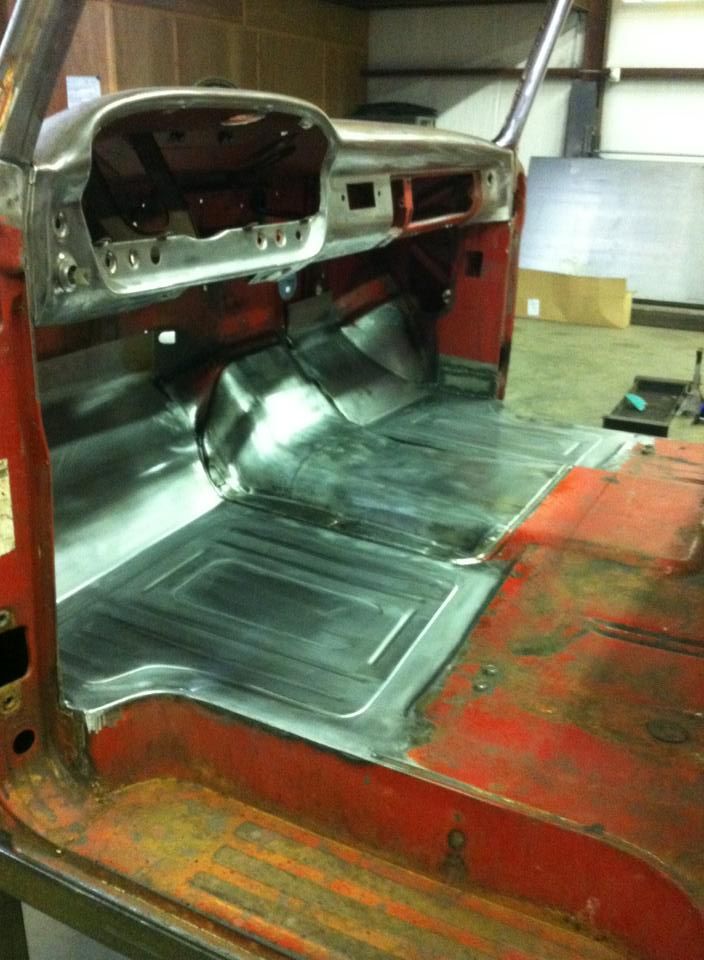

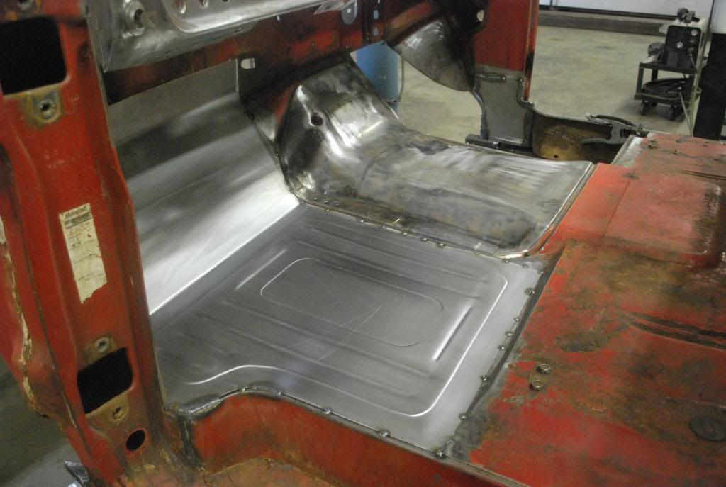

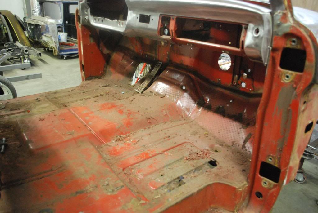

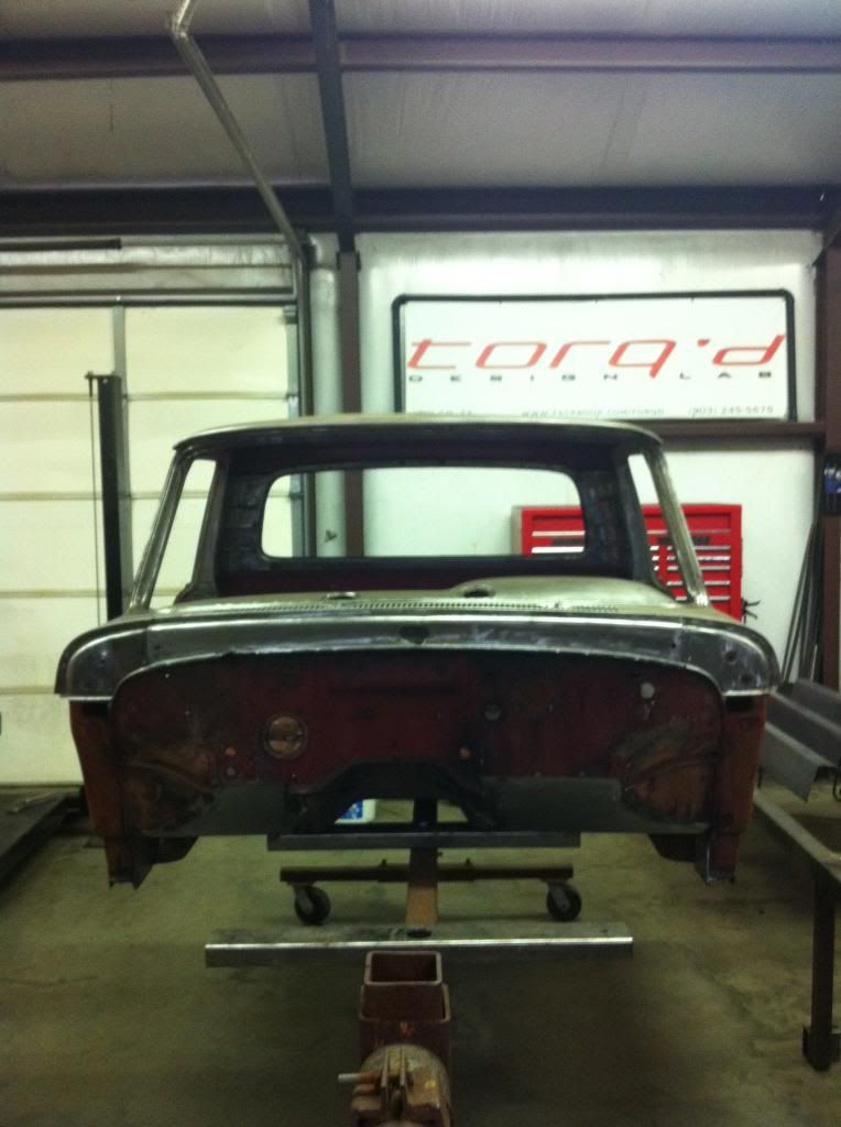

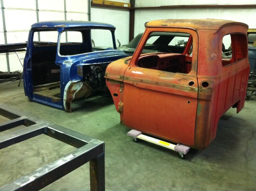

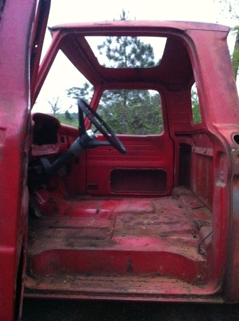

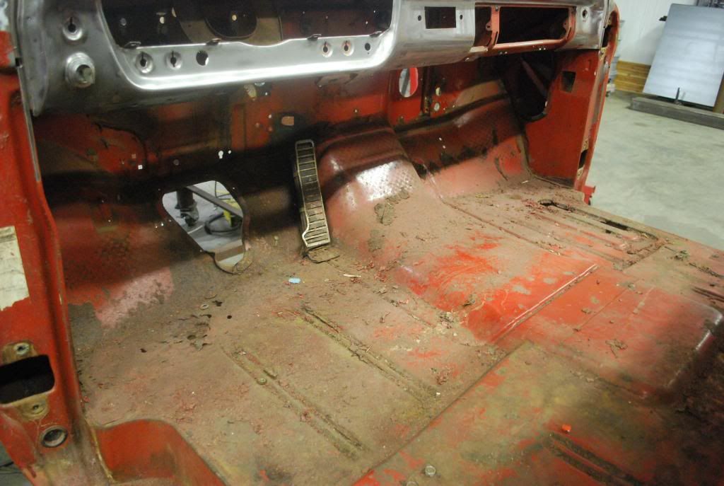

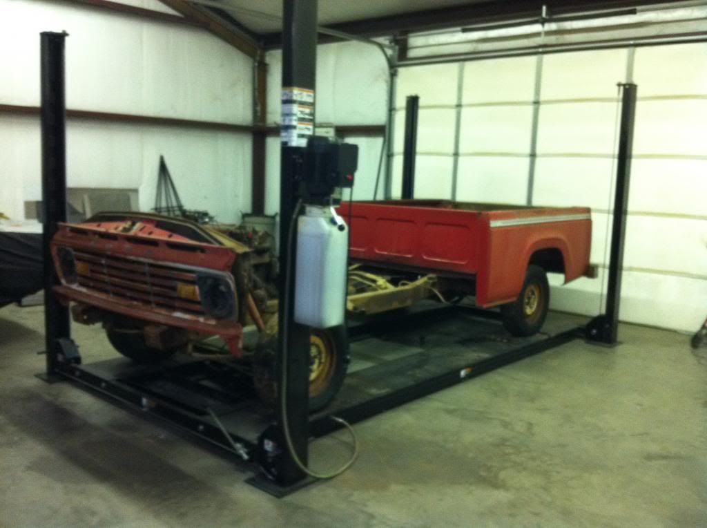

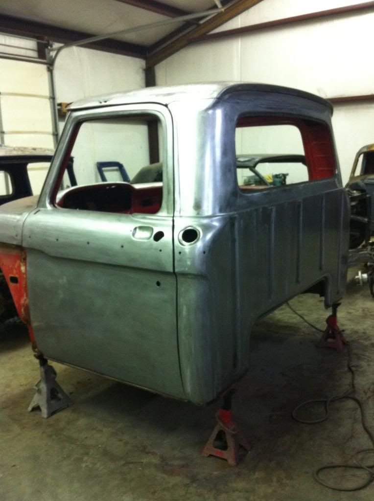

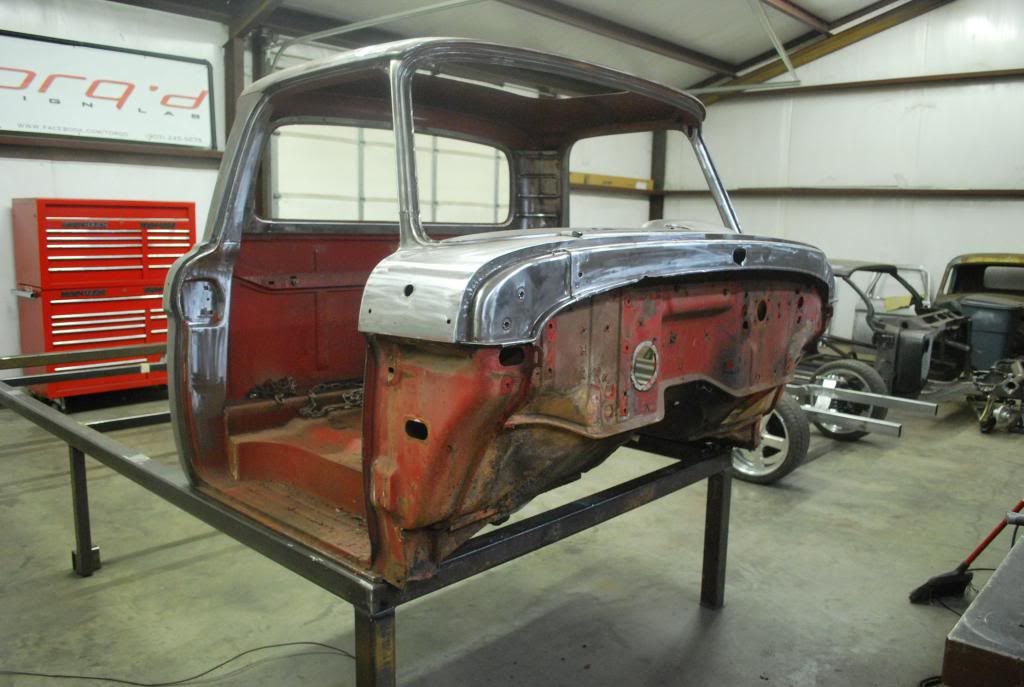

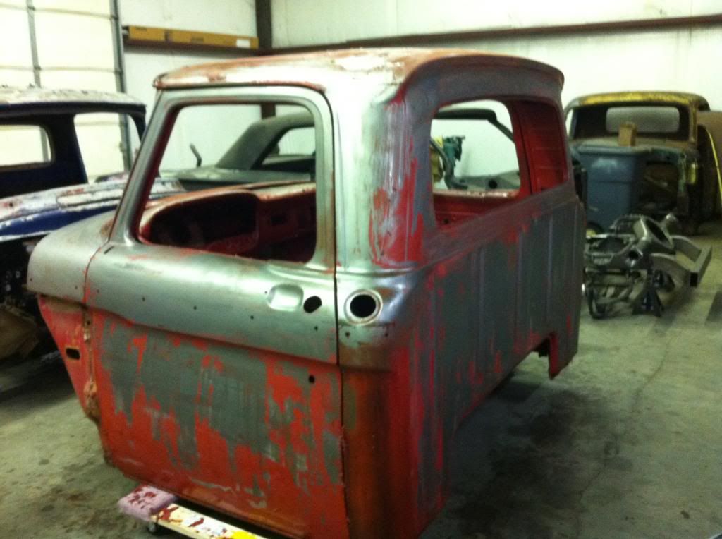

Starting the disassembly -
http://i1301.photobucket.com/albums/...ps64468074.jpg
http://i1301.photobucket.com/albums/...ps1dd75bc6.jpg
http://i1301.photobucket.com/albums/...ps3b323a62.jpg

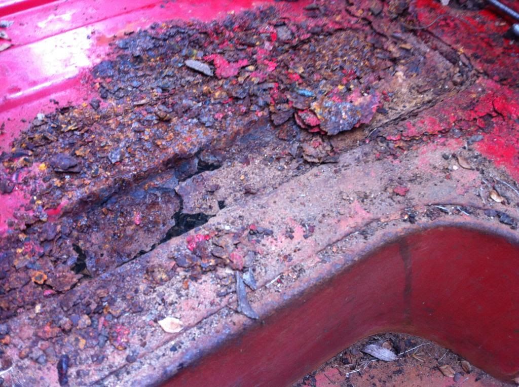

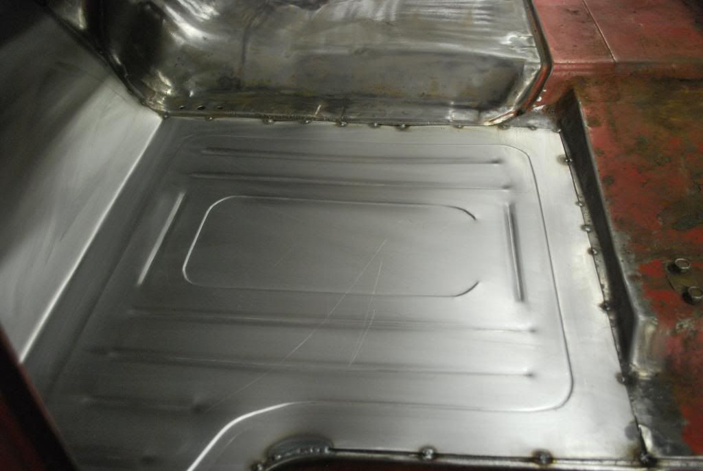

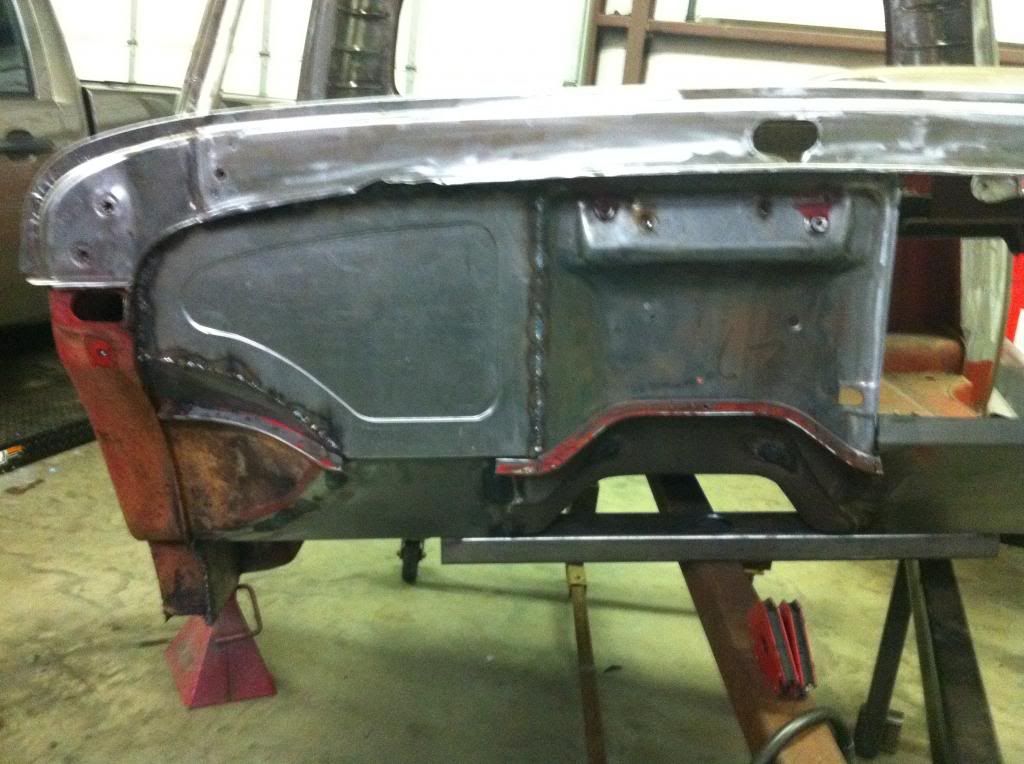

It had some rust issues in the front floor pans and front section of the inner rockers due to a leaky sunroof. I guess these were popular in the late 70s or early 80s? Don't worry...the roof is being re-skinned!
http://i1301.photobucket.com/albums/...ps6dcae6f7.jpg
http://i1301.photobucket.com/albums/...psb2f63f96.jpg
http://i1301.photobucket.com/albums/...ps56754b91.jpg
