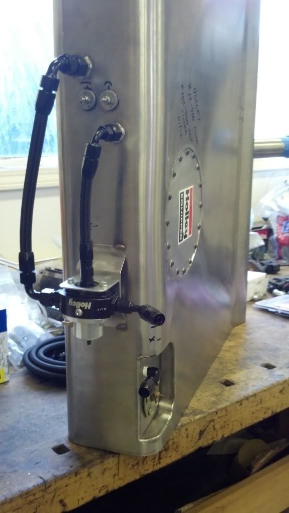

Some pictures, on the bench building it, shows regulator mounting:

view in tank. On the right side is a "U" tube (pump to prefilter), On the left is a pickup tube that goes thru a baffle wall in the tank. The return line also dumps the unused fuel in this baffled area (cavitation problem??)
