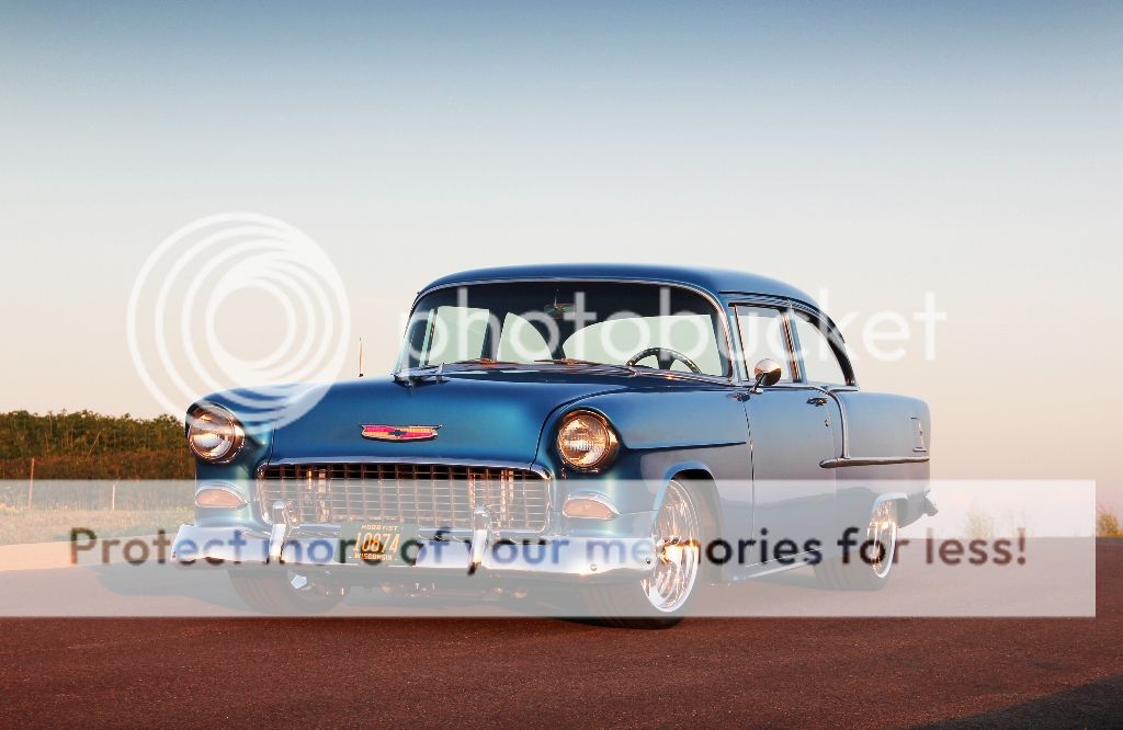

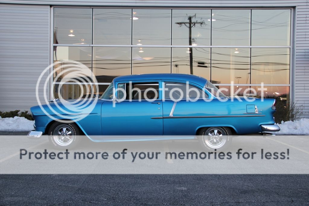

This is a nice old 55 Chevy that the owner brought to us looking for some updating in the ride, performance, stance, and looks categories. Like a lot of cars out there, it was an older restoration that fueled the need to have an old car. However, riding on a stock 1955 frame and suspension with outdated steering, and inadequate brakes kept this ride in the owners garage instead of out on the road. "It looked great, but was no fun to drive". So, after some discussion, the owner brought the 55 down to the shop to install one of our new REVO chassis as well as a few other things on his "wish list".

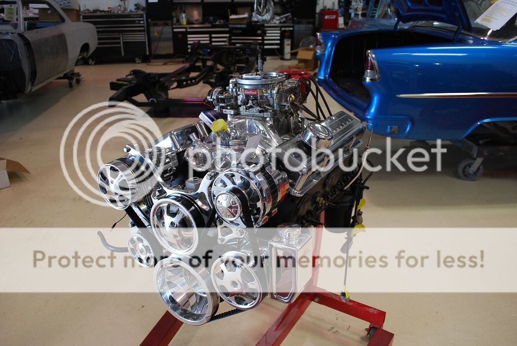

  • Engine dress up with Billet Specialties Tru-Trac, valve covers, air cleaner, etc...

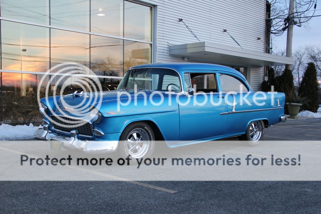

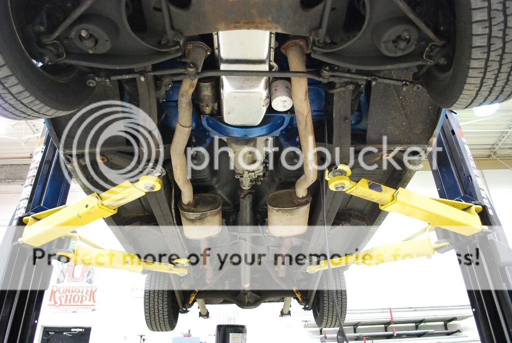

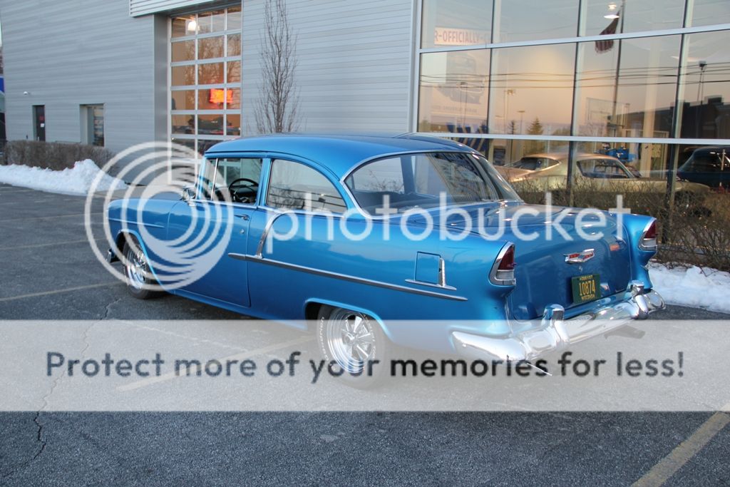

Here is what it looked like when it arrived:
http://i563.photobucket.com/albums/s...ps7166fcaf.jpg[/URL]
http://i563.photobucket.com/albums/s...ps2b1f2c5a.jpg
http://i563.photobucket.com/albums/s...ps35078703.jpg

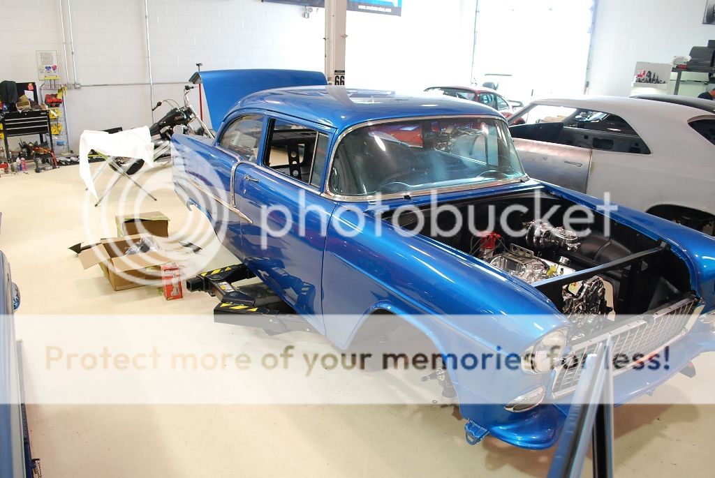

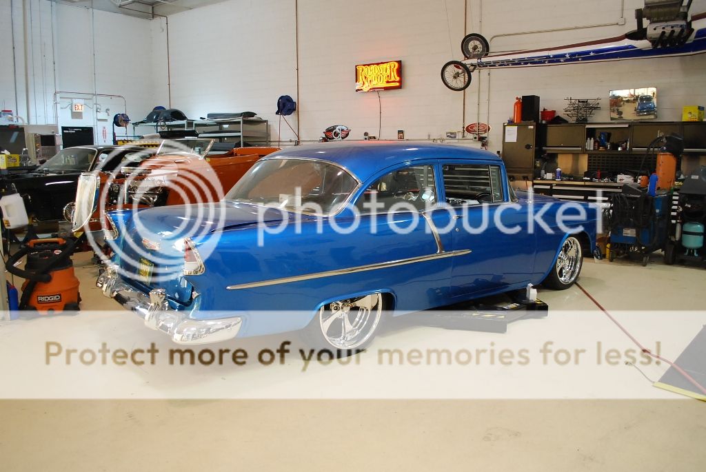

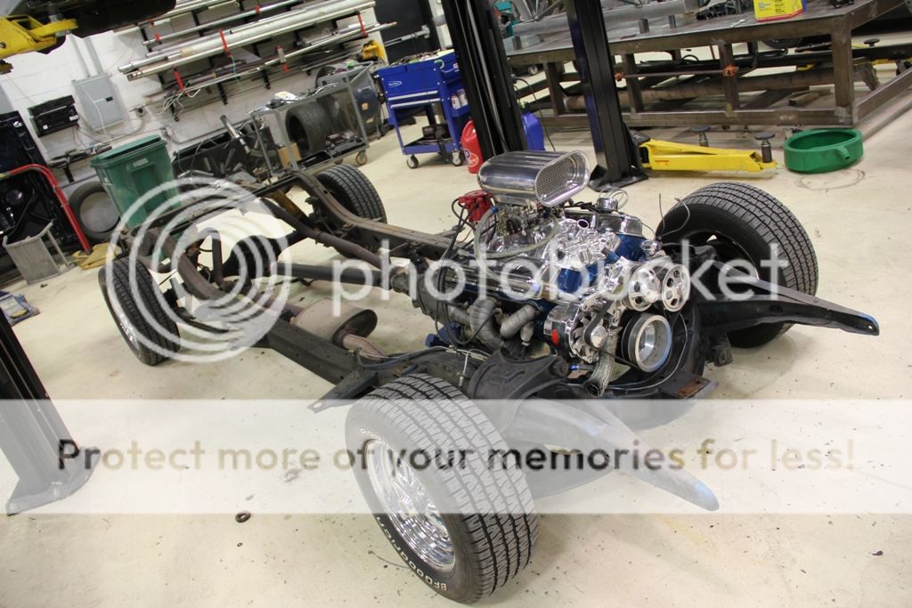

Roadster Shop 07-20-2013 09:48 AM
Disassembly begins.
http://i563.photobucket.com/albums/s...psf624c90d.jpg
http://i563.photobucket.com/albums/s...psd1b1665d.jpg
http://i563.photobucket.com/albums/s...ps8fbca012.jpg
Sorry to all who were interested, Marty already called "dibs" on the air cleaner for his Camaro!
http://i563.photobucket.com/albums/s...ps86f80b1b.jpg

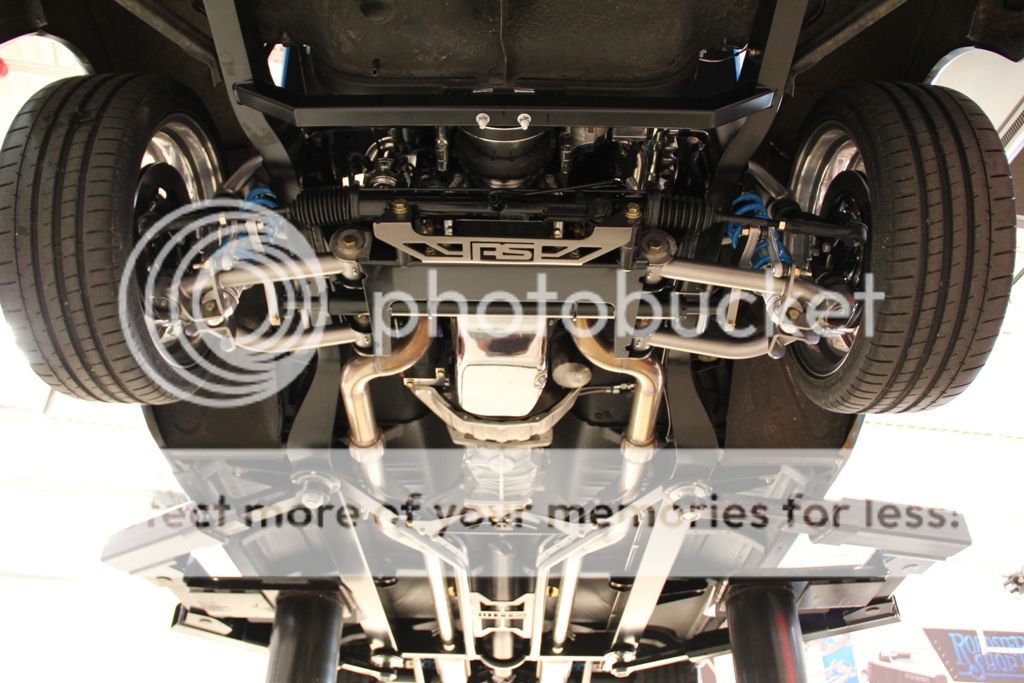

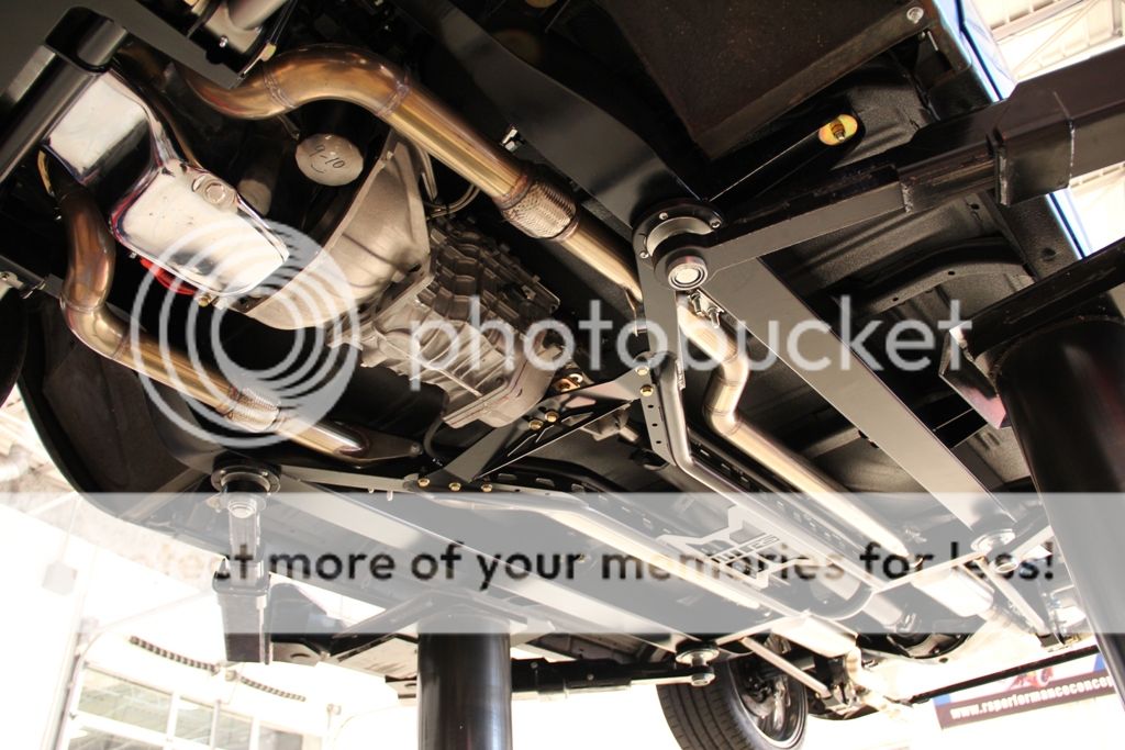

Roadster Shop 07-29-2013 06:58 AM

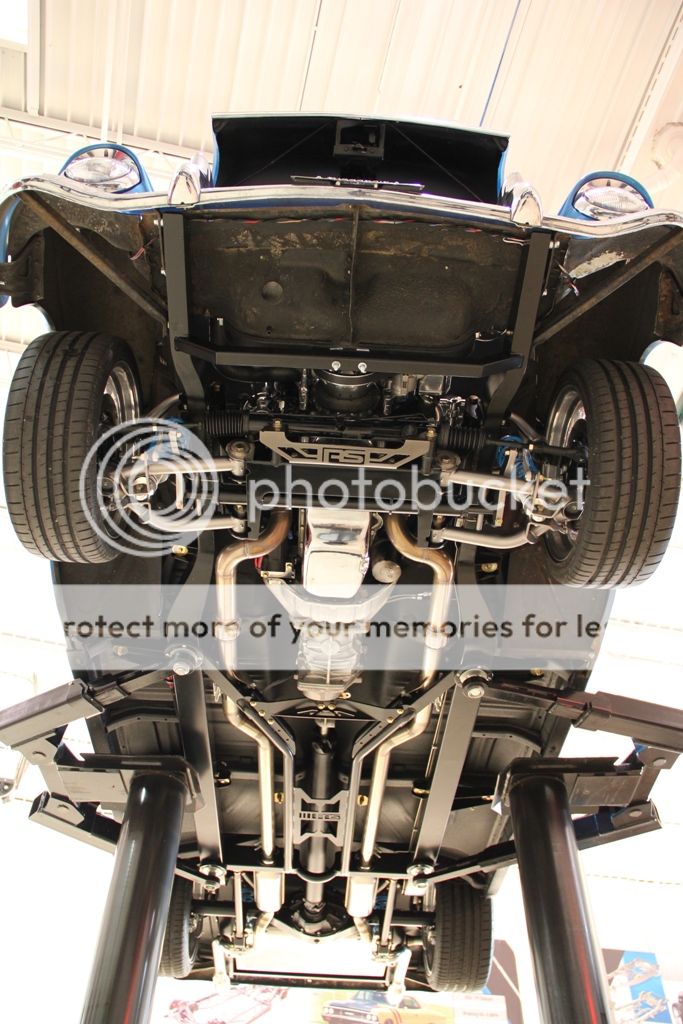

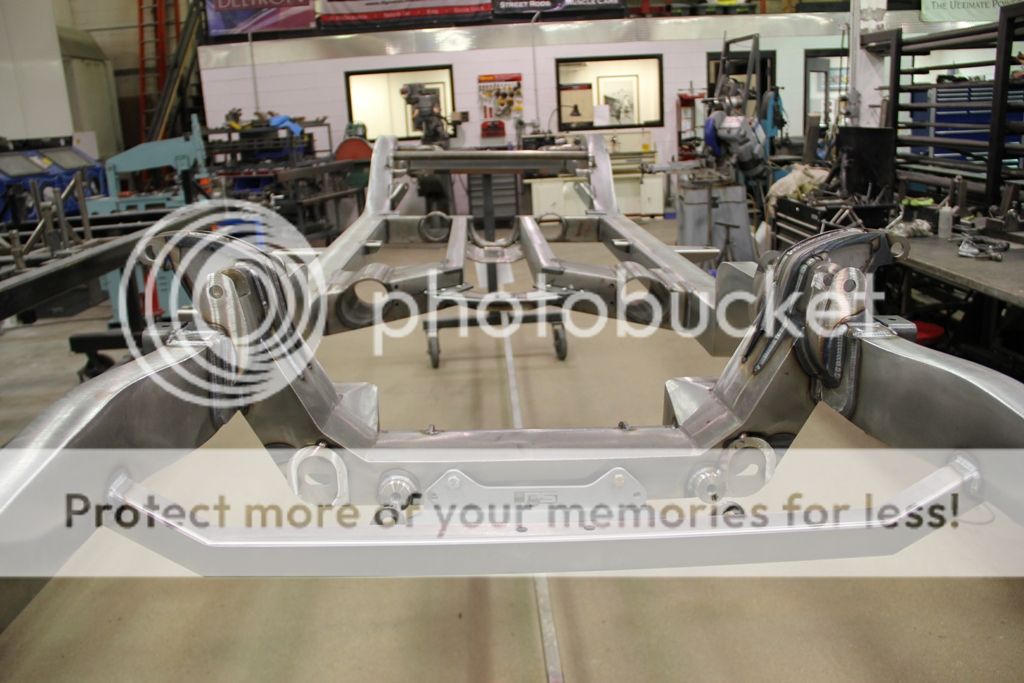

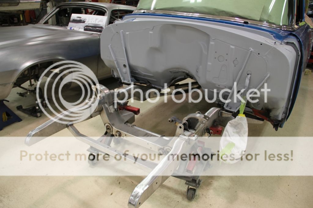

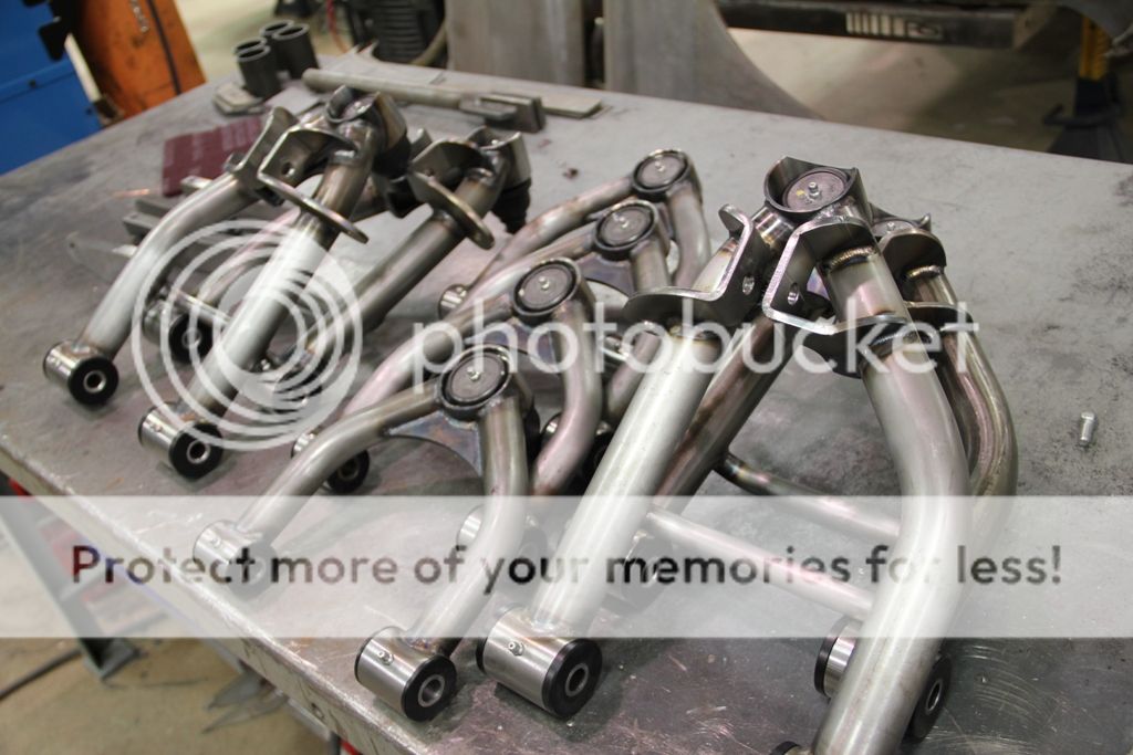

New REVO chassis and component build
http://i563.photobucket.com/albums/s...psdbf44c8d.jpg
http://i563.photobucket.com/albums/s...psf896f141.jpg

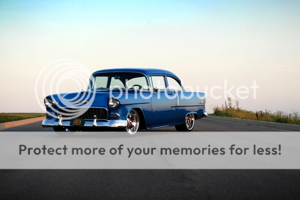

A few nice shots of the completed chassis
http://farm6.staticflickr.com/5525/9...02457a79_b.jpg
http://farm4.staticflickr.com/3785/9...01dee0ec_b.jpg
http://farm6.staticflickr.com/5485/9...886ba9d3_b.jpg

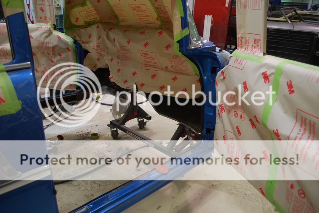

Roadster Shop 07-29-2013 07:13 AM

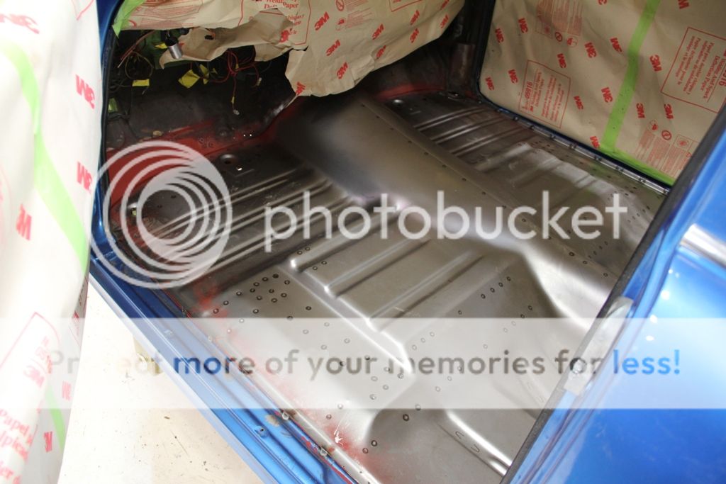

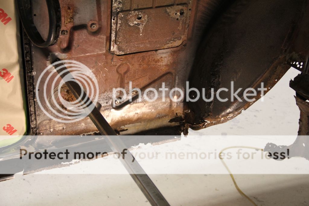

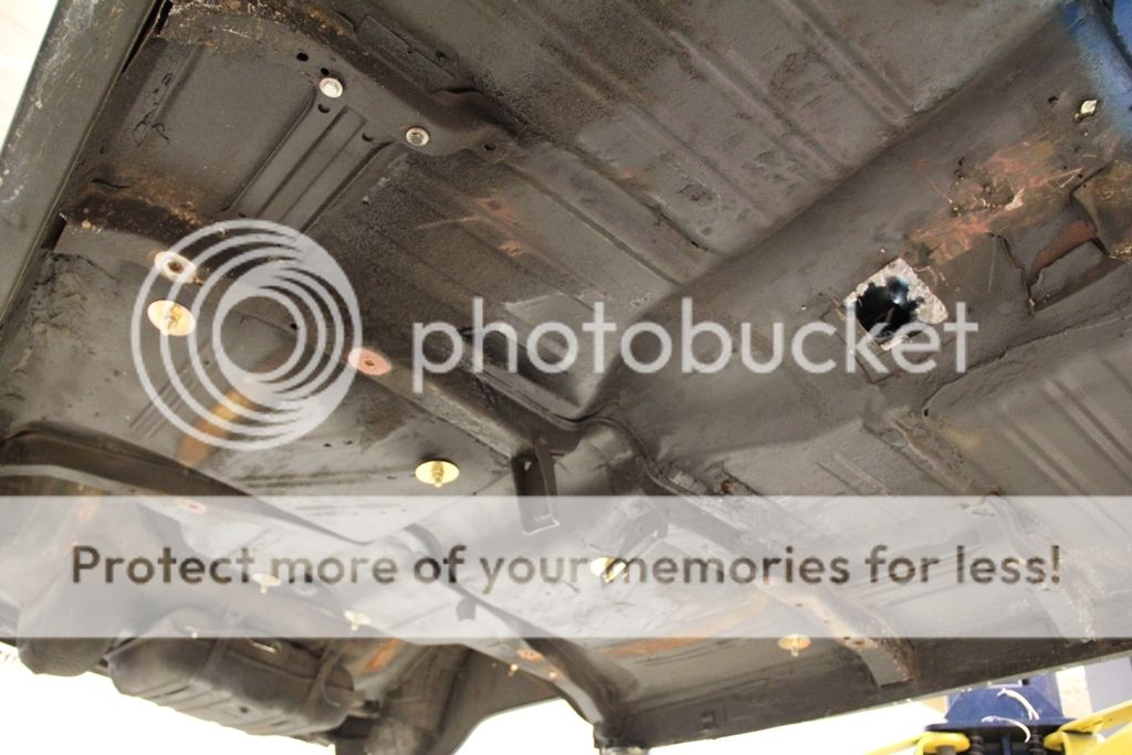

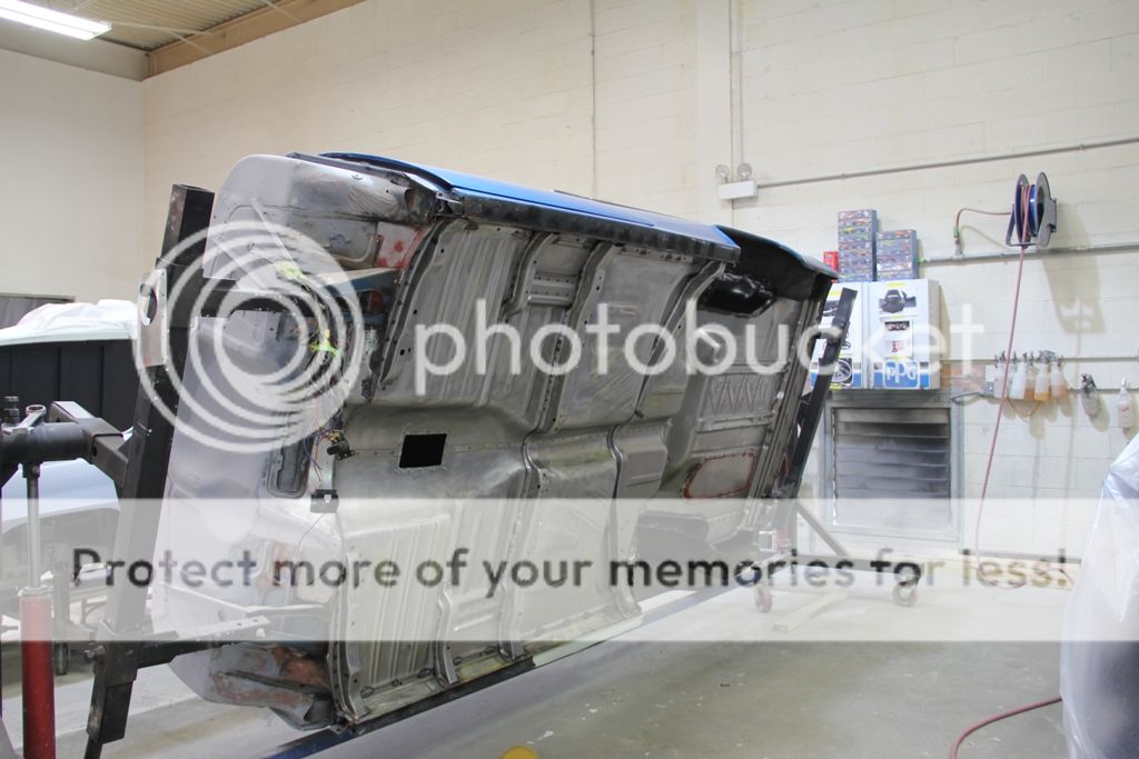

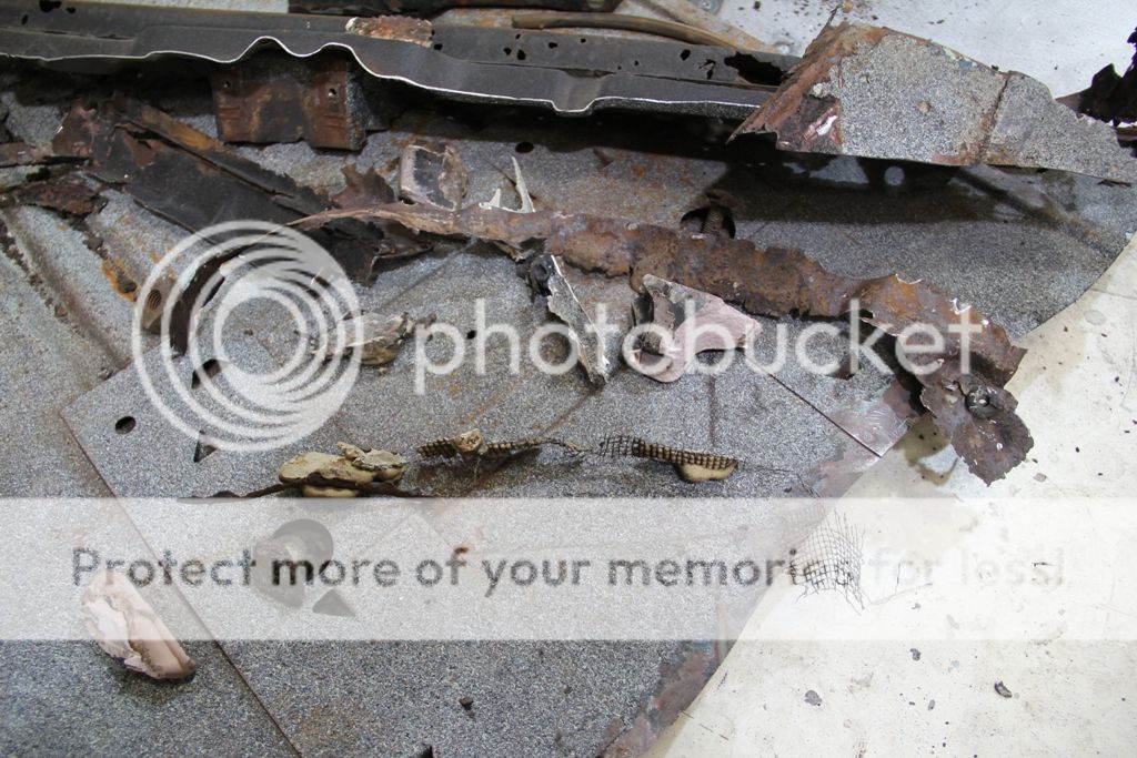

Once we moved forward with the dis-assembly, we started running into issues with the condition of the car. Several of the floor braces were not attached to the body, and some actually stayed attached to the frame when we separated the two. There was a lot of old rust that had been repaired with massive amounts of bondo, wire mesh, foam, and anything else that would fill the holes.
http://i563.photobucket.com/albums/s...psf719aa89.jpg

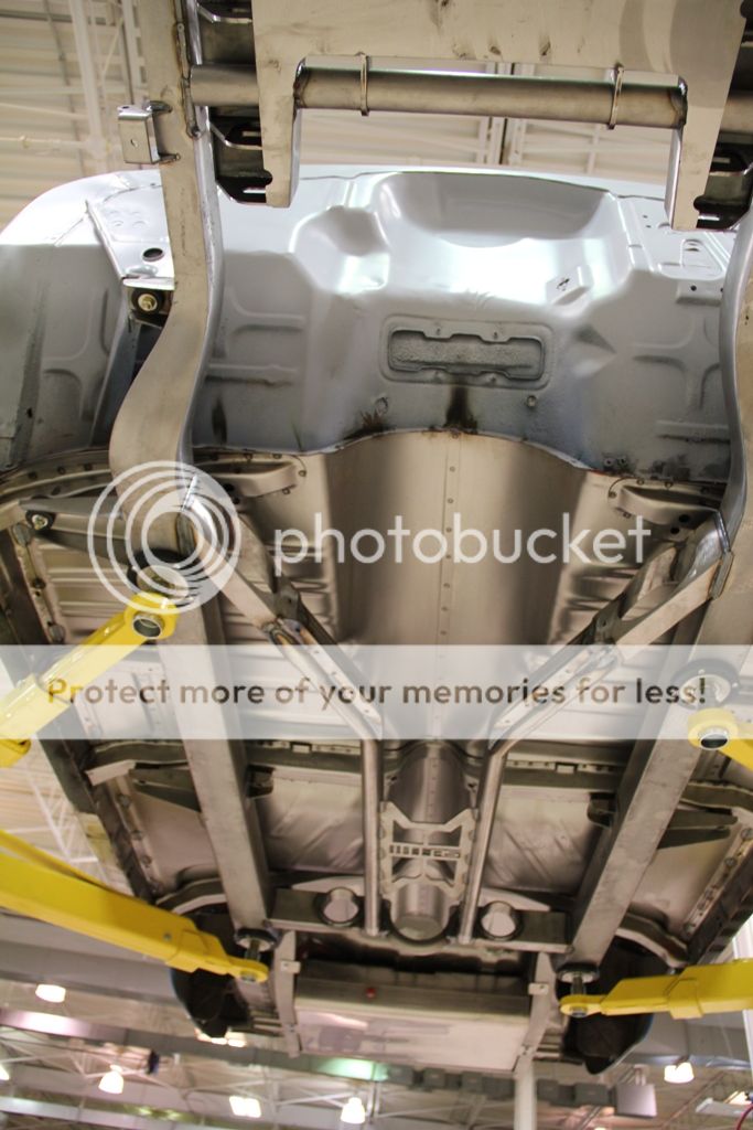

The decision was made to replace the entire floor rather than fix all of the little spots around the car. So we braced the body and removed what was left of the original floor.
http://i563.photobucket.com/albums/s...ps1f28dc7e.jpg
http://i563.photobucket.com/albums/s...ps4cae6c86.jpg

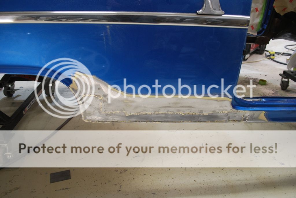

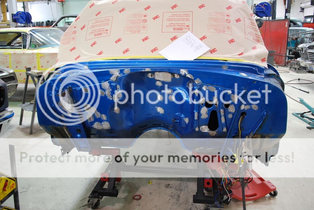

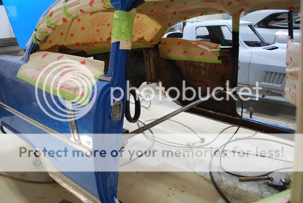

Next, we found the lower front of the passenger side quarter was pieced back together and nothing left to weld the floor or wheel houses to.
http://i563.photobucket.com/albums/s...ps46433a91.jpg
http://i563.photobucket.com/albums/s...ps08351c20.jpg

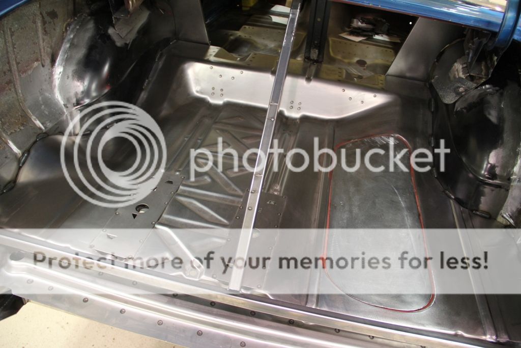

Roadster Shop 07-29-2013 06:54 PM
Originally Posted by jy211 (Post 496036)
1 piece floor? :knock:

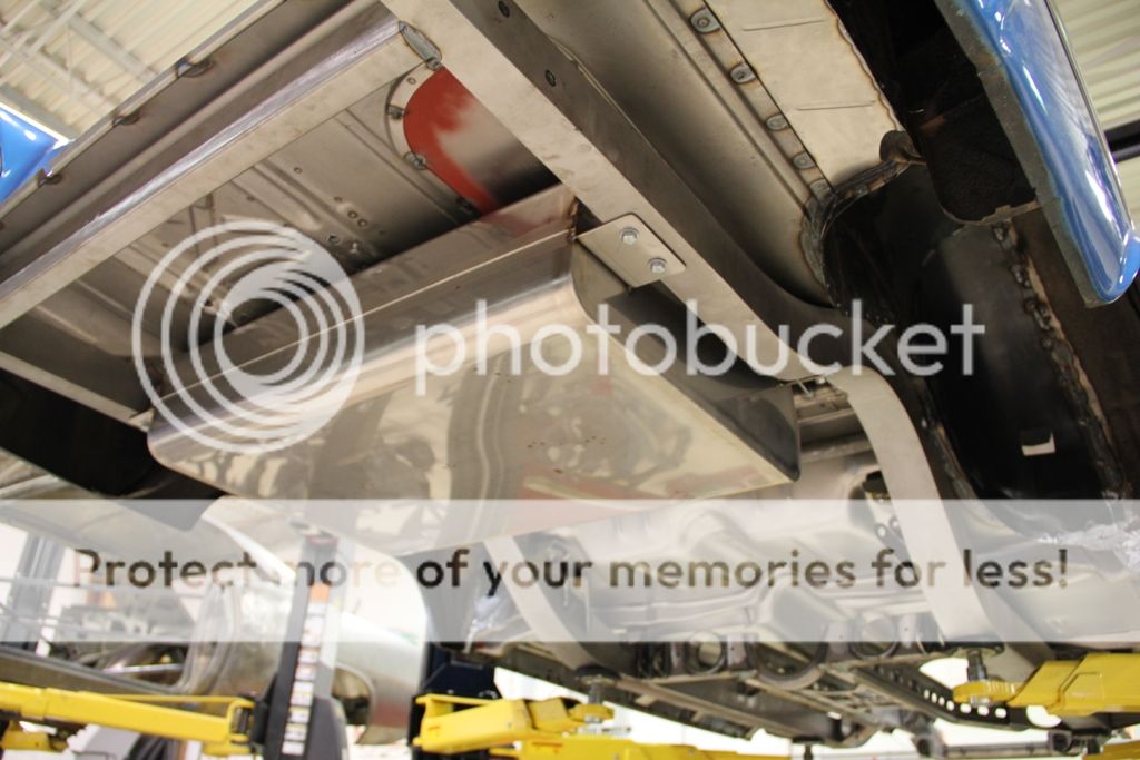

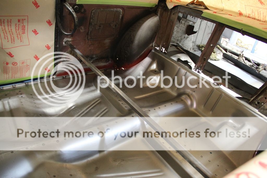

My bad, it was actually a 2 piece floor from Danchuck. 1 piece complete main floor (with braces) and then a 1 piece trunk floor. We also used the Danchuck deeper wheel tubs to comfortably get a 295 tire in the back
http://i563.photobucket.com/albums/s...ps658a6ca0.jpg
http://i563.photobucket.com/albums/s...ps854084b8.jpg
http://i563.photobucket.com/albums/s...psa90e94f1.jpg
