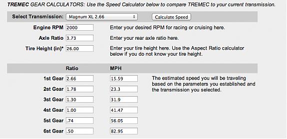

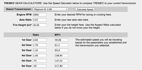

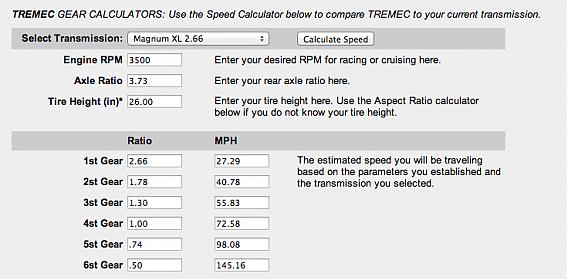

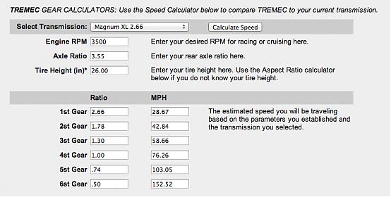

Hey Guys, I'm trying to decide what gears to run in my car. I currently have 3.08s / Viper T56 with the following ratios:
1st 2nd 3rd 4th 5th 6th Rev
2.66:1 1.78:1 1.30:1 1.00:1 0.74:1 0.50:1 2.90:1
I'm running the Michelin Pilot Super Sports: 295/30/19 @ 26"
Using the Tremec calculator
@ 2000rpm, 3500rpm, & 5000rpm I get the following speeds. The variation at my power band is only 5 - 7mph
My goal is to have improved hookup for the auto-x, and stronger pull in the 4th / 5th gear for the high speed track events.
I'd appreciate your thoughts....
Attachment 40970 Attachment 40973
Attachment 40971 Attachment 40974
Attachment 40972 Attachment 40975

With the Vipers semi-wide ratio I'd be leaning to 3:73, but 3:55 gearing will typically provide more traction.

With your motor I'd probably go to 3:73 for maximum power leverage. Then see how they feel in the LS.
I was paying close attention to my rpm today on a typical trip to town and favorite backcountry loop and it's a fine line between 3:55's and 3:73's. I've been speculating on this too long, the 3:73's may win. 2250 rpm with my .63 6th and 26.5 tire is 75 mph, 2500 rpm is 85 mph.
