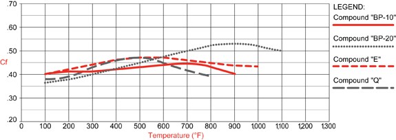

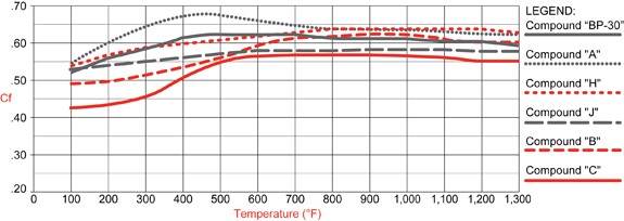

BANKO 07-27-2013 12:21 AM
2 Attachment(s)
Hey Matt, yes they do have an E compound, but that is considered the high end of the street performance category.
Street Performance Pads:
Attachment 41055
Track Pads:
Attachment 41056
After reviewing these charts side by side I can understand why you wouldn't like the BP-20s on the track. They show a really shallow slope with the peak Cf (~.52) at nearly 900 degrees F! The E is slightly better, but still needs to be at 500 degrees F for max Cf (~.475).
I'm surprised that the track pads (A & H) have an initial Cf (~.55) rising above Cf (0.6) at 500 degrees. What is interesting is the initial cold torque is far superior to the street performance pads. I guess the major consideration is rotor wear :_paranoid

Ron, thanks for your questions. I'm building my Chevelle to primarily run ASCS, GG Auto-x, and the occasional track day at some of the great tracks in Nor-Cal. It is difficult to estimate percentages, but I would assume 60% track / 40% street. I realize there is not a single pad compound that works in all situations and would tend to bias my selection towards performance on the track rather than street.
Ron Sutton 07-28-2013 01:57 PM
Originally Posted by BANKO (Post 495834)
Yep, they are consumables, very high priced consumables ;-)
I strongly urge you to have a performance street and a more aggressive track pad & simply swap pads when you're going to a track day.
The H pads are a great track pad, but not an optimum street pad. They're expensive, wear fast & eat rotors. But Man ... they do whoa down a car. :)
