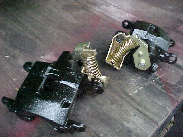

NOT A TA 08-20-2013 08:49 AM
Tobin, this is the caliper RSB is sending. I'm building a 69 Camaro for a customer who had purchased these rear brakes and wanted them installed on the 12 bolt I built for the car.
http://i240.photobucket.com/albums/f...MVC-032F-1.jpg
http://i240.photobucket.com/albums/f...MVC-027F-1.jpg

I wouldn't do anything with respect to the master cylinder until you have the rear calipers set up properly, since that's more than likely exacerbating any perceived volumetric issues that you may or may not be experiencing. The rear pads should be virtually snug up against the rotors, but not tight. See link below.
