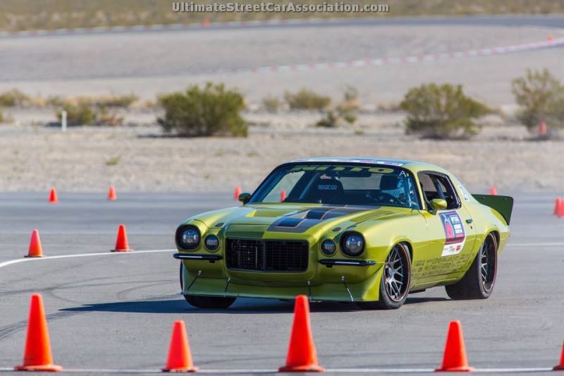

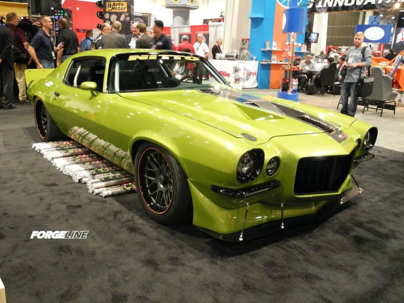

Randy Johson D&Z Customs just finish his second Camaro with the Heidts IRS and he uses it hard!! Full story here http://www.optimabatteries.com/us/en...-chevy-camaro/
http://i79.photobucket.com/albums/j1...ps990c30ad.jpg
http://i79.photobucket.com/albums/j1...ps53058b11.jpg
As for RS, I would give Phil a call? Talk to them about what you want and get some of their customers numbers to talk to about how they like their RS IRS setup??
Asking these kind of question in an open forum gets you lots of opinions but most of the time you don't get the answer from the guys that have the same setup or that have drivin one at the track yet.
