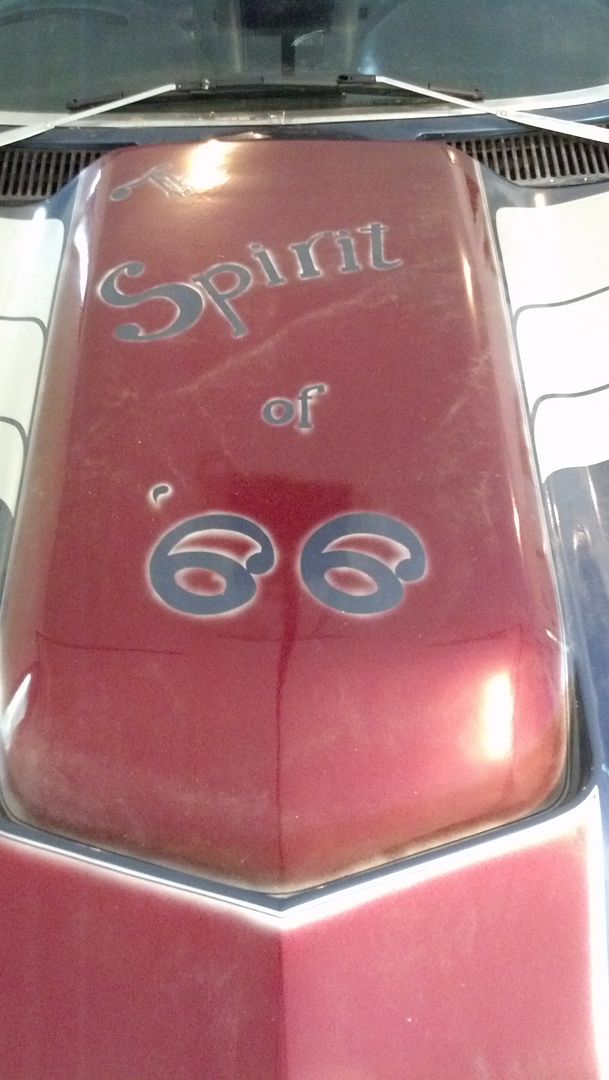

The reason for the thread title, "Spirit of '66" you ask? (yep, it's on the L88 hood)
http://i1207.photobucket.com/albums/...psccf9d7c8.jpg

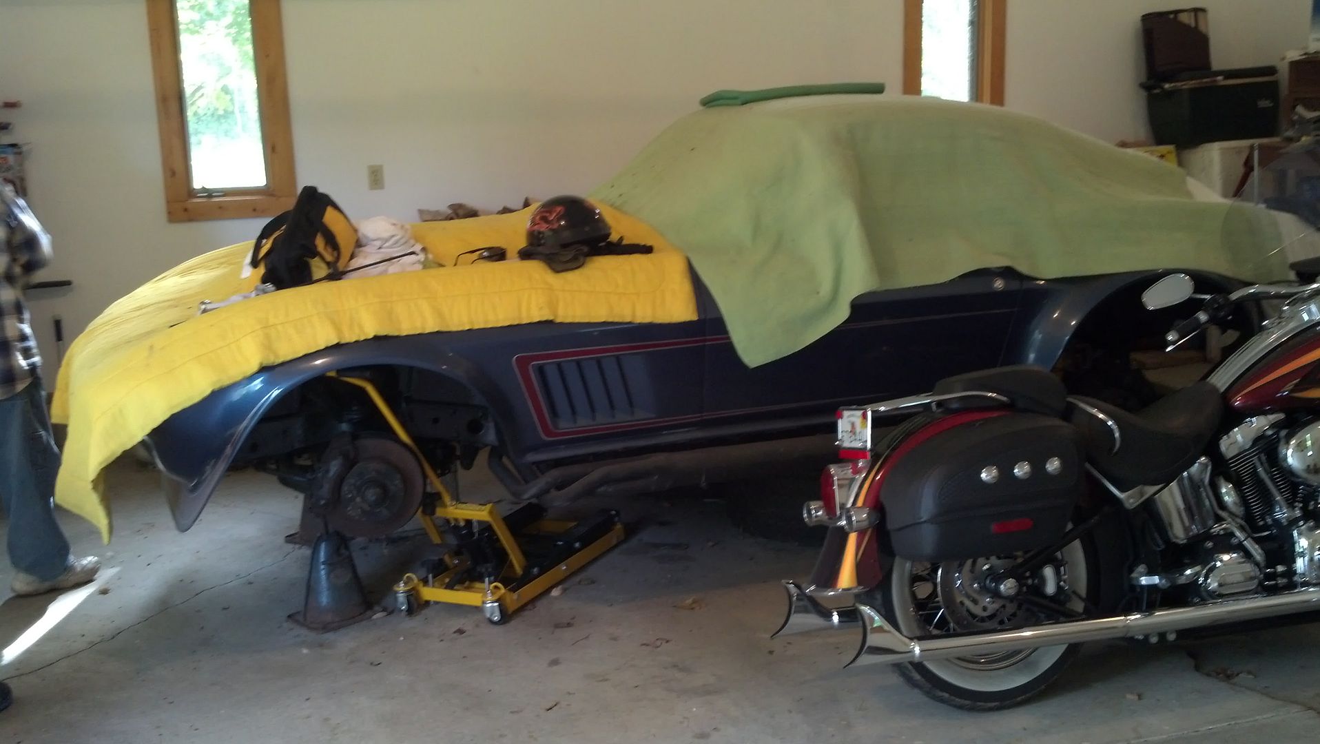

Here is how it's sat for the last 22 years
http://i1207.photobucket.com/albums/...psff5e891e.jpg

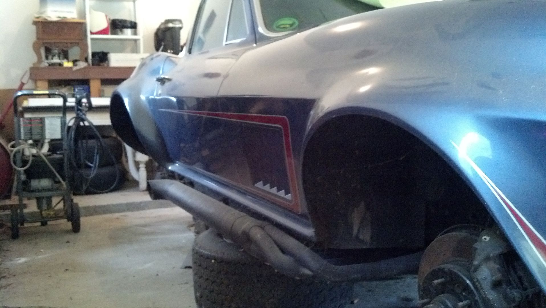

Did I mention the flares? lol, it's got lots of flair :D
http://i1207.photobucket.com/albums/...ps8e098240.jpg

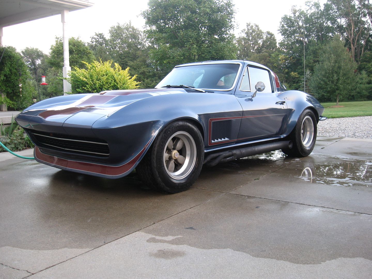

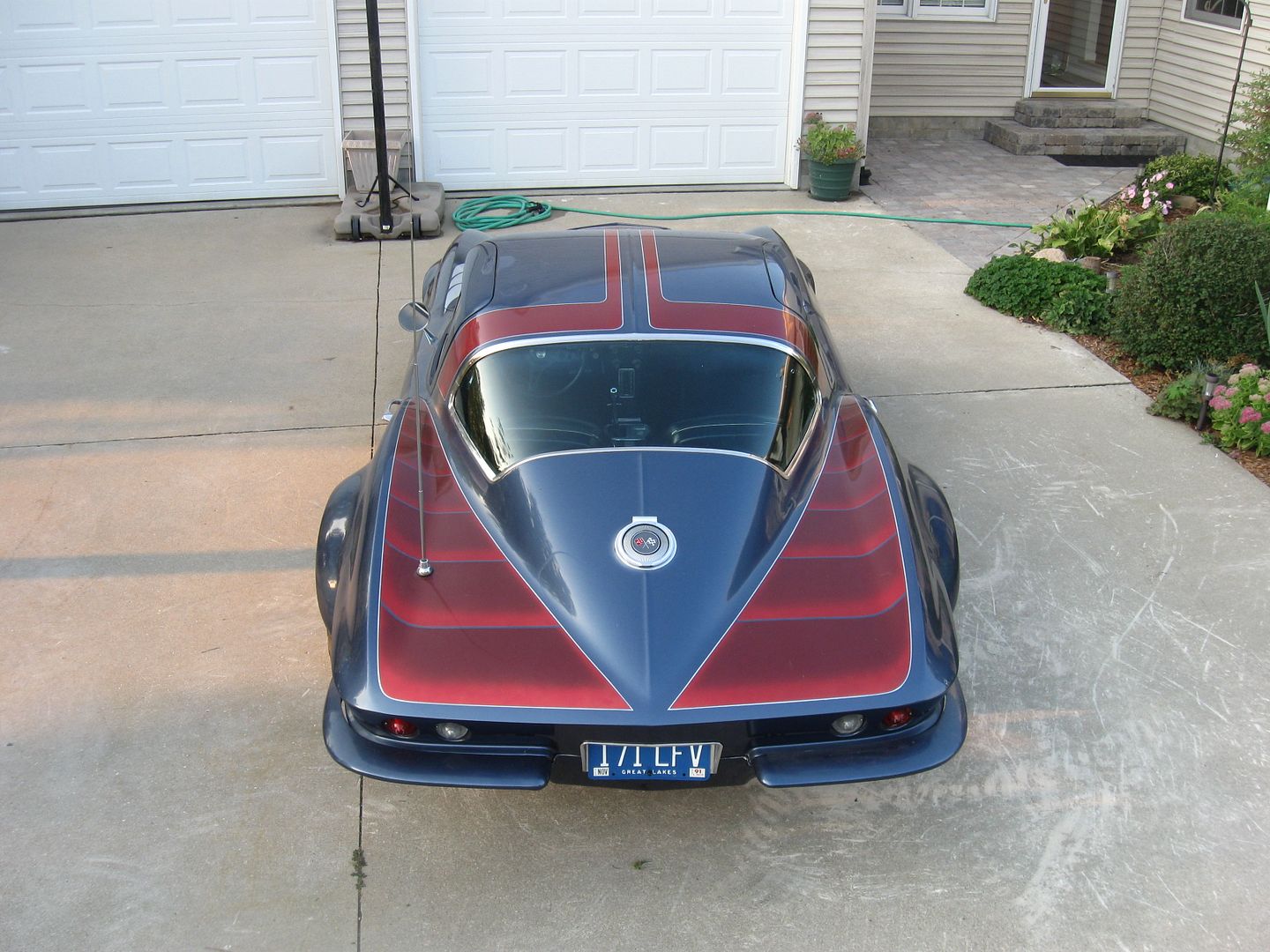

After getting it home and cleaning it up, it doesn't look too bad.
http://i1207.photobucket.com/albums/...psc6267224.jpg

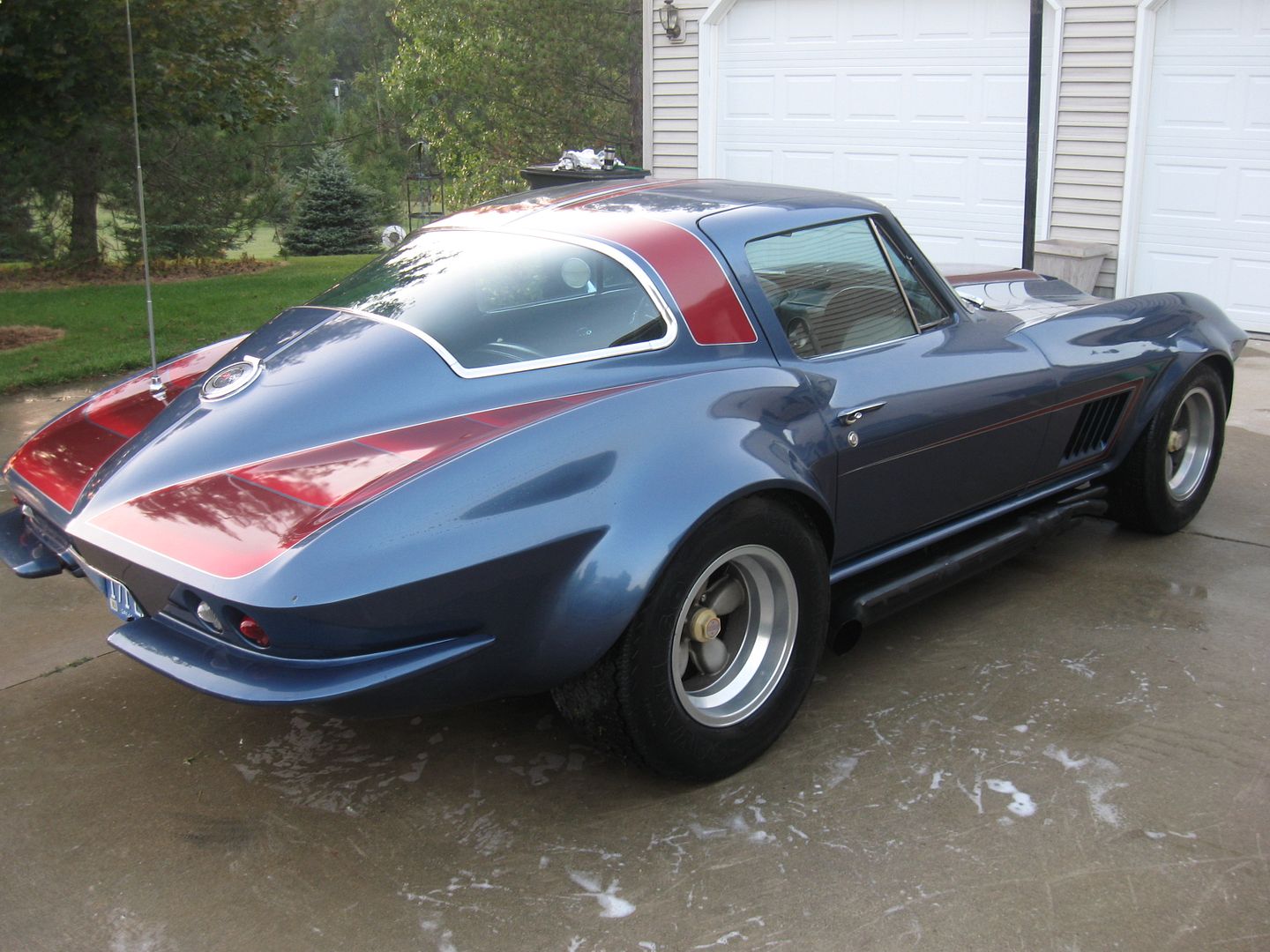

Check out the funky "layered" stripes on the rear haunches:
http://i1207.photobucket.com/albums/...psf6fd2748.jpg
better shot of the stripes before washing it, how wild is that??
http://i1207.photobucket.com/albums/...ps942e9942.jpg

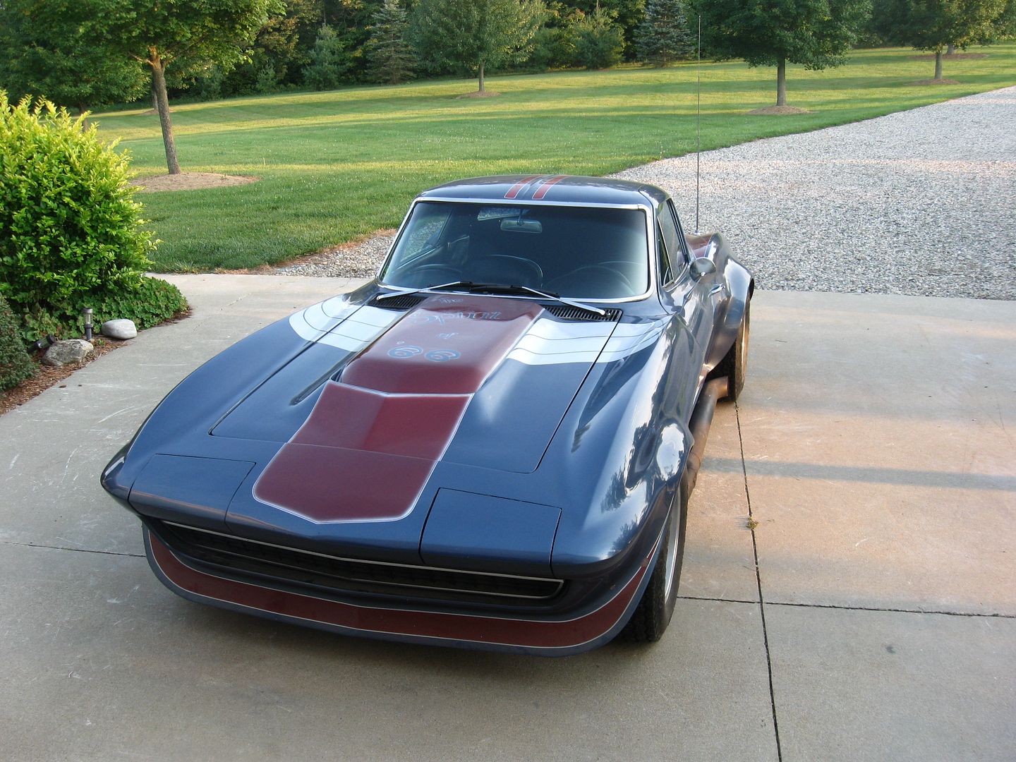

Here is a view of the stripes coming off the hood:
http://i1207.photobucket.com/albums/...ps4f639a71.jpg
I'm sure some keen eyes will say it's a 67, but it's just the side gills from a '67 grafted in when it was customized. The front bumpers cut and put on the rear (?), the chin spoiler, turn signals behind grill, L88 style hood, massive flares, all custom touches from almost 40 years ago.
Still has the ARE Daisy wheels, 15x8 and 15x10 with Firestone "Parnelli Jones" tires! Those should make nice garage art.
The paint has a lot of chips and scratches mostly from it being in the way in the garage for so long I'd suspect. Oh well, life's scars.

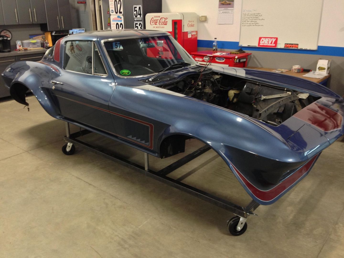

As far as numbers matching stuff if you are into that, yeah, it's mostly all there. The block is a "CE" replacement block from '68. The Muncie is matching, the heads, Winters Foundry marked manifold, original date coded Holley carb and radiator are all in place. Even the water pump is original. We have every intention of preserving any and all parts that are from the car. However, we also have every intention on modifying this car further to be a fun and hopefully competitive AutoX car.
Intially we will be using the original 327 with some changes for safety (better, baffled oil pan), as a power plant. The 4 speed as well. Suspension wise, that's up in the air yet but it won't involve many original parts for sure. Brakes will be upgraded to C6 Z06 calipers and rotors.

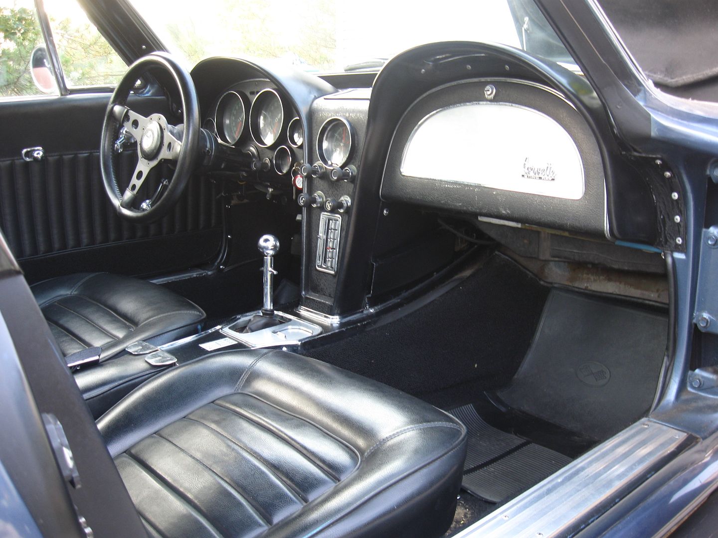

Interior is probably the weakest part of the car. It looked much better in the dark garage...It was originally Bright Blue, some painted, some dyed, some parts replaced with black parts.
http://i1207.photobucket.com/albums/...ps9aed5d3a.jpg
