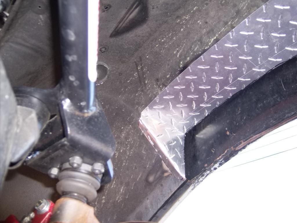

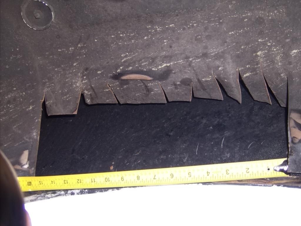

heres mine modified! its really easy not aggressive at all, Camaro inner fenders SUCK they were designed for a MAX 15inch wheel 7inch wide to get any real tire under there and a decent ride height, it needs to be modified, hope that helps
CUT UP
http://i752.photobucket.com/albums/x...ps503b4532.jpg

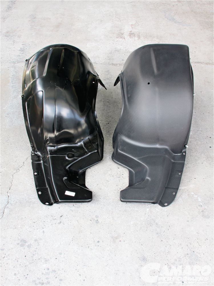

HERES THE ANVIL FENDER NEXT TO STOCK(this is the shape youre kinda looking for)
http://i752.photobucket.com/albums/x...ps493765a7.jpg
Royalty Rides 09-26-2013 10:46 AM
Totally understand what you mean. I own a 74 nova and can't fit anything underneath the stock inners. Thanks for the visual. Looks like RideTech will be getting my business.

mdprovee 09-27-2013 11:29 AM
Thanks Rodney for those pictures. I need to do that so I can a larger tire up front.
I want the Anvil inners, but my Procharger is touching the stock inner fender now, so I dont think Anvil will fit.
Vince@Meanstreets 09-27-2013 04:31 PM
Thats the beauty of Carbon Fiber, you can move things around.
