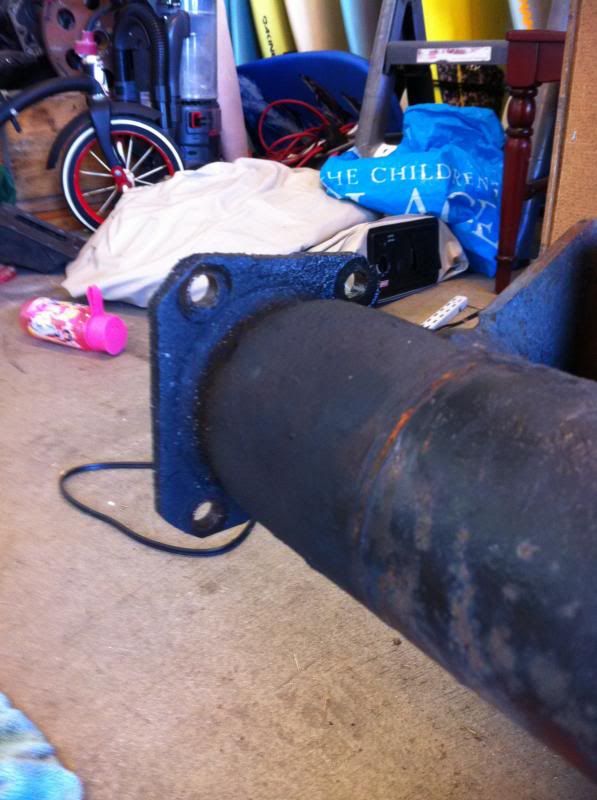

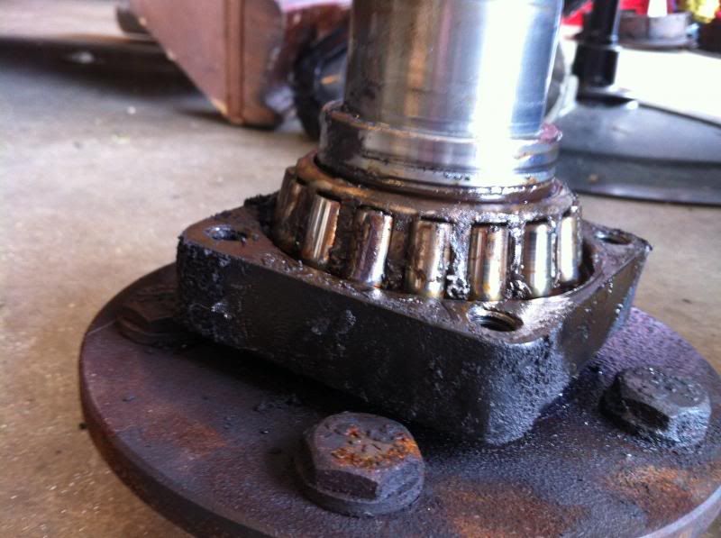

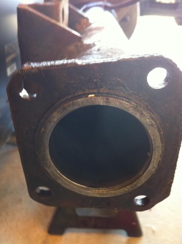

should be an etching on the side of the bearing. picture of the bearing and the housing ends might help us. What side of the bearing is the seal riding?
skooli 10-06-2013 05:24 PM
http://i6.photobucket.com/albums/y24...ps21b87238.jpghttp://i6.photobucket.com/albums/y24...psf52b35bc.jpghttp://i6.photobucket.com/albums/y24...ps0969d0ff.jpghttp://i6.photobucket.com/albums/y24...ps8f248d5e.jpg
skooli 10-12-2013 09:10 PM
So, not Ford ends. Looks like Strange c clip eliminator. Does anyone know of disc brakes that will work with this set up?
Vince@Meanstreets 10-13-2013 11:25 AM
any kit where the bracket fits to the back side of the housing end flange.
