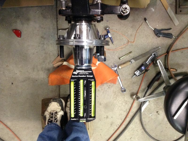

I have one of the Longacre Camber gauges from my racing days but it has the magnet end version that would normally stick to a steel hub....Well I have Wilwood aluminum hubs so the magnet will not work obviously......
So I was searching and saw someone placing the gauge actually on the Rotor. So is this an acceptable location to place it on through the wheel to get a reading or would that be an inaccurate reading versus in/on the actual spindle end itself?
Thoughts?
Vince@Meanstreets 10-08-2013 08:39 AM
Yes, it's square to the hub.
You can also make an adapter the pushes on to your lug nuts.
RBuhr69 10-08-2013 08:47 AM
Awesome, I didnt think it would matter but wanted another opinion.
for an adapter I was thinking of getting a seperate hub bearing cover and use it as an modified adapter to the gauge itself.
thanks!
DRJDVM's '69 10-08-2013 02:48 PM
I have one and they make an adapter that you can screw onto the threaded spindle hub.)... The issue I've had is with the castle nut and cotter pin, there isn't much thread exposed to engage
RBuhr69 10-08-2013 03:43 PM
ok, thanks..I will have to check and see how much thread is there and order one if it will work out. If not, I have plenty of room to put it on the rotor through the wheel openings..

Bingo, that's what I did. I bought an extra cap and made this. You have to be careful as this thing uses a shoulder bolt and wave washer to maintain alignment while allowing you to rotate the gauge. I had to make some shims for it to work, but it does work great.

I attach to the rotor when I can. I also made some thick washers that fit into the wheel center cap groove. The magnetic gage sticks to it.
