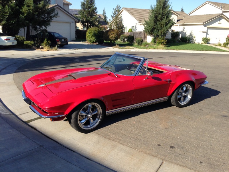

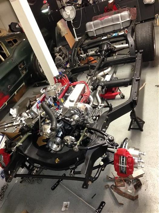

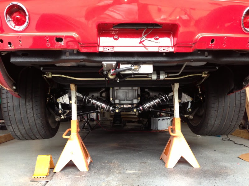

uxojerry 10-11-2013 11:07 PM
Stock Frame Mods and Examples
3 Attachment(s)
Attachment 42485
Attachment 42486
Attachment 42487
Ive included some examples of a 64 recently completed, (not mine). C2 and C3s have identical frames and suspensions. The last photo is of the Shark Bite rear coil overs. I think that looks cool and is the main reason Im leaning towards modding a stock frame. I also want to save $20k or so from the expense of a custom chassis.
Note: Consensus on the Corvette Forum is this car does not qualify as a resto-mod as it does not have a custom chassis.

Glad to see you're alive and well. A C-3 should suit you -- throttle loose with lots of roll oversteer -- fix it with more throttle -- LOL. I've had a dozen 68-72s and I still have a ton of parts -- Guldstrand, Tom's Differential, VBP, etc. The weak link is the rear suspension -- roll oversteer and lack of real strength. Not hard to fix. Tom's differential 12-bolt rear conversion with stronger u-joints and hardened stub axles. Wider tires are easy with offset trailing arms, but that doesn't cure the geometry problems. I gave my son a 69 a couple of years ago with 17 inch wheels and 295s on the rear with no body mods -- just offset trailing arms (VanSteel). A Guldstrand 5-link helps and isn't bad to install -- a C-4 rear conversion is better, is cheap, and is relatively simple to do. You basically weld in a couple of tabs to support the batwing and add the pick-up points for the front of the forward links. A roll bar fits, but is easier with a convertible with a removable hardtop -- looks better too. If there is anything I can do to help you, give me a yell.
