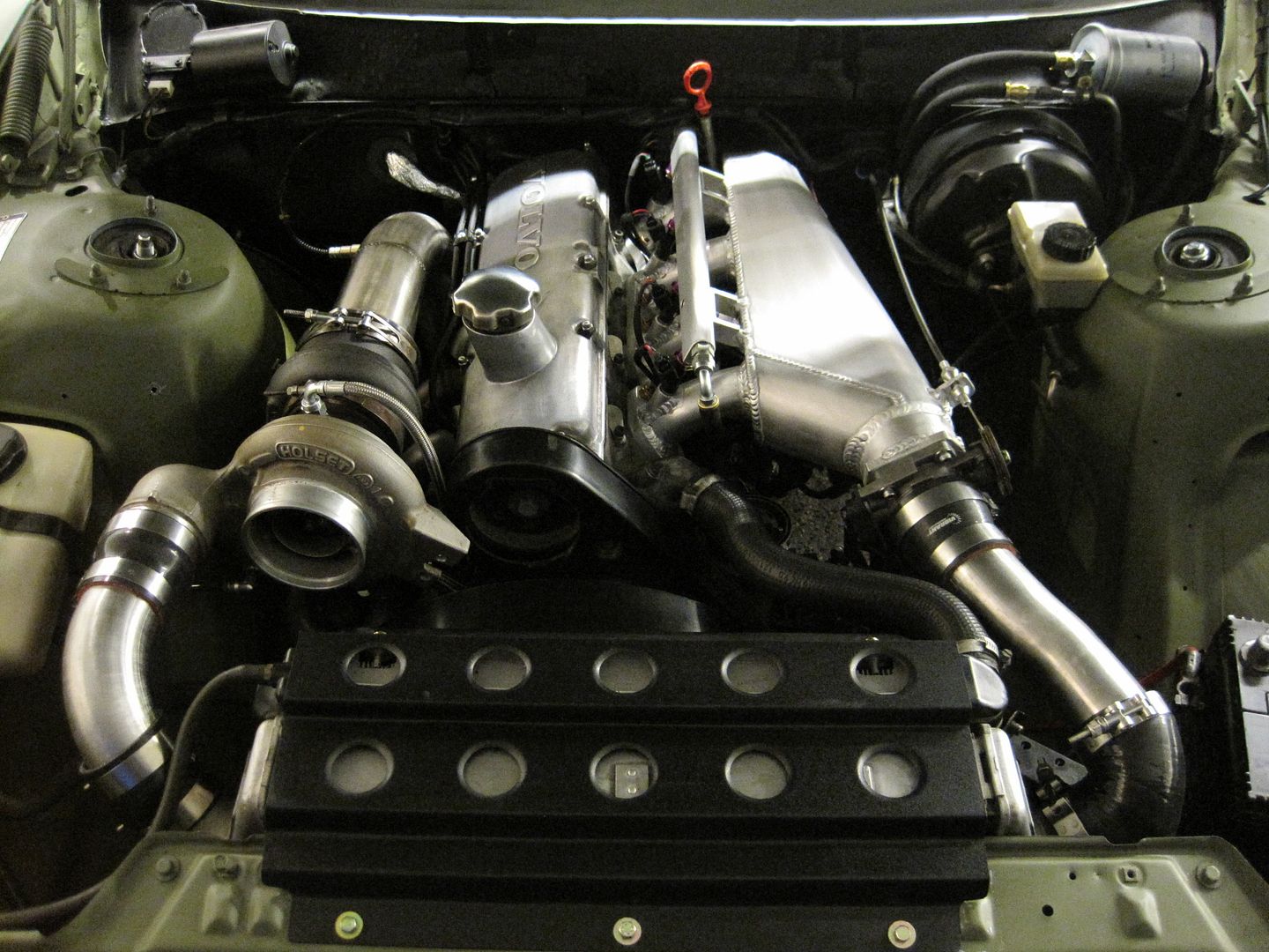

The pea green Volvo is a 1982 242. That was last springs project. Makes a little over 300 hp on just 2.1 litres. Not a big number in this crowd but a very fun car to rip around town. Rear wheel drive with a mustang t5 tranny and a spool makes for a pretty fun little car.
All work done in my little shop on this one with the exception of the intake manifold built from scratch by my friend Nathan.
