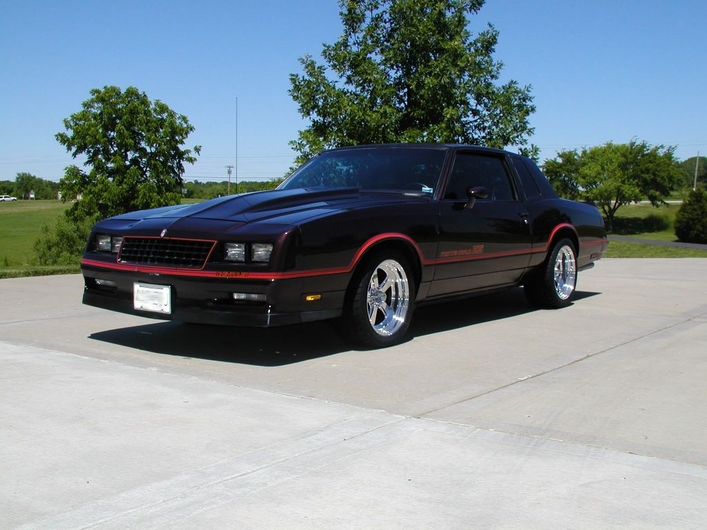

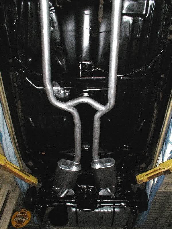

My story with Barney started off as a pretty much original 67,000 mile garage kept car I picked up at a Mecum Auction here in KC. I spent a lot of time and effort in the first few years restoring the underside and upgrading the mechanicals, the goal was better performance but retaining an original look with the car.
http://img.photobucket.com/albums/v3...MCSSsigpic.jpg
http://img.photobucket.com/albums/v3...nderbody15.jpg

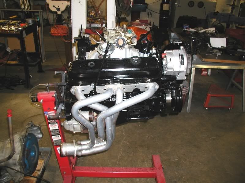

I put a GMPP HT383 crate engine under the hood in the first year keeping the original CCC carb and distributor feeding it.
http://img.photobucket.com/albums/v3...Assembled4.jpg

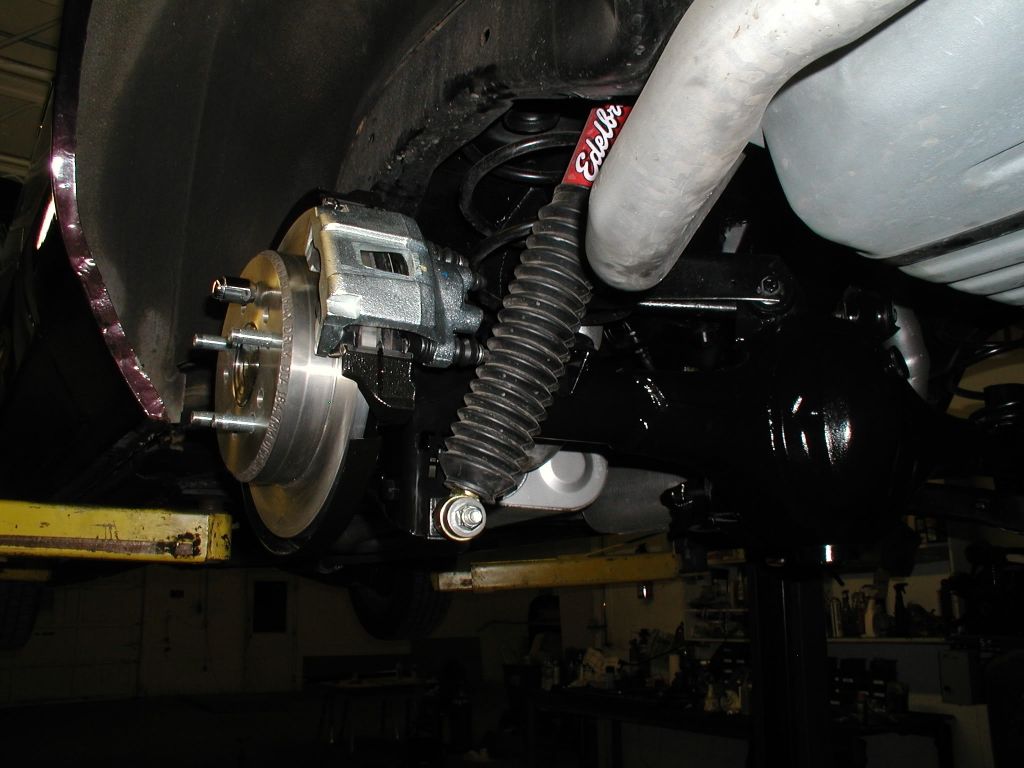

When the used Auburn posi I put in the 7.5" rear axle began to eat itself, I upgraded to a Quick Performance 9" with the rear disc brake kit.

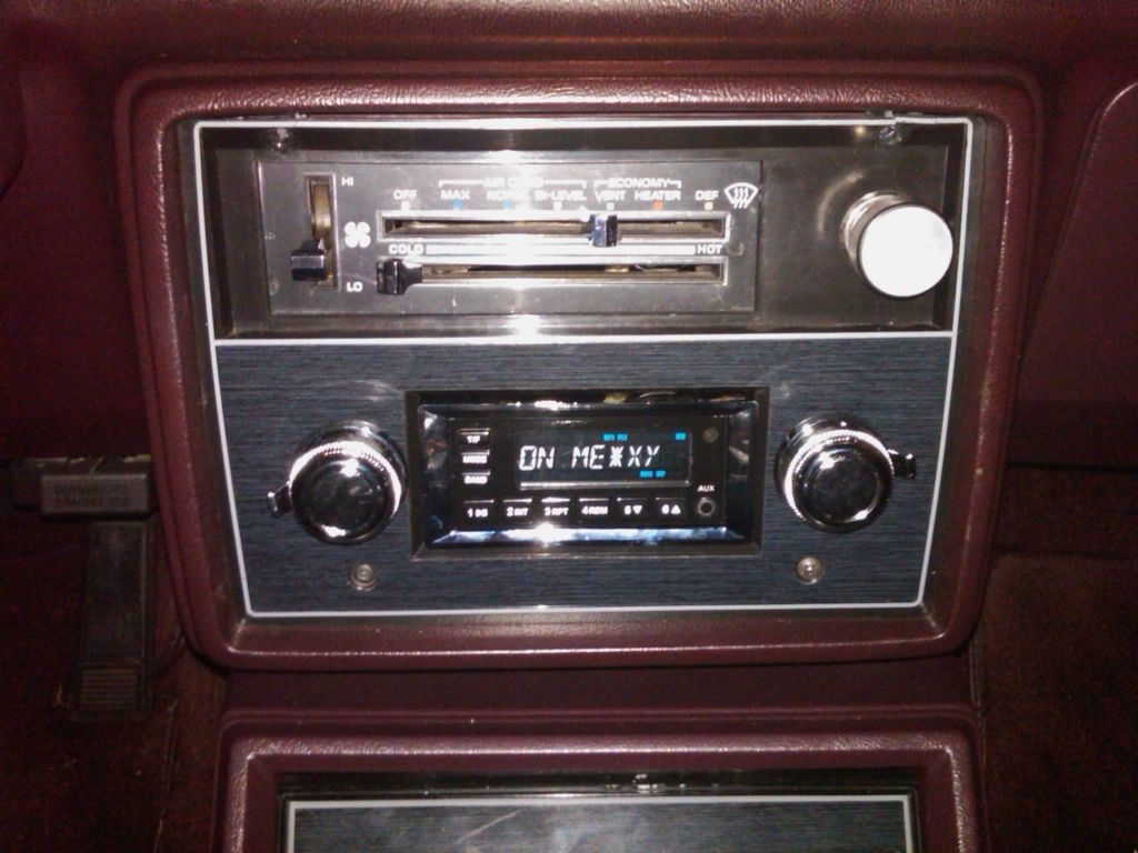

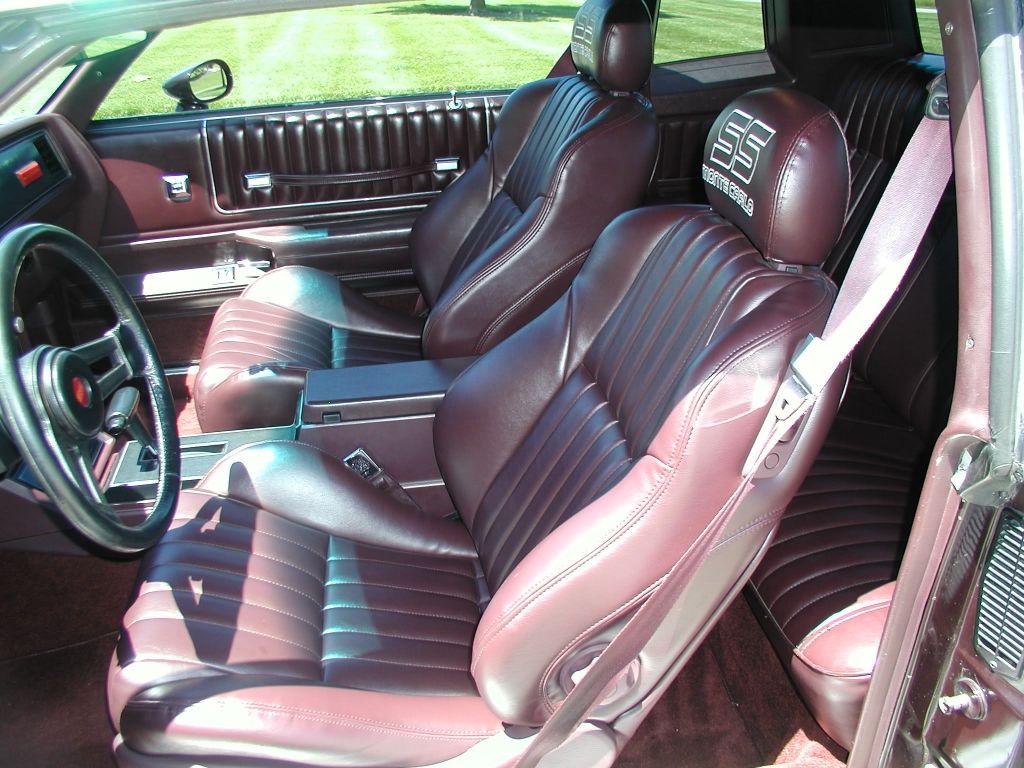

About the same time I found a set of late model GTO seats, had them covered to match the rest of the interior and replaced the woeful factory buckets. The other interior upgrade came with a Retrosound Head unit that fit in the twin shaft dash plate but offered much improved sound, a digital tuner and connections for a USB stick and MP3.

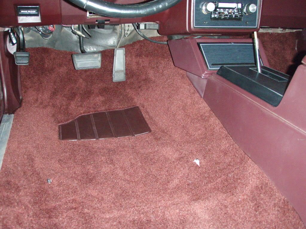

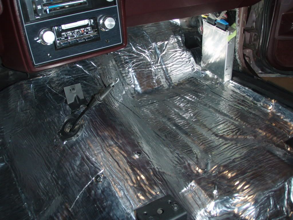

I also pulled the carpet, painted the floor with rust encapsulater and used RAAmat to deaden sound. New carpet was the last to go back in on the interior freshen up project.

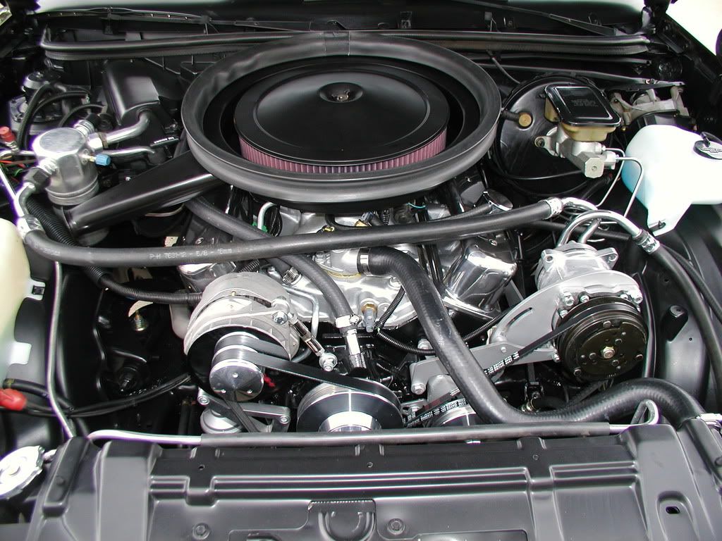

The following winter I installed an electric fan upgrade using a new Ramcharger fan setup and wired up the two speed relays with 2 sensors and a 3 way switch to override the relays when needed. I decided to clean up the underhood harness and like most projects whileImatitis kicked in and before I knew it the entire underhood area was stripped from the windshield forward to bare metal and restored.
This was my first venture outside of the "stock appearing" phase as I added some bright work under the hood when putting it all back together again. I still retained the CCC Carb, distributor and ECM though but completely disassembled the under hood harness and rerouted everything I could to hide as much of it as I could.

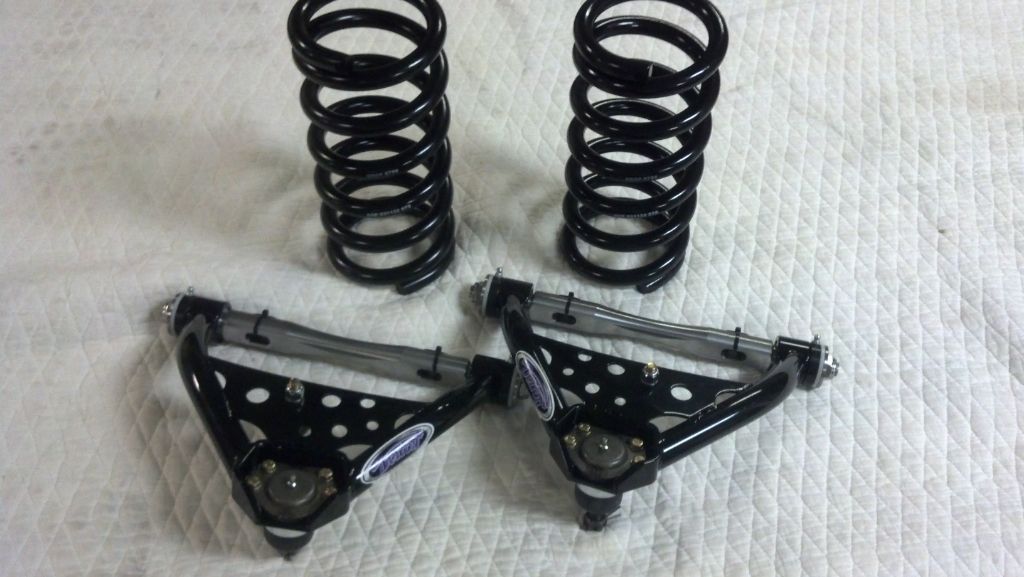

After spending some time studying front end geometry and parts choices, I picked up a set of Detroit Speed front upper control arms and DSE 2" drop springs. When I put those on I also went with the stock spindles again and greatly improved the camber and caster gains along with a better ride and more control over the front of the car...which immediately made me realize just how bad the rear of the car was.

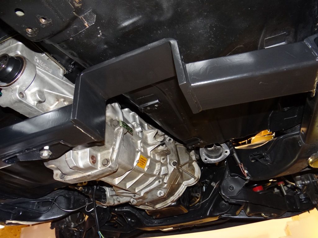

With the new direction I was headed with the car, I made the decision to swap in a T56 instead of trying to build the 200R4 to live up to the abuse I was going to put the car through. I picked up a take out from a 1994 Camaro complete from flywheel to driveshaft, including pedals and everything. Starting the week before Thanksgiving I began pulling the old trans out and preparing to put the T56 in it's place. With a lot of help from the members of the Manual Monte Cult list, the trans swap was fairly straight forward. Biggest problem I ran into was my driver's side Hedman long tube header's collector pointed directly at the clutch slave cylinder, so a new set of headers was also needed along with a rebuild of the front half of the exhaust.

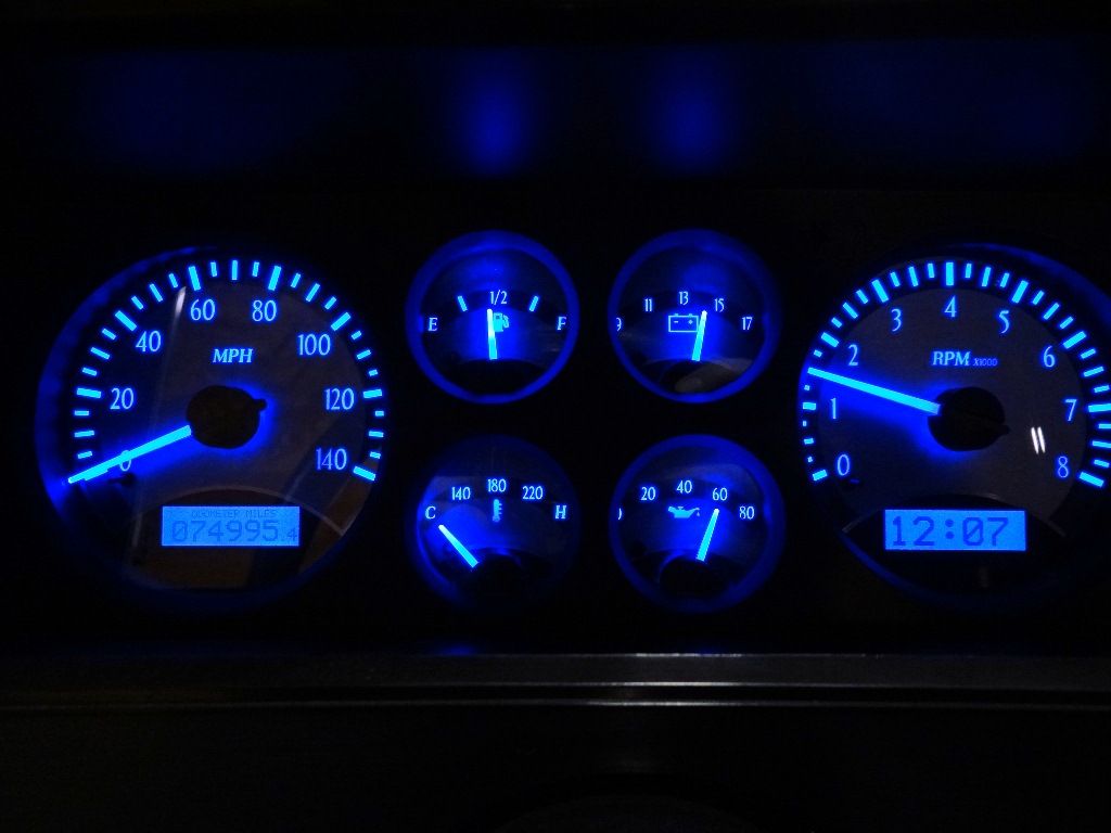

3 weeks and a day later, the car was back on the road, now shifting gears and viewing the vitals of the car through a new VHX Dakota Digital Dash which I upgraded too at the same time. I'm loving it so far, it's like a different car. Everything works very well so far, no strange noises or vibrations...stock clutch that came with the trans works flawlessly and overall...I'm very happy with the swap.

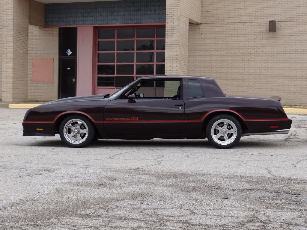

I ran that setup at two events, the first one in the rain and then double duty at the second one where the car got everyone's attention by finishing 18th out of 100 cars in raw time. Pretty good for a nice Street Monte Carlo with a full interior including AC if I say so myself.
