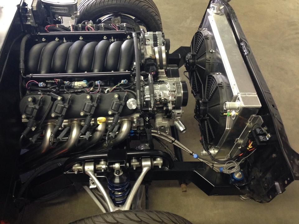

Bsinclair 11-14-2013 06:24 AM
you will have to purchase a front drive system like vintage air or wegner to get it tucked in like you are wanting..
this is a wegner system on my car and you can see how compact it is. yes they are expensive but well designed. something like this may help package your turbo setup easier though...
http://i897.photobucket.com/albums/a...ps6f49f582.jpg
Vince@Meanstreets 11-14-2013 08:28 AM
1 Attachment(s)
After all the failed fitments and alternators hitting the inner fenderwells, power steering hose hitting pitman arms we stepped up to the Wegner kits too. The fit super close and tight. Plus they give you everything with the kit. Water pump, power steering pump, alternator and harmonic balancer. We put them on all of our LS builds.
Im sure GNX7 might have all the parts so a holley bracket should be fine. But its gonna take some magic to get turbo tubing past that.
http://i169.photobucket.com/albums/u...s/102_4439.jpg
