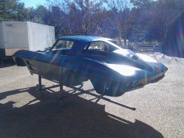

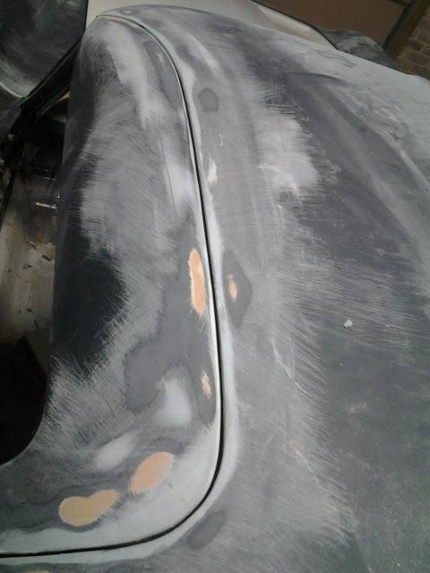

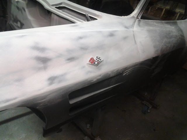

May 29th: Disassembly/wet sanding with 600
http://i852.photobucket.com/albums/a...ps93ac68b8.jpg
http://i852.photobucket.com/albums/a...ps05ce7182.jpg
http://i852.photobucket.com/albums/a...psc122fb75.jpg
Restocreations 11-13-2013 02:57 PM

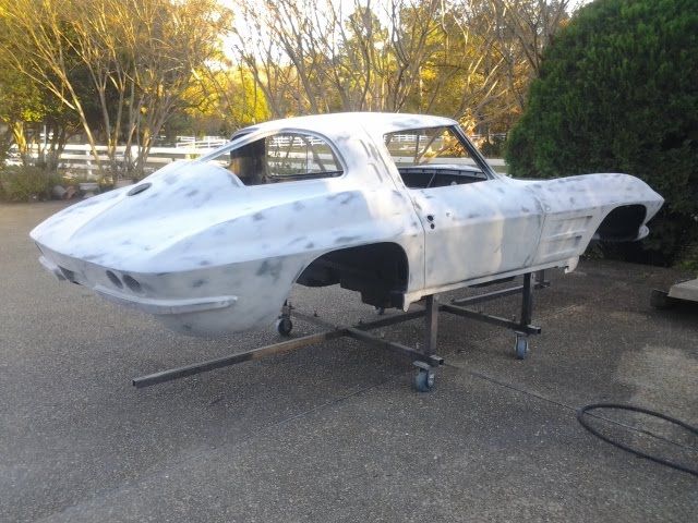

32 Man hours total

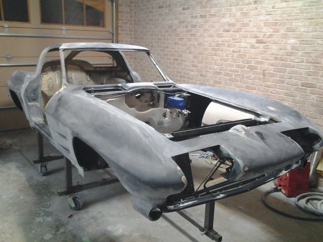

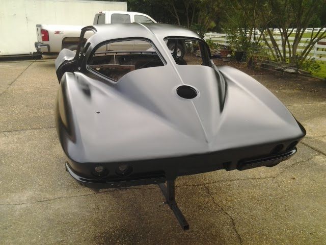

Body completely naked of all exterior parts and glass(minus tail lamps), the paint has been wet sanded with 600 grit, all interior molding has been removed, rear carpet is out, and the door alignment has been adjusted as best as possible.

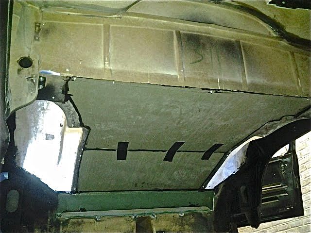

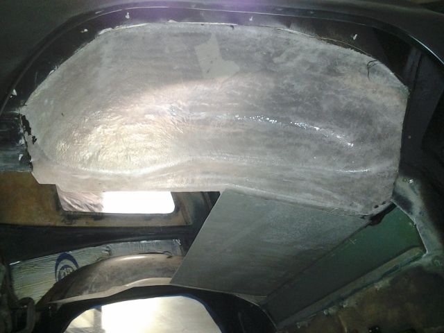

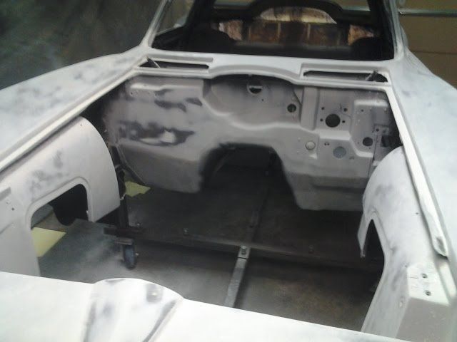

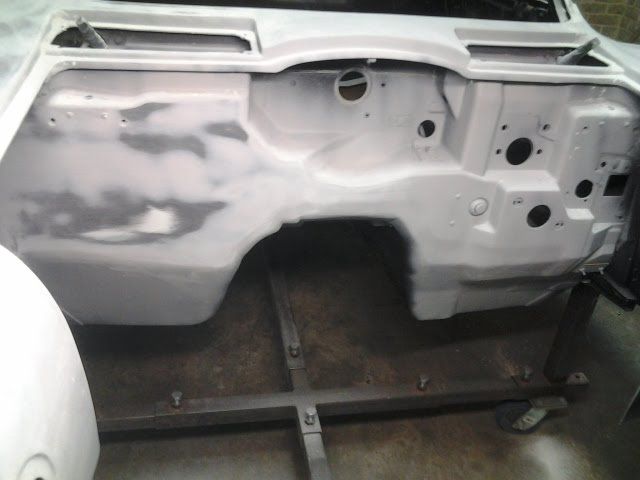

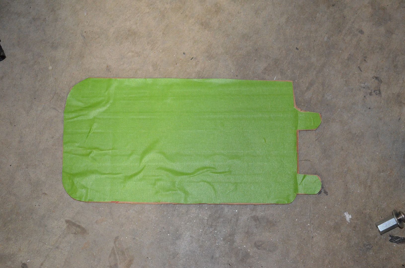

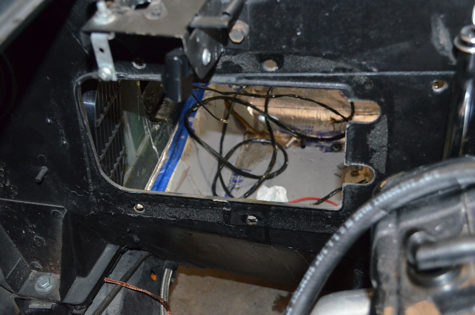

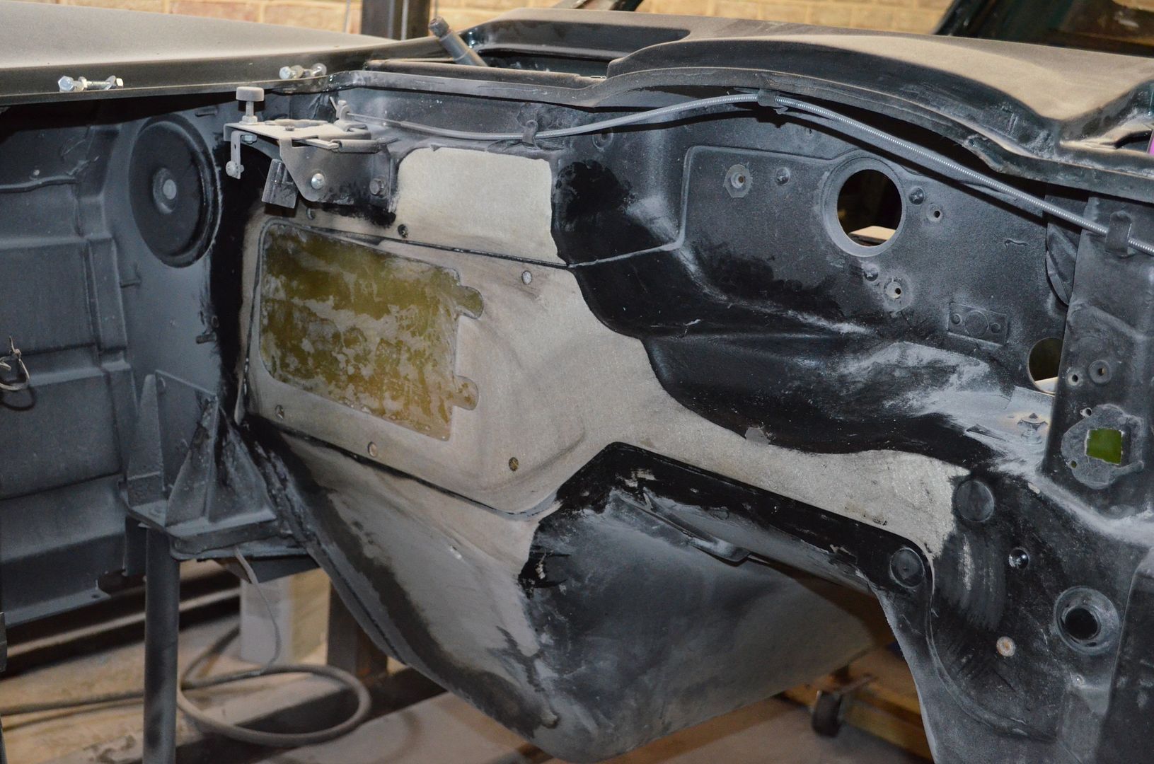

I was watching overhaulin' the other night and saw how they were using tape to create a form for fiberglass, so i tried it on the firewall where the heater box hole will no longer be necessary thanks to the newer vintage air unit. It worked well, but i ended up needing to still put a layer of glass on the backside for support.
Clean slate
http://i852.photobucket.com/albums/a...ps87736b88.jpg
My opponent
http://i852.photobucket.com/albums/a...ps36c6f62e.jpg
Template for fiberglass mat made out of tape, which i then transferred to cardboard.
http://i852.photobucket.com/albums/a...ps8f545c57.jpg
http://i852.photobucket.com/albums/a...ps71c27ba4.jpg
Firewall glassed in and sanded around area to be filled.
http://i852.photobucket.com/albums/a...ps2f5a4fa2.jpg
First skim coat of evercoat filler.
http://i852.photobucket.com/albums/a...ps99bce3db.jpg

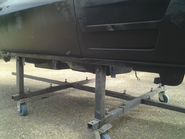

New dolley came in yesterday. I assembled it this evening and mounted it under the car. No big updates for now. I've been busy hustling to get another car ready for paint, so i havent had time to work on the 63 this week.
http://i852.photobucket.com/albums/a...ps3960c44e.jpg

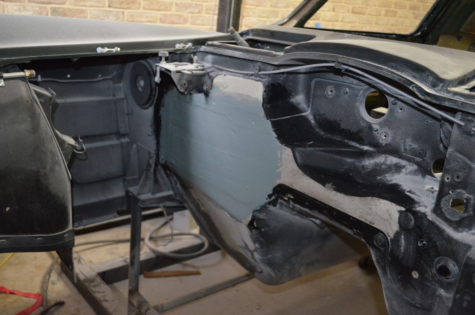

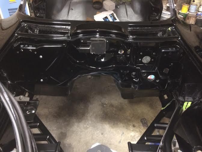

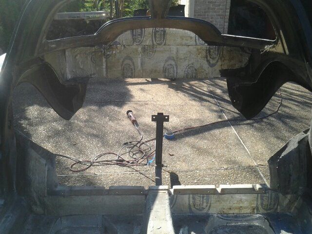

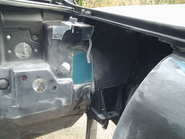

I removed a large majority of the old paint from the firewall and fender skirts, but still a lot to go before epoxy primer. At this point, i was also in the process of fitting the new components on the firewall and in the engine bay to insure everything fit correctly.
http://i852.photobucket.com/albums/a...ps7993101e.jpg
http://i852.photobucket.com/albums/a...ps3bbe79a2.jpg
http://i852.photobucket.com/albums/a...ps7de7aae7.jpg

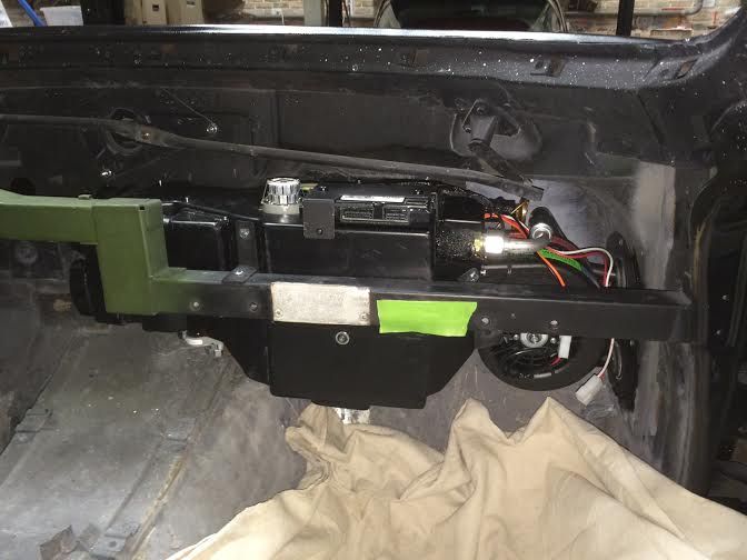

Making sure everything lines up with the new vintage air system. Still a good bit of body work to do on the firewall where i deleted the heater box cut out.
http://i852.photobucket.com/albums/a...psb12bc528.jpg

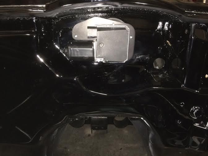

New wiper motor from Detroit Speed.
http://i852.photobucket.com/albums/a...pse0b1b3cc.jpg

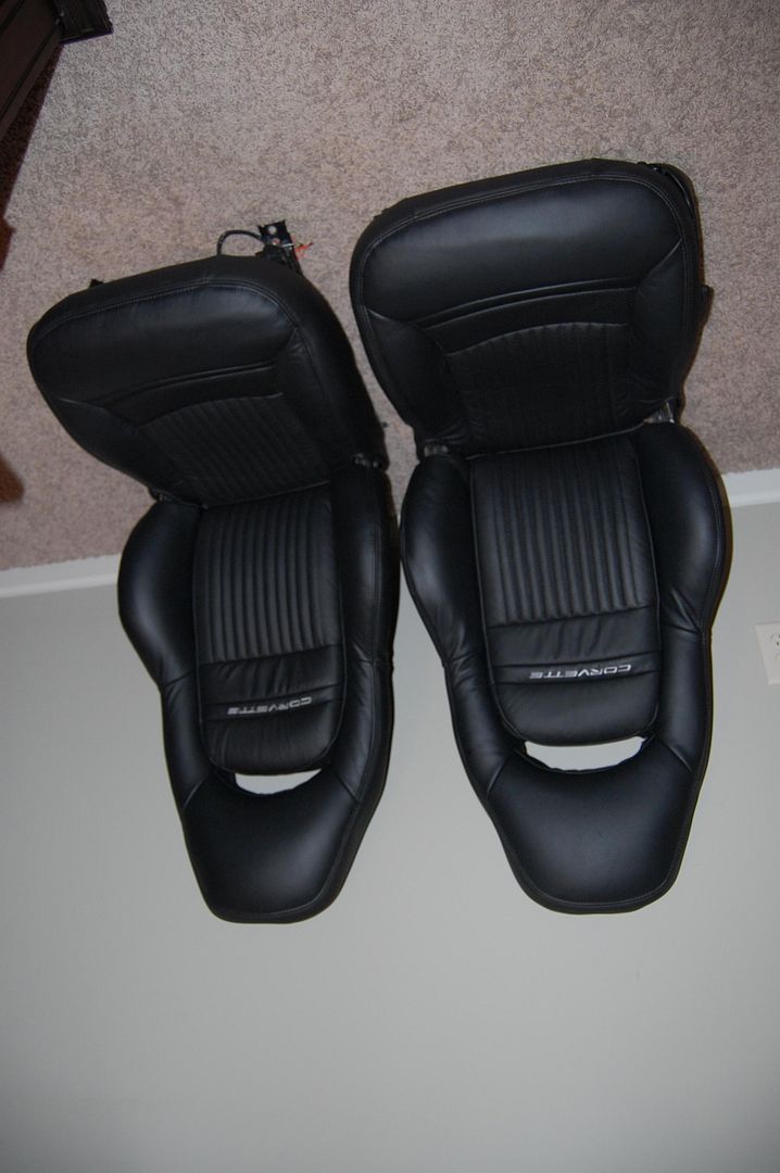

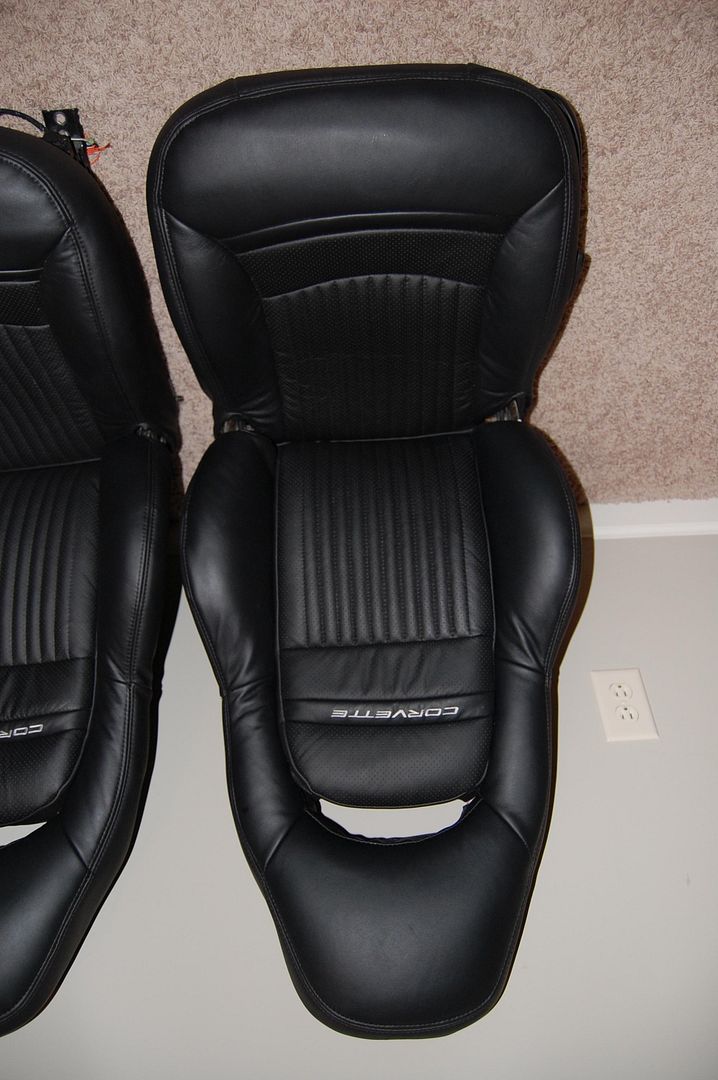

Seats recovered in new black leather.
http://i852.photobucket.com/albums/a...pse82edb1e.jpg
http://i852.photobucket.com/albums/a...psfddfae68.jpg

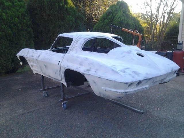

Restocreations 11-13-2013 03:06 PM
70 hours

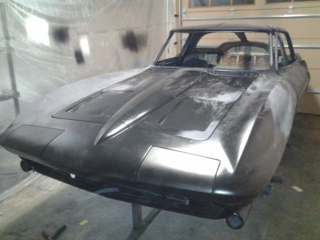

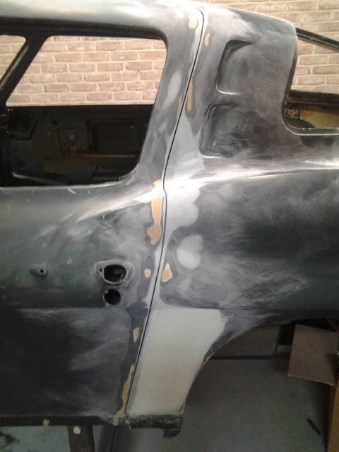

I really did not want to get this far into bodywork, but the door gaps on this car were massive at the front and rear and I just couldn't leave them that way.
Before
http://i852.photobucket.com/albums/a...ps83e2cc4c.jpg
After, which ended up being too tight.
http://i852.photobucket.com/albums/a...psbc93a629.jpg
http://i852.photobucket.com/albums/a...psa77210d4.jpg
Smoothing out the firewall took a lot longer than i initially thought it would.
http://i852.photobucket.com/albums/a...ps3dad36ca.jpg

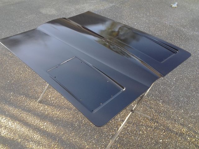

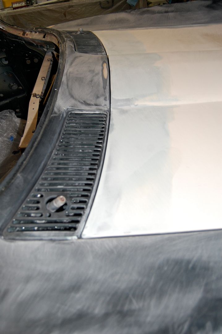

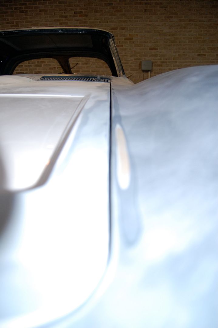

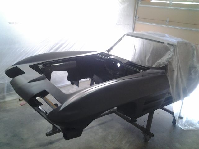

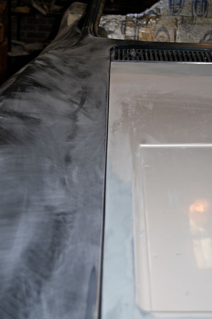

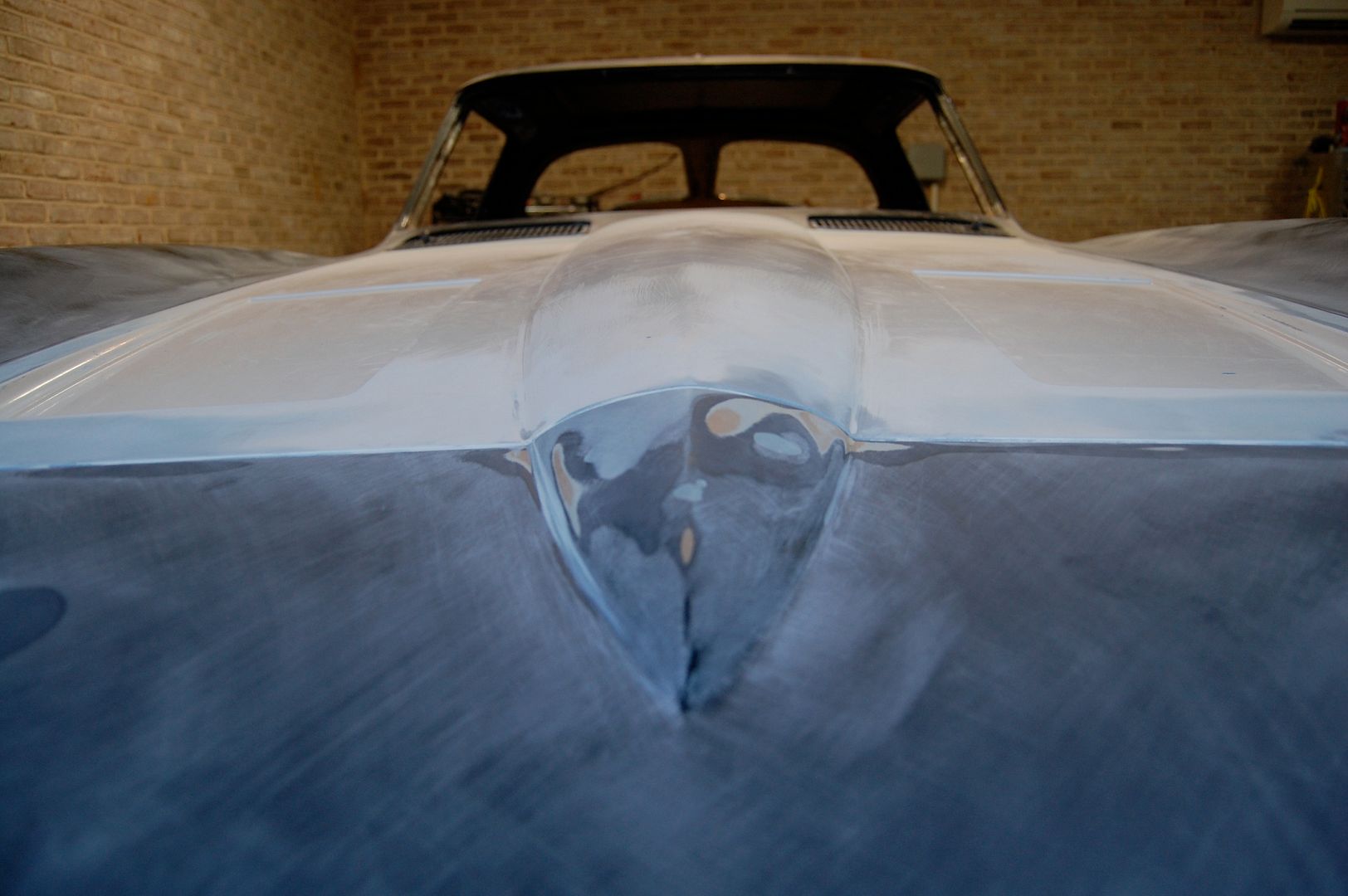

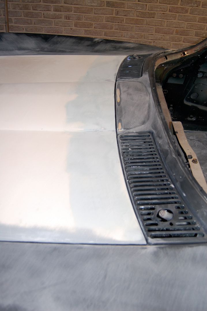

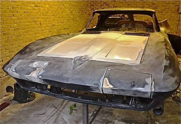

The hood finally was finished by shermersheim and arrived. Bolting it on made me realize that the hood surround is wavy from previous bodywork.
http://i852.photobucket.com/albums/a...ps8b94b0f5.jpg
http://i852.photobucket.com/albums/a...psb68fe141.jpg

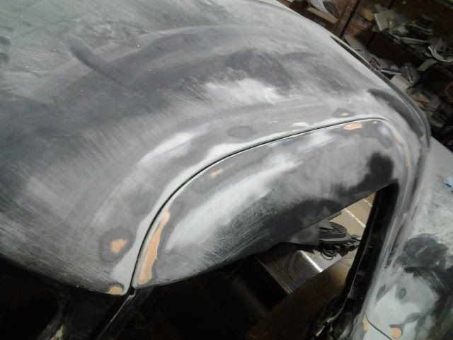

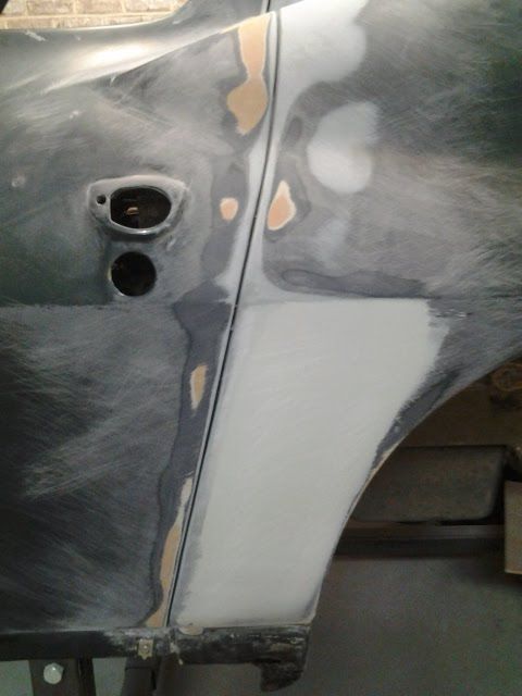

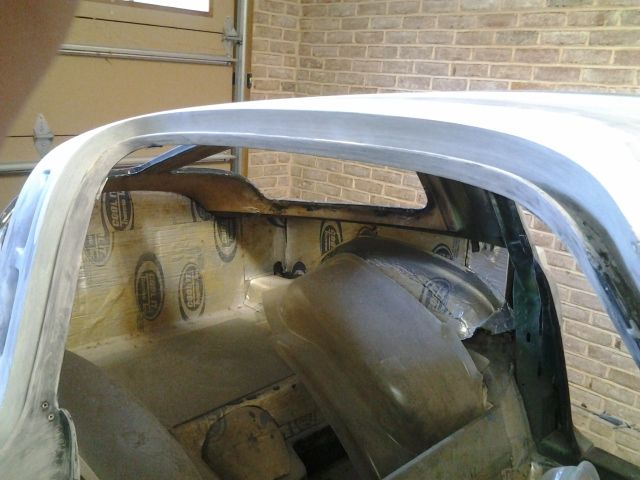

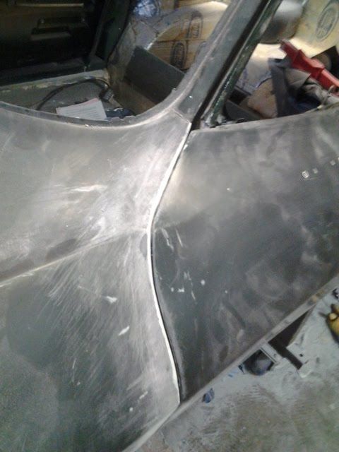

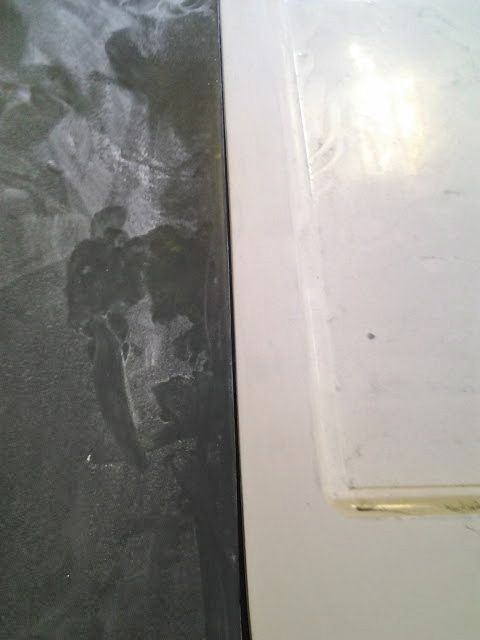

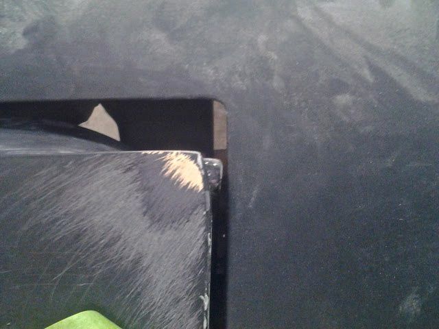

Finished narrowing the gap on the driver's side door and fitting the door to the roof, quarter, and fender. The door stuck out past the roof panel just in front of the indentations previously , but that problem is now resolved.
http://i852.photobucket.com/albums/a...ps15d16228.jpg
http://i852.photobucket.com/albums/a...psa4cc1134.jpg
The door had dipped down at the rear corner and sat lower than the body. It wasn't terrible, but it needed to be addressed.
http://i852.photobucket.com/albums/a...pse8872b1e.jpg
http://i852.photobucket.com/albums/a...ps4eab7b6a.jpg

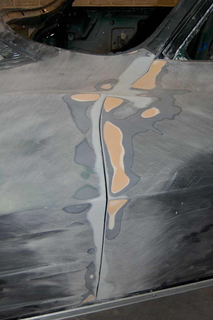

Front of door Before
http://i852.photobucket.com/albums/a...ps3889880d.jpg
Front of door After. I will need to remove the door to finish smoothing things out.
http://i852.photobucket.com/albums/a...ps9ae0fdad.jpg
Still a good bit of filling and smoothing to do on the passenger door, but the gap is already nice and tight after building up the jamb with evercoat vette panel filler.
http://i852.photobucket.com/albums/a...psac0c0a0f.jpg

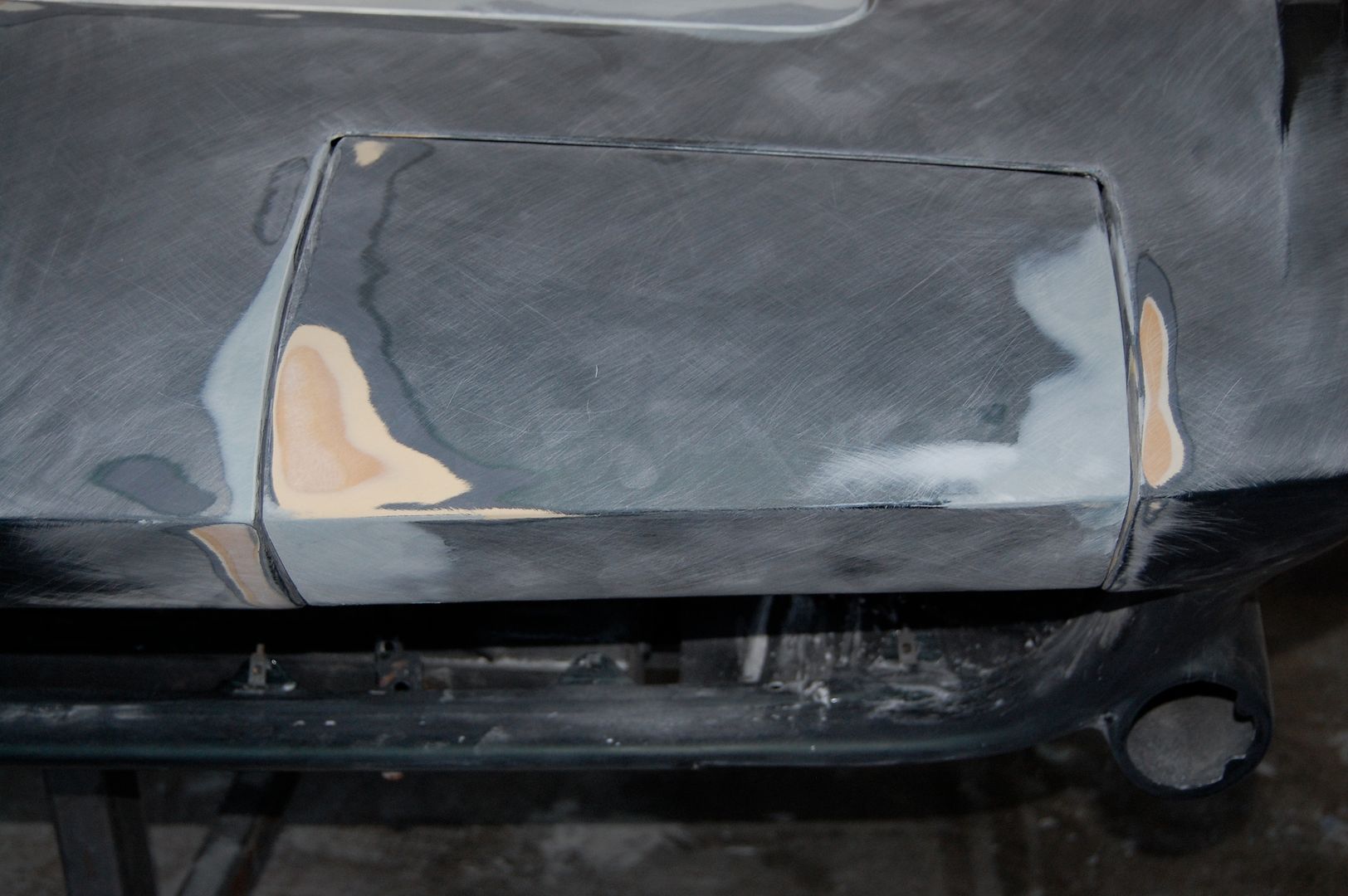

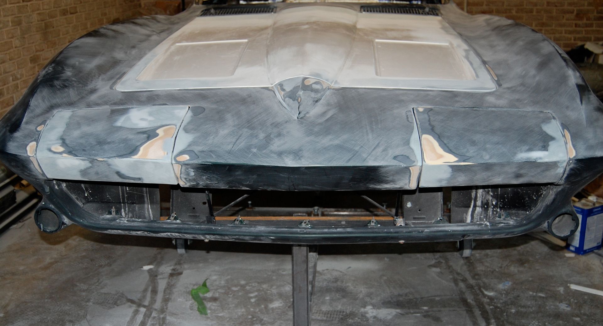

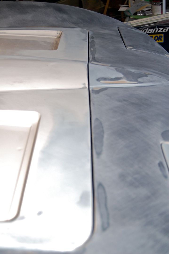

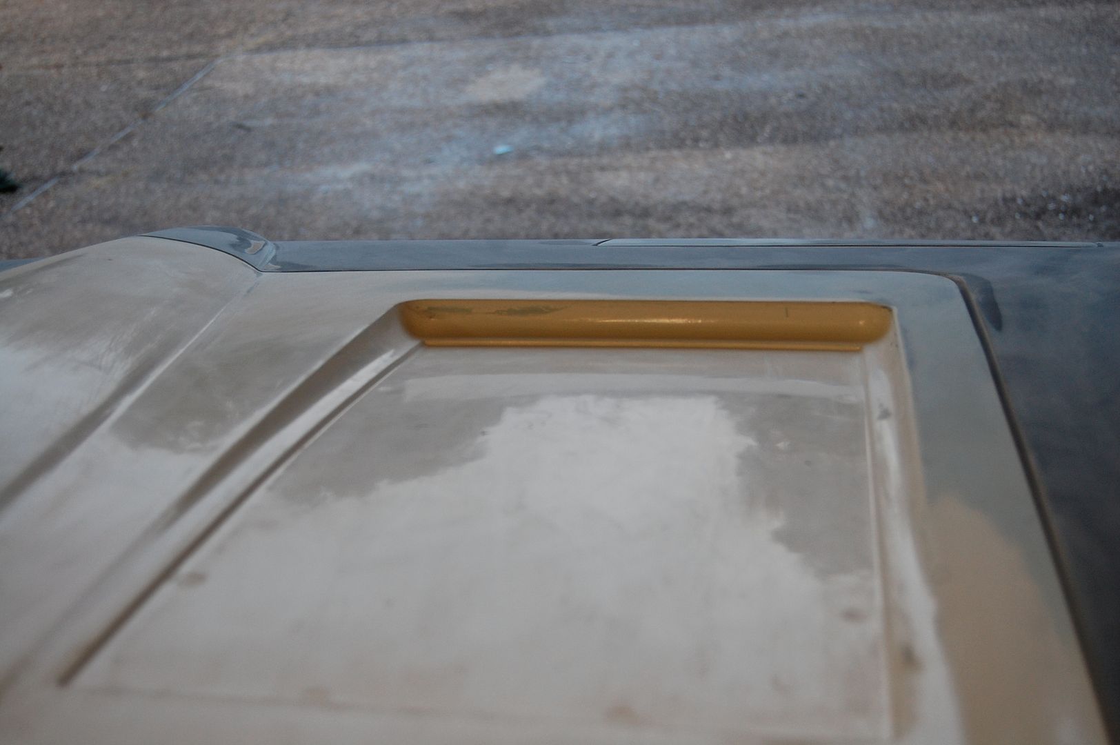

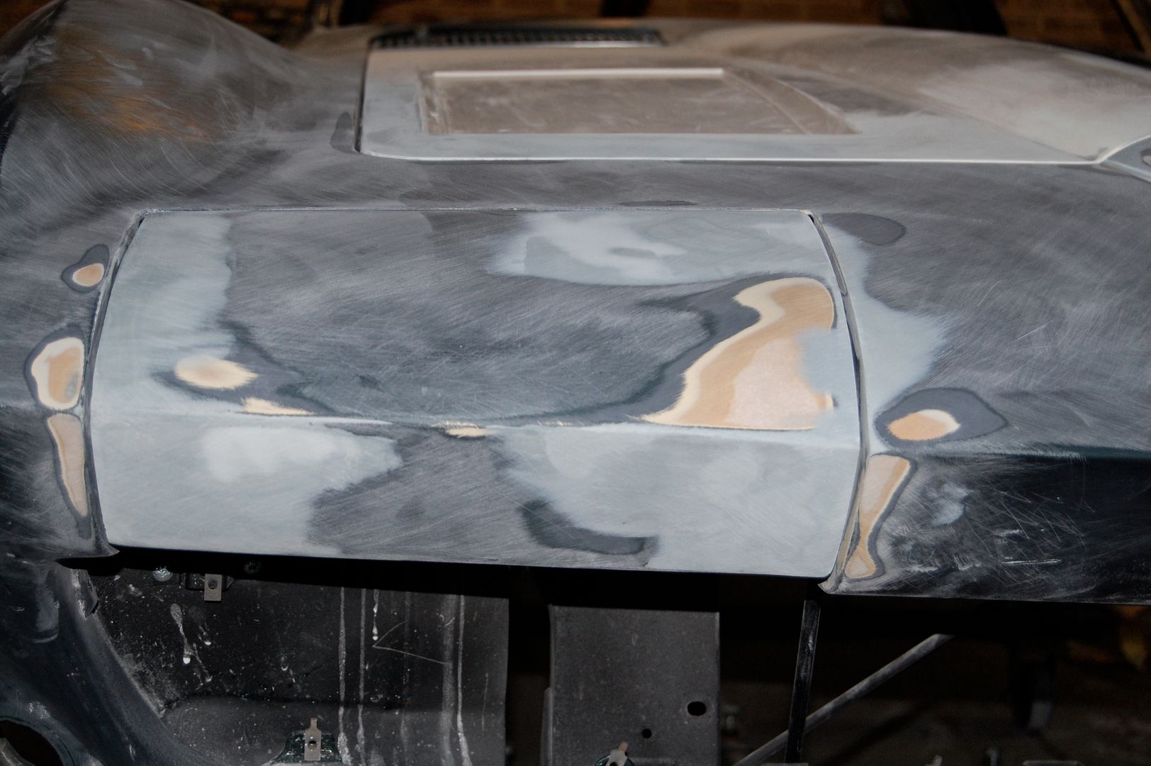

119 hours At this point I started to have a whole new appreciation for people that do body work day in and day out. Miserable!!!
IF you purchase a new hood, order it in two pieces and bond it together yourself with 3m panel bond. This hood fit like crap and it is supposed to be the best on the market
This was the worst fitting spot on the hood.
Before
http://i852.photobucket.com/albums/a...psd11b6f67.jpg
After
http://i852.photobucket.com/albums/a...ps70b72959.jpg
http://i852.photobucket.com/albums/a...pse4d20efc.jpg
Before-Zero space on passenger side
http://i852.photobucket.com/albums/a...pseffef9aa.jpg
After
http://i852.photobucket.com/albums/a...ps209939d7.jpg
Front Before-No space and sat way too low at front edges.
http://i852.photobucket.com/albums/a...psaebcd34a.jpg
After
http://i852.photobucket.com/albums/a...ps01e4b8f5.jpg
Driver's side before-too wide
http://i852.photobucket.com/albums/a...ps72b52854.jpg
Driver's side after
http://i852.photobucket.com/albums/a...ps6507133e.jpg

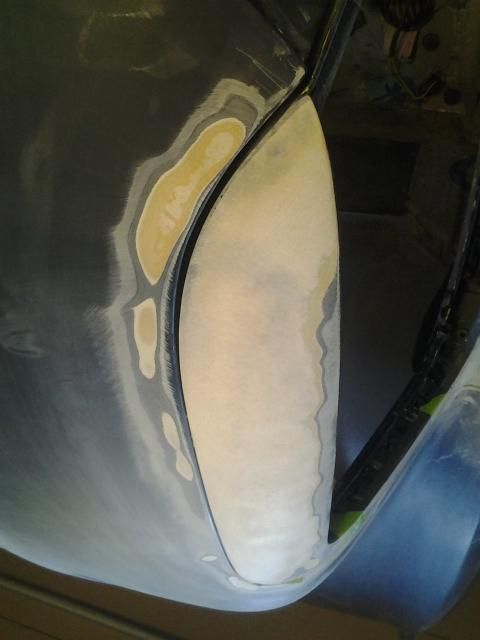

Had an issue with the headlamp bucket...the casing was too narrow and the bezel was to wide. So, i has to shave the edge of the bezel and build up the casing. Once i had it properly aligned, i had to build up the inboard corner and the front of the casing at the lower nose portion of the surround.
Before
http://i852.photobucket.com/albums/a...ps3be1c8df.jpg
After
http://i852.photobucket.com/albums/a...ps5f29d5d7.jpg
http://i852.photobucket.com/albums/a...psdb44d4c7.jpg
Both Required attention, but the driver's side was not nearly as bad.
http://i852.photobucket.com/albums/a...psfbcd0914.jpg
