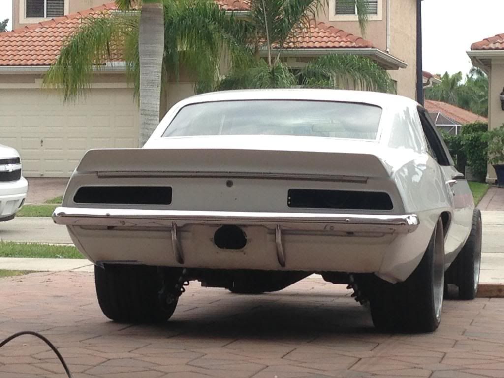

I bought this car earlier in the year (2013) with small intentions just to update the steering, suspension, brakes, and a few other things and just enjoy it. I should have known better cause I am not capable of ever doing that weather its with a daily driver or a project.
Here is the car as it looked when I got it
http://i4.photobucket.com/albums/y13...ps76a139a3.jpg
http://i4.photobucket.com/albums/y13...ps7be5ccb8.jpg

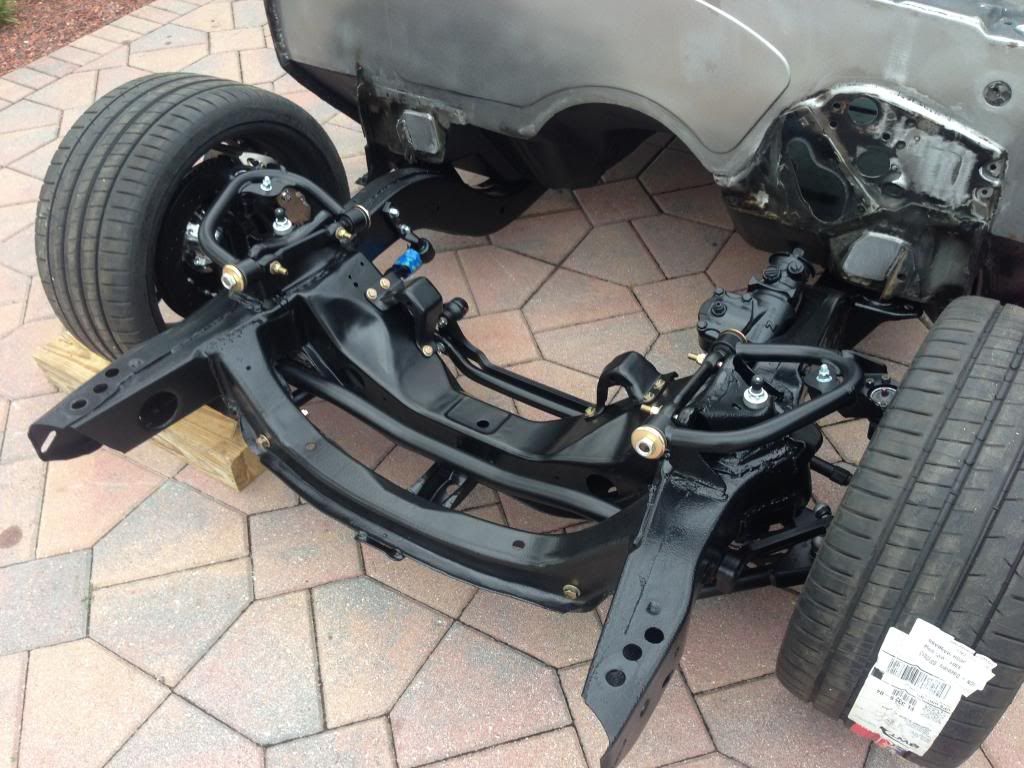

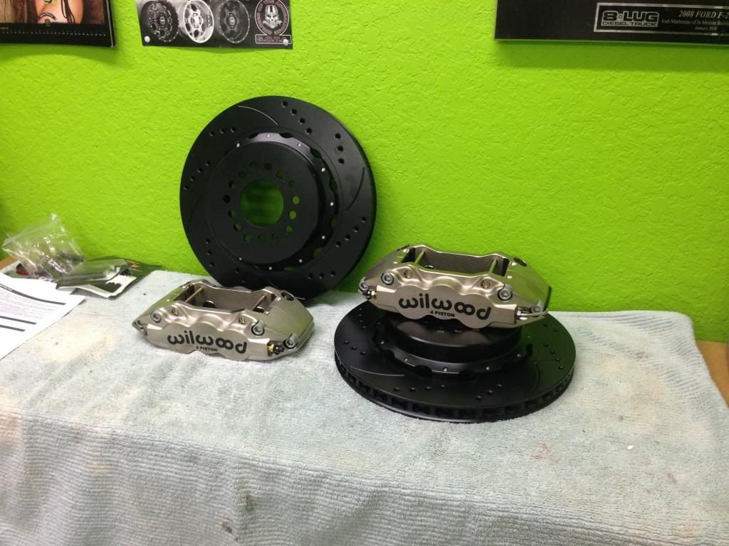

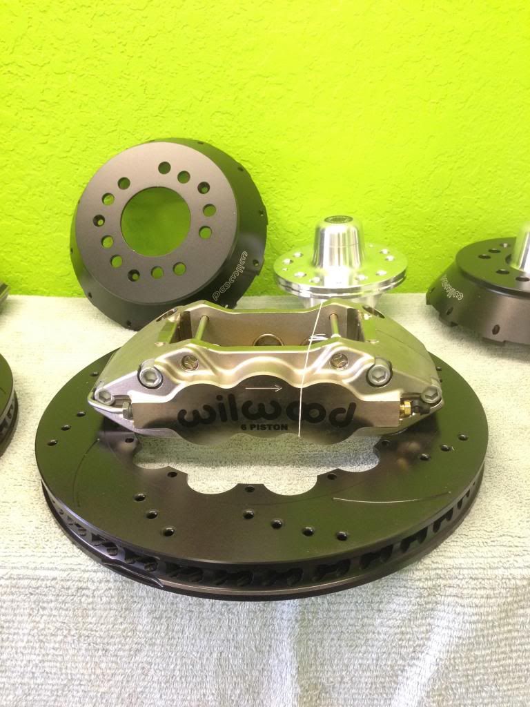

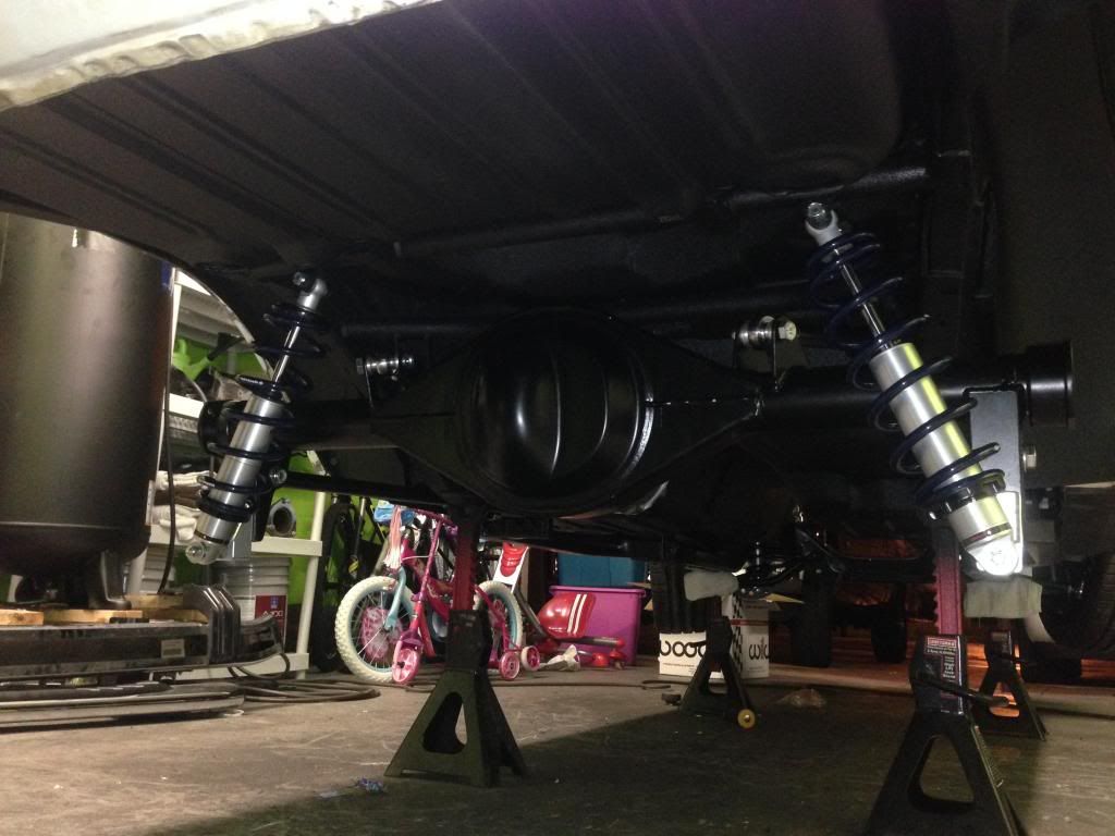

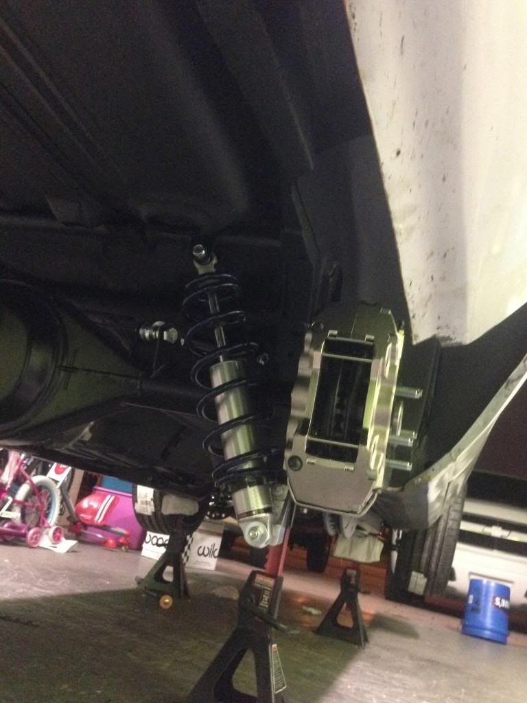

Once I started to tear it apart and order parts it spiraled out of control. I pulled the whole car apart down to a shell. Removed the interior, front clip and sheet metal, engine/tranny/rearend, all wiring and lights removed etc etc.
With the help of some good people, Darren@ridetech, Jeremy at Miranda Built, the folks at Wilwood, COR Wheels, and Michelin Tires, I ended up with a healthy parts list to get me thru the next few months.
I ended up with the following.

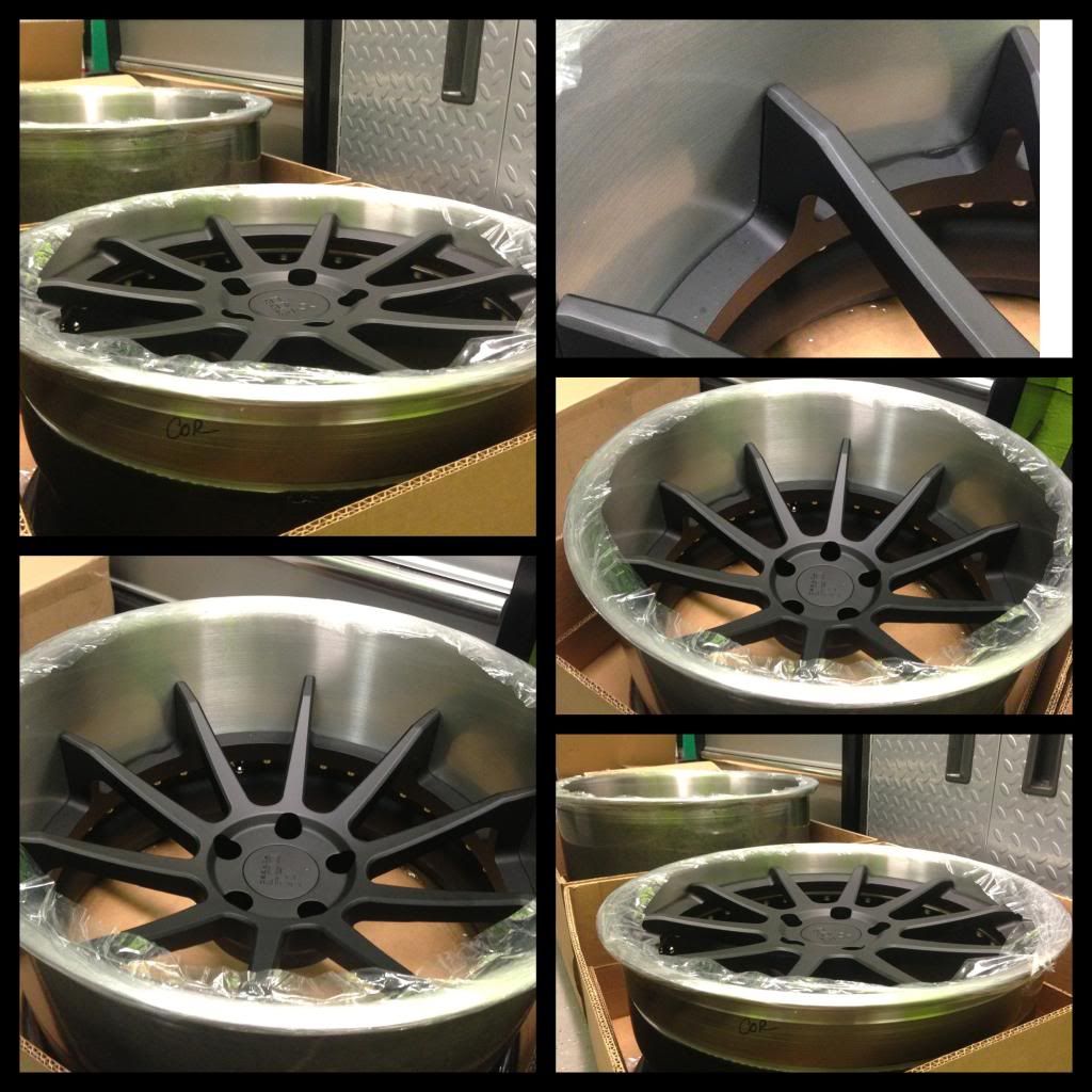

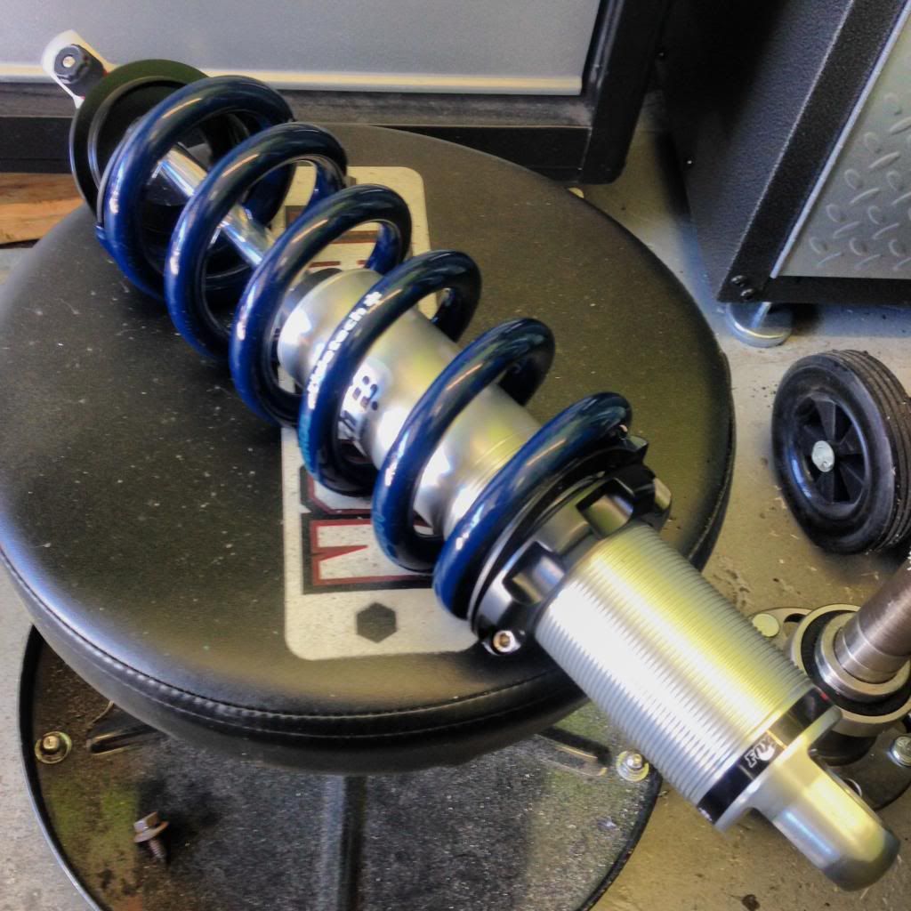

Ride Tech Stage 2 Suspension Package with Muscle Bar and Tru-Turn Steering

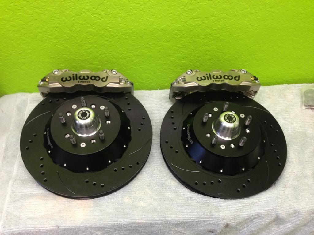

Wilwood 14" 6 Piston Fronts and 14" 4 Piston Rears all with upgraded Nickel Calipers
COR Cypher 3 Piece Wheels 20x12 in the rear and 19x9 in the Front
Michelin Pilot Spots 325/25/20 Rear and 265/30/19 Front
DSE Mini Tubs

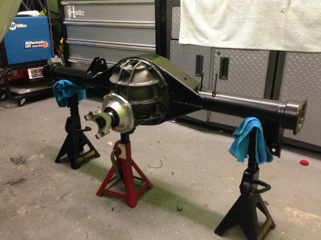

QuickPerformance 9" Narrowed with Billet ends, new center section etc
http://i4.photobucket.com/albums/y13...ps2deab412.jpg
http://i4.photobucket.com/albums/y13...psfd40b4d2.jpg
http://i4.photobucket.com/albums/y13...ps1a3758dc.jpg
http://i4.photobucket.com/albums/y13...psae7ebc85.jpg
http://i4.photobucket.com/albums/y13...ps9d89ffea.jpg
http://i4.photobucket.com/albums/y13...ps464ae04a.jpg

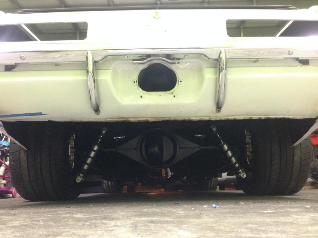

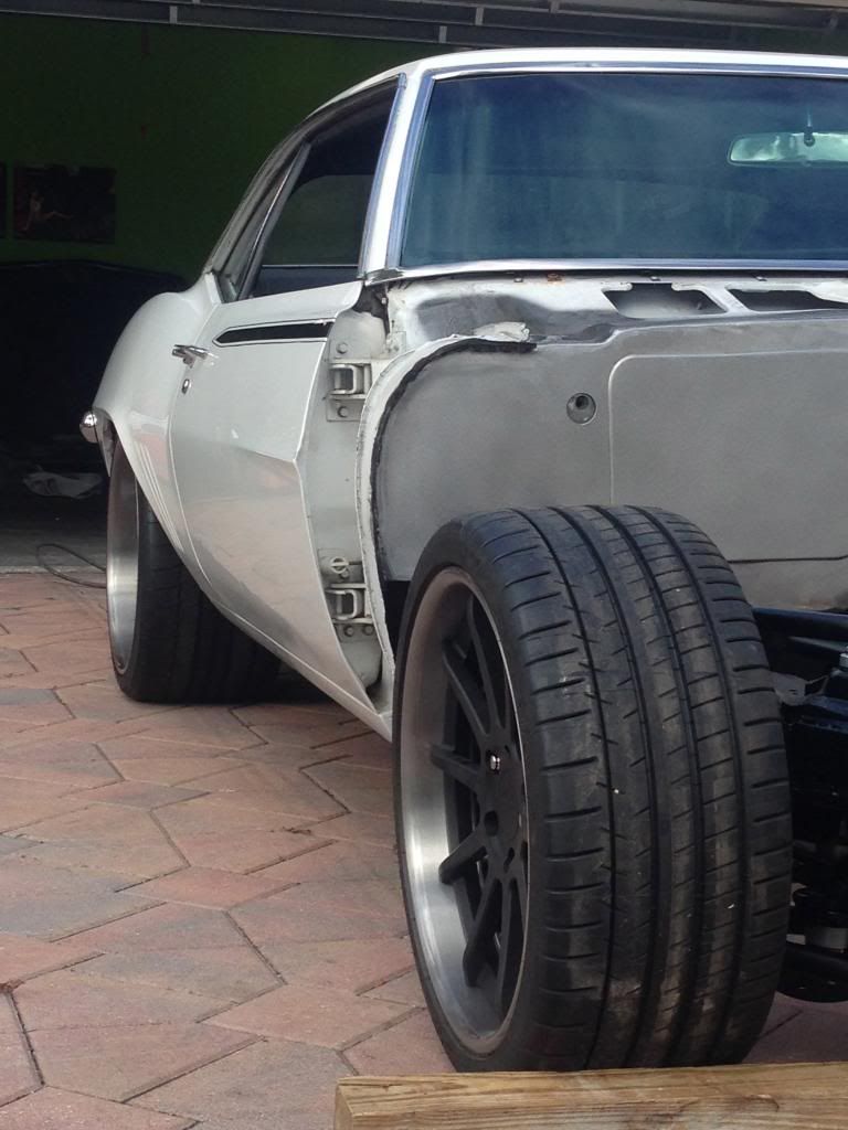

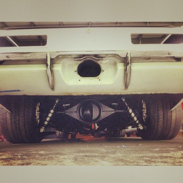

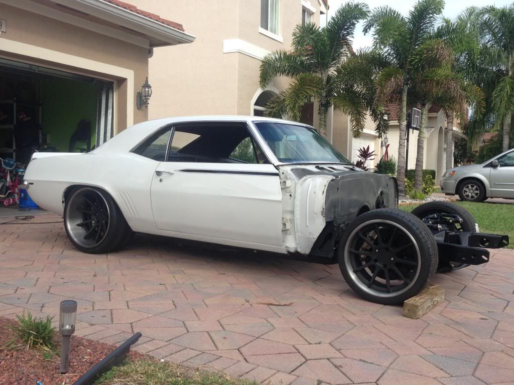

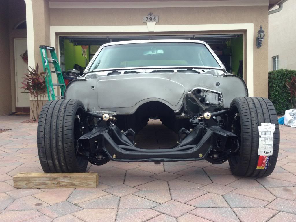

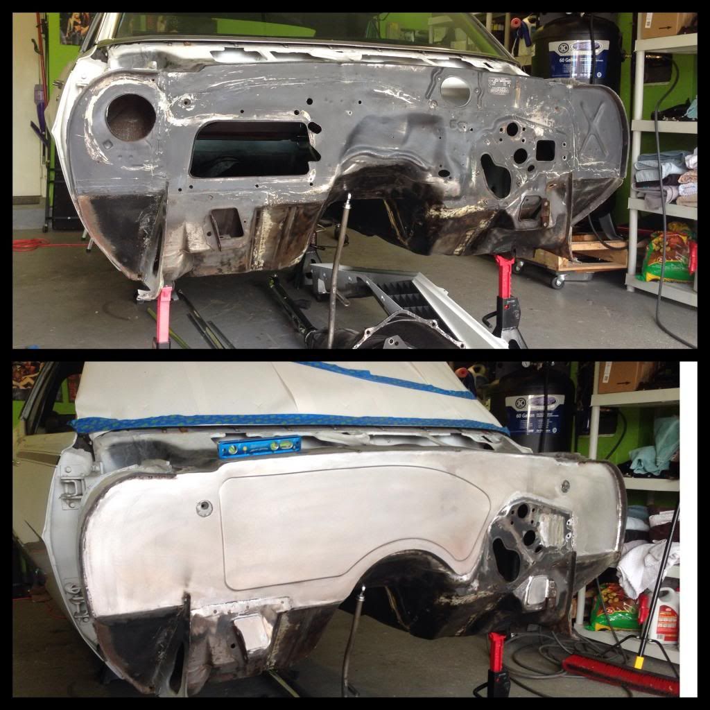

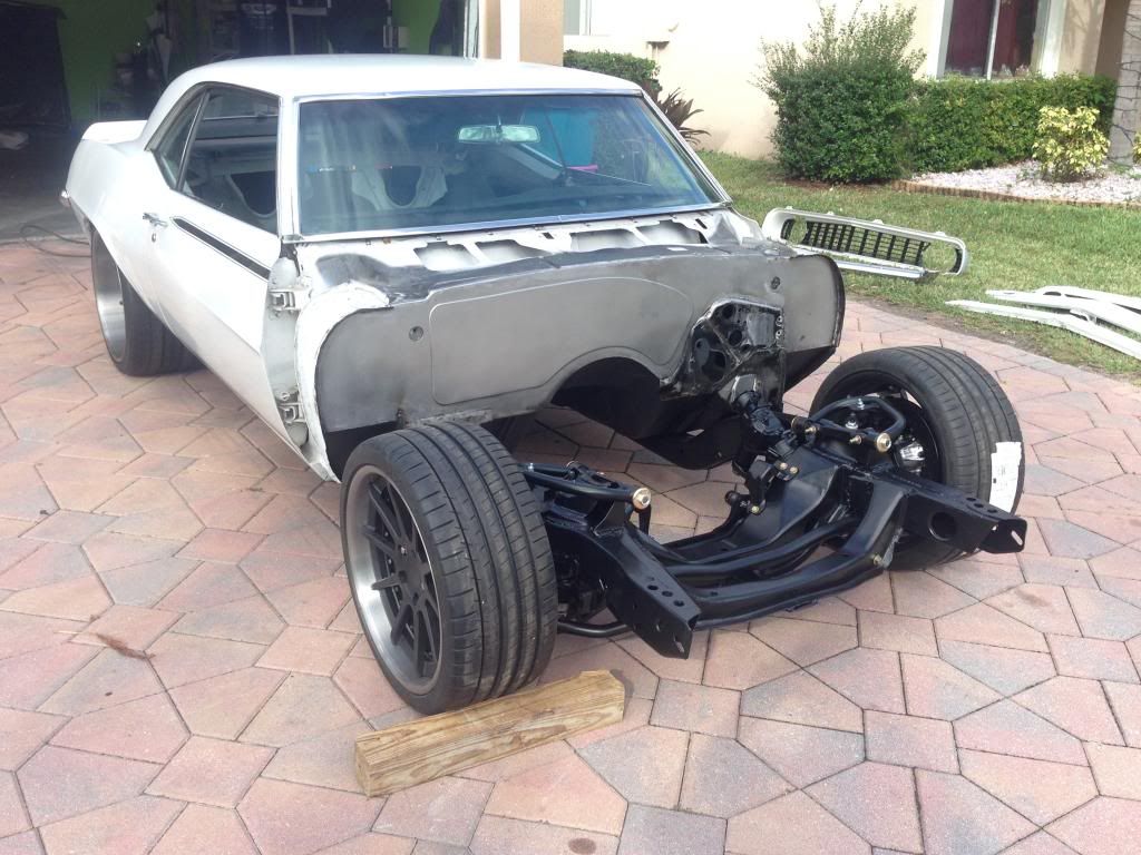

My good friend Jeremy of Miranda Built has really helped me out on this build.

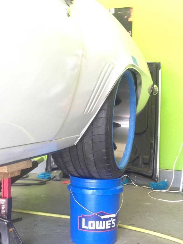

We immediately started to tackle the mini tubs, then he worked his magic and shaved the firewall, and got the car rolling back on its own 4 tires.
http://i4.photobucket.com/albums/y13...ps7400a26d.jpg
http://i4.photobucket.com/albums/y13...ps13388132.jpg
http://i4.photobucket.com/albums/y13...psc605dbf2.jpg
http://i4.photobucket.com/albums/y13...ps0bfb45ed.jpg
http://i4.photobucket.com/albums/y13...ps91ada108.jpg
http://i4.photobucket.com/albums/y13...ps1622b321.jpg
http://i4.photobucket.com/albums/y13...ps233331e6.jpg
http://i4.photobucket.com/albums/y13...ps378b98c1.jpg
http://i4.photobucket.com/albums/y13...ps9f9097ef.jpg
http://i4.photobucket.com/albums/y13...ps56a17e9c.jpg
http://i4.photobucket.com/albums/y13...ps13217180.jpg
http://i4.photobucket.com/albums/y13...ps993df16a.jpg
http://i4.photobucket.com/albums/y13...ps6e802881.jpg
http://i4.photobucket.com/albums/y13...ps52d6ed33.jpg

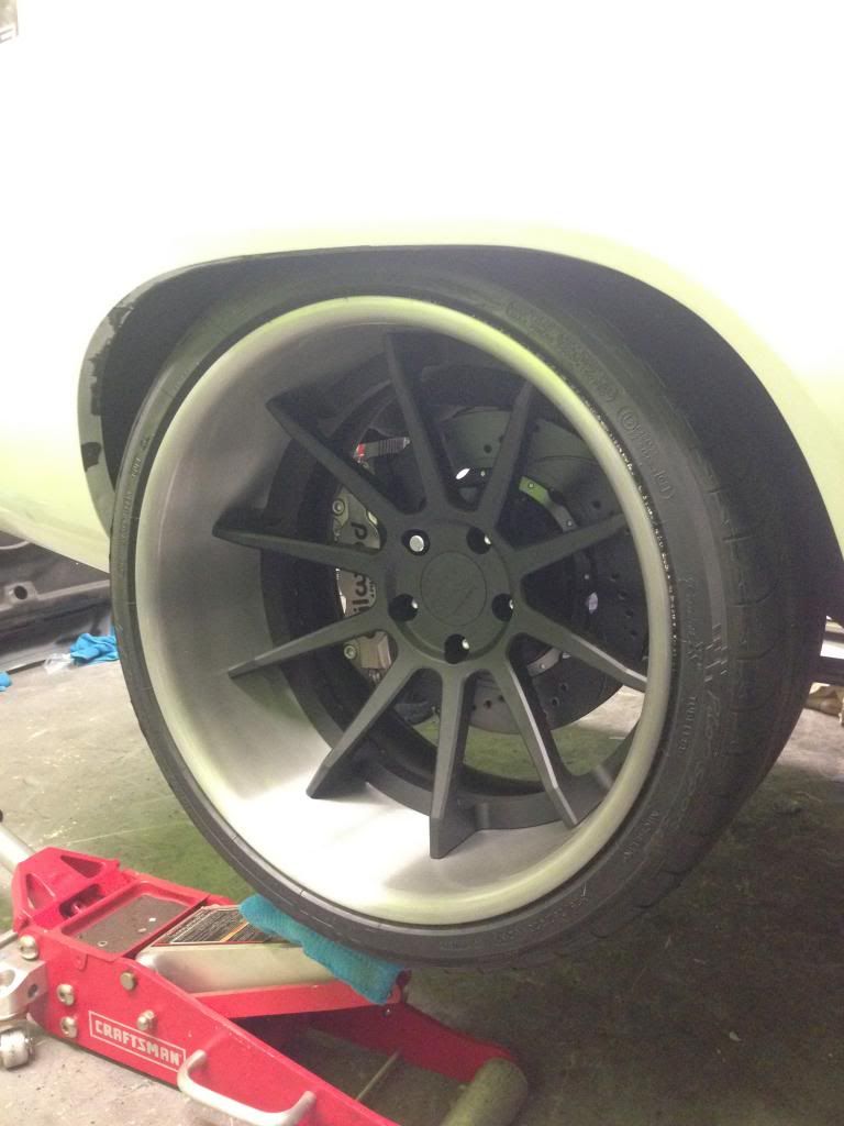

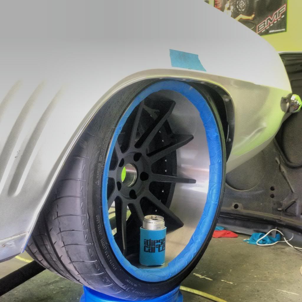

streetbird 11-18-2013 01:20 PM
love the wheels, nice start.
Does the 265 rub on the stock subframe?
It seem wide
