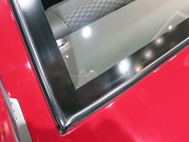

I would like to put the front and rear glass flush to the body of my 69 Nova.
Can I just raise the window 1/4 inch with some rubber blocks and use a special molding to fill the gap between the body and the glass?
I was at SEMA and I think I saw some of these solutions.
Can anyone give me some advice?
Pictures?

Vince@Meanstreets 12-22-2013 10:51 AM
Get I touch with you local glass company, they should know what seals would work best. I picked up a 1 1/4" lip seal that hides the gap but it's tought to get the corners right.
Instead of rubber blocks you can have your glass installer use eurethan to build it to the right level.
