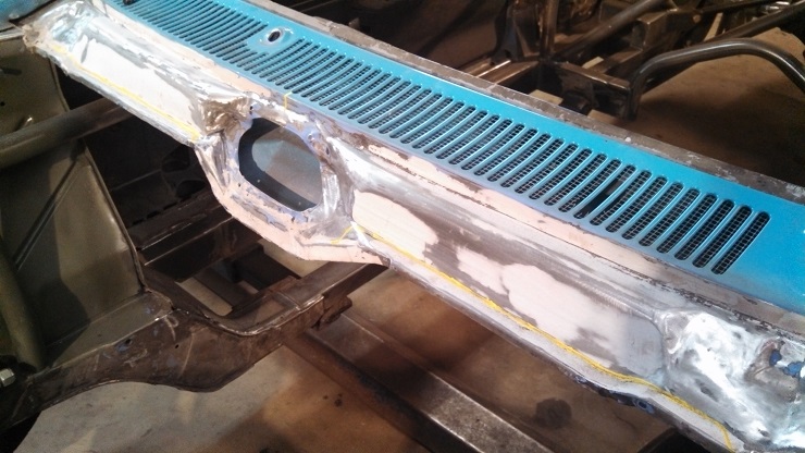

Due to the engine set back on my big block Ford powered AMC Javelin, I need to modify my cowl. I would like to eliminate the factory wiper motor mounting location. I have began looking at utilizing a street rod type hidden wiper kit. I would like to move the motor inside, on the firewall instead of on the engine compartment side of the cowl/firewall.
Does anybody have a good suggestion on how to accomplish that?
Vince@Meanstreets 12-22-2013 09:22 PM
Are you able to keep the stock location on the arm pivot shafts?
If you know a fabricator, you can mount the motor behind the glove box area and make an extension for the main transmission arm to motor. Don't kill the wiper motor mounting flange, you can use that to remount the motor else where. Do you have a picture of your cowl sides?

Barnburner 12-23-2013 05:13 AM
1 Attachment(s)
Thanks for the input!
I will be able to keep everything in factory location except the motor.
I am looking at using http://www.specialtypowerwindows.com...s.php?c=2&t=13
This is a cable driven unit that will allow me to run the motor under the dash
Attachment 44137
