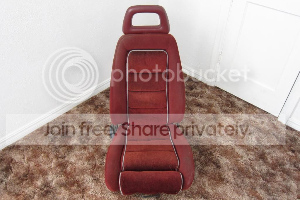

Well, I found some Mustang Recaros or so I thought. I should have done more research but the seats I got aren't the 79-83 Recaros that came in Mustangs. I think they are Recaros but can't find anything on them that says so. I haven't disassembled them either so maybe a stamping is buried. If anyone know what they are, I'd greatly appreciate the help in identifying the seats.
Regardless, I like the design, they are comfortable and supportive, and fit in the car. They also have that old school vibe that I wanted with the square head rests. No netting but that's ok. Got them shipped in from Indiana for under $400 and they don't need to be rebuilt right away. I'm happy.
Here's one of the seats
