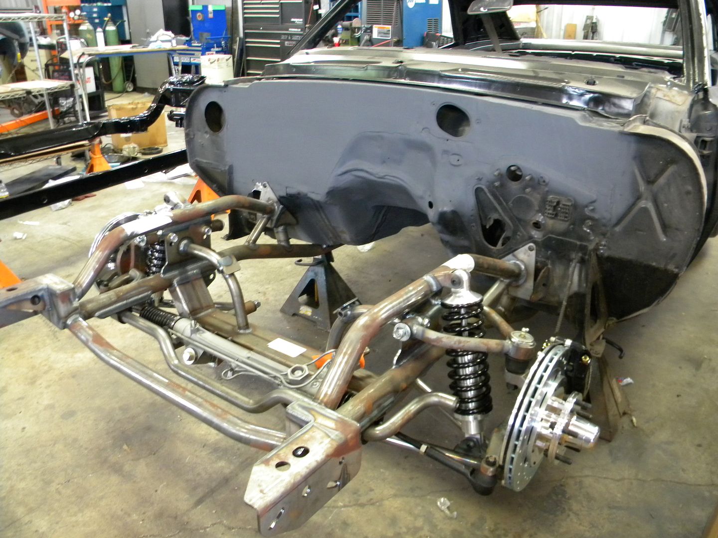

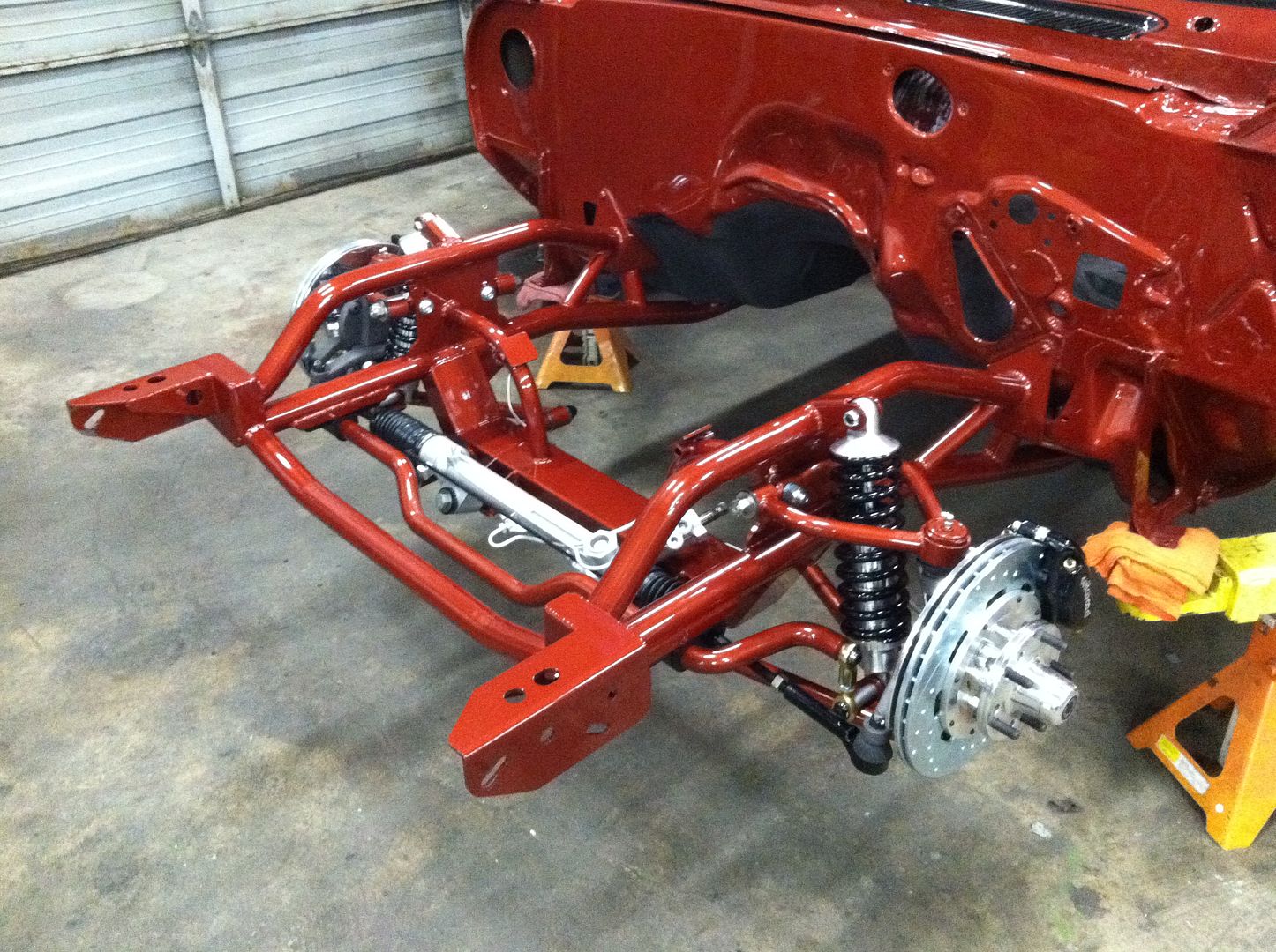

Total Cost Involved front Subframe
Detroit Speed 3" Drop leafs w/ Afco Sliders

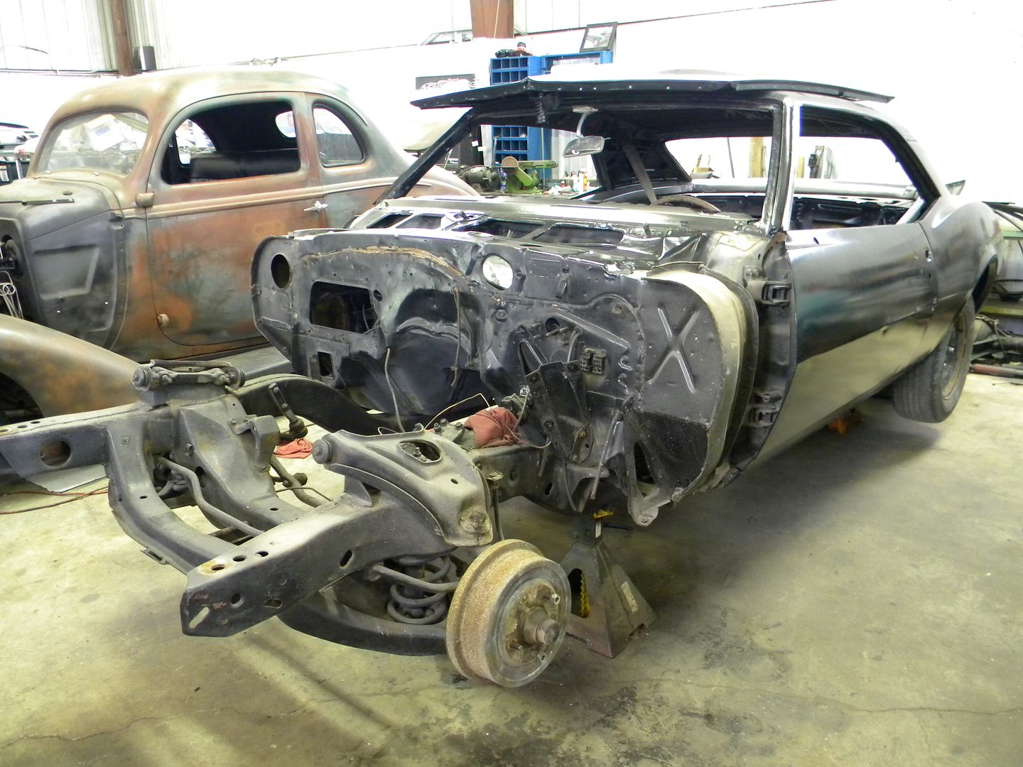

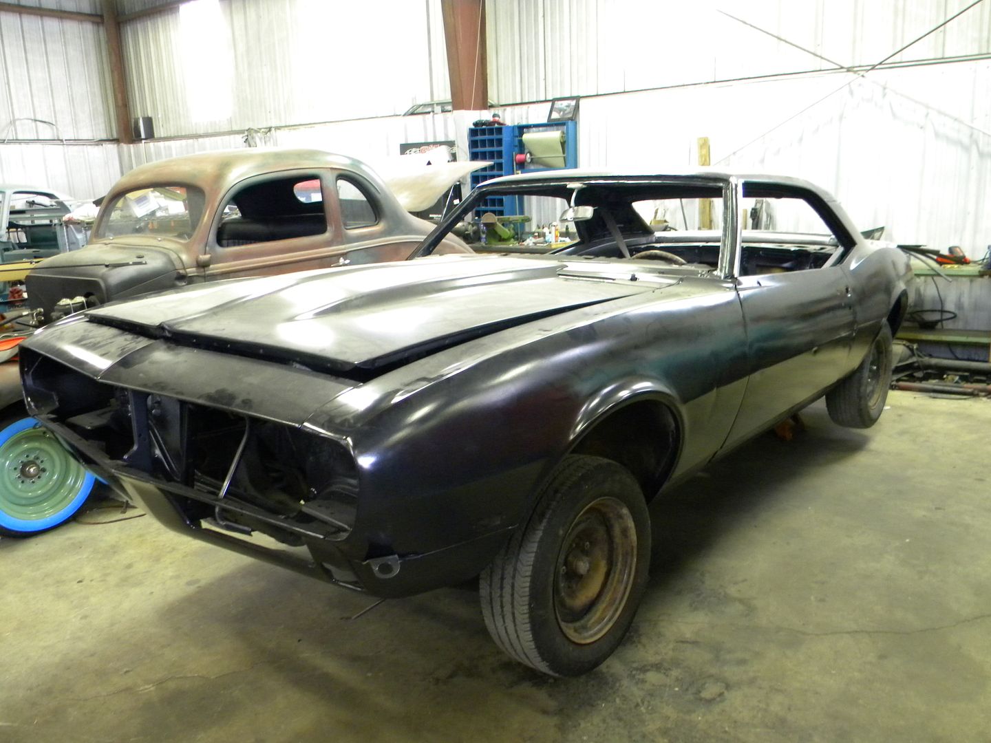

Here is the car as we received it
http://i1337.photobucket.com/albums/...psdabe6d5d.jpg
GAP Industries 12-30-2013 06:04 PM

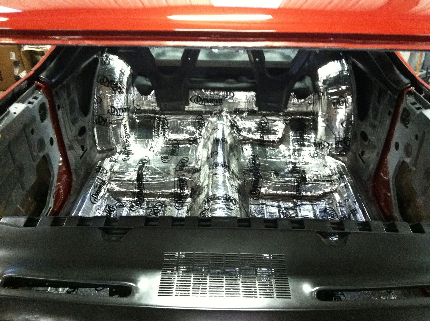

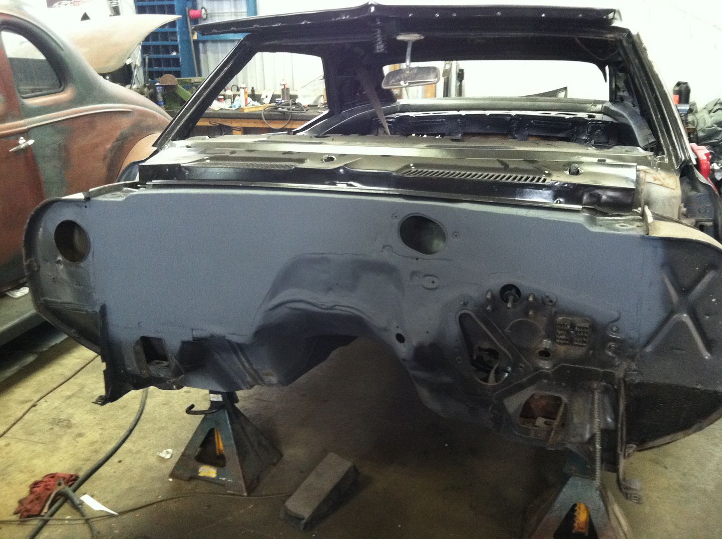

The tear down pics and firewall repair
http://i1337.photobucket.com/albums/...ps9d89d143.jpg
http://i1337.photobucket.com/albums/...ps05a66ac1.jpg

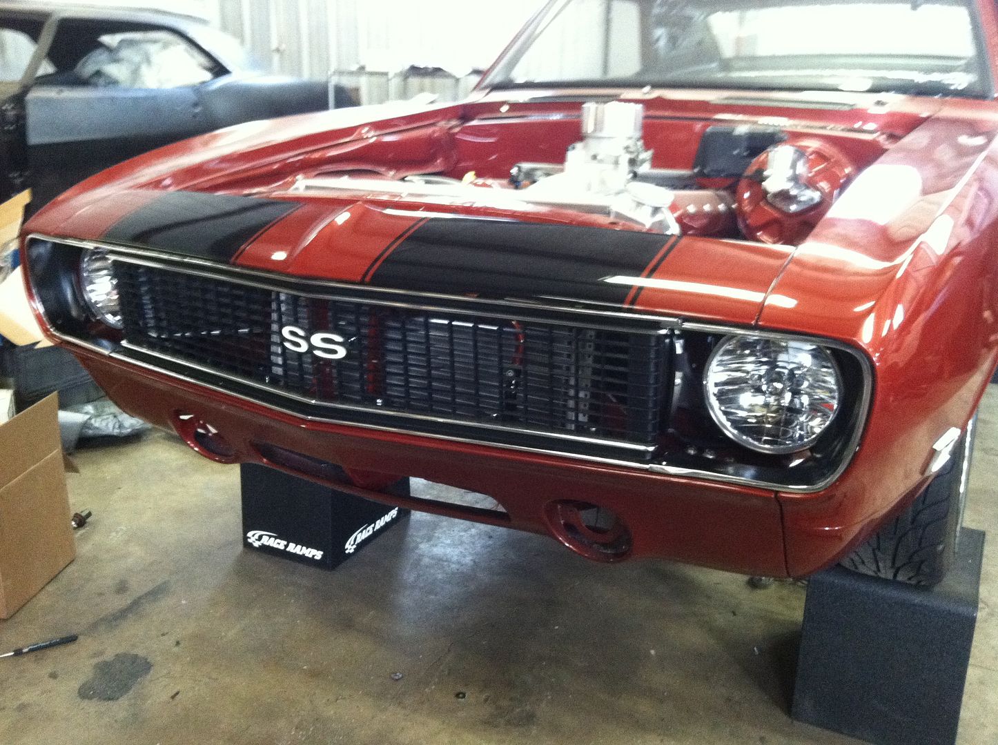

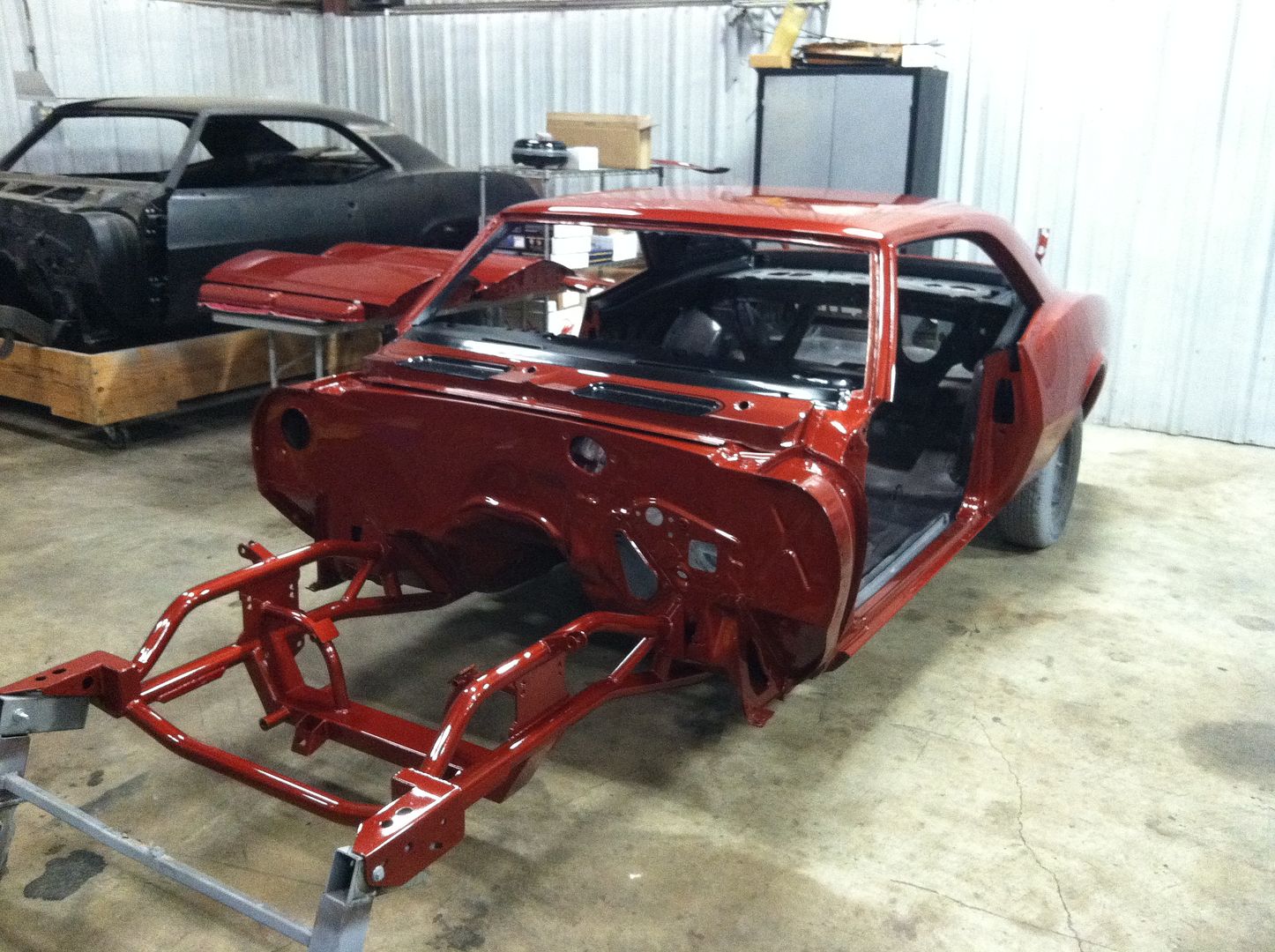

Here are some pictures before it went off to paint
http://i1337.photobucket.com/albums/...ps6e5e78a0.jpg

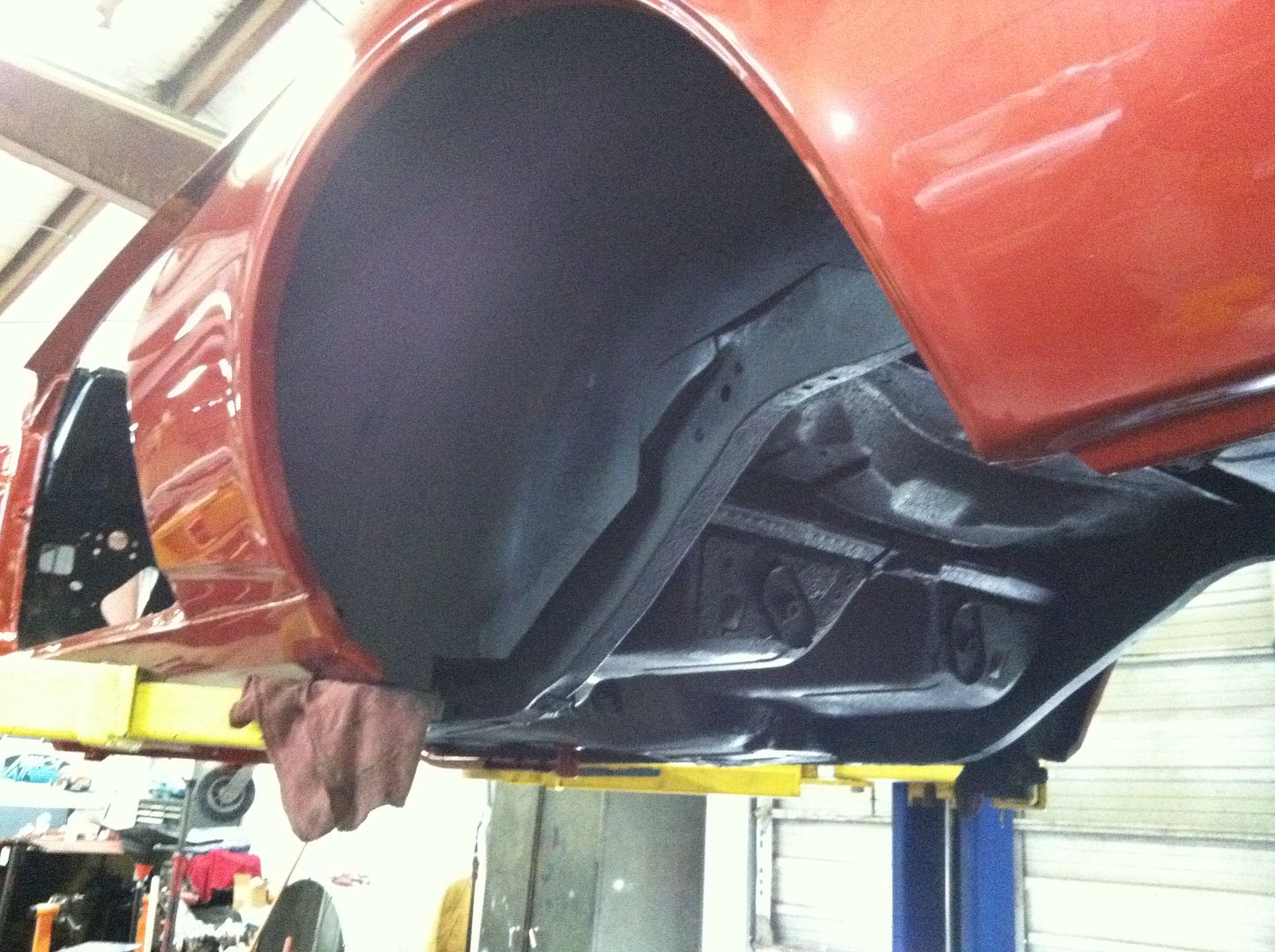

http://i1337.photobucket.com/albums/...psfc36ce51.jpg
The bottom of the car was sprayed with Lizard Skin
http://i1337.photobucket.com/albums/...ps691f9606.jpg

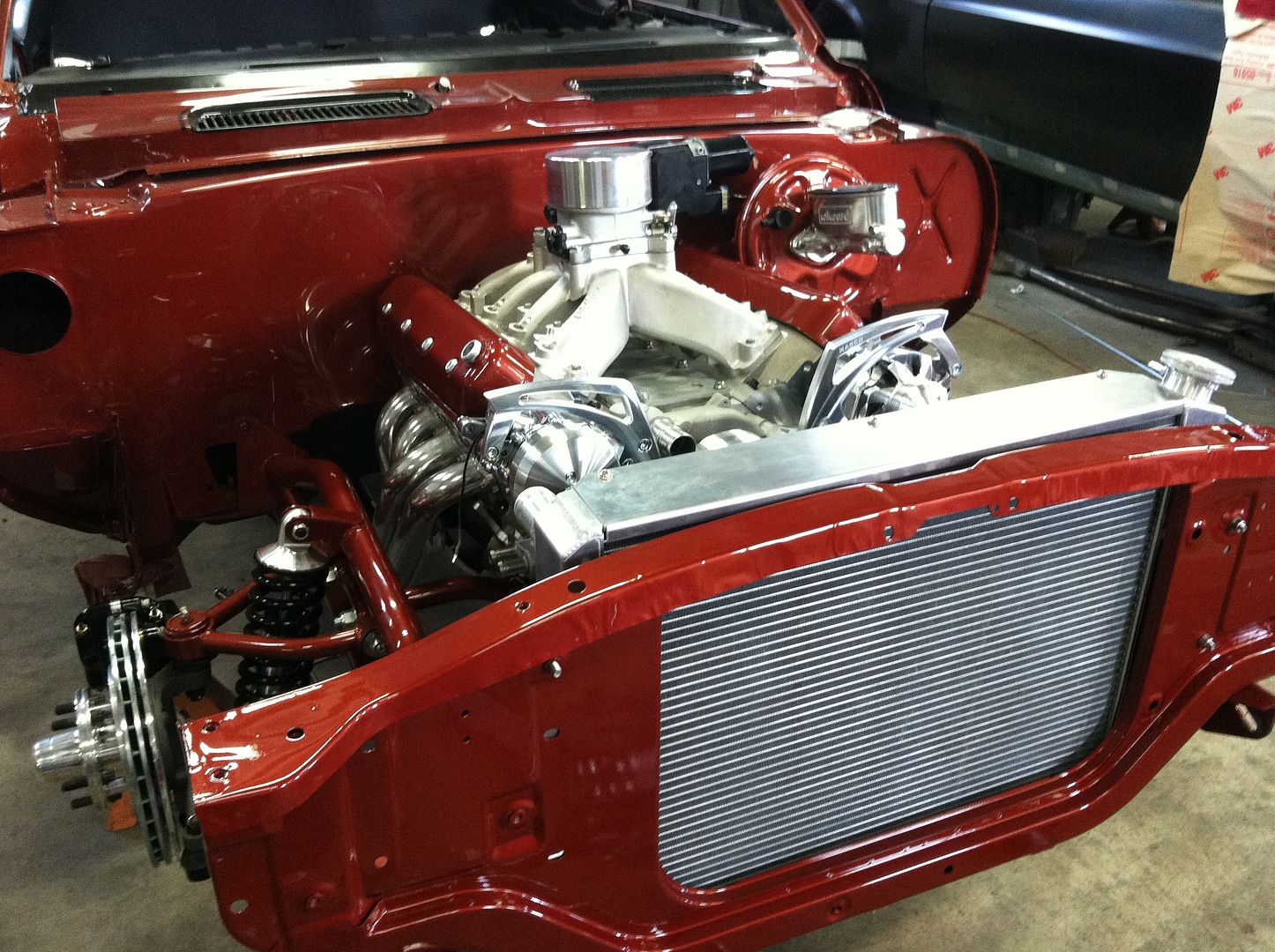

No onto the fun stuff
http://i1337.photobucket.com/albums/...psf460ce98.jpg
http://i1337.photobucket.com/albums/...psbd7ab1ef.jpg
GAP Industries 12-30-2013 06:09 PM

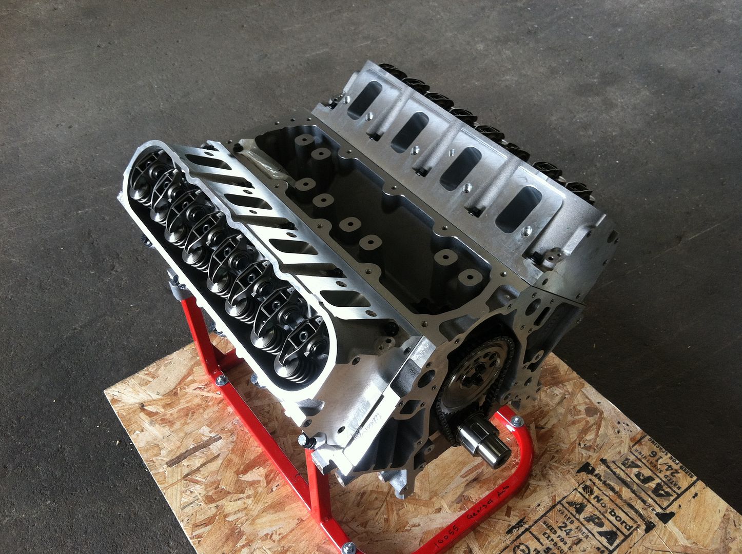

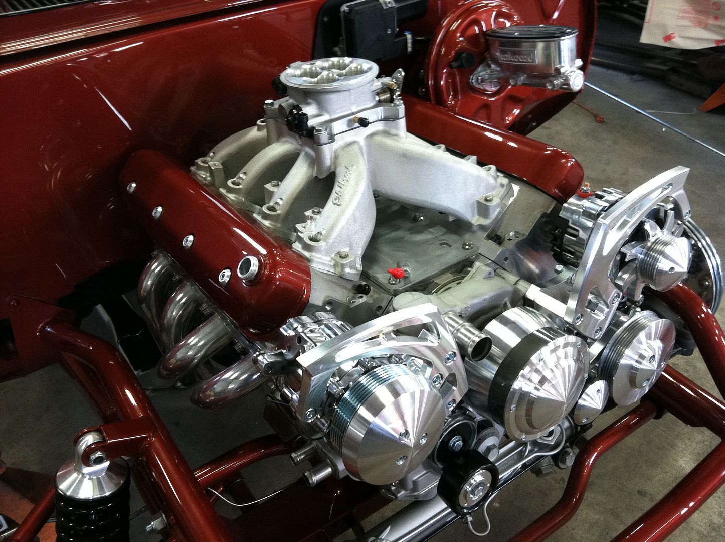

Texas Speed Long Block
http://i1337.photobucket.com/albums/...ps8c14b1b0.jpg
http://i1337.photobucket.com/albums/...ps3d497250.jpg
http://i1337.photobucket.com/albums/...ps9497436a.jpg

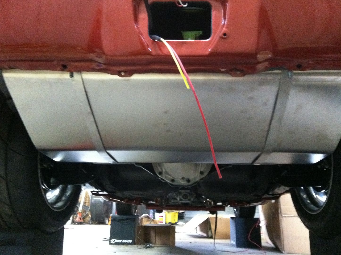

Ricks Stainless Fuel Tank
http://i1337.photobucket.com/albums/...ps1511885e.jpg
http://i1337.photobucket.com/albums/...ps25384185.jpg
http://i1337.photobucket.com/albums/...ps10185b4e.jpg

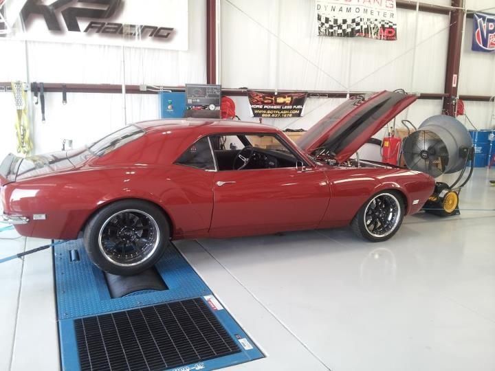

Finally we strapped it to the dyno to tune it
Made 528 HP to the tires through an Automatic

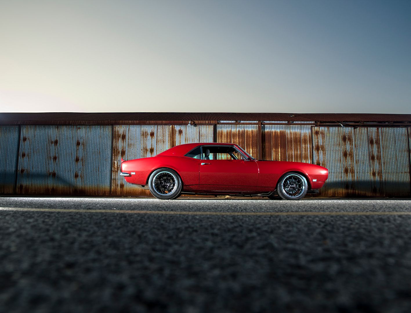

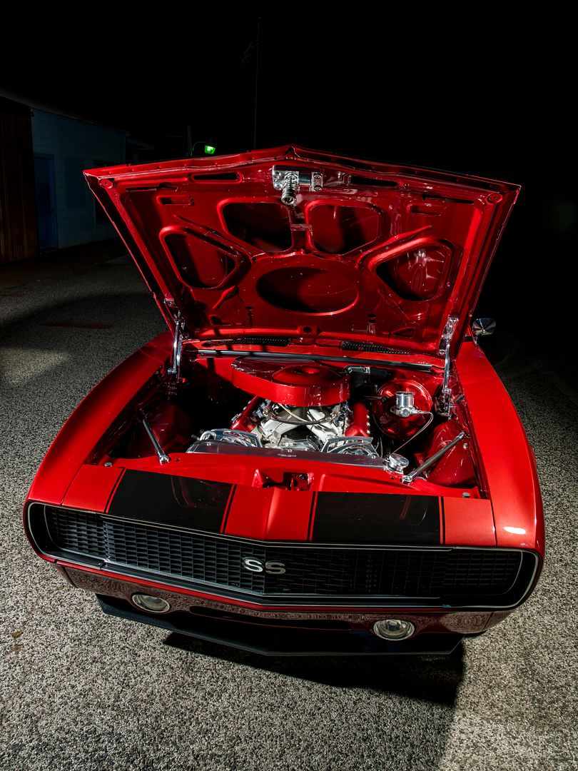

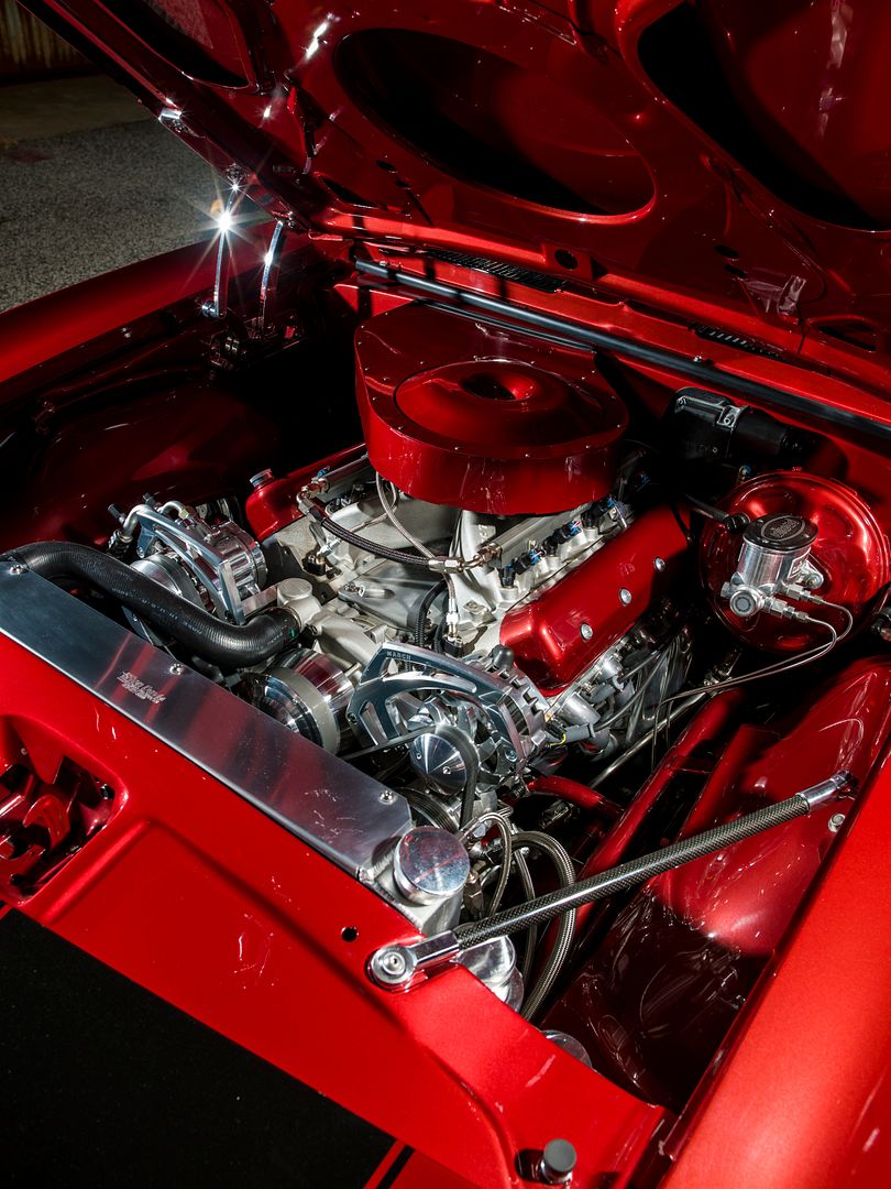

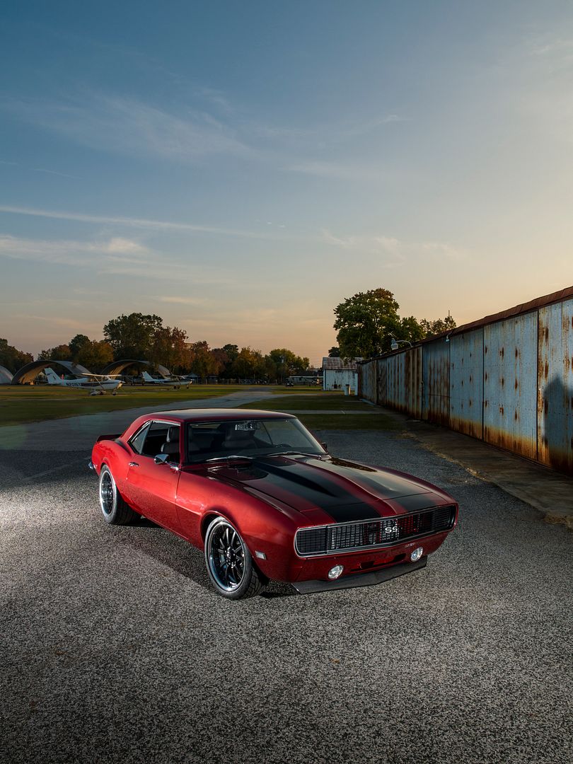

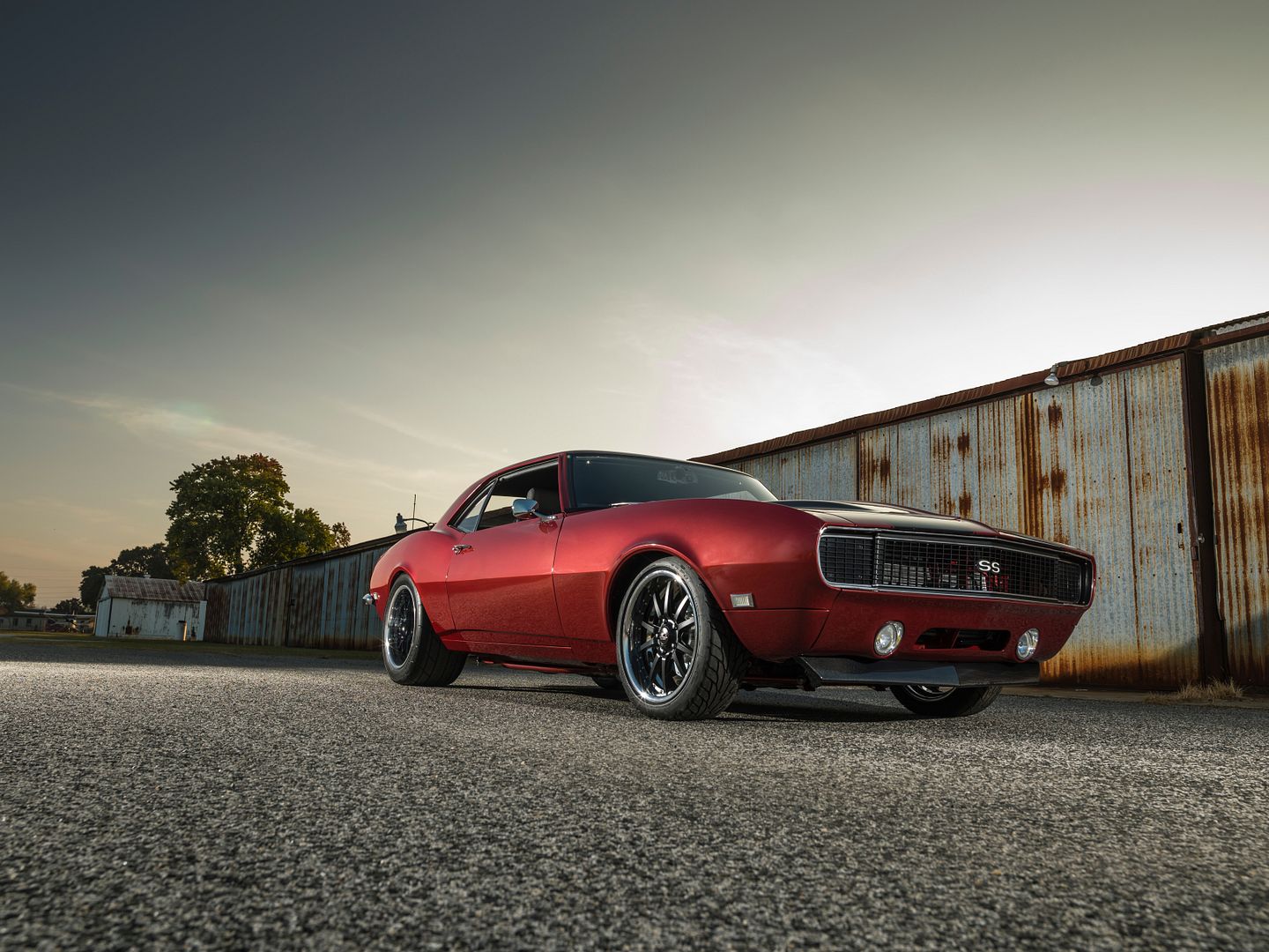

Here are the finished pictures taken by John Jackson of Not Stock Photography
http://i1337.photobucket.com/albums/...psada779da.jpg
http://i1337.photobucket.com/albums/...pse687d33b.jpg
http://i1337.photobucket.com/albums/...ps713ce640.jpg
http://i1337.photobucket.com/albums/...ps118f618a.jpg
http://i1337.photobucket.com/albums/...psebd039d9.jpg
http://i1337.photobucket.com/albums/...ps2f9d721b.jpg
http://i1337.photobucket.com/albums/...ps3f62c87b.jpg
http://i1337.photobucket.com/albums/...psf869adc7.jpg
http://i1337.photobucket.com/albums/...ps04a0ef12.jpg
Jon69RagTop 12-30-2013 06:58 PM
Stunning
Nice work Tim, great attention to detail. Love the tire and wheel sizing.
