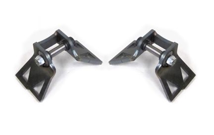

The brackets themselves...

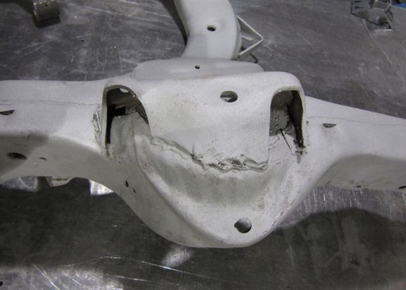

Frame before trimming...

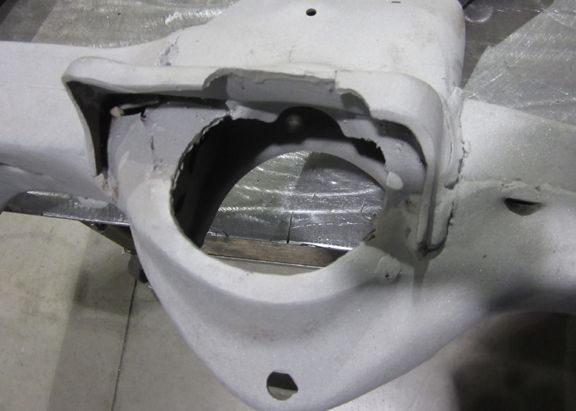

After trimming. Notice the notch for the bracket and that the spring pocket has been opened up...
http://i1299.photobucket.com/albums/...ps87a25889.jpg

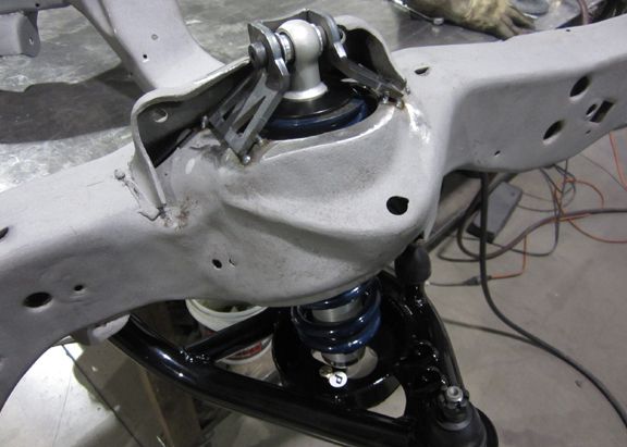

Tacked in place to mock everything up before welding it in...
http://i1299.photobucket.com/albums/...psd9909f24.jpg

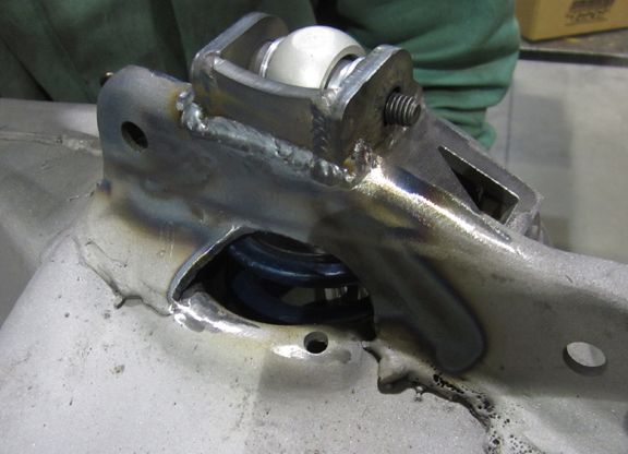

We suggest clearancing this area at the base of the control arm mount too, giving the shock/spring assembly room to breathe. More info on the kit here... A Body Chicane Coilover Conversion
