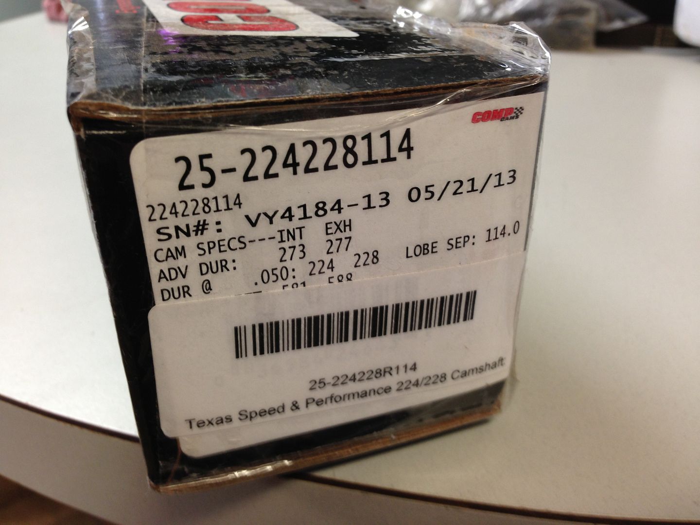

Texas Speed Cam 224/228 .581/.588 on a 142 LSA with new pushrods and springs

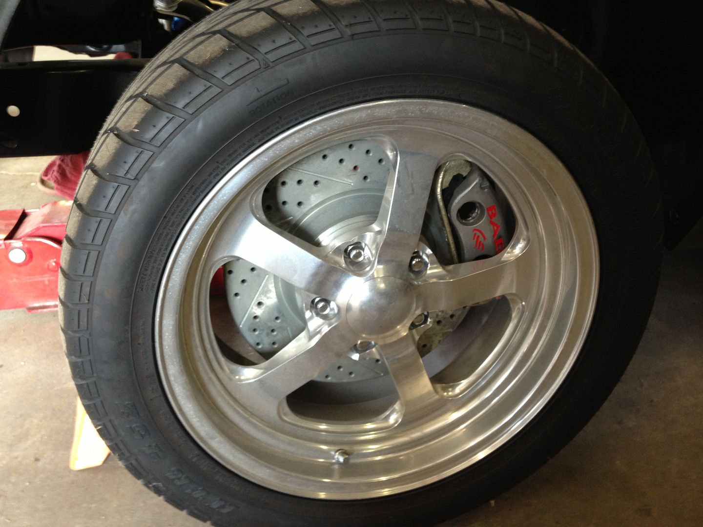

Baer Track 13” 4-pistion brakes in front
Baer Sport 12” 2-pistion brakes in rear

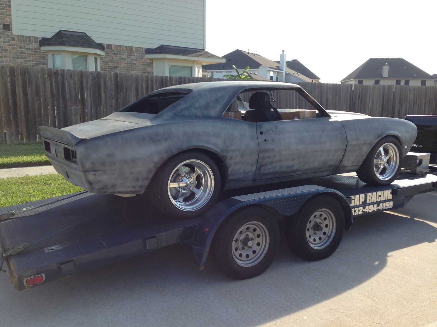

GAP Industries 12-31-2013 09:55 AM

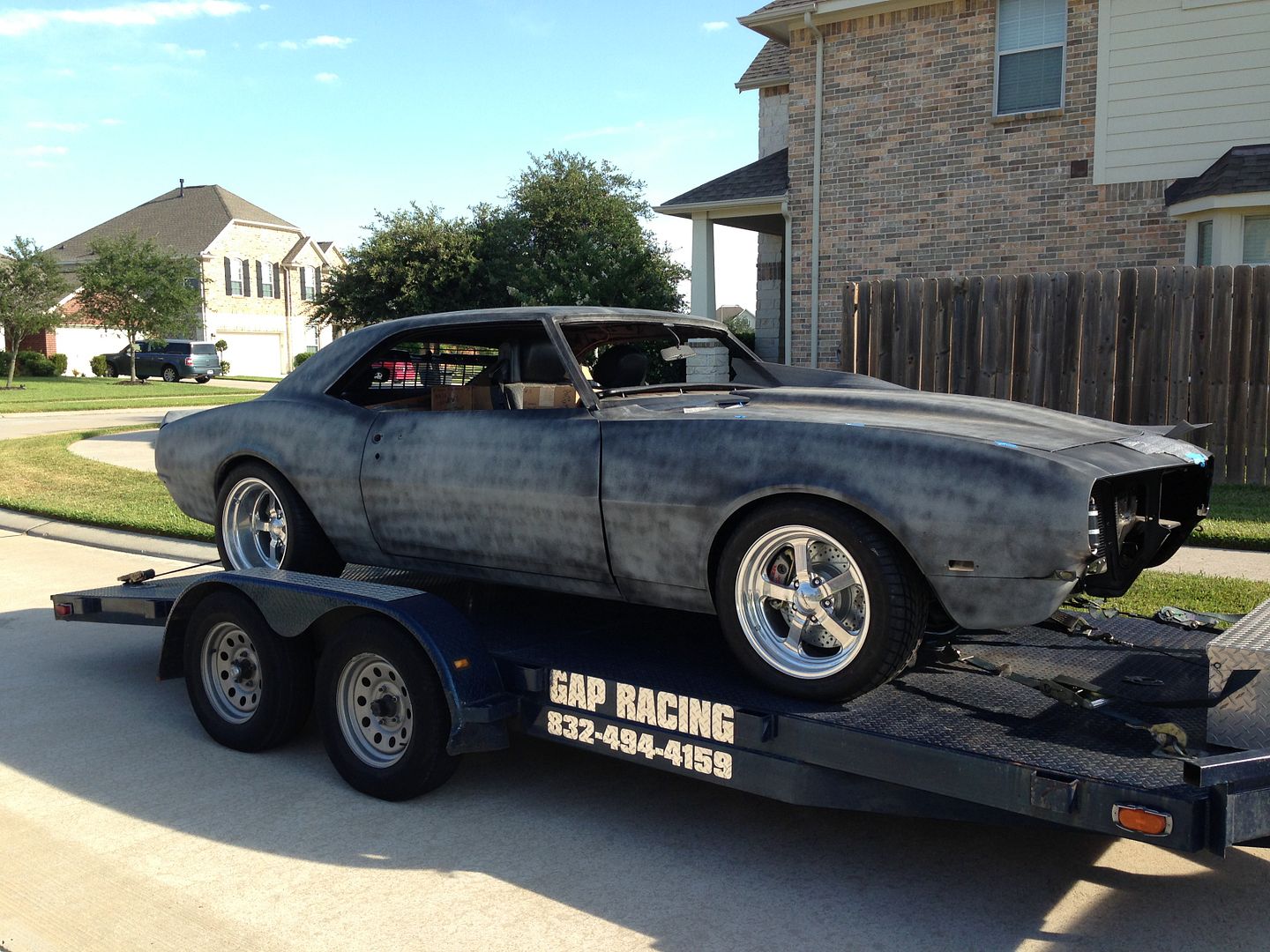

Here is the car the day we picked it up
http://i1337.photobucket.com/albums/...psd33205b1.jpg
http://i1337.photobucket.com/albums/...ps3fa5b072.jpg

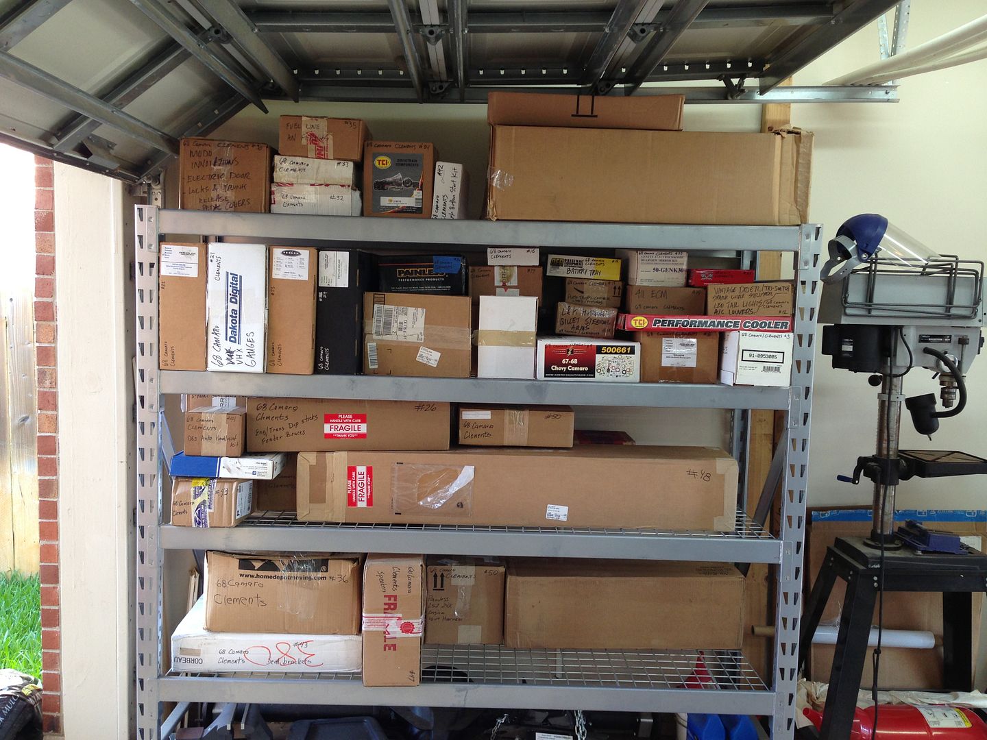

Casey had collected a ton of parts for the project which made our job a lot easier.
http://i1337.photobucket.com/albums/...ps2189ce12.jpg

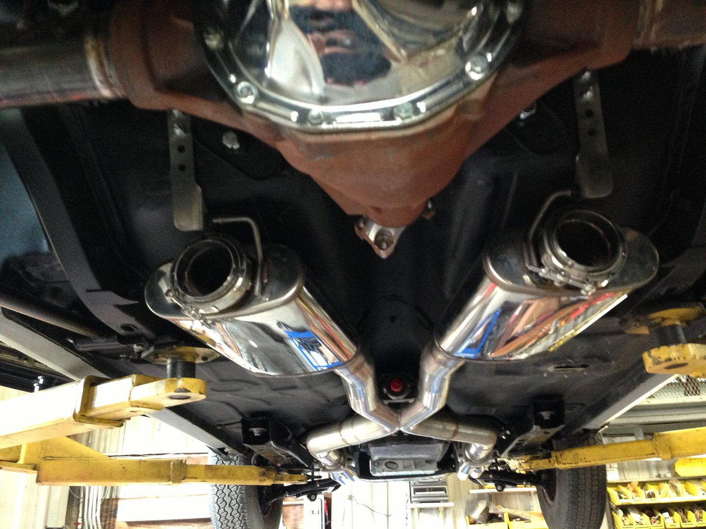

GAP Industries 12-31-2013 10:03 AM

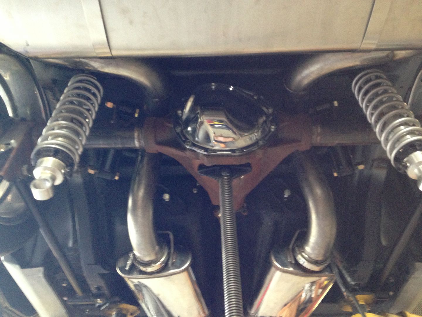

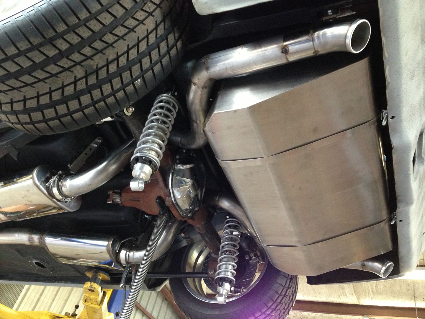

Before all the drivetrain was removed, we started to fit the Dynatech exhaust kit he supplied and try to modify it from the axle back to work with the rear suspension setup
http://i1337.photobucket.com/albums/...ps6a33b2b0.jpg
http://i1337.photobucket.com/albums/...ps35d46c24.jpg
http://i1337.photobucket.com/albums/...psae20fd7d.jpg
http://i1337.photobucket.com/albums/...psd243c391.jpg
http://i1337.photobucket.com/albums/...ps917071c4.jpg
GAP Industries 12-31-2013 10:09 AM

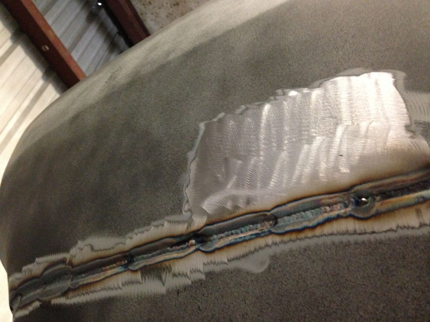

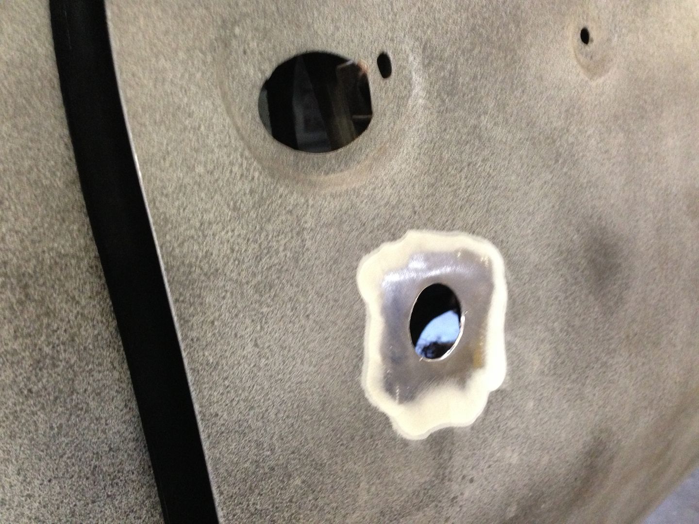

Once the exhaust was sorted out, we took it off the car and welded it all up. Then on to the body modifications
Deleting the door locks
http://i1337.photobucket.com/albums/...ps8b11e627.jpg

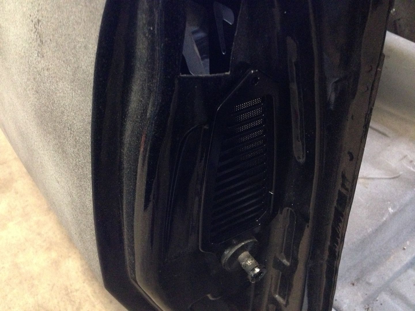

Removing the vents in the cowl
http://i1337.photobucket.com/albums/...ps856dae75.jpg

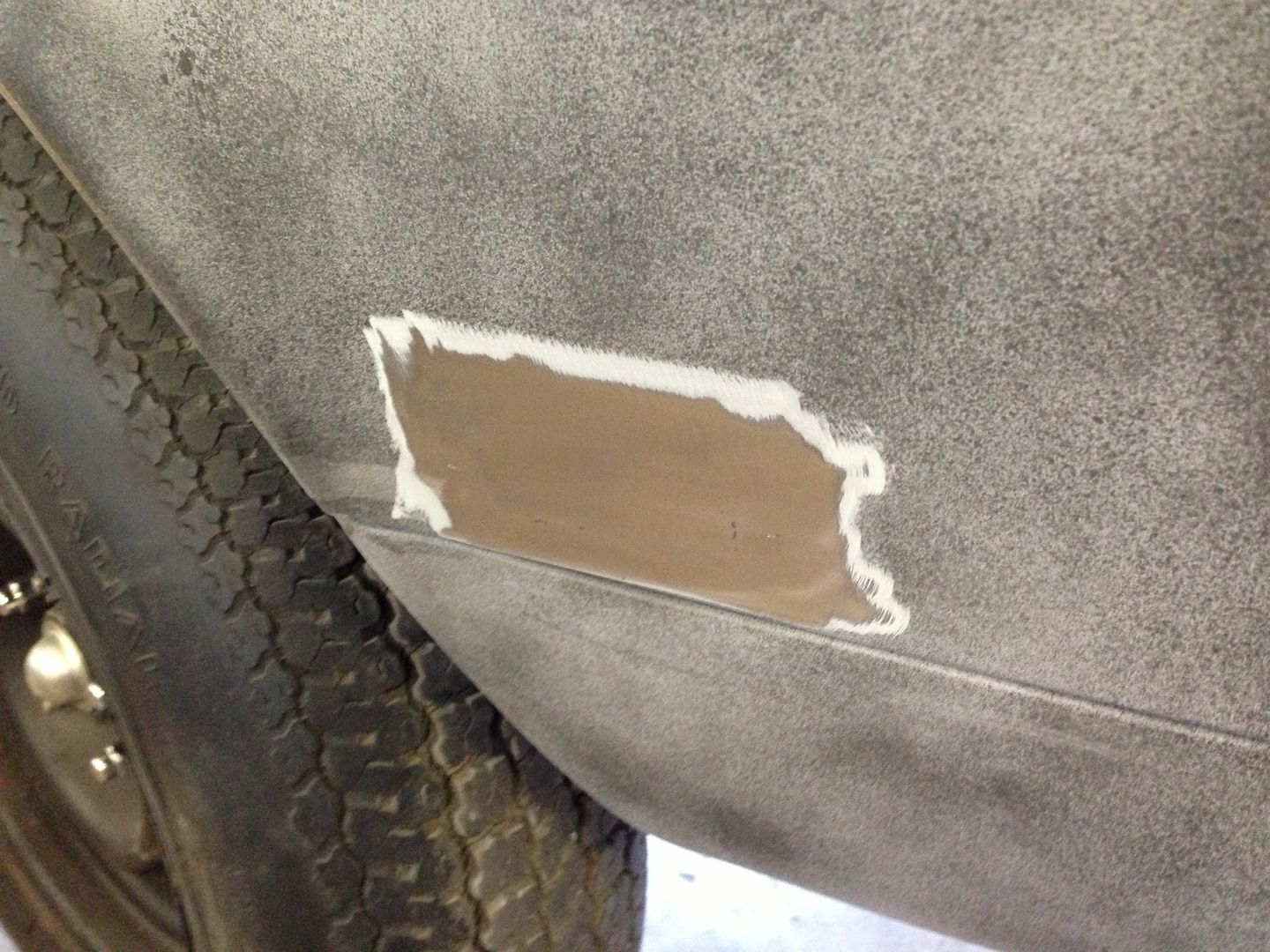

Welded up the side marker lights
http://i1337.photobucket.com/albums/...psb740cbd9.jpg
Deleted the front bumper bracket and welded the extensions in
http://i1337.photobucket.com/albums/...psec1dd1b8.jpg
Deleted the center speaker in the dash
http://i1337.photobucket.com/albums/...ps1b3110e5.jpg
Welded up the factory AC vents
http://i1337.photobucket.com/albums/...ps4e914da5.jpg
Repaired the damaged dash area
http://i1337.photobucket.com/albums/...ps4713dac5.jpg

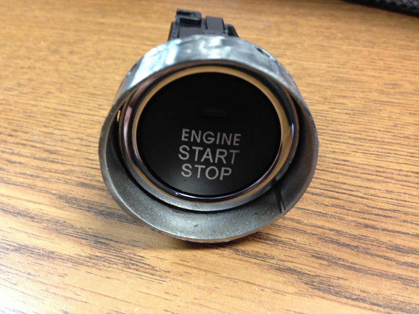

We made a recess for the push start button
http://i1337.photobucket.com/albums/...pse69fb1f3.jpg

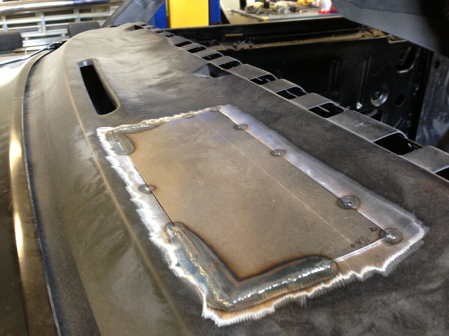

And modified the center of the dash
http://i1337.photobucket.com/albums/...pse9c431f2.jpg

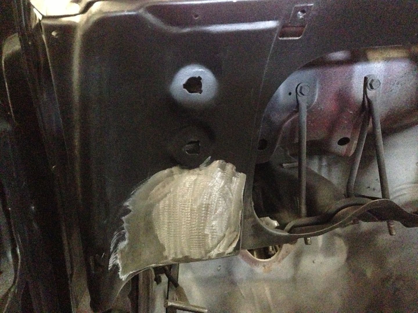

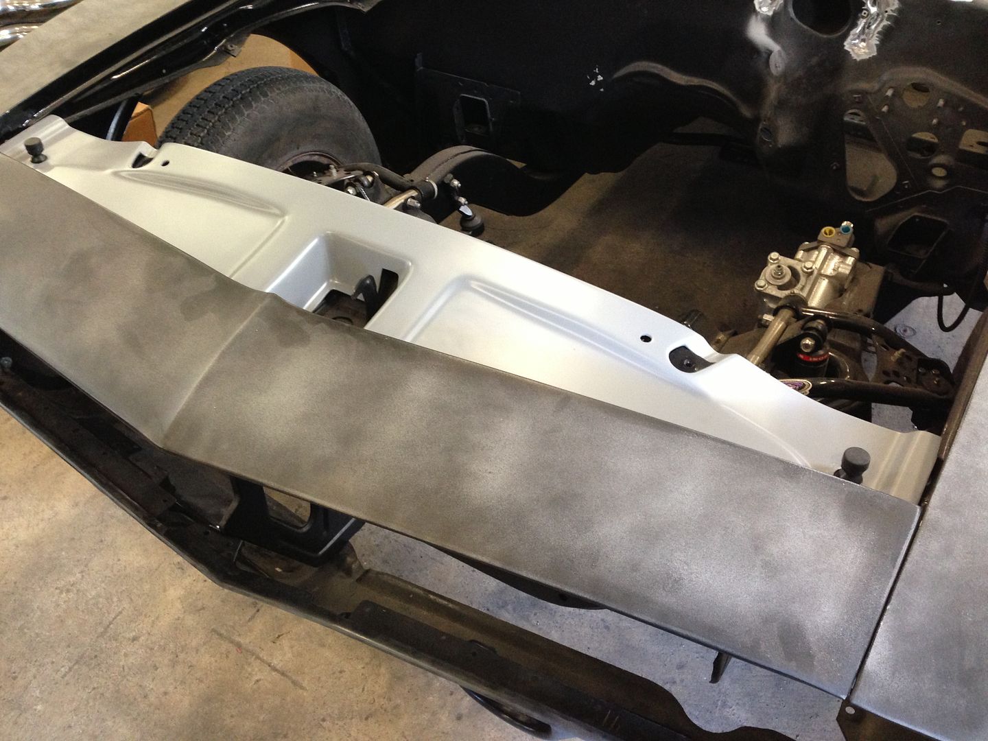

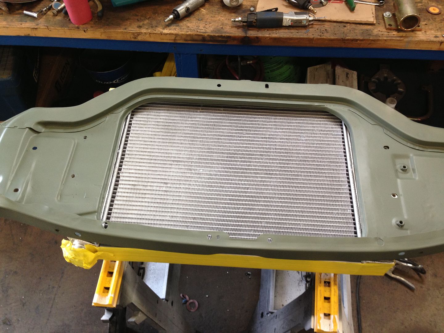

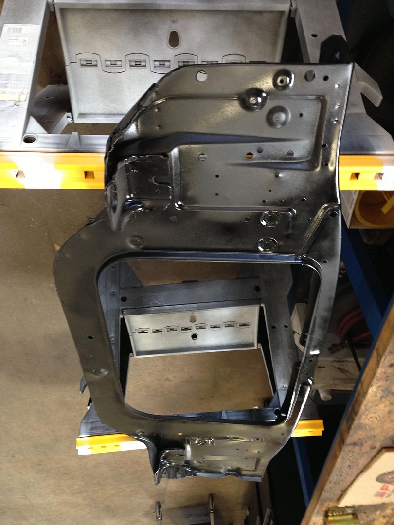

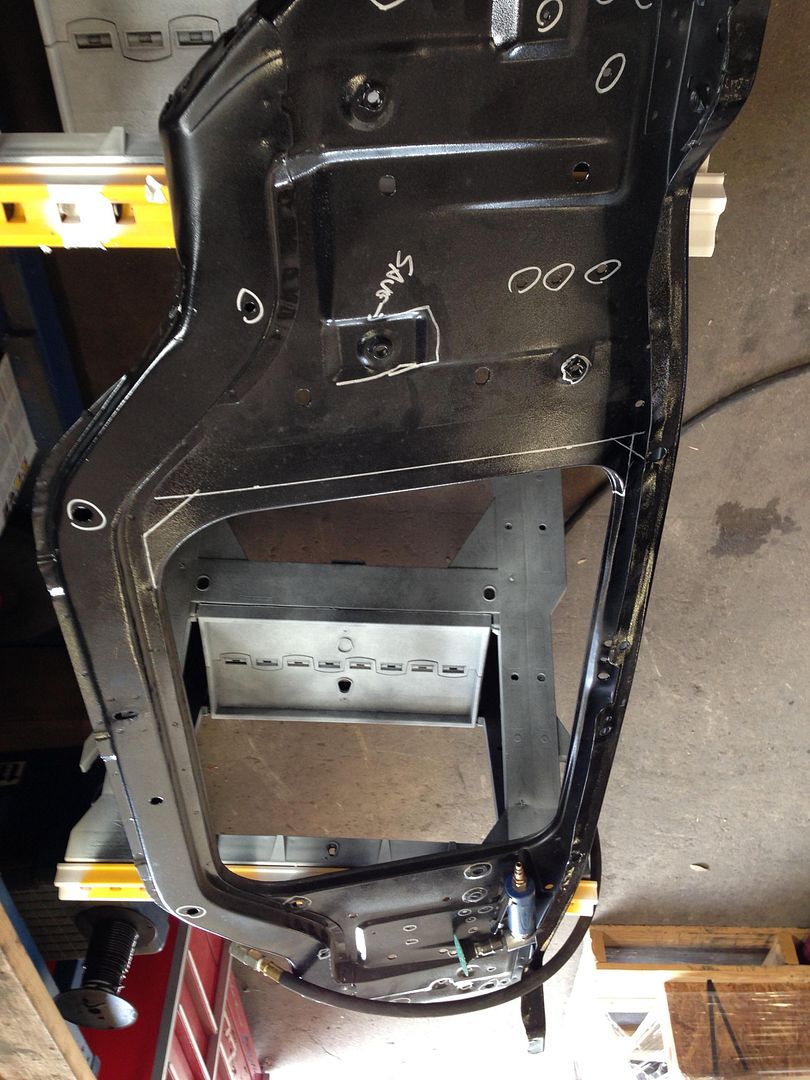

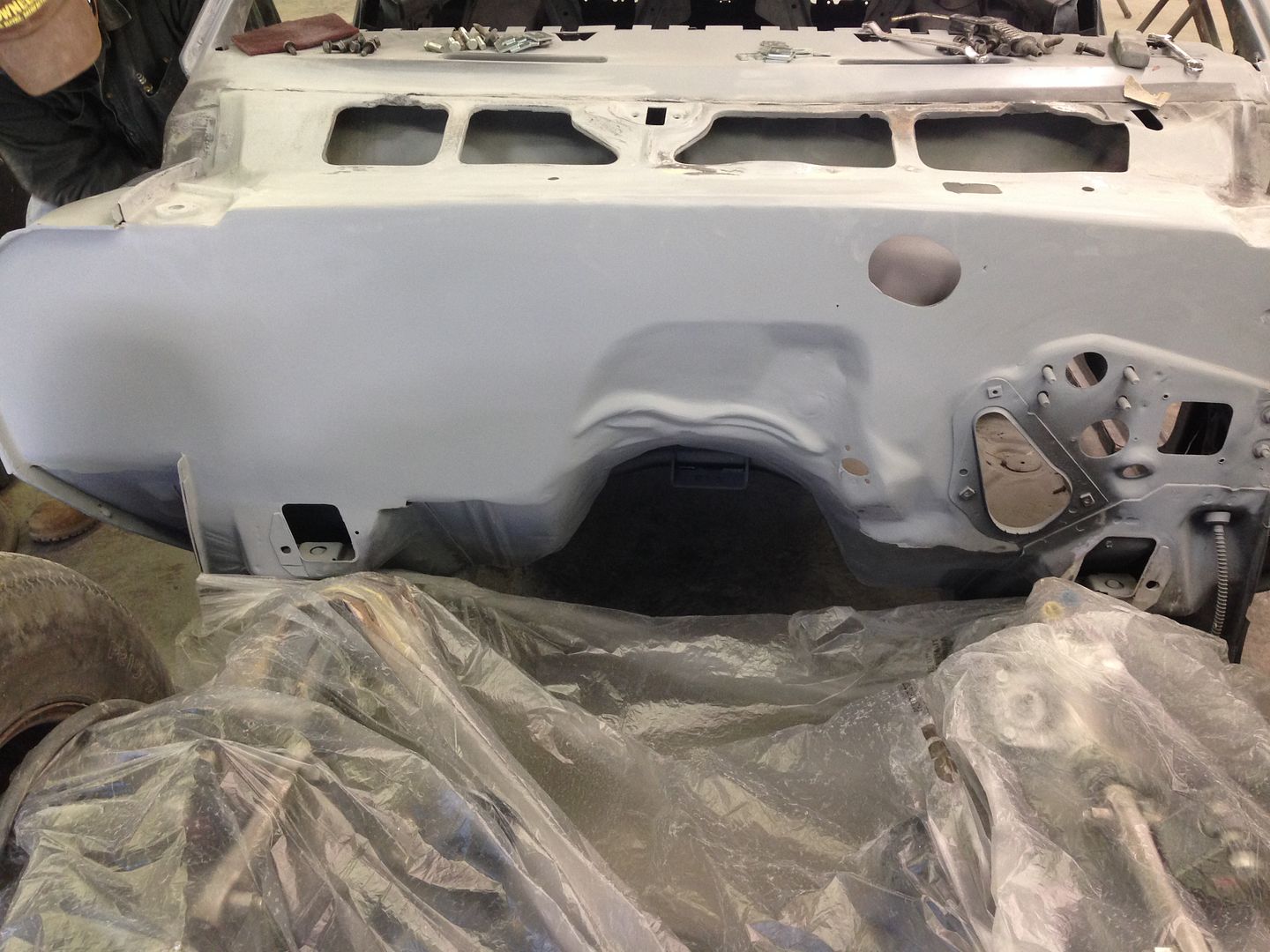

Then we pulled the engine to make some changes to the firewall and core support
http://i1337.photobucket.com/albums/...ps886c1118.jpg
http://i1337.photobucket.com/albums/...psff6f893e.jpg

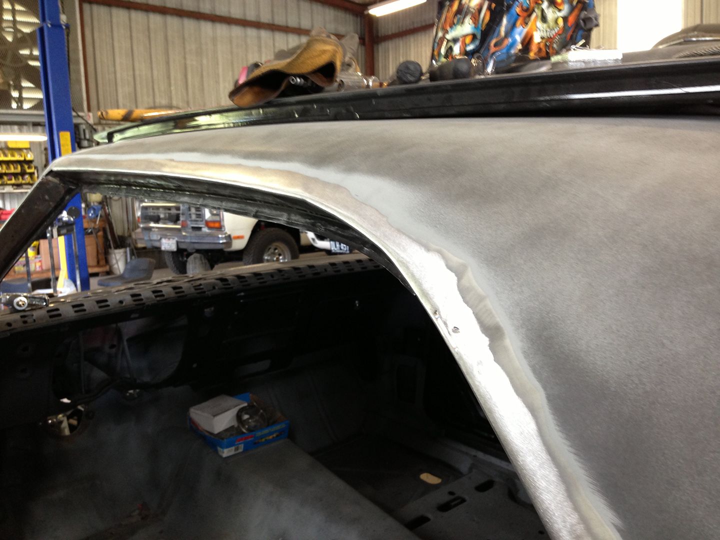

We also finished up the drip rails
http://i1337.photobucket.com/albums/...ps5f64e180.jpg
http://i1337.photobucket.com/albums/...psb013d55f.jpg
http://i1337.photobucket.com/albums/...psc185e411.jpg
Here is the core support before we started cutting and welding on it
http://i1337.photobucket.com/albums/...ps5c0c3ae5.jpg
http://i1337.photobucket.com/albums/...ps5a555f1e.jpg
Now he can take advantage of the entire surface of the radiator
http://i1337.photobucket.com/albums/...ps57705d28.jpg

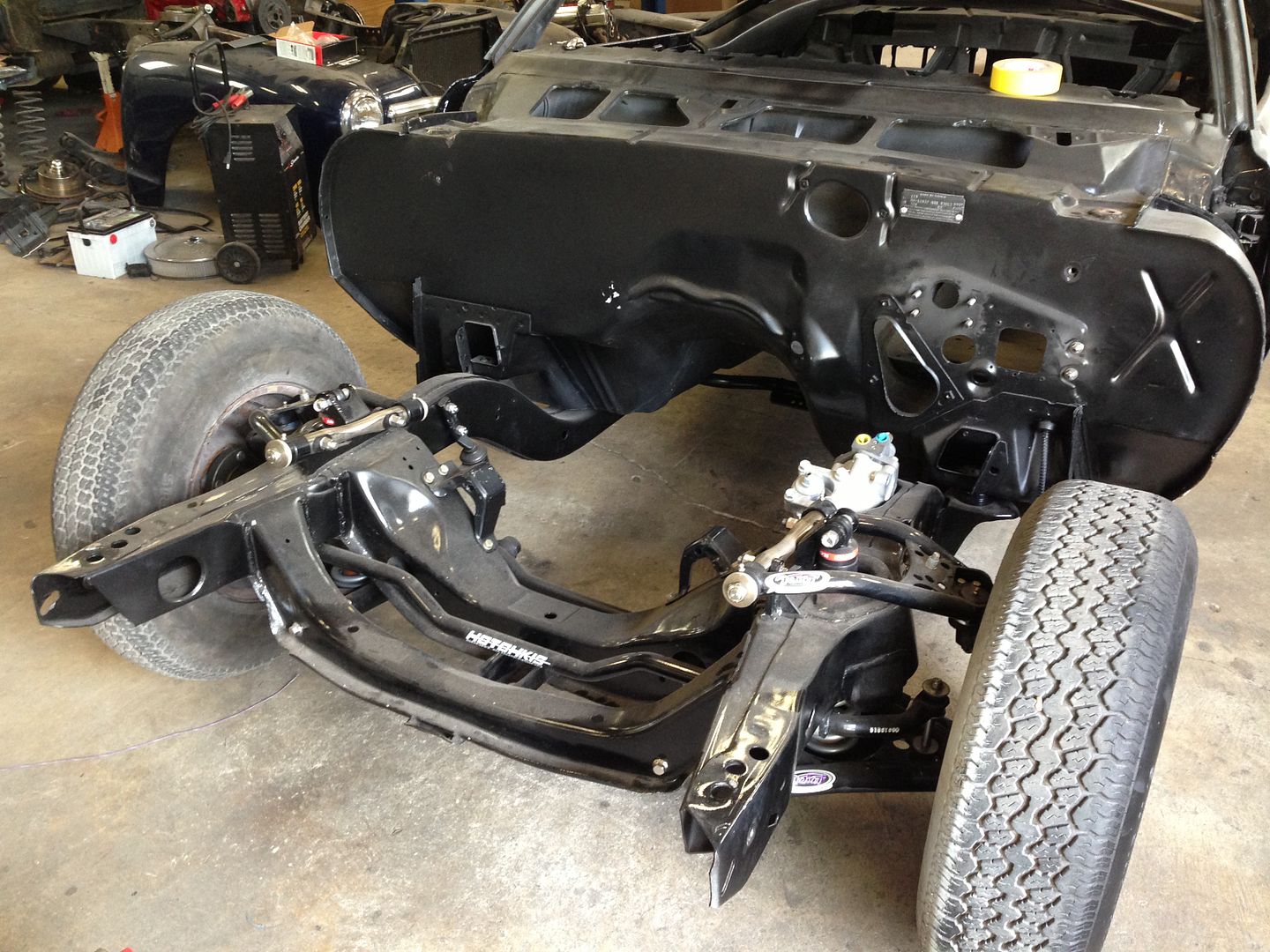

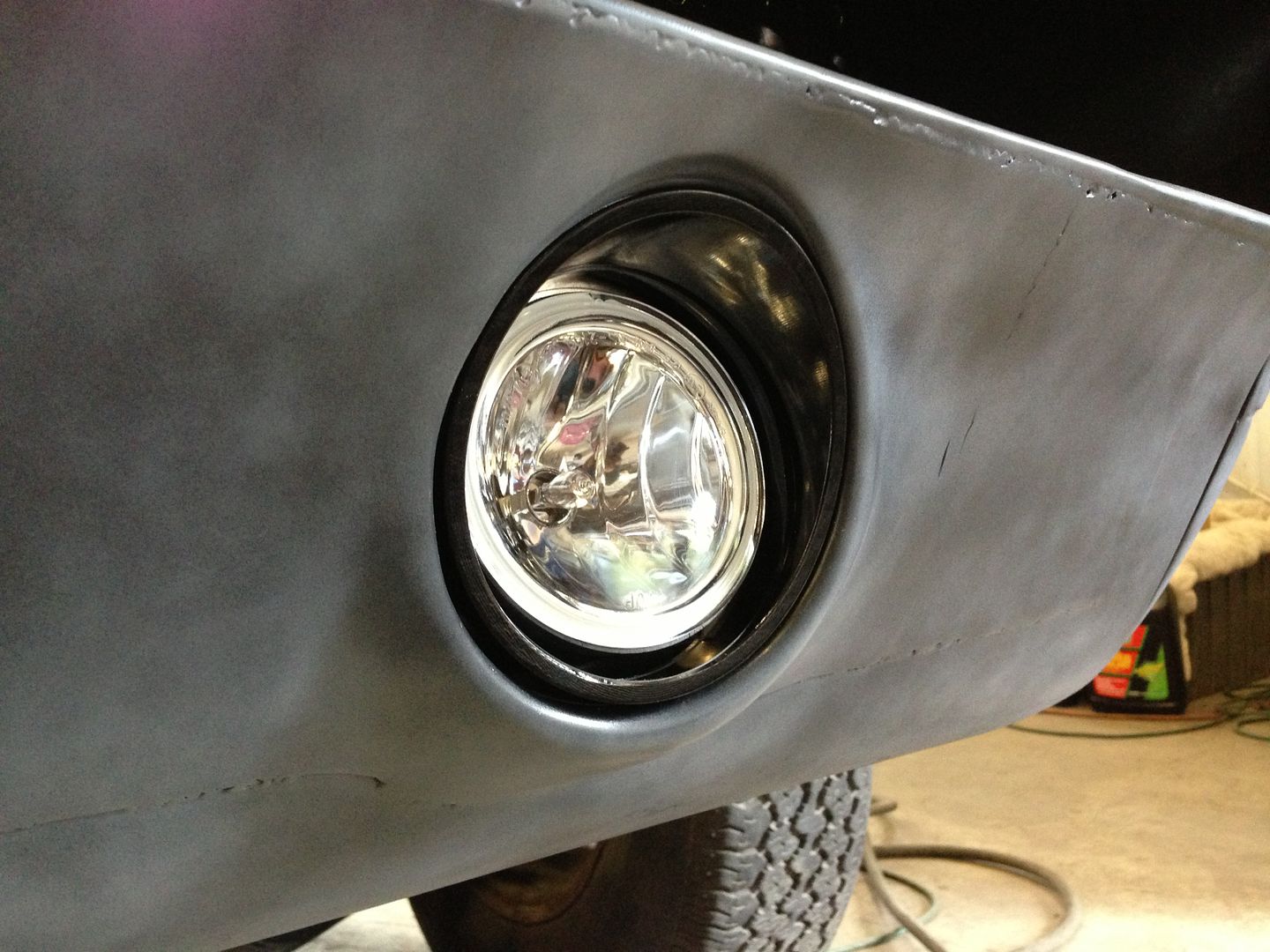

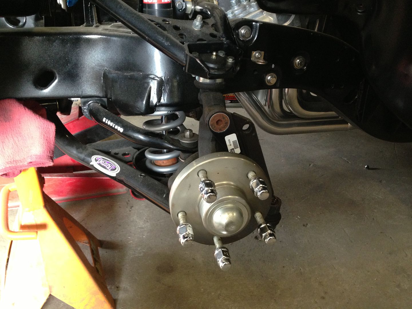

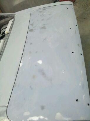

Started to fit all the pieces and make modifications before it ships off to paint
http://i1337.photobucket.com/albums/...psfdc83849.jpg
http://i1337.photobucket.com/albums/...pse9a0dd01.jpg
http://i1337.photobucket.com/albums/...psdddad408.jpg
http://i1337.photobucket.com/albums/...psbe833d88.jpg
http://i1337.photobucket.com/albums/...ps03cf5c20.jpg

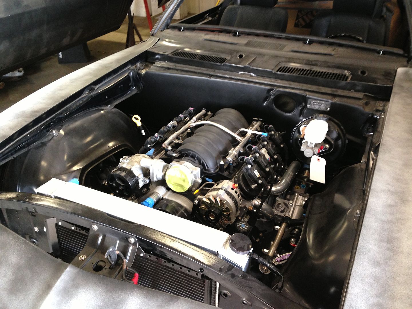

Doing a little Engine upgrade while the body is at paint
http://i1337.photobucket.com/albums/...psf1bfd378.jpg

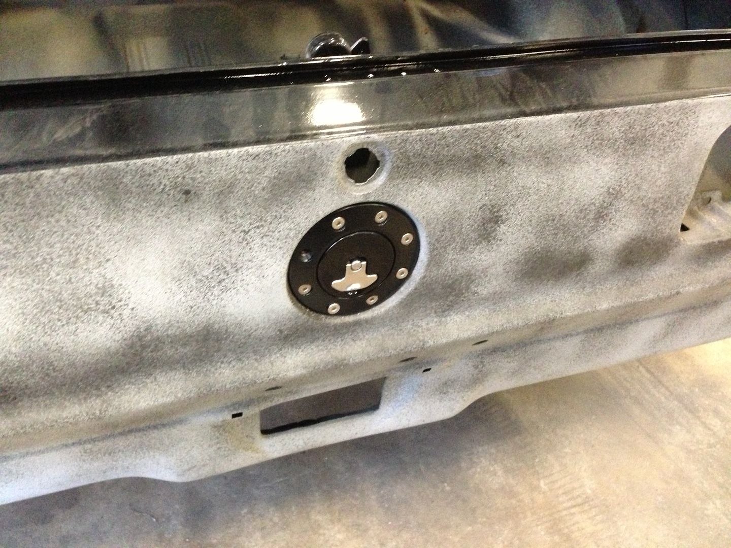

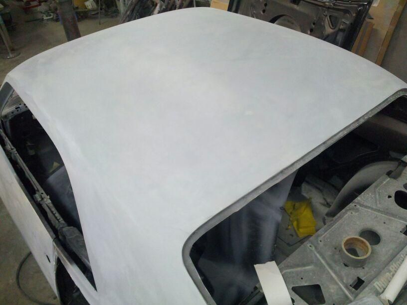

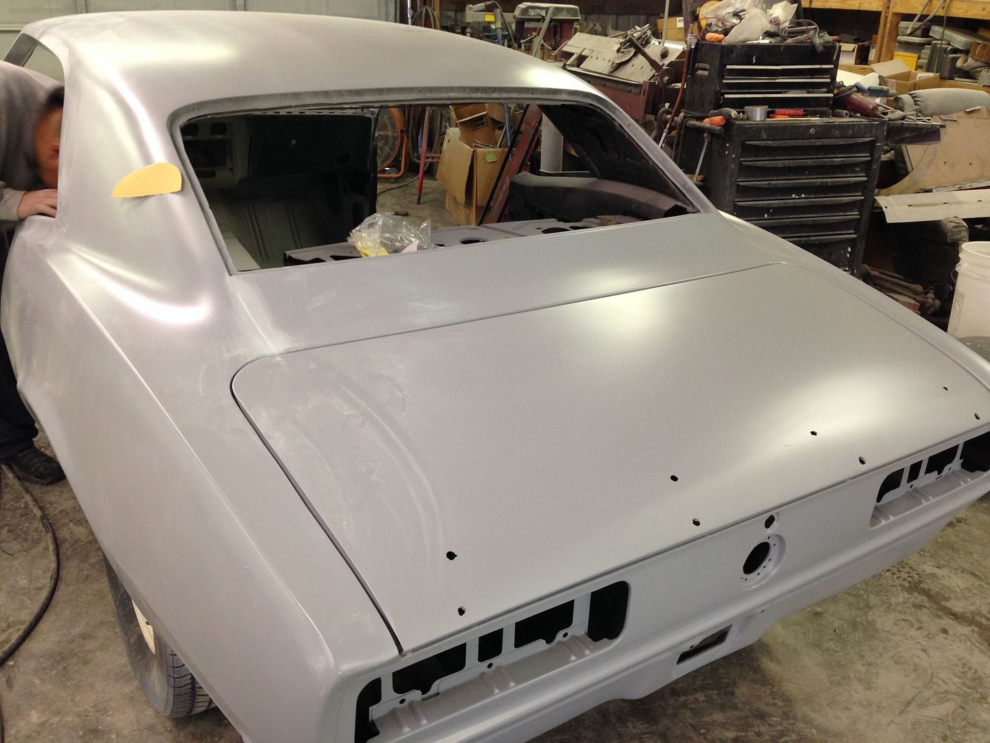

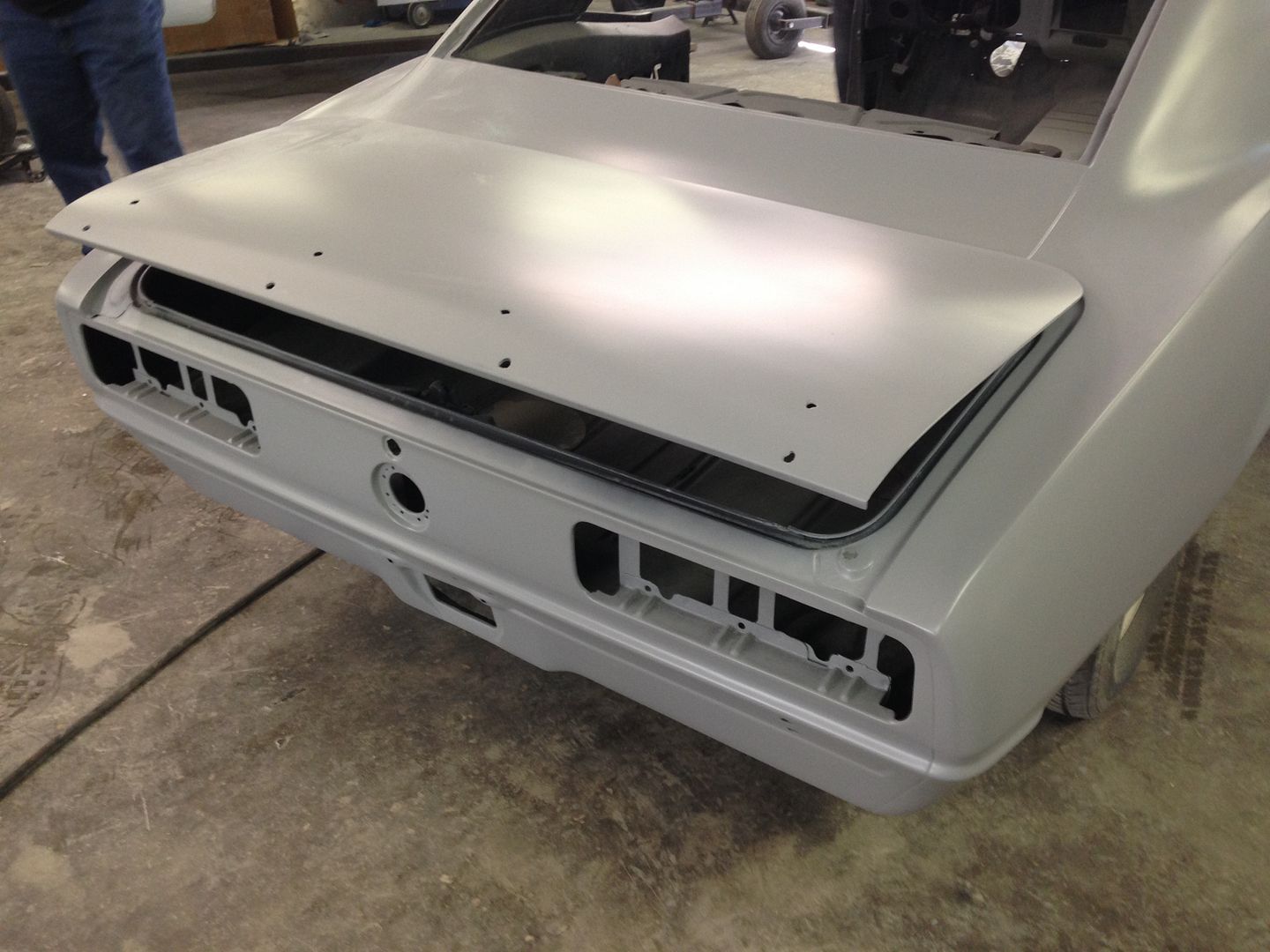

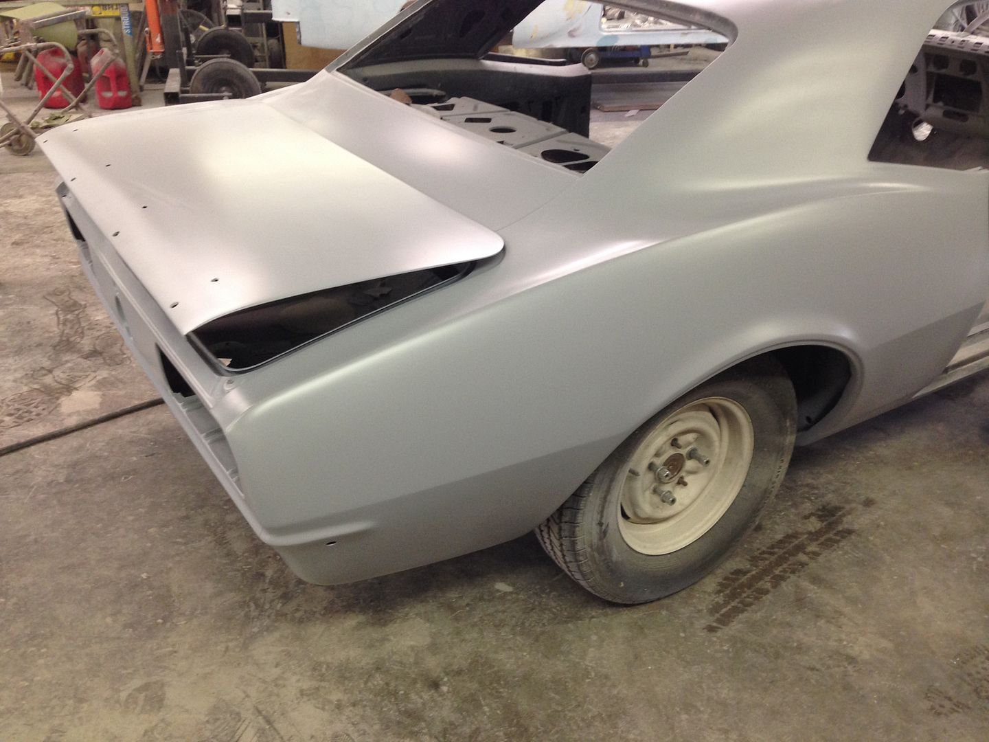

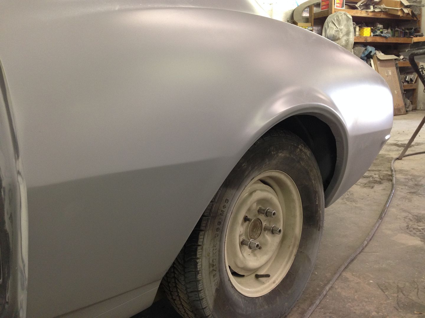

Here is an update from the body shop.
http://i1337.photobucket.com/albums/...psf4a85d62.jpg
http://i1337.photobucket.com/albums/...ps99a3591e.jpg
