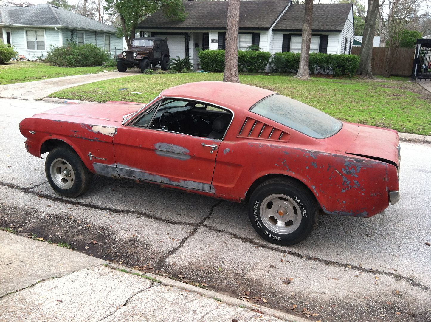

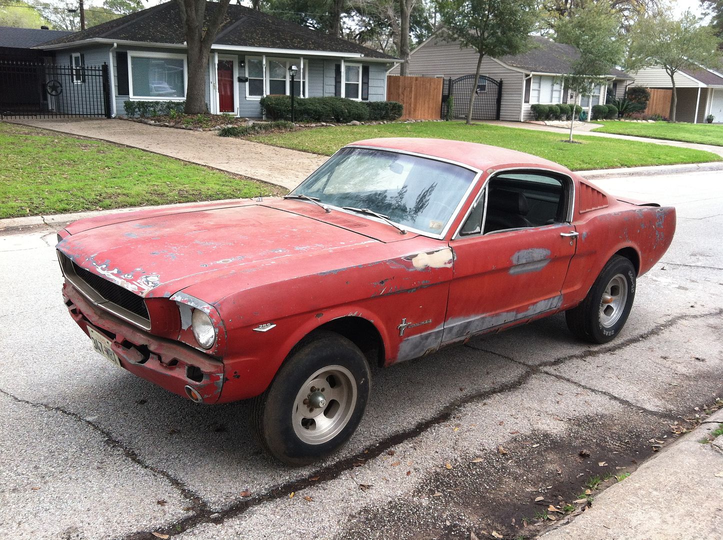

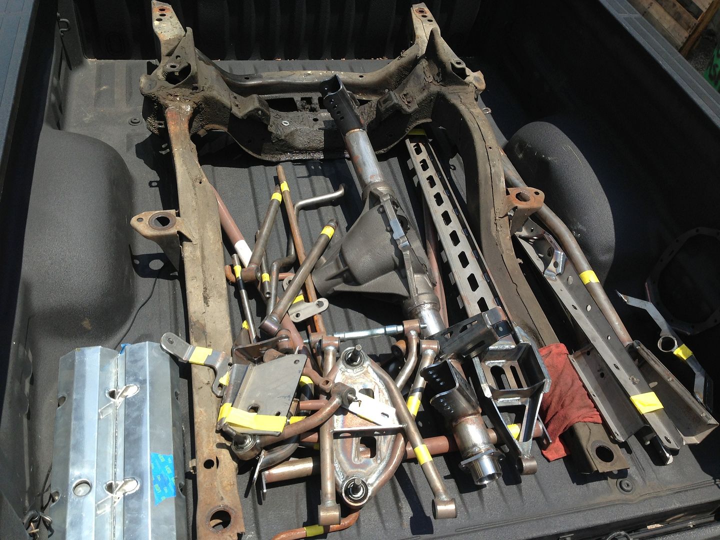

This project is a 1965 Mustang that the owner has had since it was new. The car was originally green. He then painted it red back in the 70's and did a lot of drag racing with it. The car had had a hard life and then was put away for over 20 years. Most of his family members have forgotten about it. When the car came to us, the plan was to go back original and install a mild 289 and a 4 speed. As with many project, things changed. We sat down and discussed hos options for making it more modern, giving him the ability to actually drive it and enjoy it.

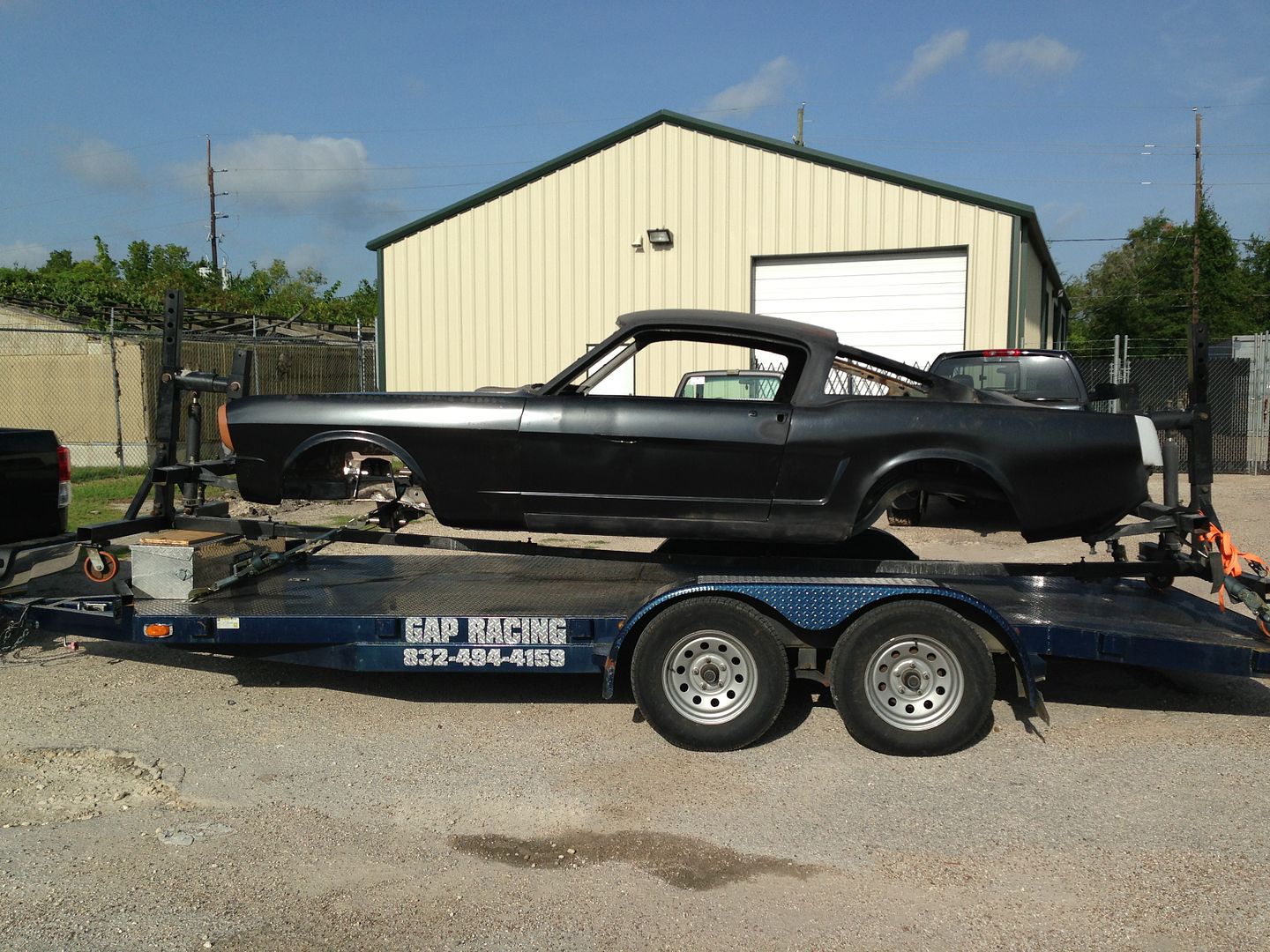

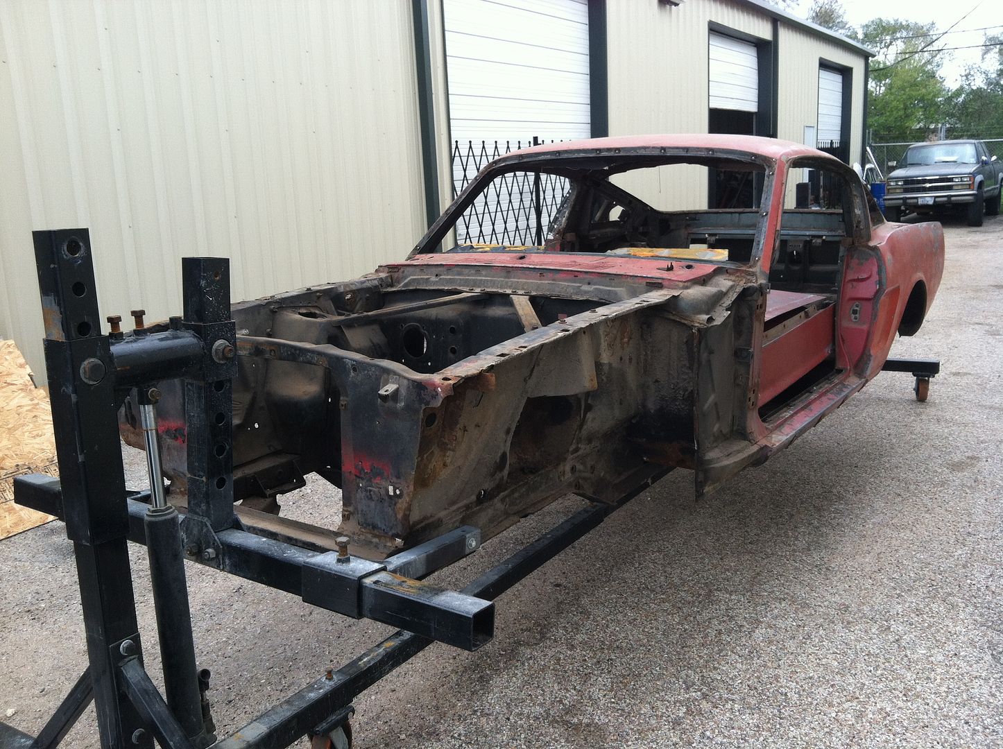

Here is the project the day we picked it up
http://i1337.photobucket.com/albums/...ps28039365.jpg
http://i1337.photobucket.com/albums/...psba9abb4f.jpg

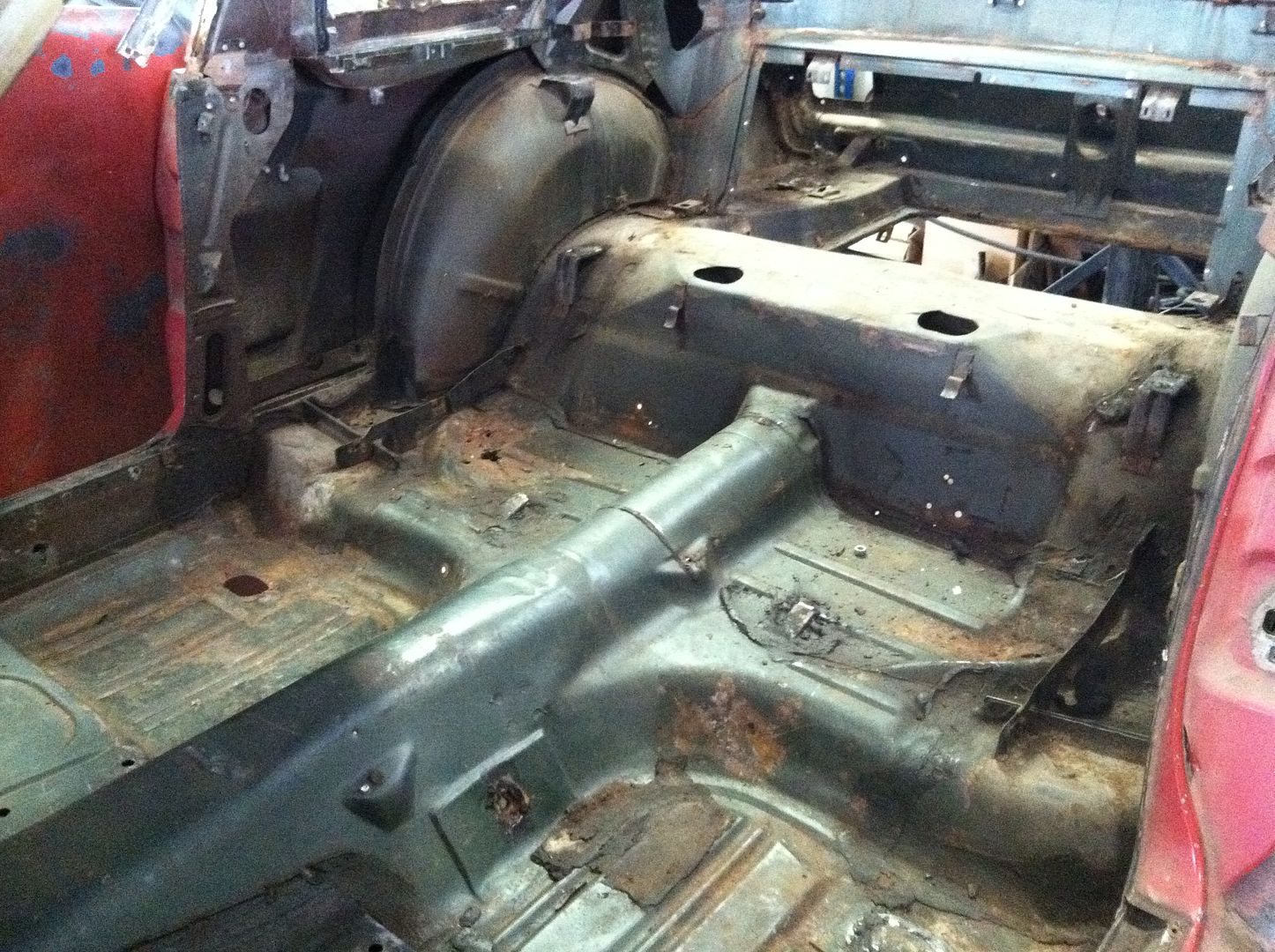

So as we started to do the tear down, we realized the car was in need of a lot of sheet metal.
http://i1337.photobucket.com/albums/...ps5adc42ee.jpg

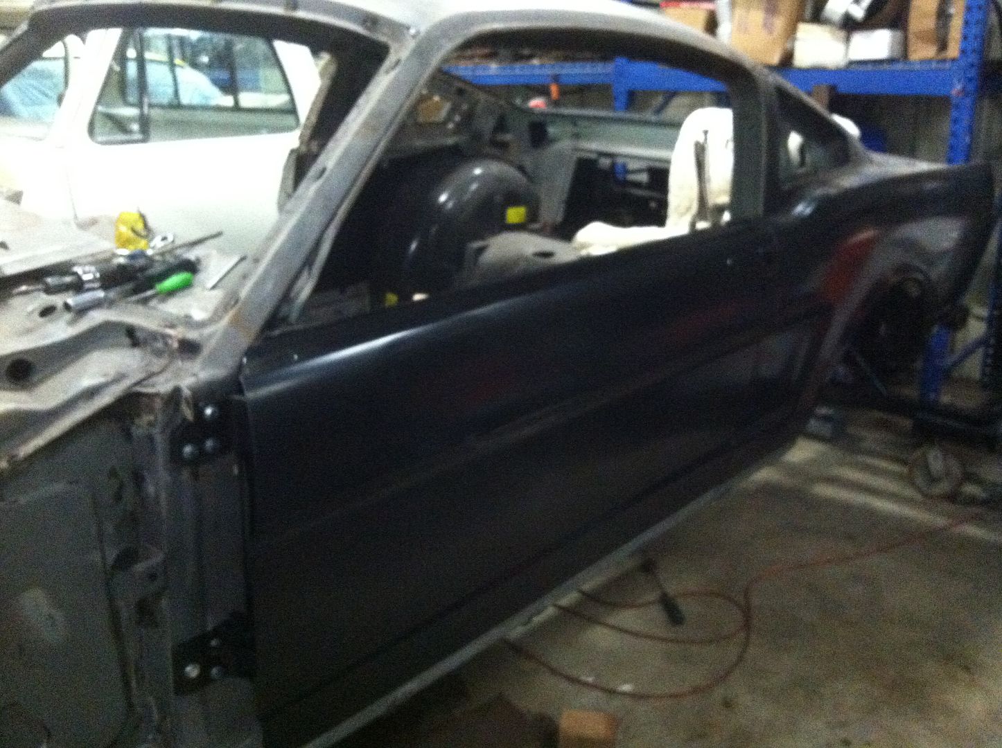

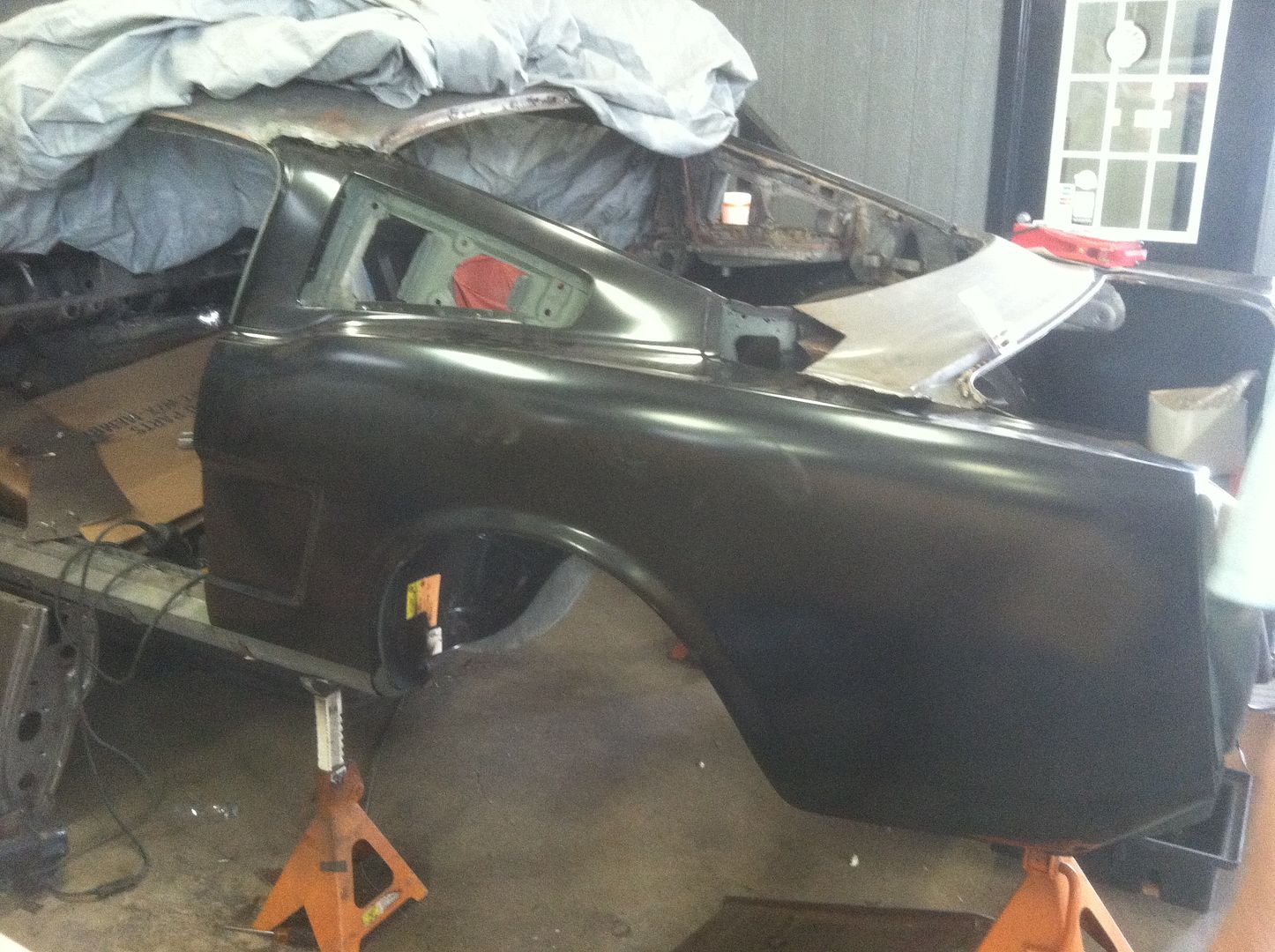

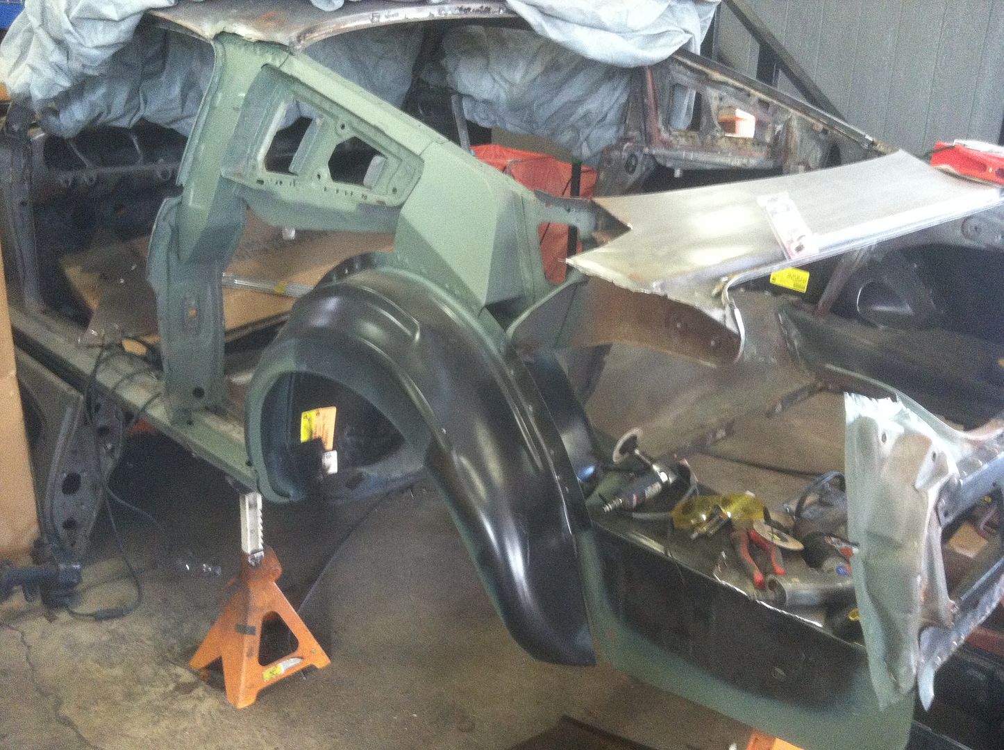

When we got it back to the shop, we started replacing the inner tubs with a wider version, new Quarters, Floors, Trunk, Doors, Fenders, pretty much most of the sheet metal was replaced
http://i1337.photobucket.com/albums/...ps404f1827.jpg
http://i1337.photobucket.com/albums/...pse1128691.jpg
http://i1337.photobucket.com/albums/...ps2ed35c5f.jpg

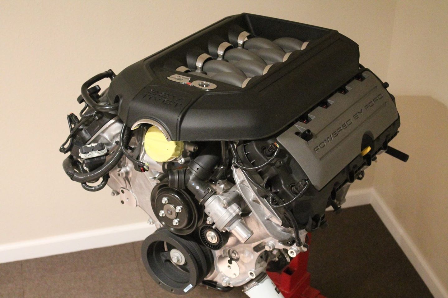

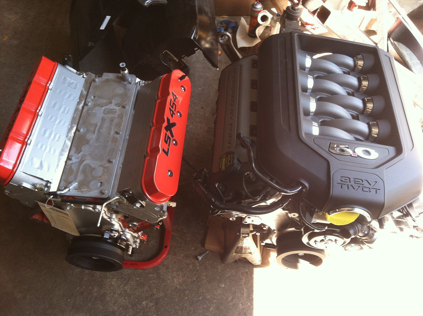

The new power plant arrived
http://i1337.photobucket.com/albums/...ps8c252bdf.jpg
Gives you an idea of how large this little motor really is
http://i1337.photobucket.com/albums/...ps44a0e706.jpg

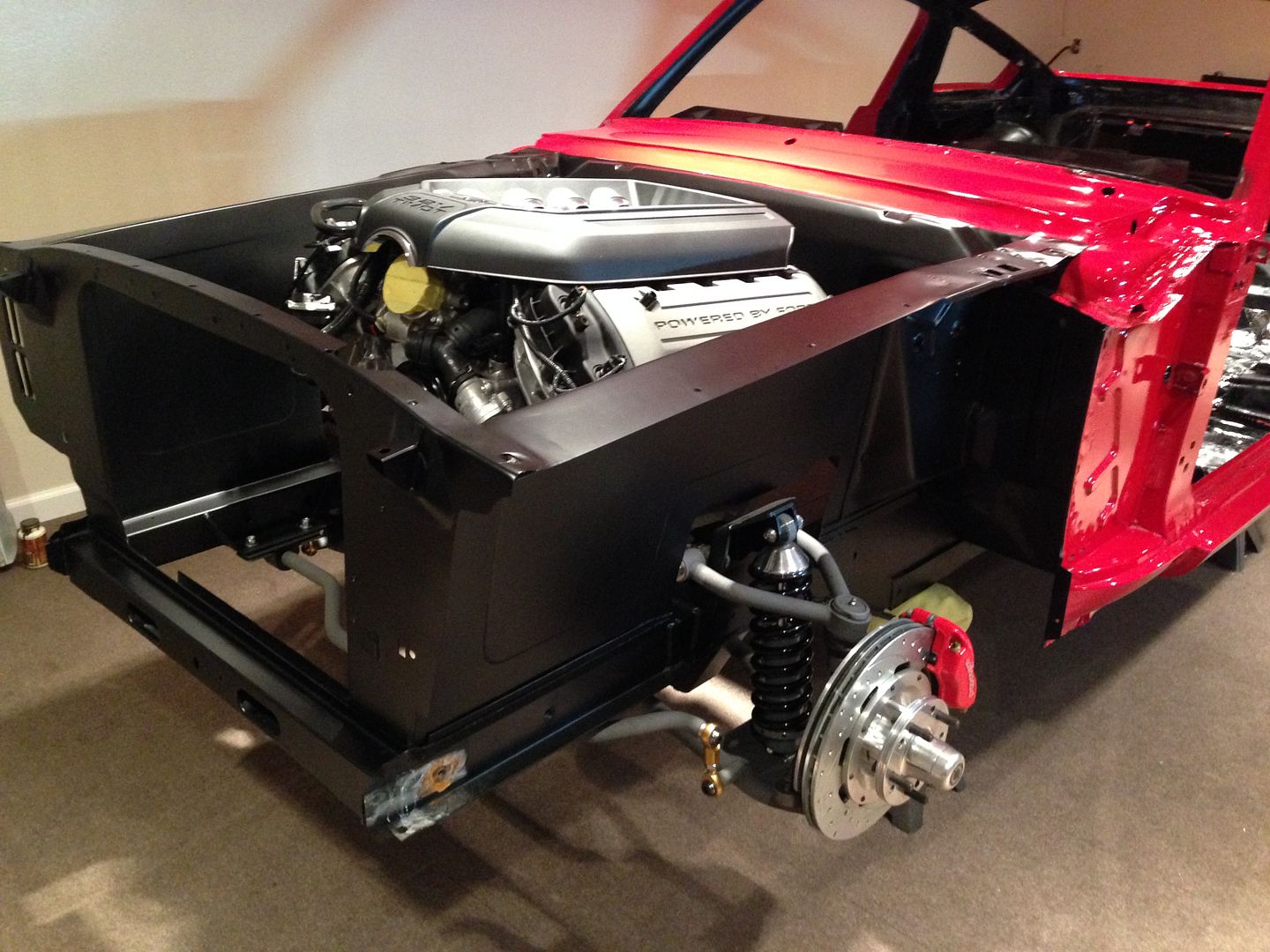

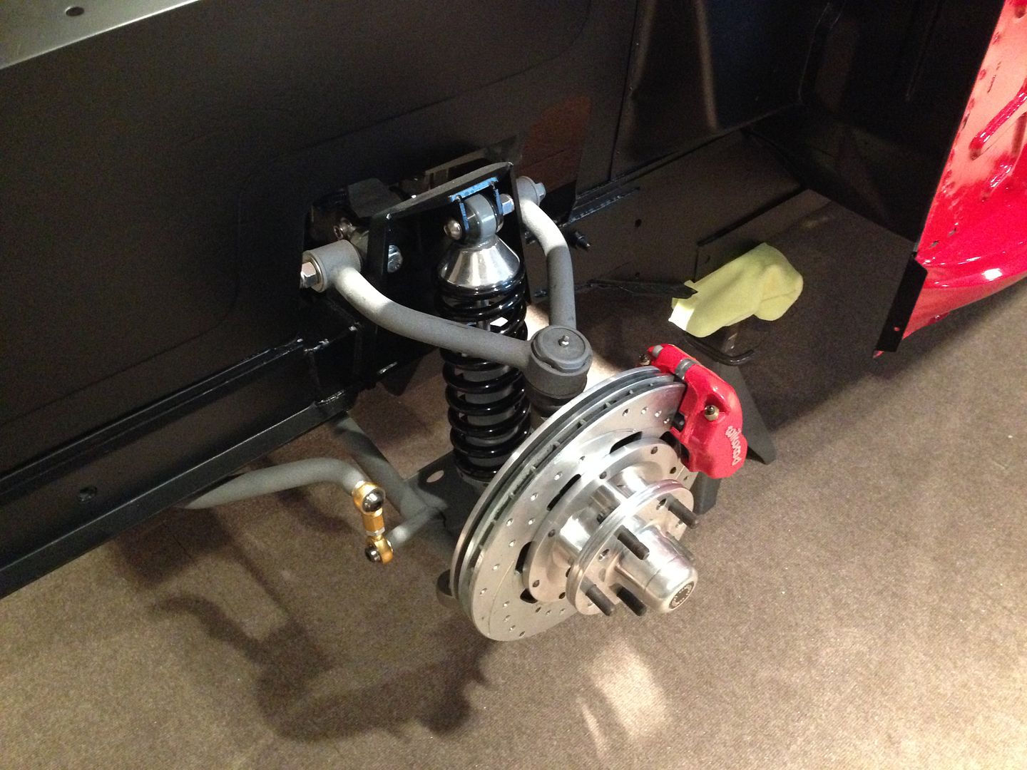

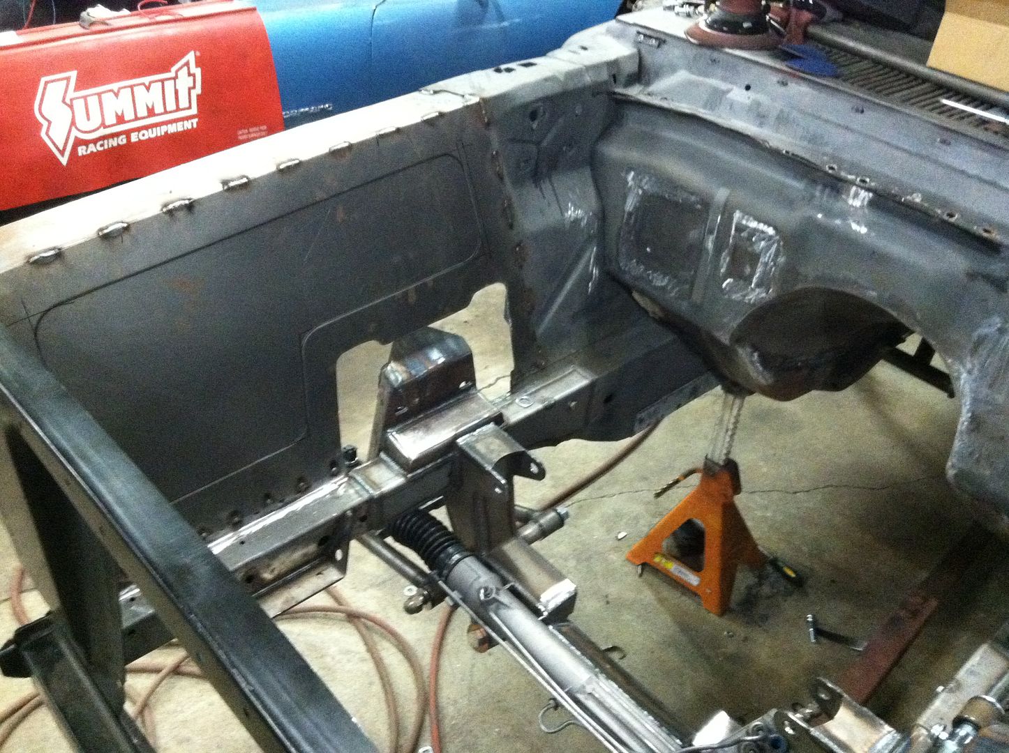

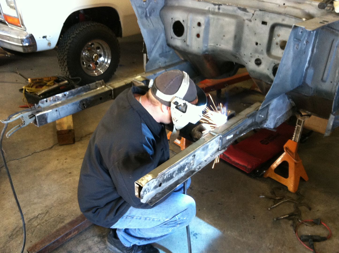

Both shock towers and the entire front inner fender area was destroyed. It had been in an accident and the repair was horrible. We cut it all out of the way and started installing the TCI front suspension
http://i1337.photobucket.com/albums/...ps4152d1cf.jpg

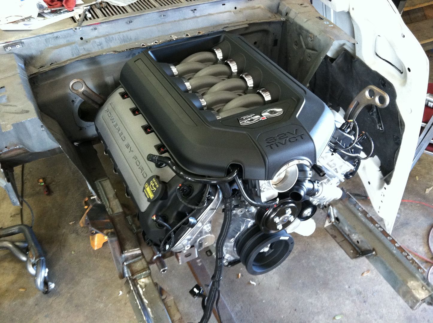

Test fit the engine
http://i1337.photobucket.com/albums/...ps2ecab6a7.jpg

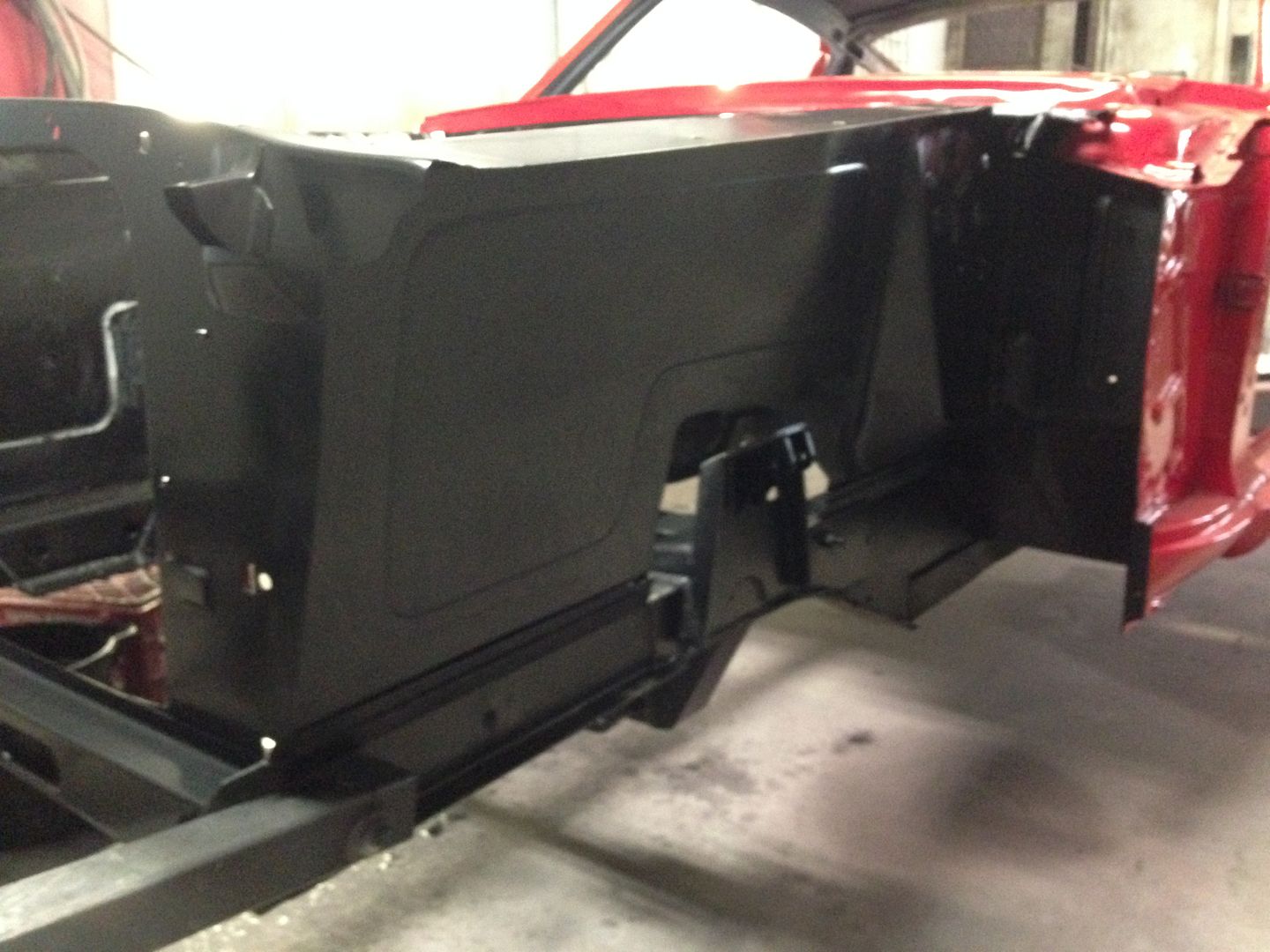

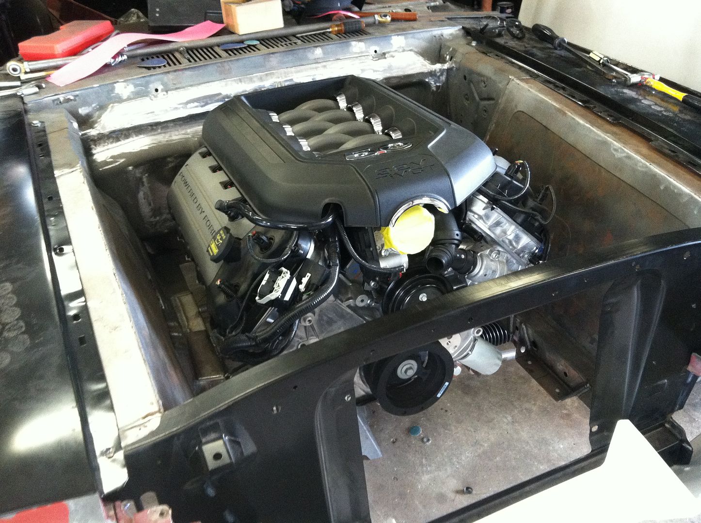

Started fabricating some better looking panels to clean up the engine bay area
http://i1337.photobucket.com/albums/...ps70bd0a16.jpg

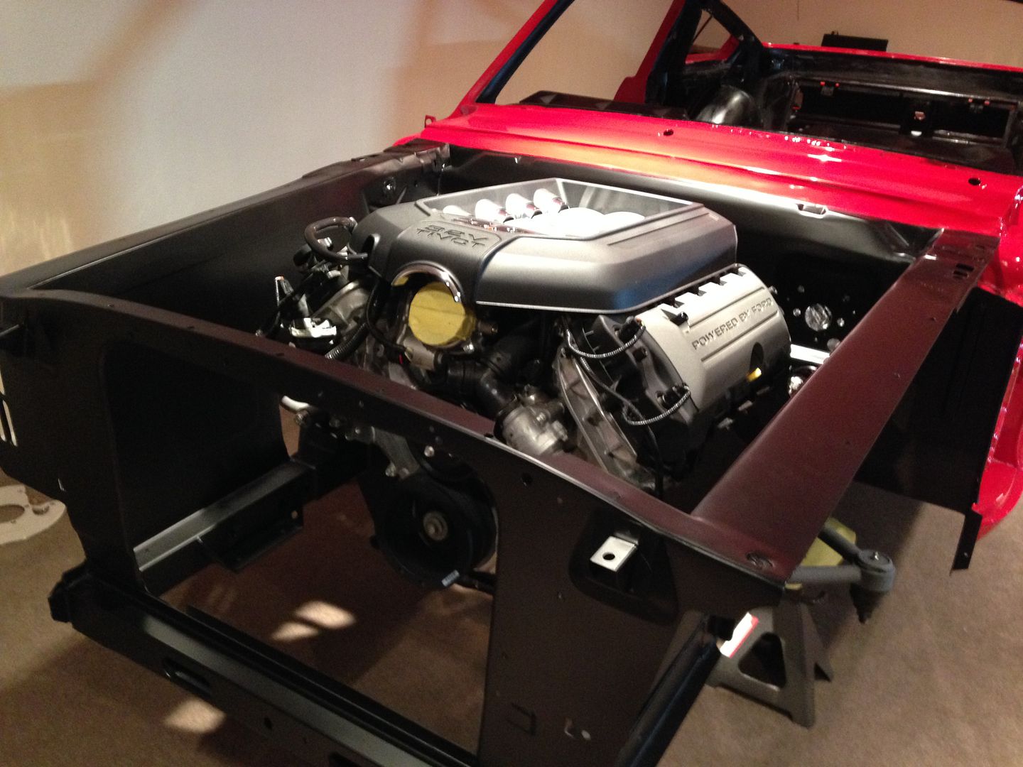

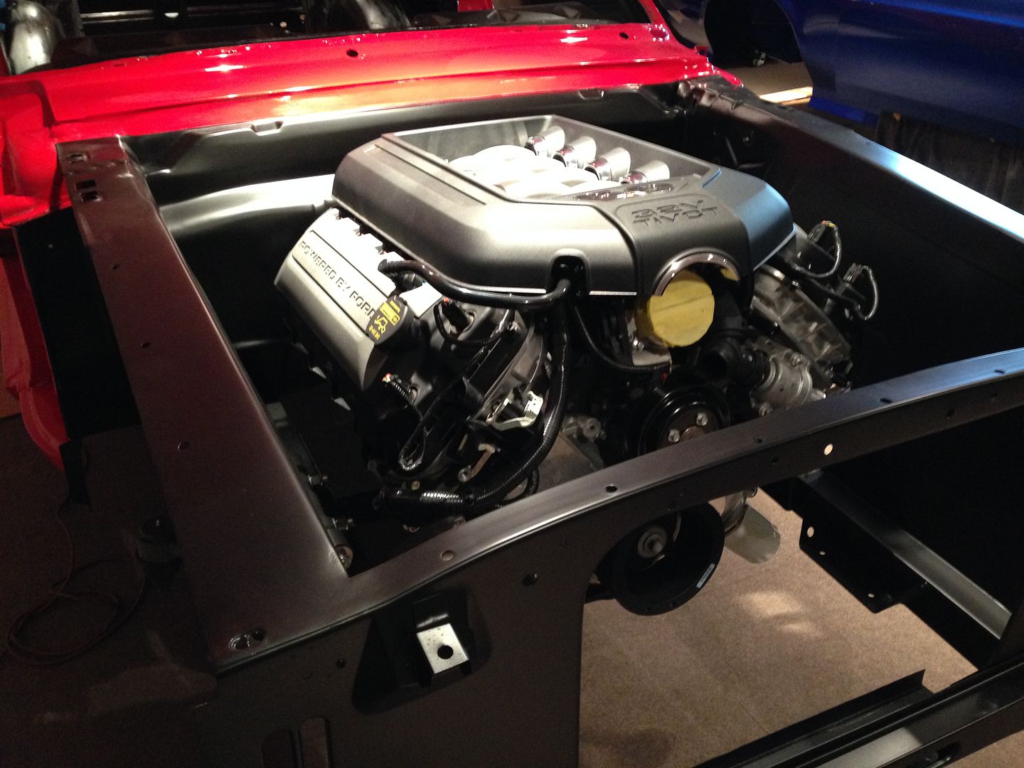

Then we installed the 5.0 with the 5 Speed. Then we ended up raising the trans tunnel
http://i1337.photobucket.com/albums/...ps4deb1bad.jpg

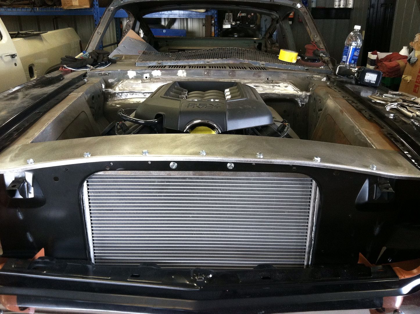

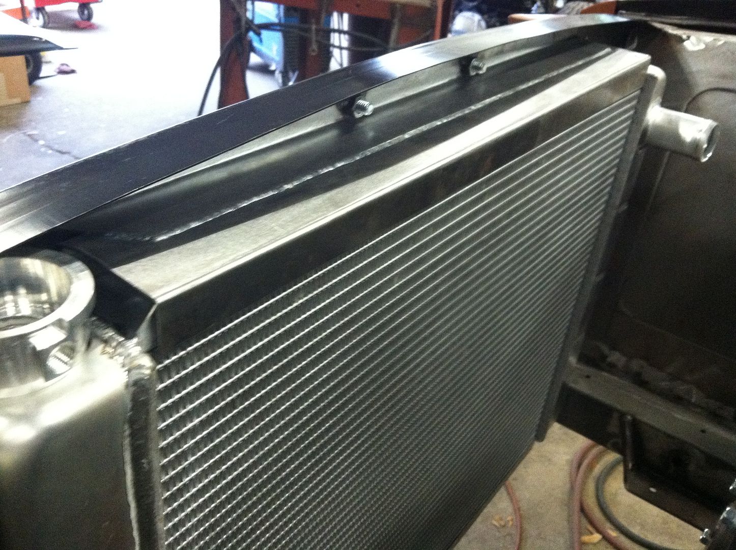

Fabbed up a radiator mount.
http://i1337.photobucket.com/albums/...ps02cd4b1b.jpg

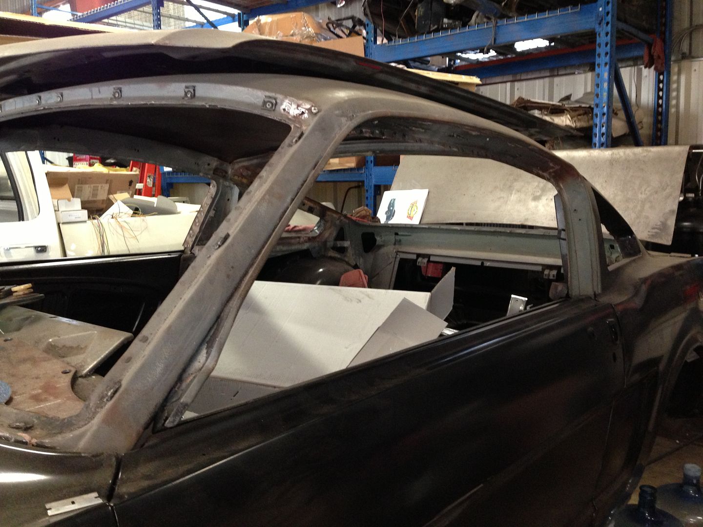

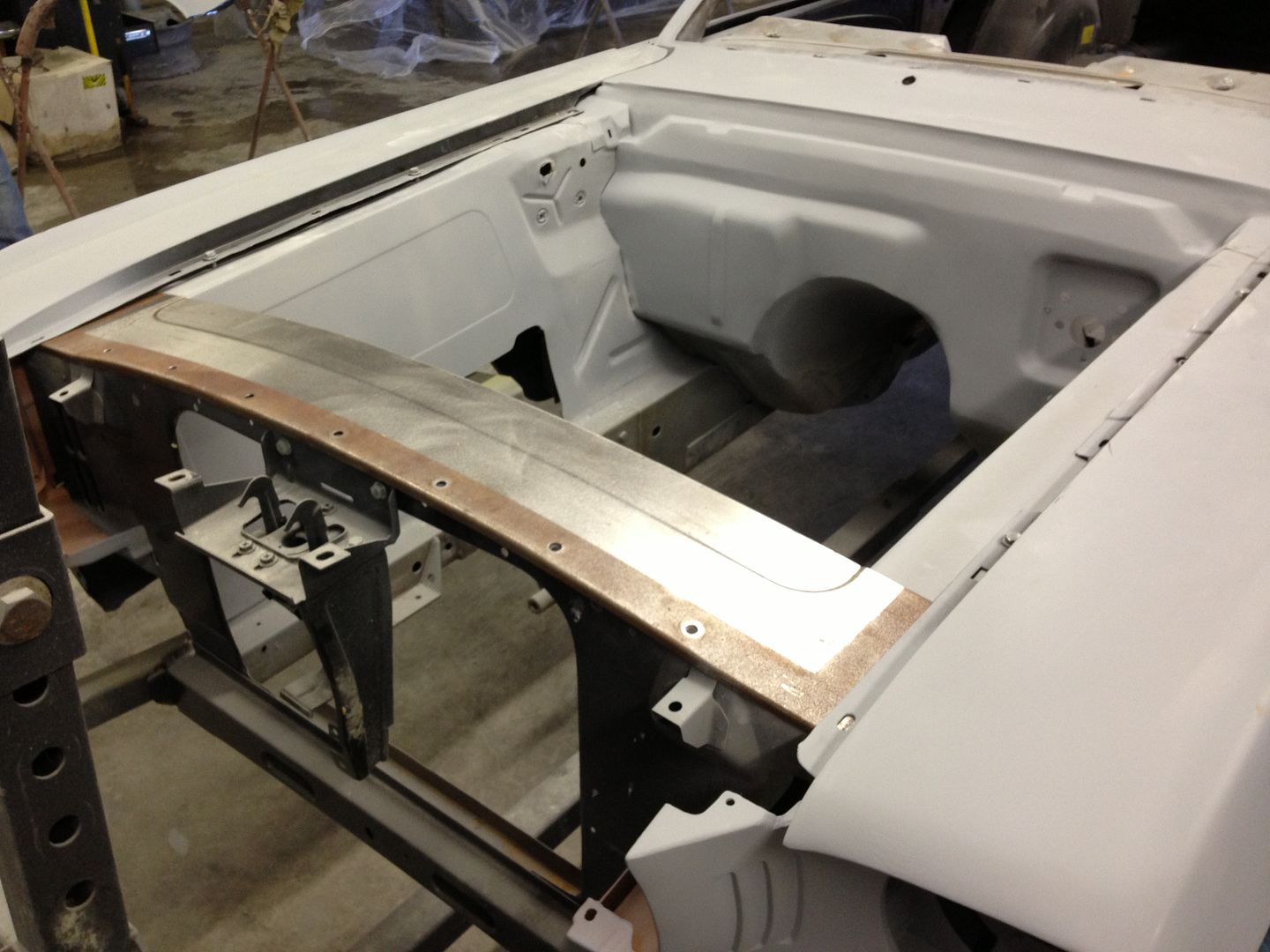

The drip rails needed some attention. They were rotten and falling off
http://i1337.photobucket.com/albums/...ps4ab135bb.jpg

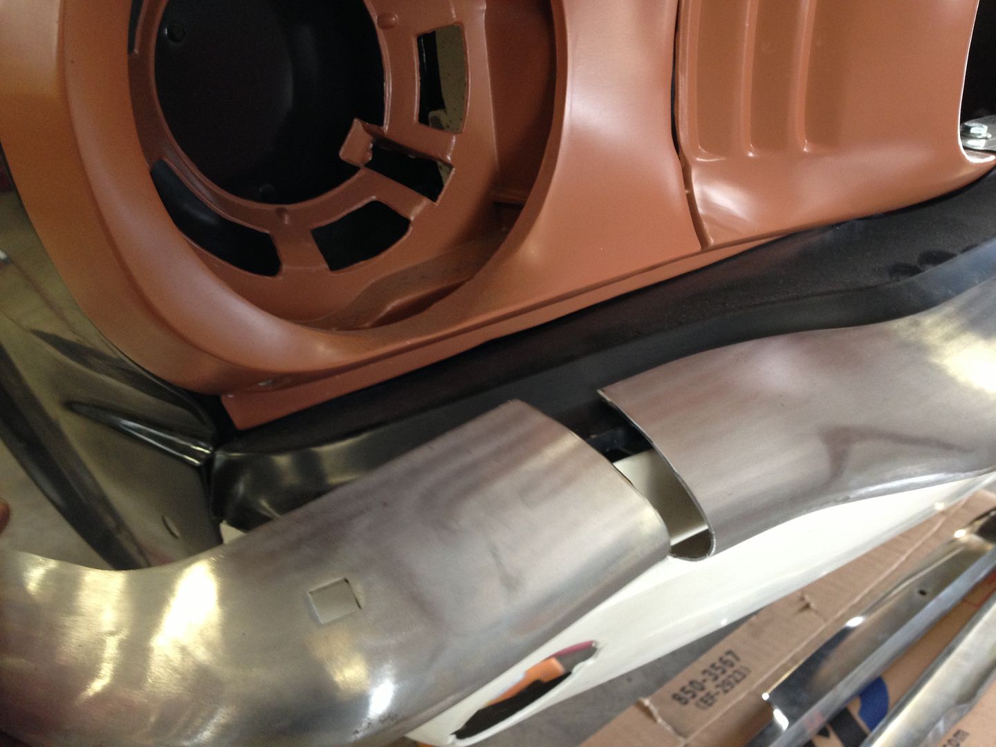

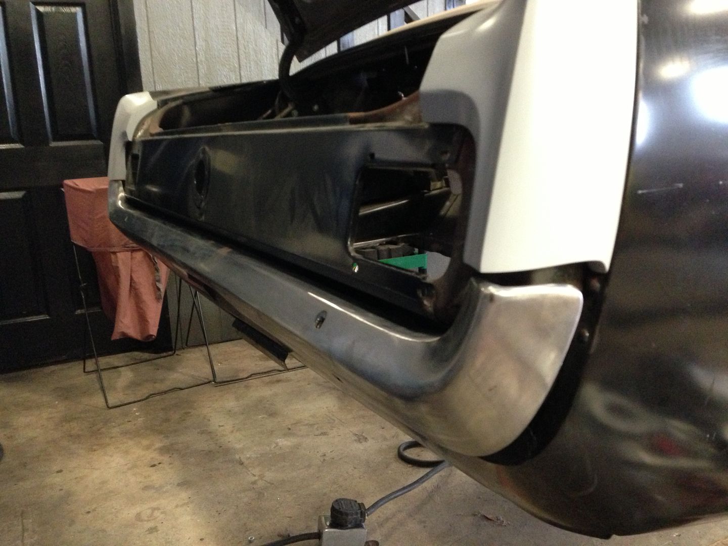

Once all the sheet metal was lined out, we started hacking up the front bumper to make it fit tighter
http://i1337.photobucket.com/albums/...psa34172c9.jpg
http://i1337.photobucket.com/albums/...ps20d2a6df.jpg
The rear bumper needed a lot of attention too
http://i1337.photobucket.com/albums/...ps1f46af91.jpg
Once they were trimmed and notched and re shaped, we took them off and welded all the holes up too

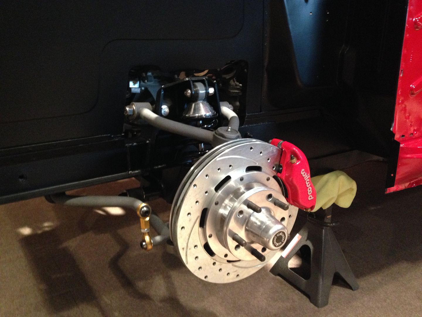

Suspension stuff is headed out to the powder coater
http://i1337.photobucket.com/albums/...pssqtk8nk9.jpg

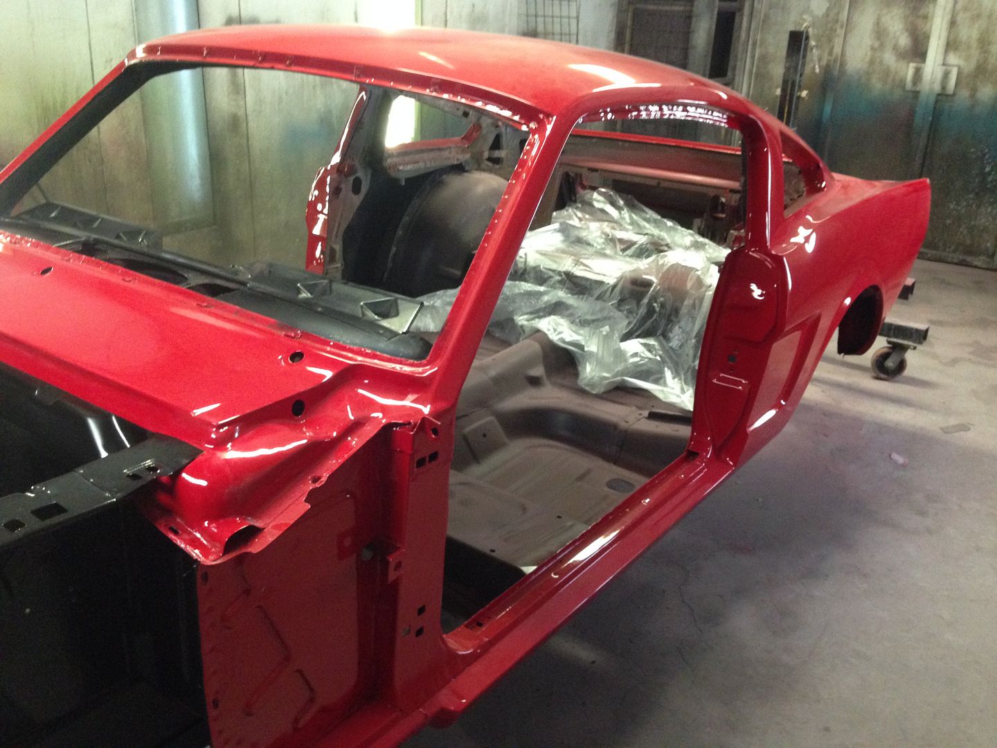

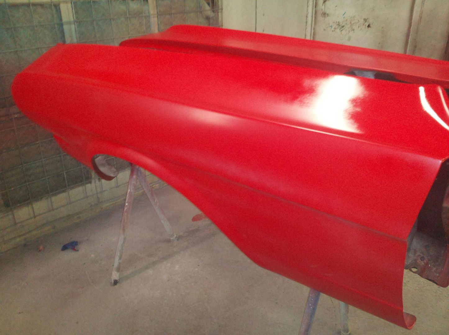

Body is off to paint
http://i1337.photobucket.com/albums/...ps2e545cbd.jpg

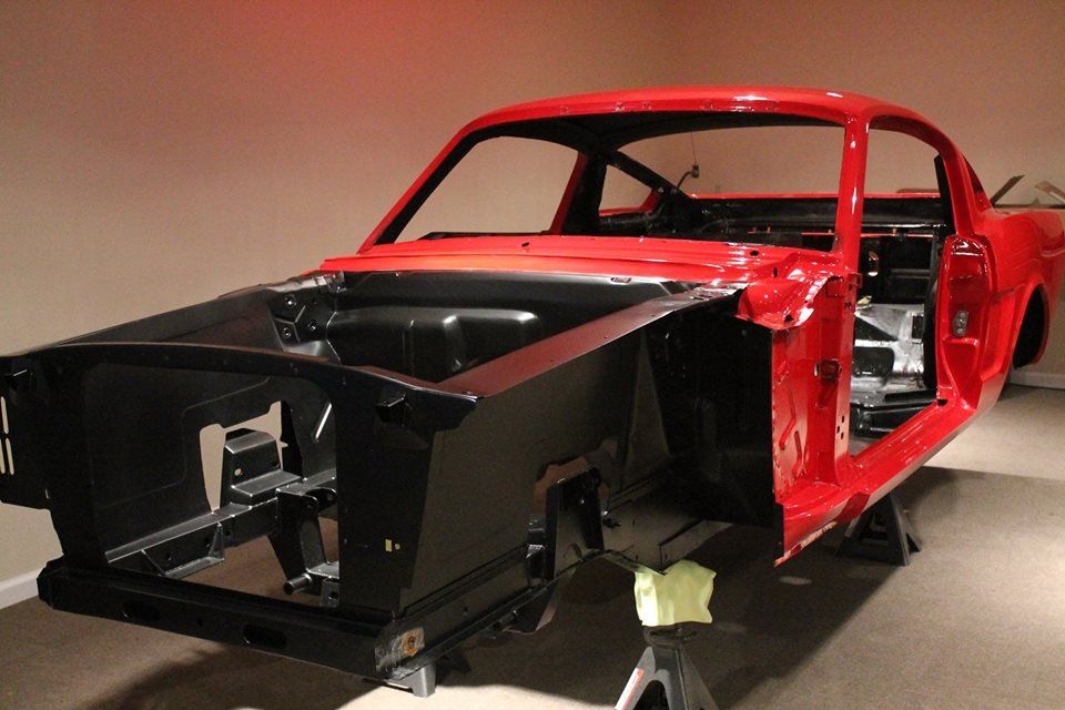

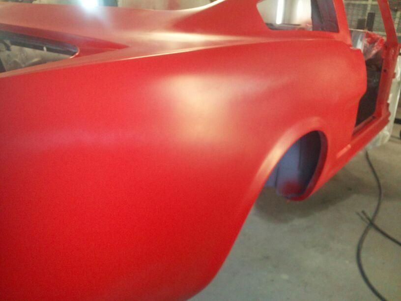

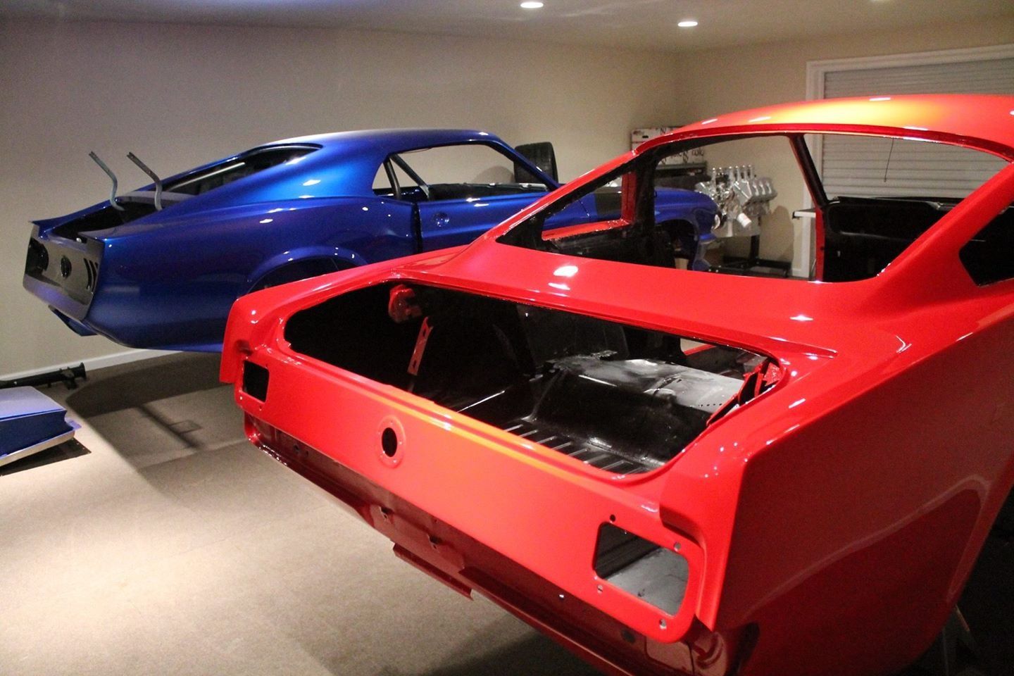

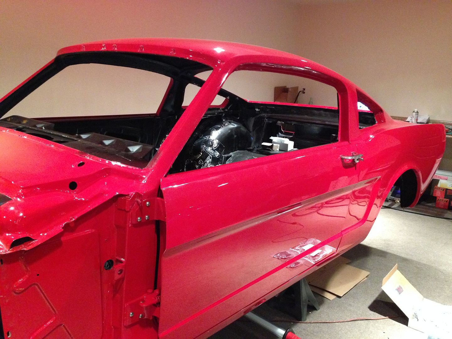

GAP Industries 01-01-2014 12:17 PM

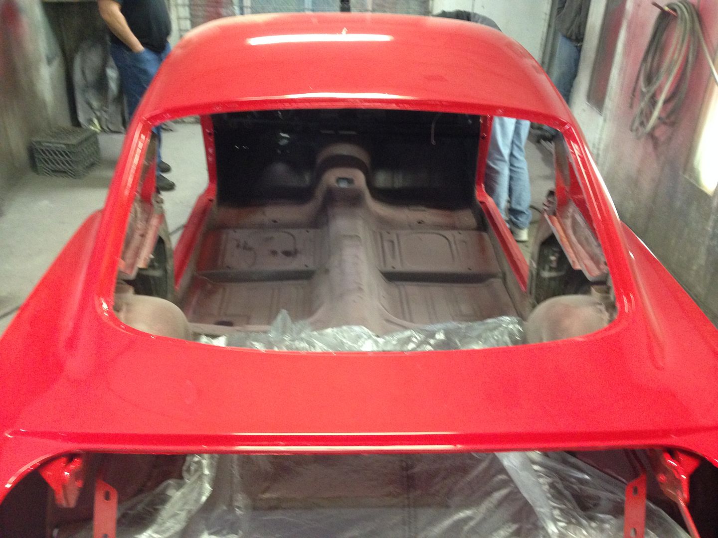

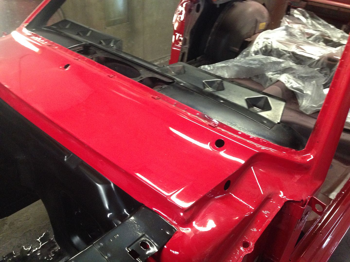

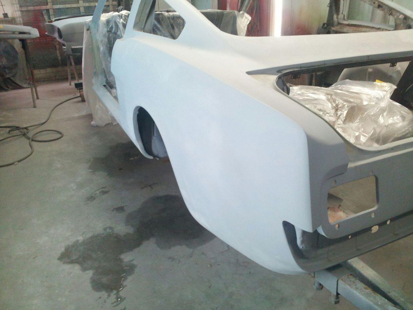

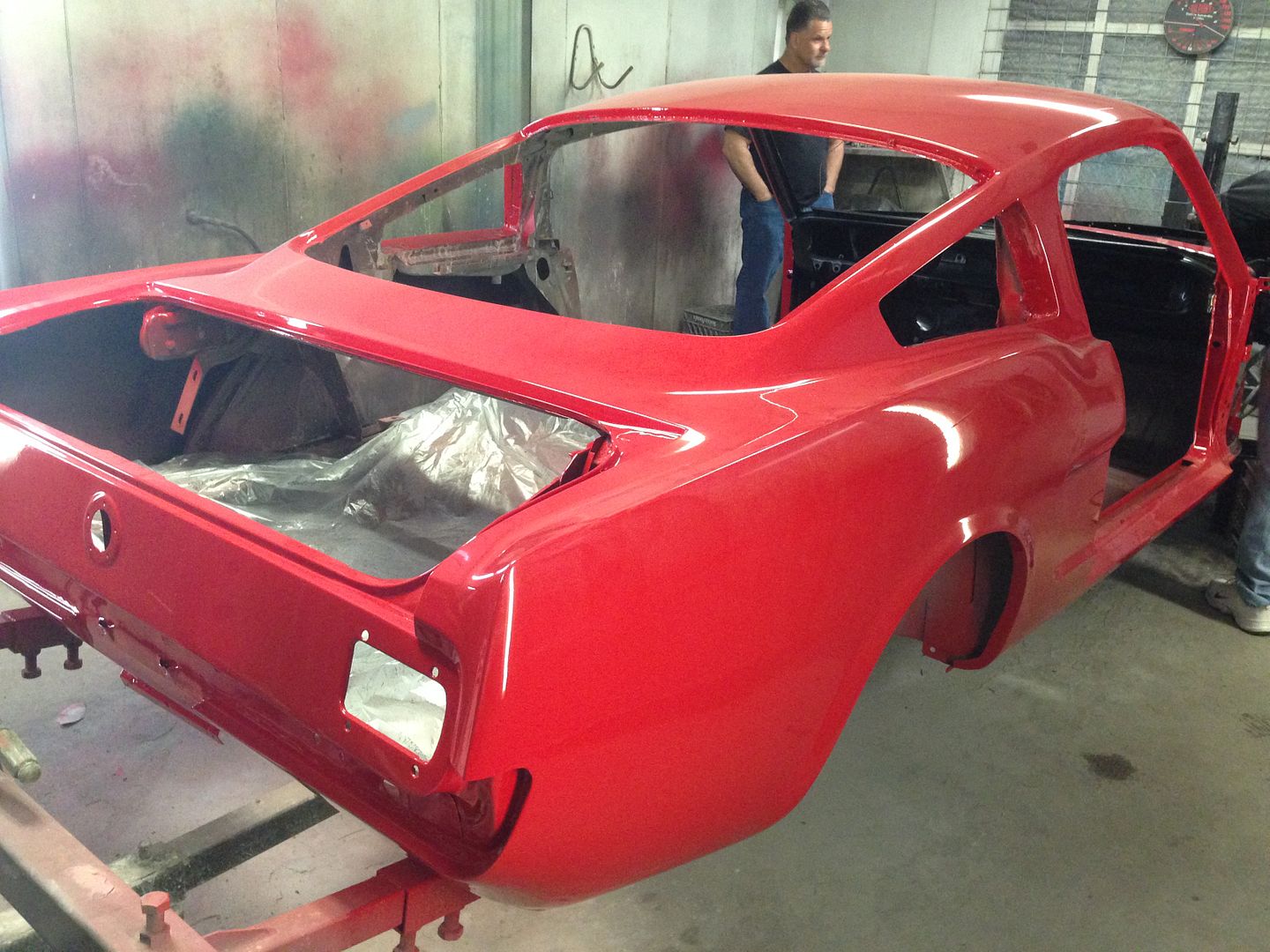

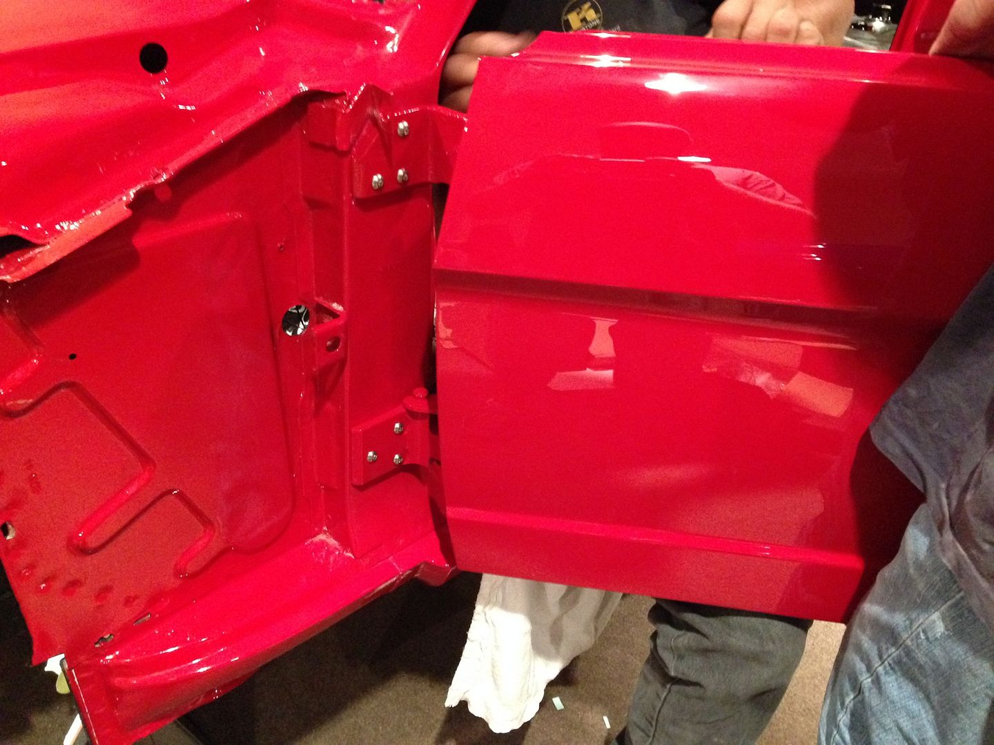

Body Shop update. All the body work is done
http://i1337.photobucket.com/albums/...psbb71bddf.jpg
http://i1337.photobucket.com/albums/...psa88a0a41.jpg
Customer ended up going with a Nissan Redline Red
http://i1337.photobucket.com/albums/...ps3aav3axj.jpg
http://i1337.photobucket.com/albums/...psip27ofwb.jpg

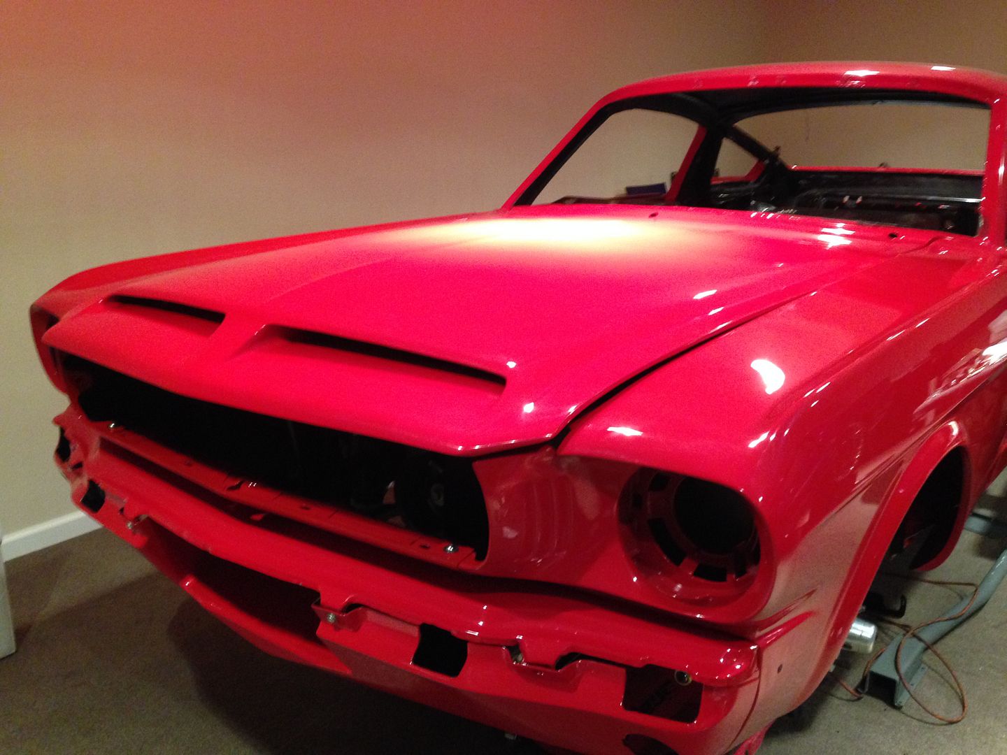

GAP Industries 01-01-2014 12:18 PM
Hope to have some more updates early in January. As soon as its buffed out, we will have it in the clean room so it can go back together.
We did not do a lot of custom stuff to the car. Customer wanted to keep all the factory trim and stainless. Should be a really cool driver.

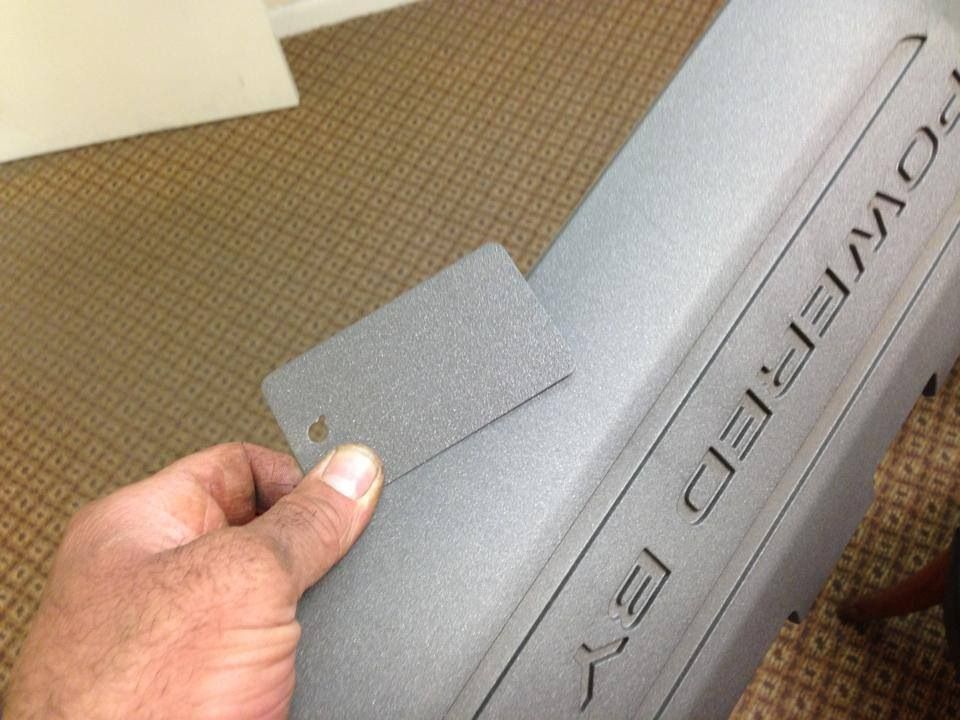

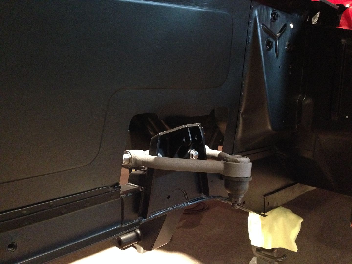

We found a textured powder coat for the suspension that matched the Valve covers and intake
http://i1337.photobucket.com/albums/...psb6ec8lav.jpg
