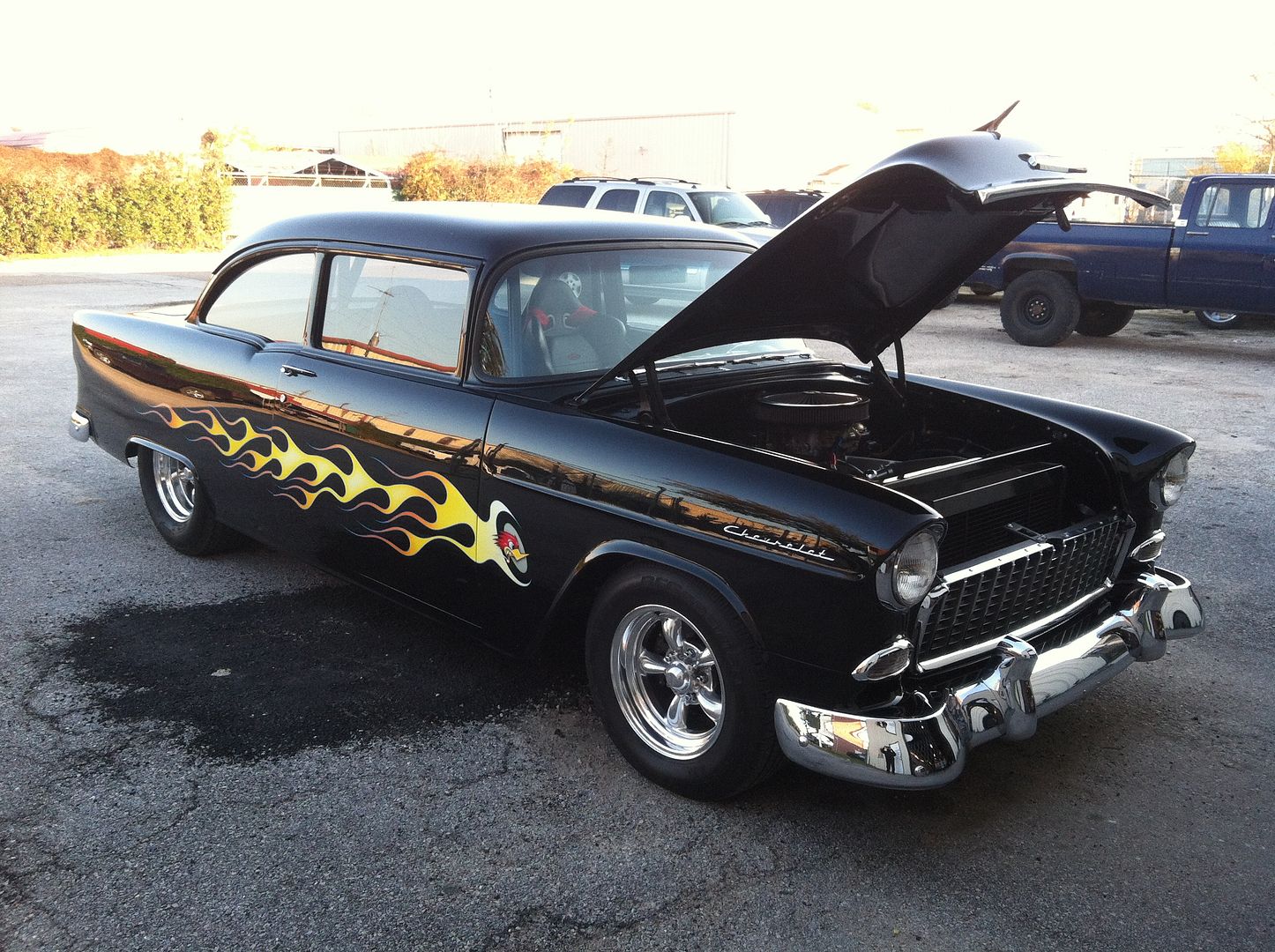

GAP Industries 01-05-2014 09:29 AM
1955 BelAir finish at GAP Racing
This car came in as someone's street/strip car. It already had a ladder bar rear suspension and a roll cage in it. The plan was to ditch the 468 Big Block, add a lot more power, a lot more tire and clean the car up.
Here is what we started with
http://i1337.photobucket.com/albums/...ps14001e9b.jpg
GAP Industries 01-05-2014 09:30 AM
The customer really liked the flames and the graphics on the side and did not want to redo the paint either.

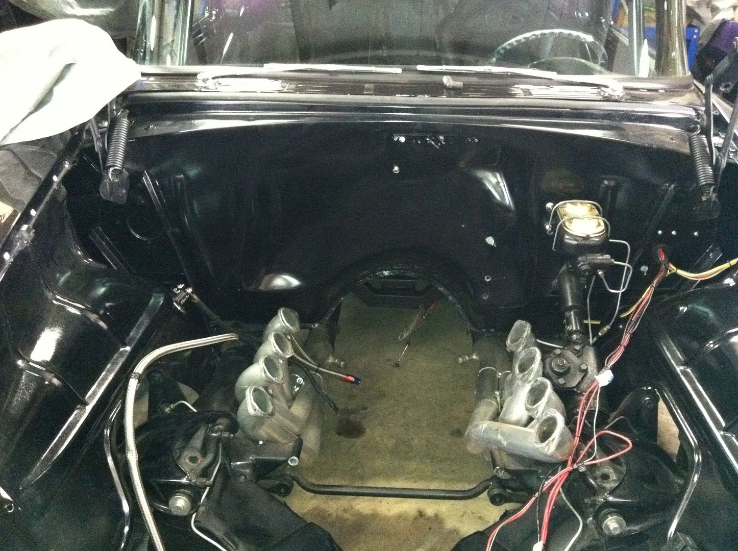

GAP Industries 01-05-2014 09:31 AM

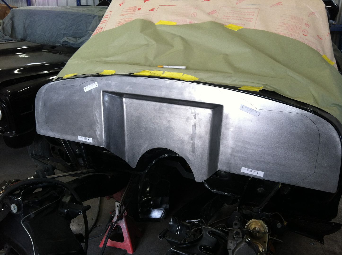

Firewall modification was done.
http://i1337.photobucket.com/albums/...psaf4256b4.jpg

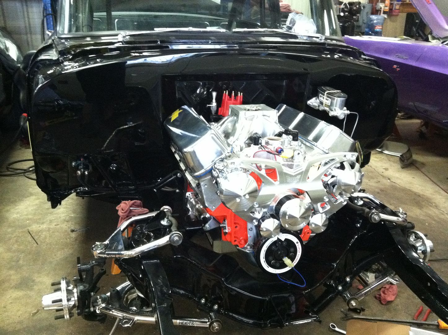

GAP Industries 01-05-2014 09:33 AM

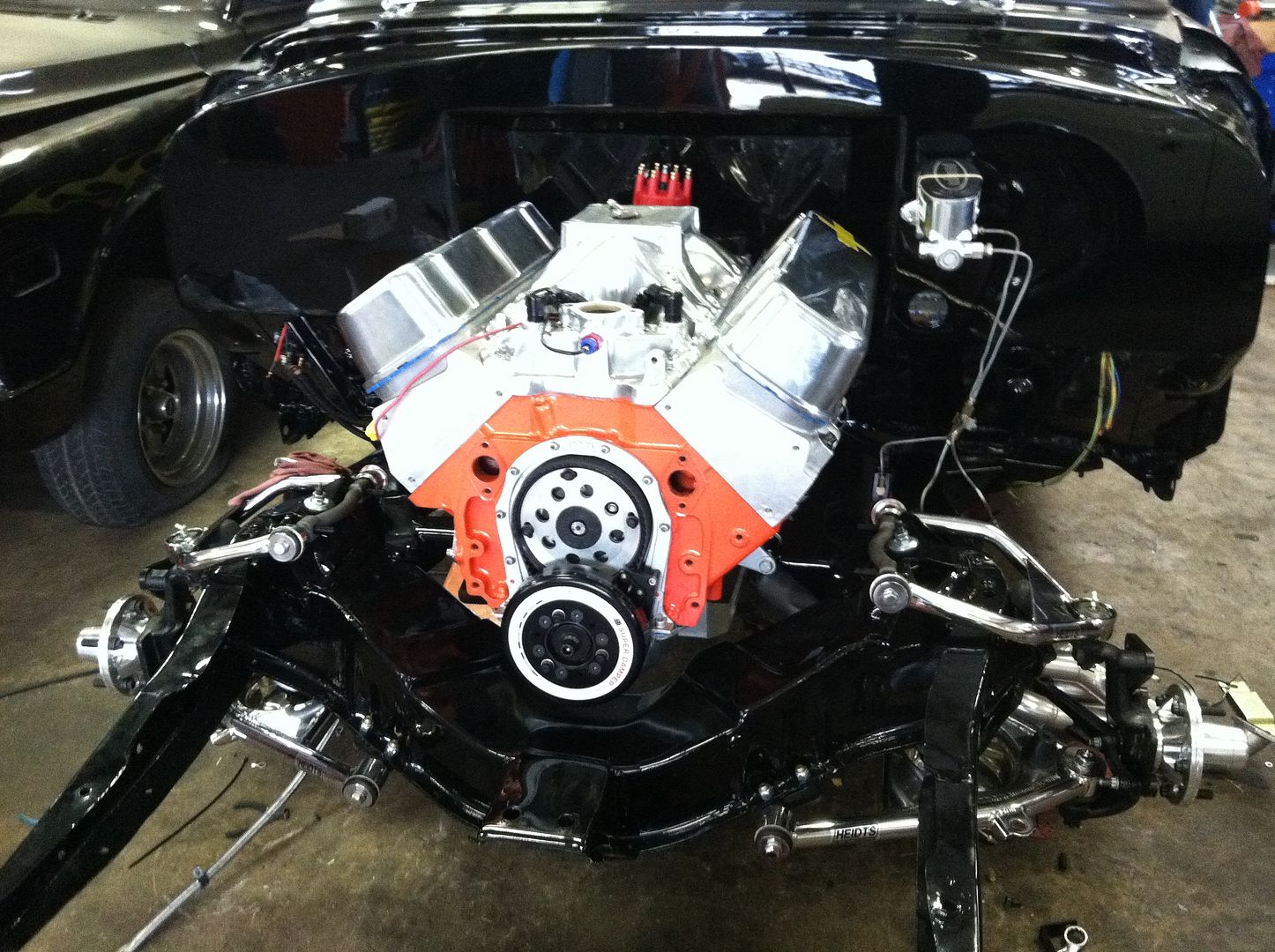

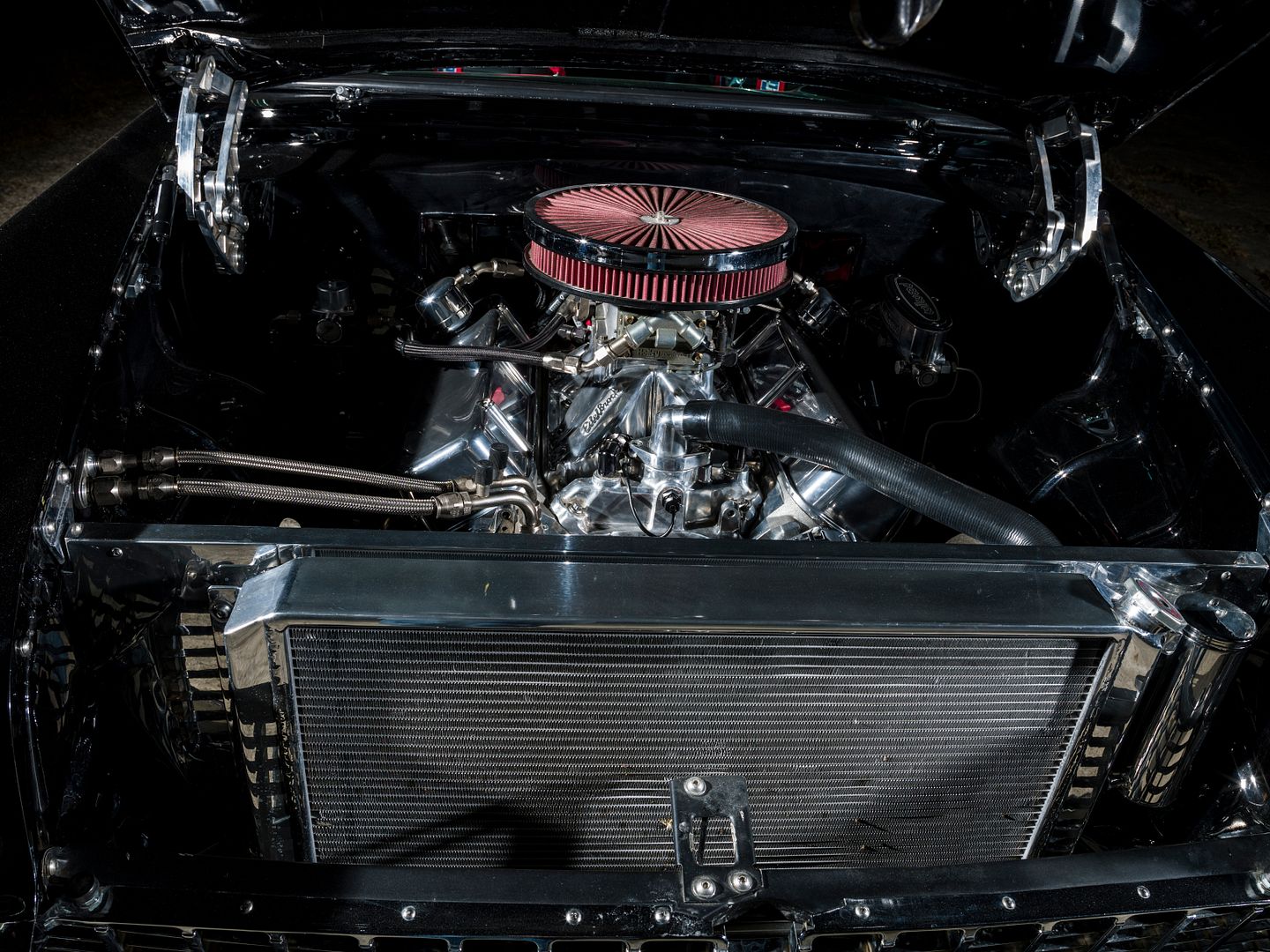

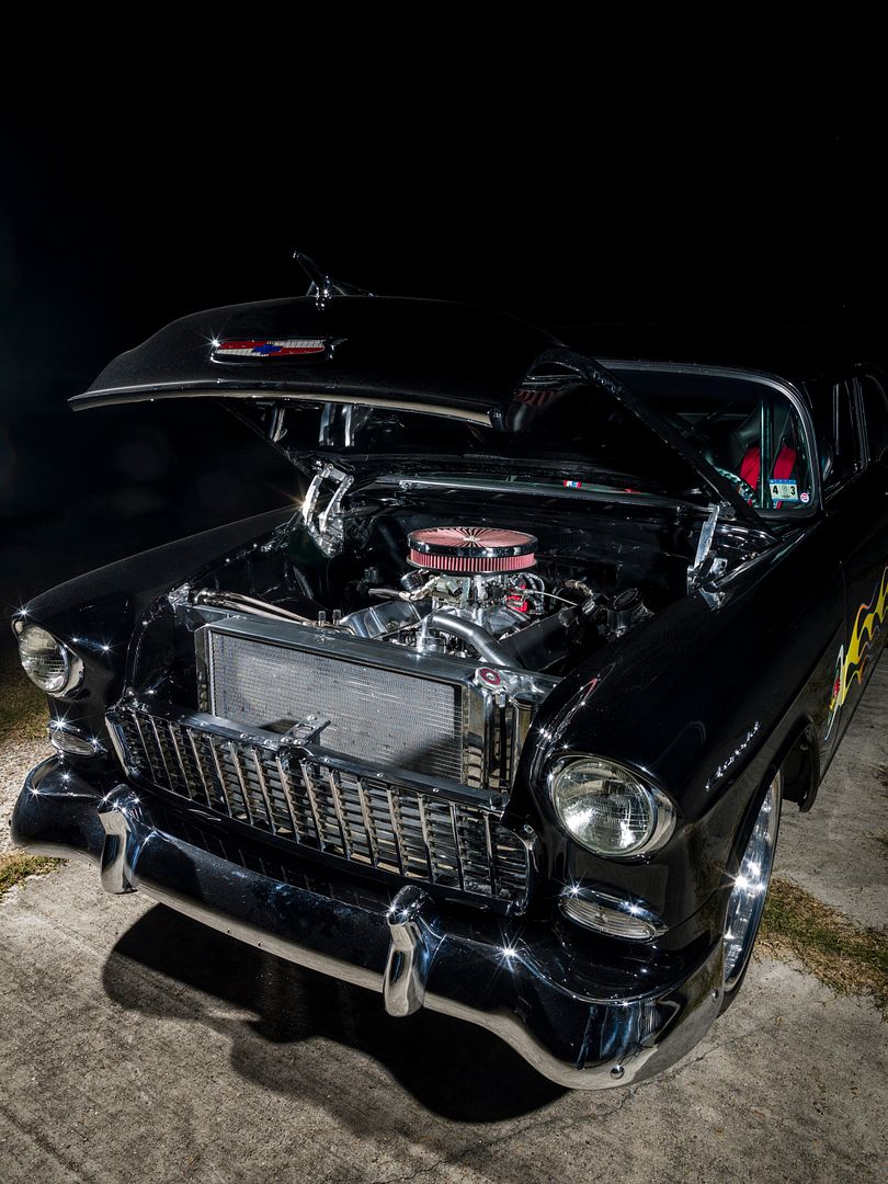

The guys over at Houston Engine and Balancing put together a really strong 598 Cubic inch motor that put out over 920 Horses.
http://i1337.photobucket.com/albums/...ps7fb9d813.jpg
We also installed a set of Heidts Stainless A-Arms, Wilwood master cylinder and started building a custom set of headers
http://i1337.photobucket.com/albums/...psa6dbdec5.jpg

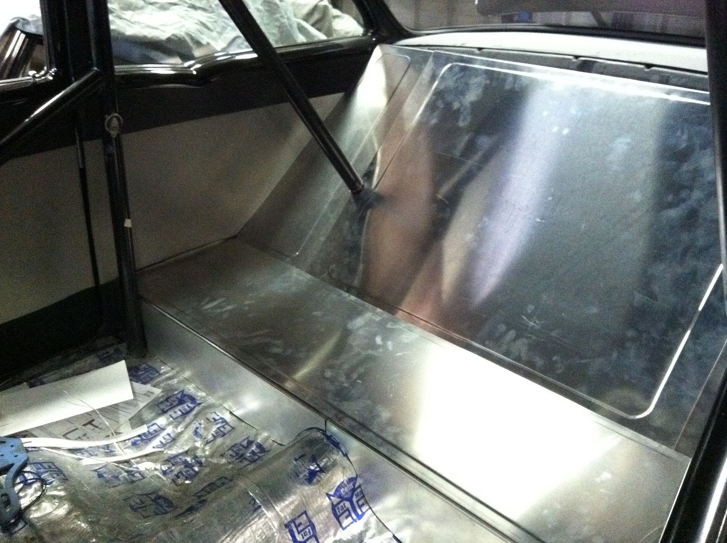

GAP Industries 01-05-2014 09:36 AM

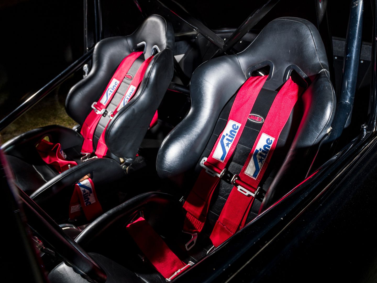

On the inside, we re-tubbed the back of the car to make room for much larger wheels and tires. We also got rid of the wood panels that had been covered in carpet and made some out of aluminum.
http://i1337.photobucket.com/albums/...psba512183.jpg

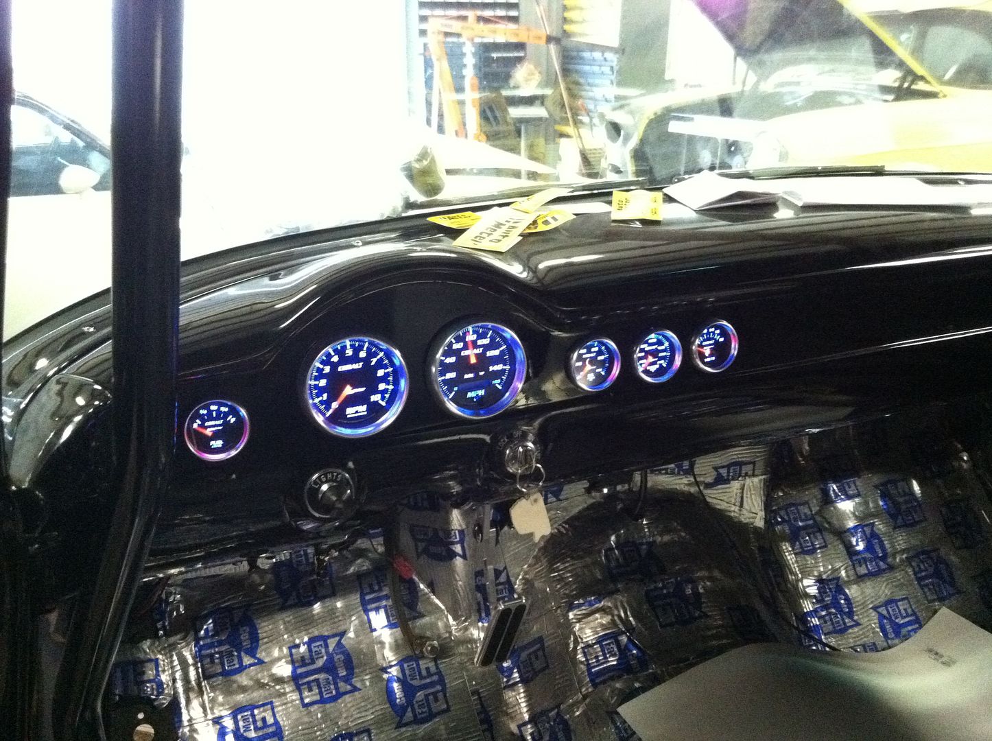

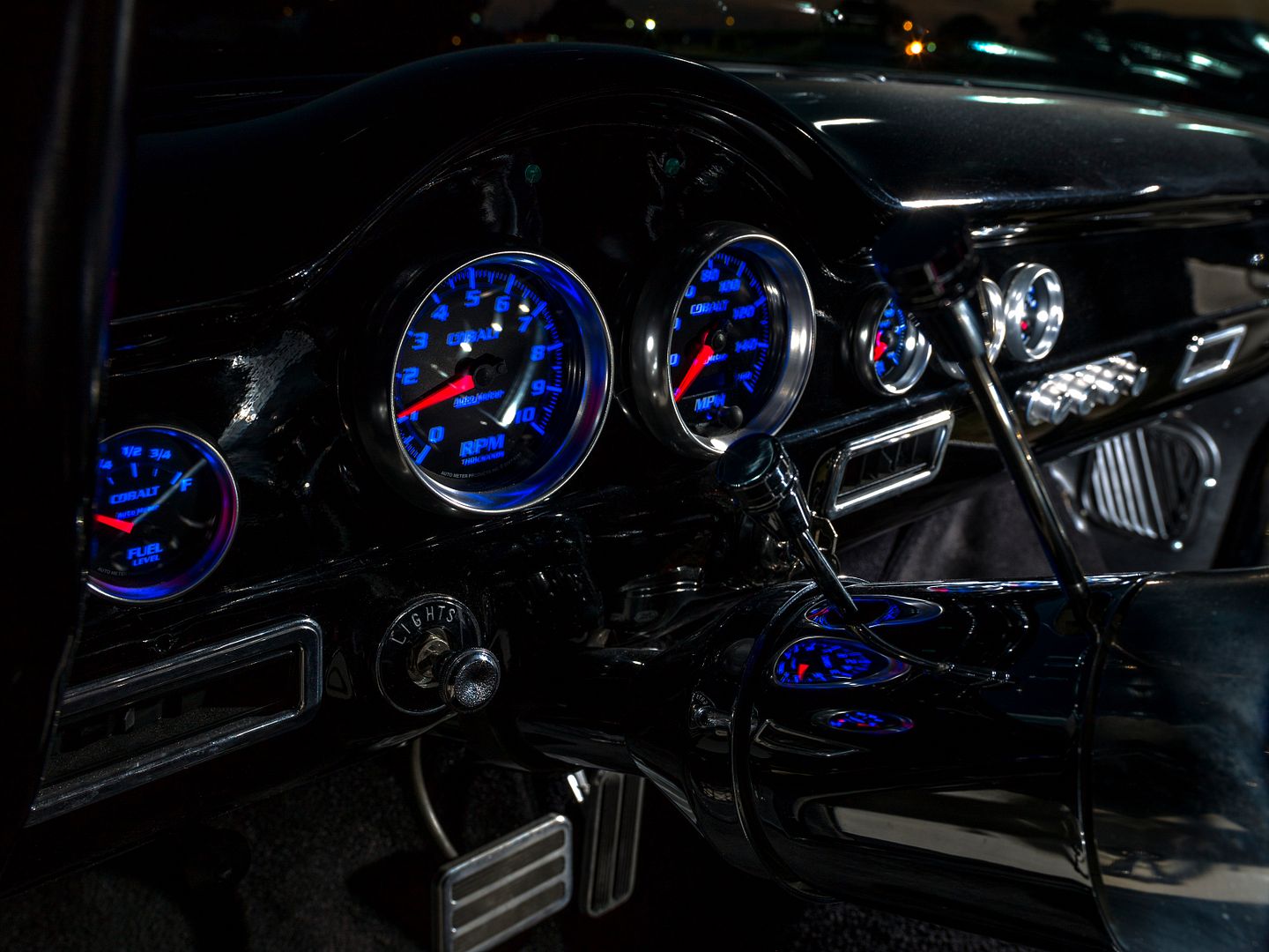

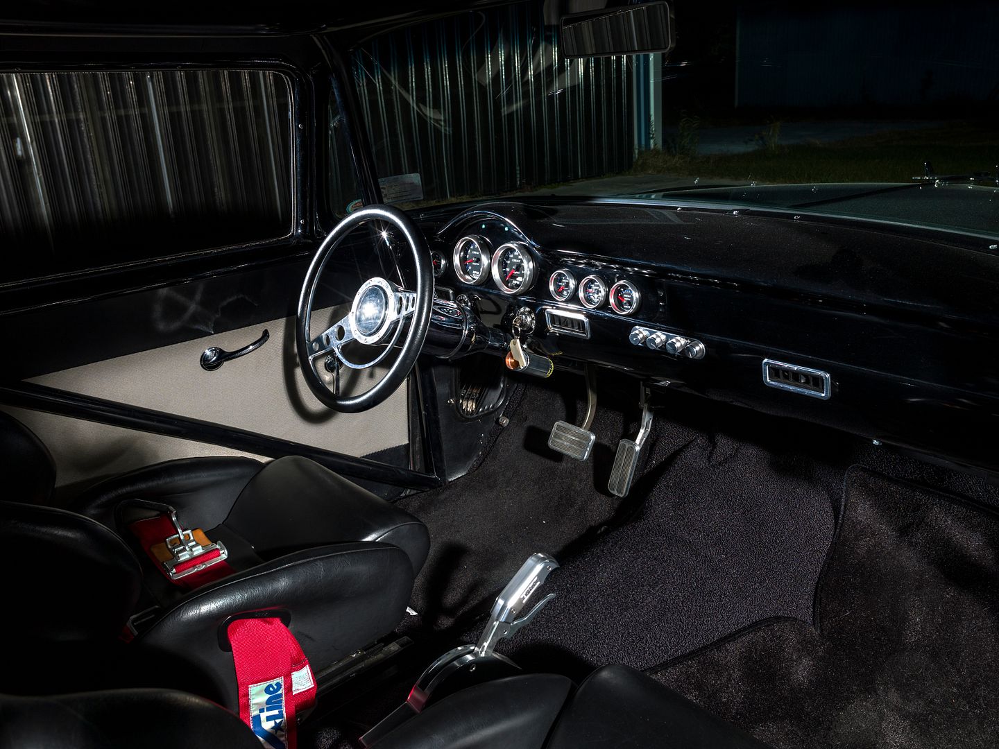

We also welded up the old holes in the dash, modified and repainted the dash to make room for the Autometer Cobalt Gauges
http://i1337.photobucket.com/albums/...ps8432dd21.jpg
We ended up added ac vents and a billet control to the center of the dash for the Vintage Air we installed also.

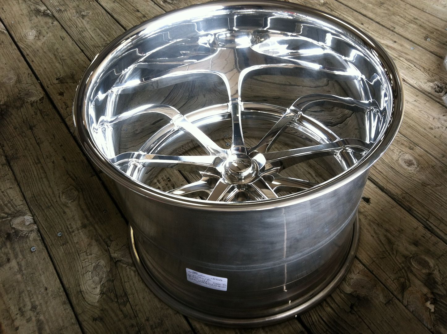

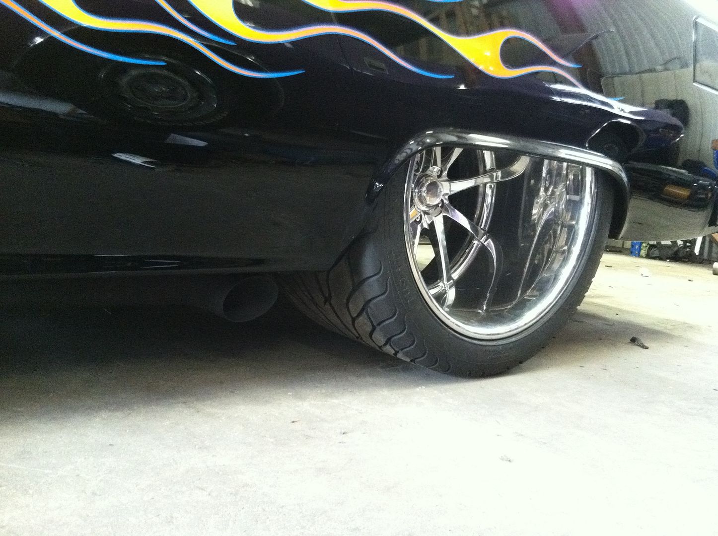

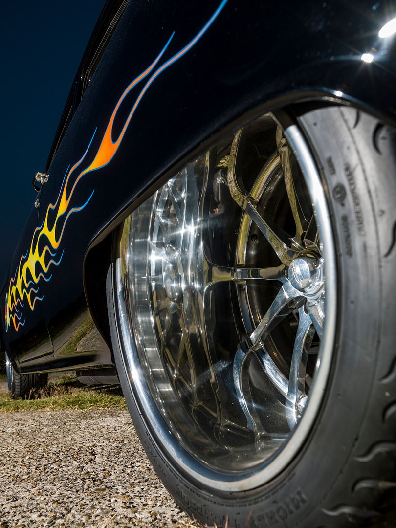

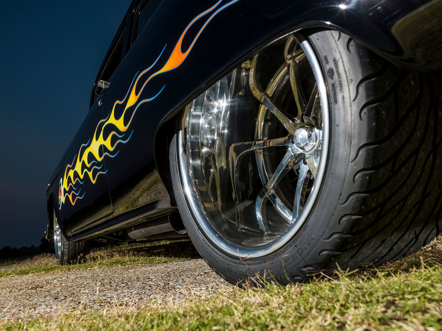

Billet Specialties Turbine wheels arrived. 20x15 for the rear
http://i1337.photobucket.com/albums/...ps080f8c99.jpg
GAP Industries 01-05-2014 09:41 AM

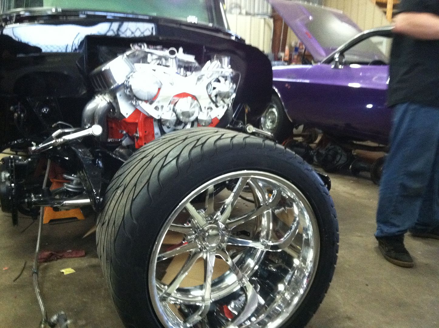

Mounted up the Wheels on Mickey Thompson SR Radials 29x18x20
http://i1337.photobucket.com/albums/...psa68b2695.jpg

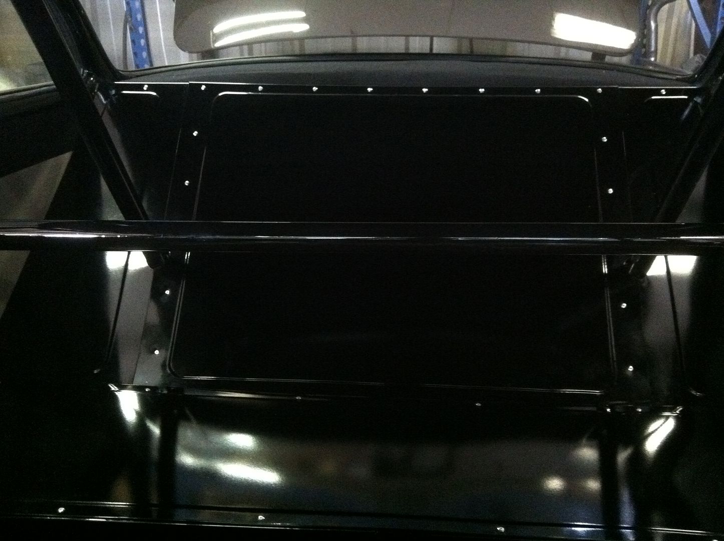

GAP Industries 01-05-2014 09:42 AM

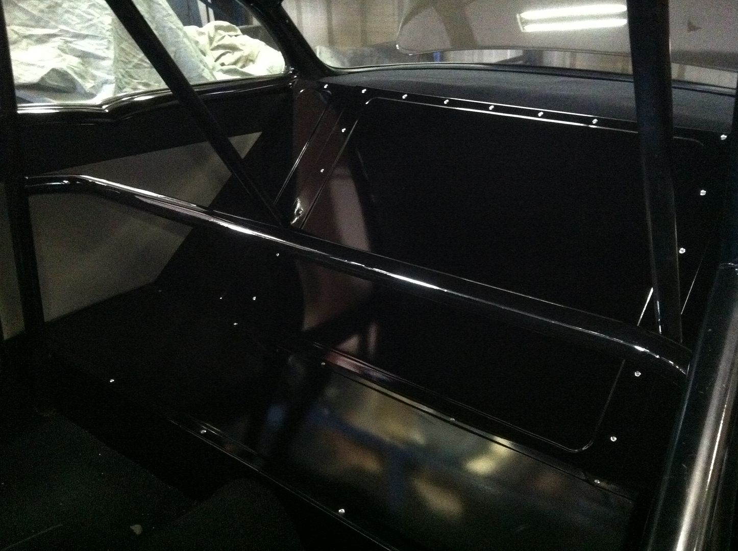

Al the interior panels came back from the powder coater and were re installed.
http://i1337.photobucket.com/albums/...ps601879cc.jpg
http://i1337.photobucket.com/albums/...ps642a4a24.jpg

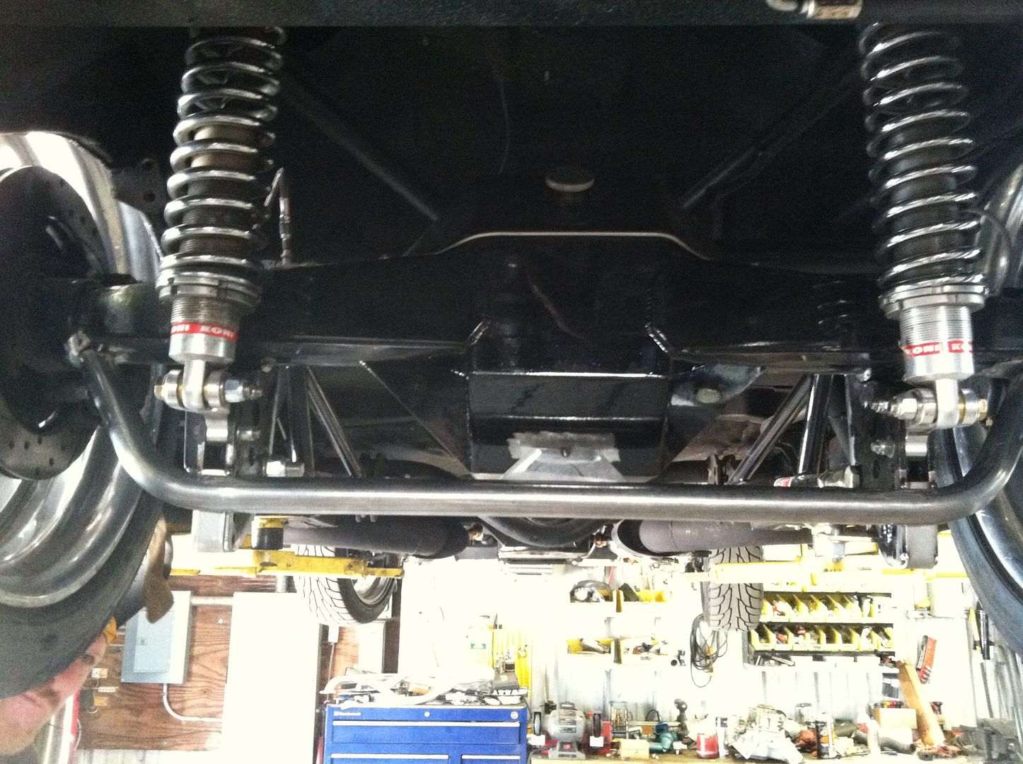

GAP Industries 01-05-2014 09:44 AM
New Fabricated 9" installed. New Coil Overs, Ladder bars, and also built a custom side exit exhaust that we had coated black to blend in.
http://i1337.photobucket.com/albums/...ps86405be2.jpg
GAP Industries 01-05-2014 09:45 AM
We ended up adding more bracing to the ladder bar/shock brackets.
http://i1337.photobucket.com/albums/...psd7113321.jpg
