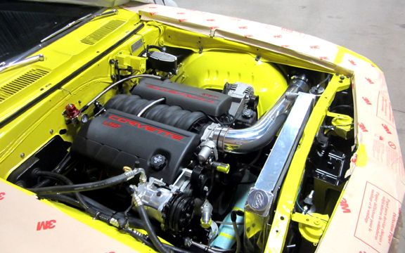

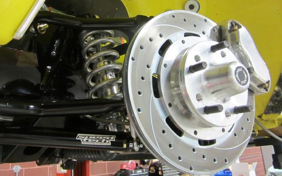

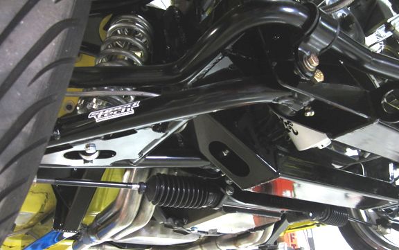

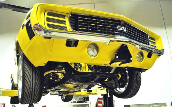

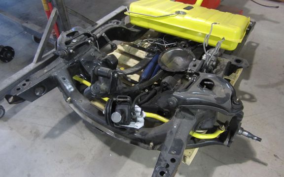

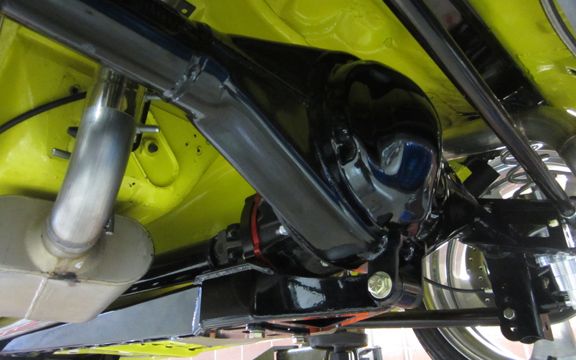

We recently got a '69 Convert in the shop for an engine and suspension swap. It's almost done, we need to adjust the suspension, do an alignment, and a little bit of interior work to wrap things up. Thought I'd share a few photos and will post more "posed" pics when it's done.
The story is this car was bought at auction a few years back. Upon returning home the car got driven about 8 miles when the SBC grenaded. So much for a fully rebuilt car. The owner was so frustrated he just put it in storage. Over this past summer we built a '69 Camaro for his son, see below. That car became a mag cover car not long after it was finished. Dad liked our customer service, shop work, and products so he decided to dust off the 'Vert and bring it to us. We're glad he did, and we suspect the car is too :).
We found several things wrong with it besides the bad engine, so we ended up swapping in our Track Time complete front and rear suspension package along with an LS2 backed by a 4L60 and a full custom stainless exhaust system. Enjoy the pics!

Some of what came out...
http://i1299.photobucket.com/albums/...ps48b4b80c.jpg
In with the new...
http://i1299.photobucket.com/albums/...psf7168d6e.jpg

streetbird 01-22-2014 04:44 PM

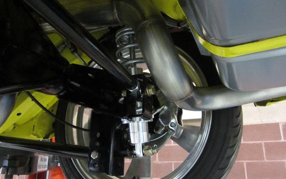

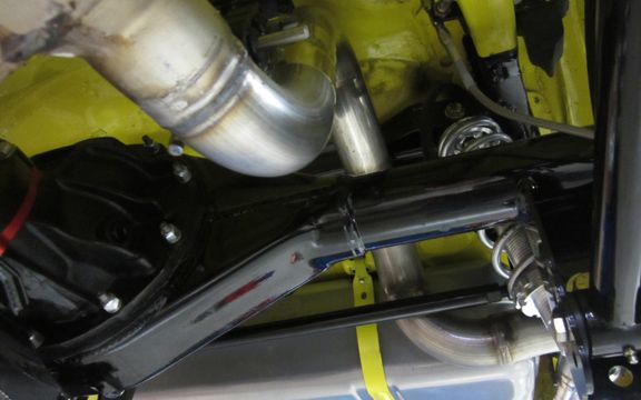

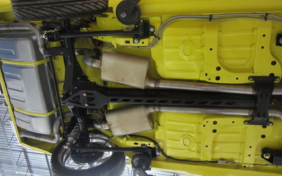

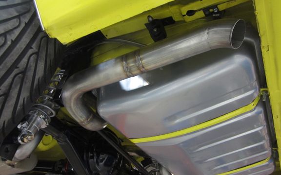

nice car. What is the od off the exhaust piping 2.5 or 3 inch?
Sheck44 01-23-2014 02:53 AM
Exhaust
Thanks Ben for the exhaust pics with the Torque arm and stock tank, exactly what I was after.

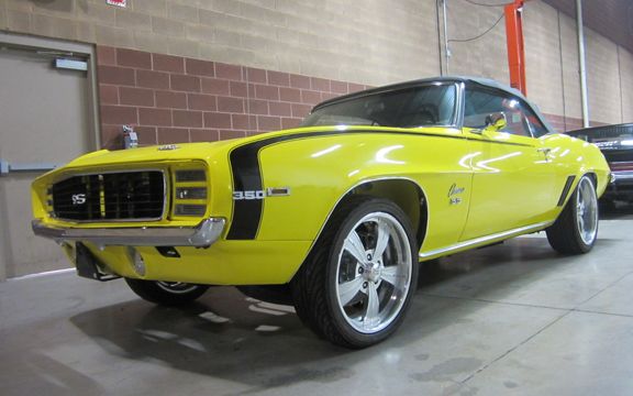

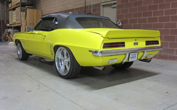

Very nice guys, is he changing the wheels? They just look a little dated? Nice looking car!
72Z/28 01-25-2014 05:59 AM
Awesome suspension upgrade Ben. Just wondering is this the EFI tank from Aeromotive/Tank Inc?
Ben@SpeedTech 02-03-2014 03:47 PM
The exhaust on this car is 2.5" od. That is an Aeromotive fuel tank with internal Stealth 340 pump.

It would be our preference to do something a little wider, but the owner likes these. However, it looks TONS better with the ride adjusted lower. More pics soon...
