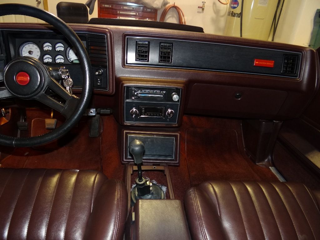

Sieg 01-17-2014 08:44 AM
http://photos.smugmug.com/photos/i-d...dTrVK5J-XL.jpg
My engine is solid mounts with urethane trans mount.

Sieg 01-17-2014 10:53 AM
Originally Posted by cwylie (Post 529651)
Seig- Did you run any type of rubber boot on yours to keep exhaust/dust/rain out?
I would like to keep it as low profile as possible because I dont plan to run a center console. Im thinking im just going to run a lokar shift boot screwed directly to the floor but we will see.
I sewed up a vinyl cover for now since I have a console. The Lokar may be your one of your better options.
