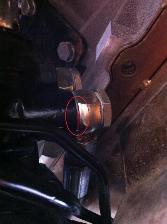

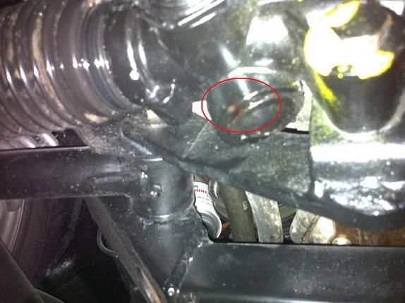

I have got this power steering rack and pinion leak problems ever since I bought my car. The rack and pinion came with the Speedtech front clip kit that was installed by the previous owner and power steering leak issues started after driving the car for only 150 miles.
I have circled the areas where power steering fluid leak is taking place.
http://i218.photobucket.com/albums/c...ps7e26d894.jpg
http://i218.photobucket.com/albums/c...ps503e91d3.jpg
http://i218.photobucket.com/albums/c...psc3ff7677.jpg

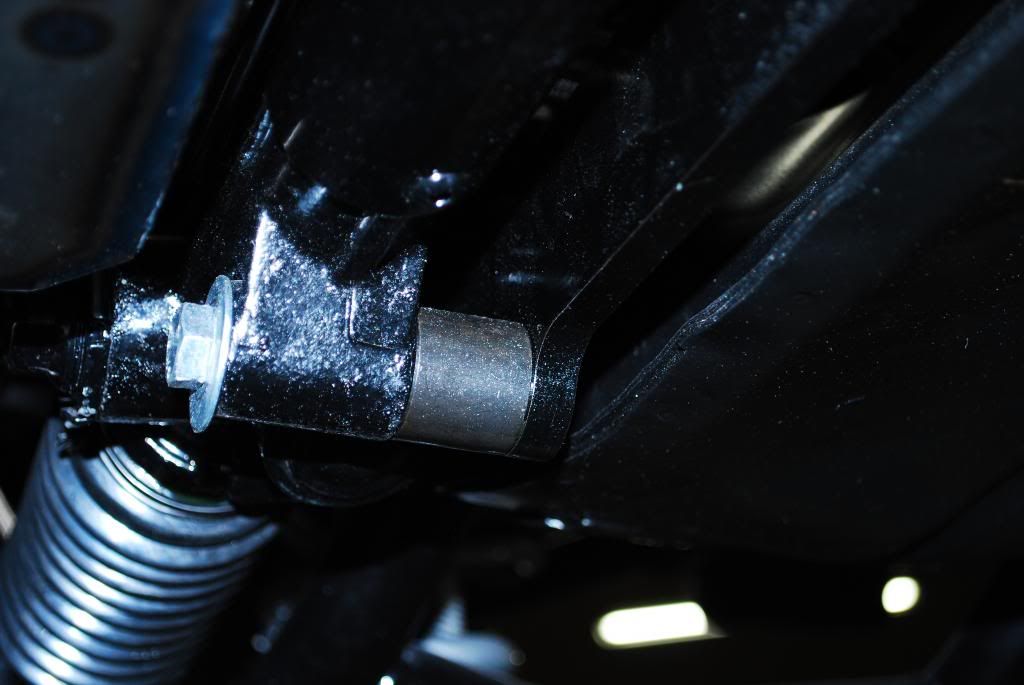

The high pressure hose as seen in the above photo is leaking as well plus the areas circled above. I cleaned the area circled in the 3rd photo, and I did not observe any leak afterwards
I am really surprised how power steering rack and pinion failed after 150 miles of driving.
Does this mean it is the time for a new power steering rack and pinion?
Your input guys will be appreciated

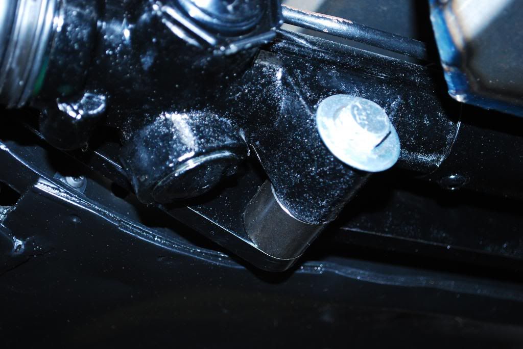

in a couple of the pictures it looks like the mounting bracket has been modified?? where the rack mounts to the bracket, not sure what is going on there.
The leak at the Banjo fitting is likely just that it needs to be tightened or was tightened incorrectly and has damaged the seal.
Make sure!!!! the pressure line is on the correct port!!! the pressure "IN" port is the one that is lowest on the pinion housing. If this is hooked up incorrectly and has been pressurized then the seals inside the unit will probably be blown. and this will cause the unit to leak.
sometimes the fluid coming from the housing separation is left over assembly fluid.
The fluid also appears to be RED is it ATF or Power Steering Fluid??? DON't use ATF!!!!
let me know if this helps you can call as well if you need to 435-628=4300

I am not sure if the mounting bracket was modified. I do appreciate if you send me a photo showing the correct way of mounting the bracket

Blake Foster 01-31-2014 03:53 PM
GET THE ATF OUT!!!
if there is an issue with it leaking, and it goes back for warranty Unisteer will instantly void any warranty if it has ATF in the rack, it specifically says in the unisteer instructions "DO NOT USE ATF"
http://i1235.photobucket.com/albums/...ps1a19e4a8.jpg
http://i1235.photobucket.com/albums/...ps615fc7dc.jpg
