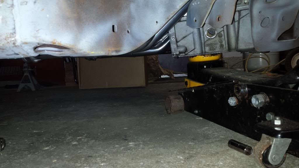

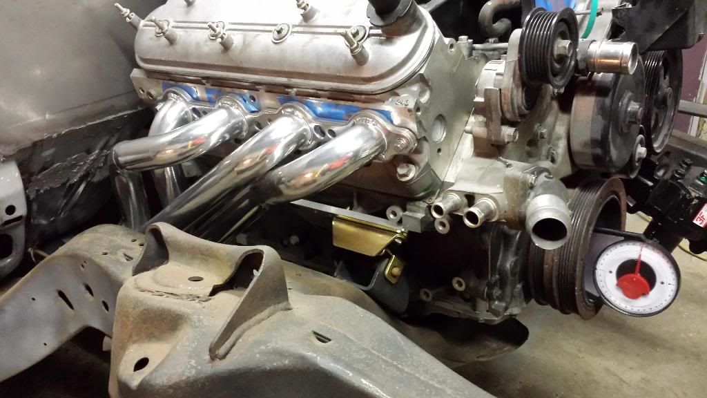

forcepower 02-18-2014 05:38 PM
headers
flowmaster sells a set also
[IMG]http://i772.photobucket.com/albums/y...psghz6lesg.jpg[/IMG]
they tuck up nicely
[IMG]http://i772.photobucket.com/albums/y...pshbioaetj.jpg[/IMG]
