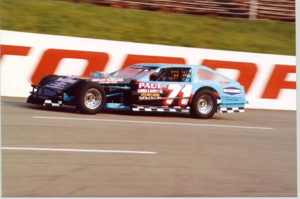

I sent Ron Sutton a PM regarding some help I am trying to provide a friend that purchased my old Asphalt Modified some years ago. He thought it would be helpful to start a thread just in case anyone was interested in the discussion. So here we go. We have had quite a bit of instability with asphalt short track racing in southwestern PA for the last 5+ years I would say. Because of that and other reasons this car hasn't run much. With the start of 2014 both 1/2 mile tracks have been purchased by new owners and will be opened with full race schedules. It's not important to the discussion, but here is the car before I sold it. Everyone likes pictures!
http://i140.photobucket.com/albums/r...cing/RCAR7.jpg
The current owners want to come back out and run a full season. In the years that have passed since I ran it the engine rules have changed to a point that the combination he has is not competitive. They are on a budget and can't go to one of the top builders in the area that have good packages. I want to try and point them in the right direction so that when they freshen their engine here in the next few weeks, they can make some changes for the better. As we all know tailoring an engine for it's intended purpose is a complex deal. I am quite sure we will not be able to go all out, but the discussion should be interesting. On to the details:
